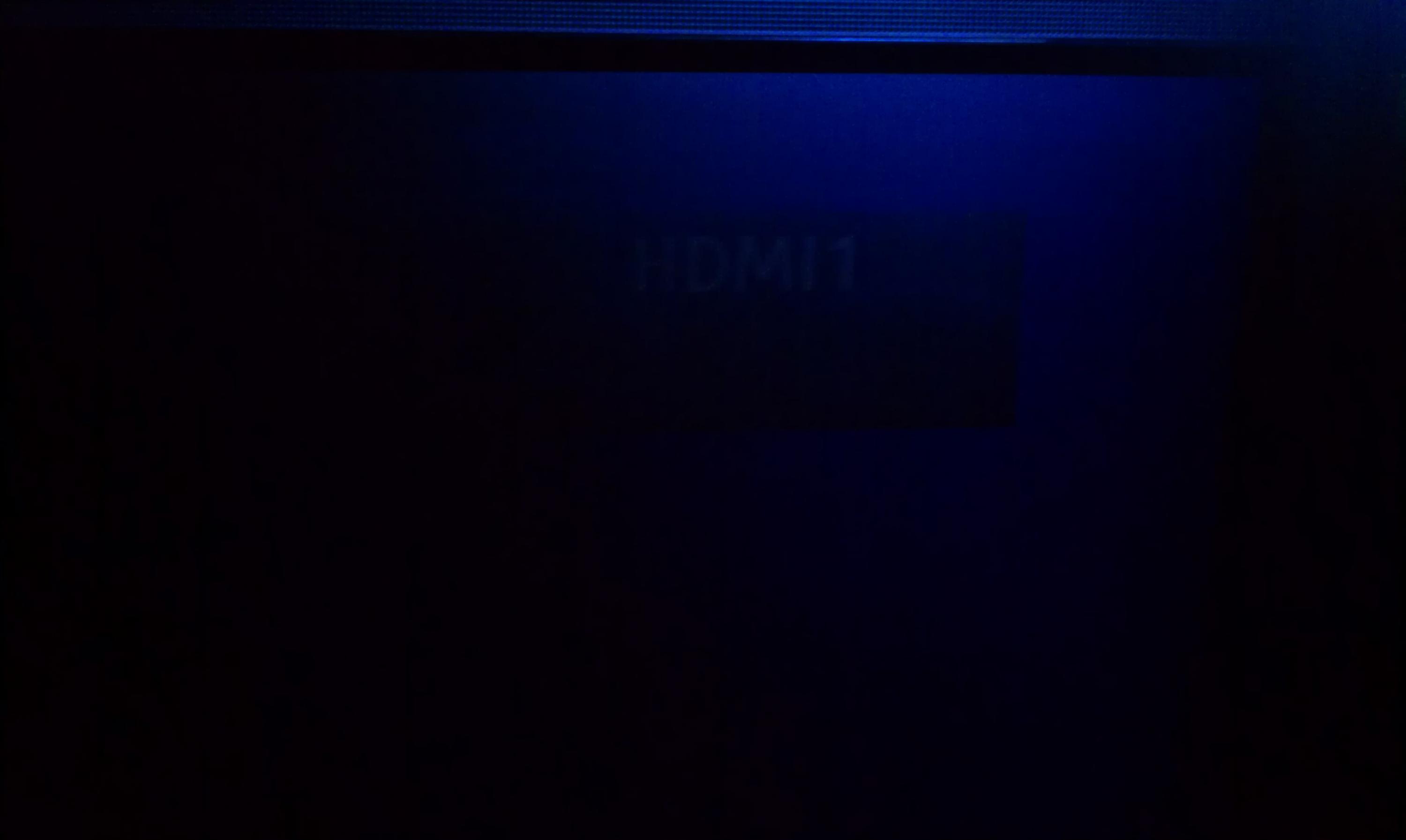

    Symptoms:
    The screen is mostly dark with dim, but clear, picture on the right-hand side. The TV also emits a high-pitched whine when powered-on. Its as if the right-hand backlight (Master-side) remains functional although at reduced output with the slave-side completely out.

              Before you spend any money. Post a picture of your set powered on in a dark room. I'm no expert, but wouldn't a bad inverter cause 2 seconds to black, or no backlight at all, rather than a dark half lit screen? I have a 46" Sanyo with bad tab bonds that does the same thing. I would hate to spend money on an inverter to find out the panel is bad.

                  Pic as requested. The backlighting appears to be even more faint now. I had to black-out the room for my crappy phone camera to even pick it up. It dimly illuminates only the top quarter of the screen. You can just barely make out the HDMI1 source msg in this pic (I have nothing connected to source at present).
                  I still need to re-open the case and check voltages as suggested by truep

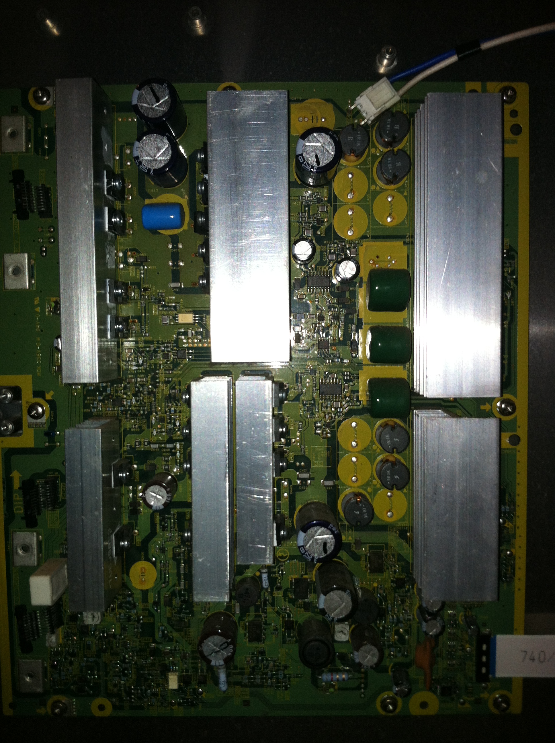

                        This is a TC-P50S1. 7 blinking red lights, if I disconnect the SC board I get 6 blinking lights. If instead I disconnect the board on the opposite side(can't remember what it is called) I still get 7 blinking lights. I also tried disconnecting the upper and lower boards connected to the SC board but, this did not make a difference so, I believe the SC board is my problem. It has the glued on heat sinks so, I can't see if anything is blown. Everything visible looks fine. I can't seem to find a price under $130 for a board. Any suggestions where to get cheap parts?
                          This belongs in its own thread.
                          If you do not have good surface mount soldering skills repair services are available or board swap is the only option.
