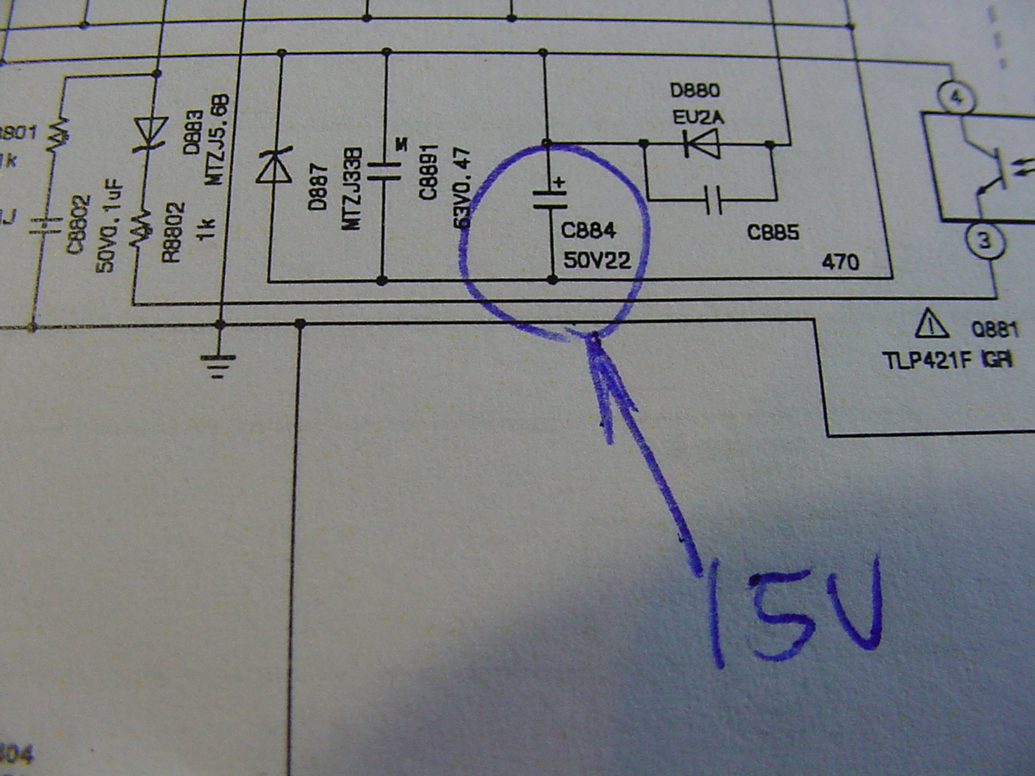

    Did you put on enough heat sink compound when you install the new IC? Toyical VCC for the STW6765 is around 18~19V range, see spec attached. Is the 12V out put steady?

      I put quite a bit on there and it's coming out the sides of it. And thanks for the voltage info. I'm wondering if its the connection of the regulator or the seine board going bad. Someone else had the same problem but I never heard if replacing the seine board fixed it

          I checked the voltage, it is 15vdc.

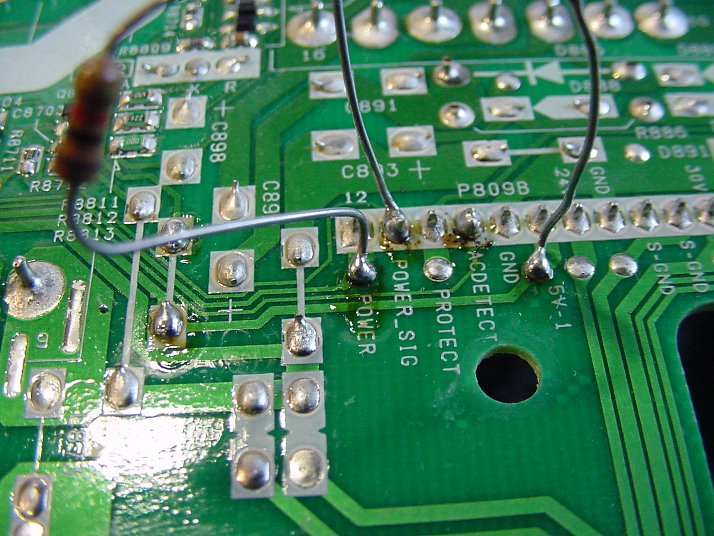

            So what did you just put some resistors of the power supply. What value are those resistors.
              Re: New problem 42hl196
              The typical 1 k resistors. I am also trying to figure out why that IC gets so hot, I did not have a chance to check the temp yet.

                I tried the resistor thing you did but it didn't change anything. It still does the same thing. Tv blinks red lights for 30sec then blue light comes on with backlight which looks kinda dark in the middle then screen shuts off then comes back on a couple seconds later

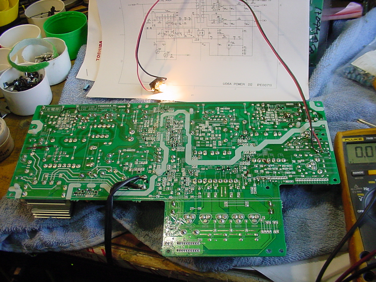

                  You use the resistors to test the power supply by itself, not connected to the other board.

                                  So I tested the tv and left it on for about a hour and a half and heard a huge pop and tv was off giving 3 red blinking lights. I looked at the connection of the 6765 and one of the solder joints I guess got hot and melted and touched the one next to it. Do u think its fried the strw6765. I'm so frustrated now with this power board. It would be nice to start again with a fresh one but you can't find them anywhere.

                                    So I bought a power supply off ebay and got it and plugged it in and it fired right up cause it said it came out of a working tv w/cracked screen of course. It worked fine for about 30min then shut off. I went and felt the heat sink on the strw6765 and it's blazing hot. And I touché the resistors above it and they are hot but not burning hot. And I touched the other two big heat sinks with mosfets on them an they are warm but not burning. I do not understand what the problem with this is. Why is it running so hot. And I'm sure that's why it shut down.

                                      As a suggestion, I'd just check the various diodes that form part of the circuitry around that regulating device. You might have to lift one leg to accurately check. Bud is far more knowledgeable than me, but often these diodes perform a 'snubbing' function to prevent high frequency oscillations and the like, and if the diode has failed then the device can overheat although will initially function.
