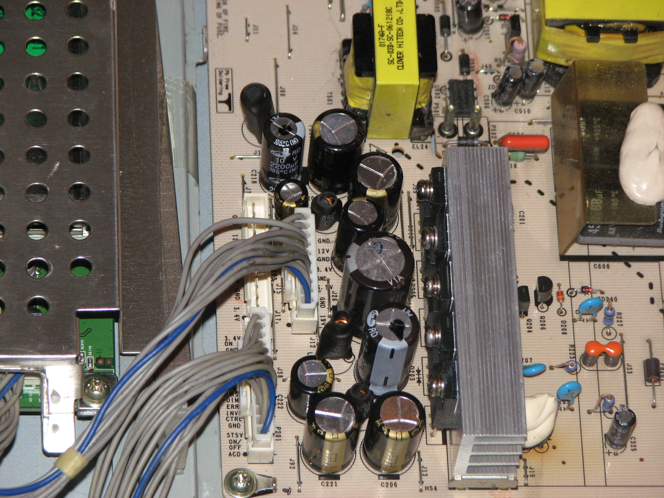

      Originally posted by mikoz View Post
      Sorry can't read the IC's but have squared 5 out for you to check for Tom66's suggestion. RU3037
      Thank you for reply. It is the upper right mostfet
        Re: LG 32LC7D no sound
        Yeah, it's probably the rightmost IC on that image.
        That's it , here's the reading off it.
        1&8=.919
        1&7=.924
        1&6=1.083
        1&5=1.068
        can you tell me what to buy at digikey. I'm not sure what to buy,Thanks
          What is part # on it? Looks like only one chip so only need to replace that.
            Part #u3037m
              OK, then this should do:
              http://www.ebay.co.uk/itm/IR-IRU3037...item53f505b5ac
              May want to get second one as it can be difficult to solder.
              One pin to check: pin 1 to pin 4, DC20V scale. If IRU3037 is working well, it should be around 1.25V +/-5%. If not, it will be lower or higher.
                        Originally posted by CR Designs View Post
                        Thanks tom66 will check it and post reading
                        Tom66 It read 1.24, so do I need to replace it ?
                          #32
                          Hmm, I would replace it anyway, but that is unexpected. Someone else on this forum had that chip fail with same fault but different power supply. I wouldn't be as certain as I was before, though. If it doesn't work, it may be one of the feedback resistors is bad. If the input-bias of the IRU has increased, then it could still cause this...

                                      #38
                                      Can you show which connectors have 3.4V on them? The 3.4V failing causes a variety of issues: DVB failure (no digital TV or blocky image), HDMI failure, remote control fault, side button fault, audio faults and failing to power on.
                                        #39
                                        Here is the image. The 2.38 volts is found on the connector closest to the edge of the motherboard - connector P201.
                                          #40
                                          That's fine -- it's simply an on/off signal (3.4V ON) which >2V is OK. So you would most likely have a main board problem. I note this TV uses a different PSU to others. Can you post a picture of the main board? This is the board with the HDMI inputs on it... there may also be a 2nd main board with other inputs on it.
