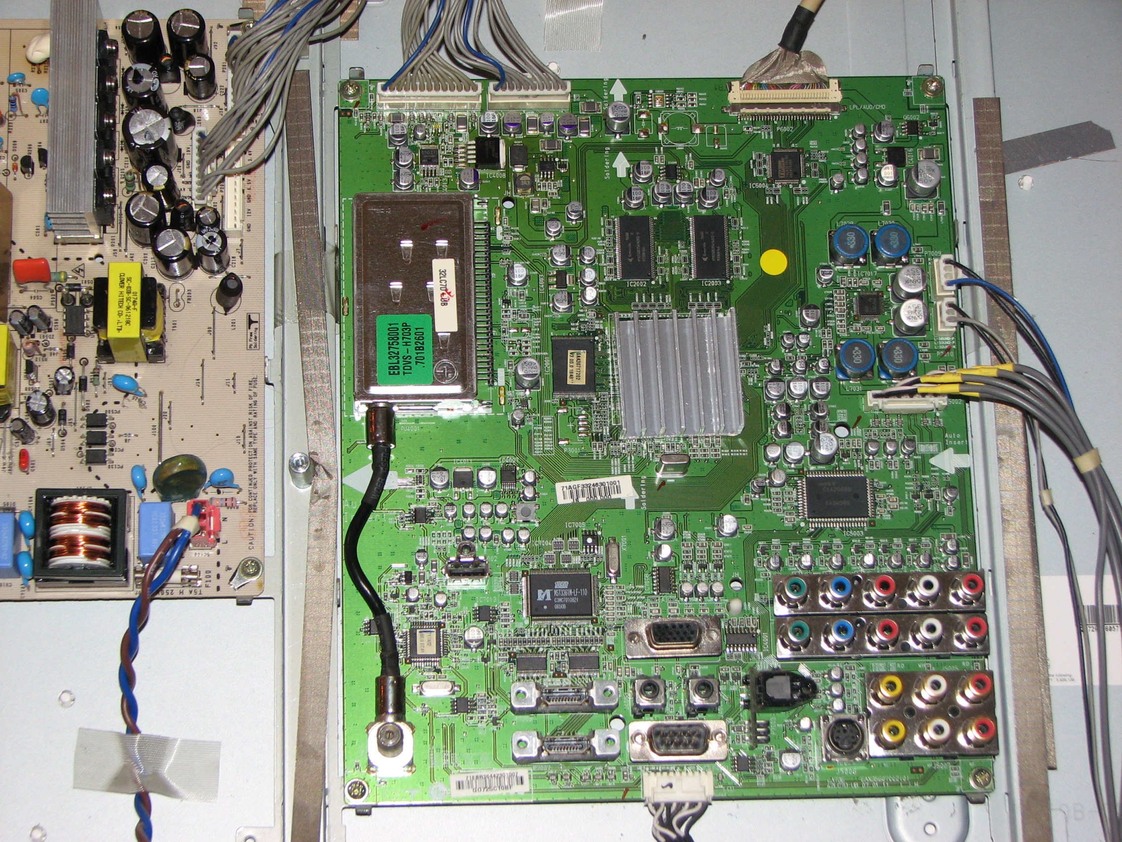

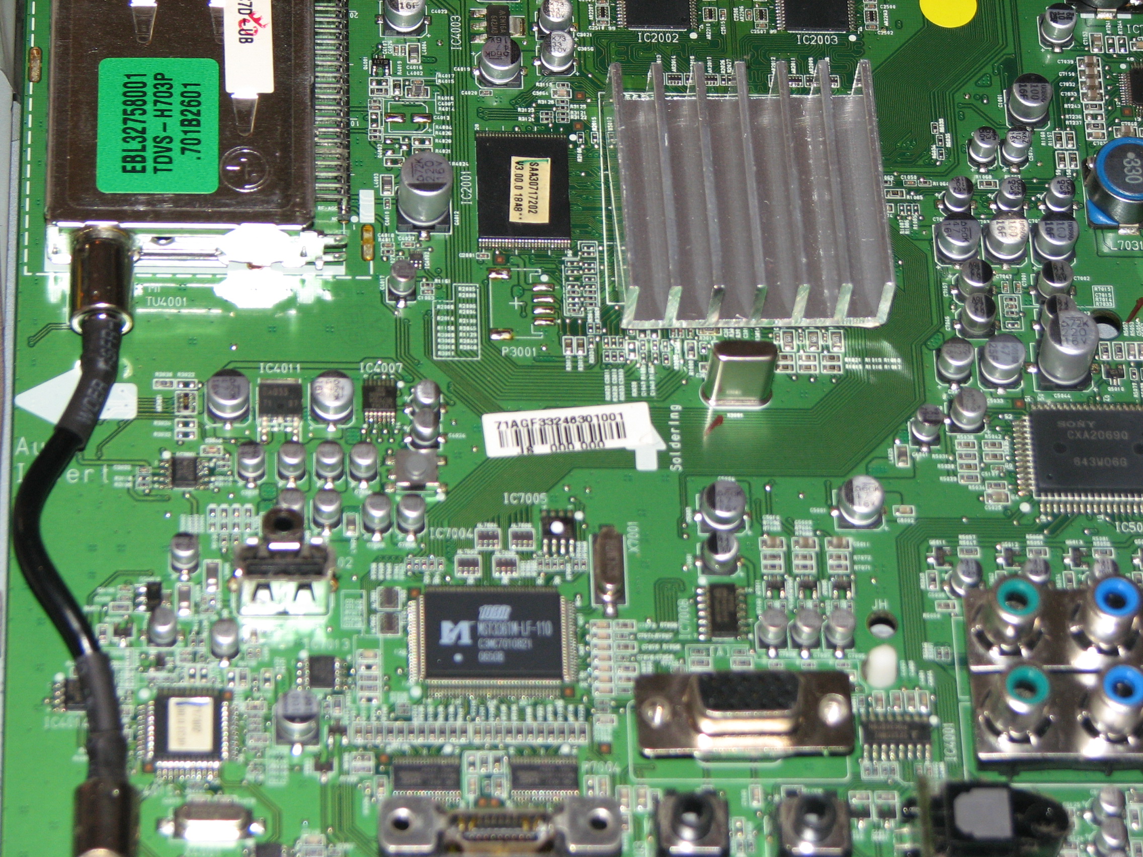

    Here are a couple pictures of the main board. Thanks for taking a look.
      #42
      Re: LG 32LC7D no sound
      As expected there are a variety of voltage regulators on this main board. See this post for how to identify and test such devices.
      https://www.badcaps.net/forum/showth...329#post261329
        #43
        Hi Tom, so I went ahead and checked voltage readings on all the regulators that I could locate. I listed the values below. Problem is I dont recognize any of the part numbers and have difficulty matching them on datasheet.com. Are you familiar with any of these or recognize any faulty values
        Measured values: LG 32LC7D-UB
        IC4022
        BA022 7197
        Pin1: 4.95
        Pin 2: 0
        Pin 3: 3.34
        IC4016
        KA78 09R
        Pin 1: 12.02
        Pin 2: 0
        Pin 3: 8.95
        IC4003
        EH16A 64J48
        Pin 1: 0
        Pin 2: 3.27
        Pin 3: 4.95
        IC4008
        SC156615M 0637 G0613111-1
        Pin 1: 3.37
        Pin 2: 3.34
        Pin 3: 0
        Pin 4: 1.19
        Pin 5: 2.60
        IC4013
        05DZ11 sharp HU0
        Pin 1: 6.45
        Pin 2: 3.22
        Pin 3: 4.95
        Pin 4: 0.01
        Pin 5: 0.00
          #44
          All regulators appear to be working fine. I can think of a few other tests, but will need a schematic of the main board.

              #46
              Yes. It can be caused by a power surge damaging the HDMI processor (the device marked "10Bit")
                #47
                So the HDMI processor also controls the analog/digital cable input? Just to be clear, the HDMI works fine.
                Sorry..you probably already knew that but wanted to make sure...
                  #48
                  Sorry, got that the wrong way around. In this case it would be a result of the cable/DTV tuner being damaged by a power surge or external event (wire touching cable line or local transient.)
