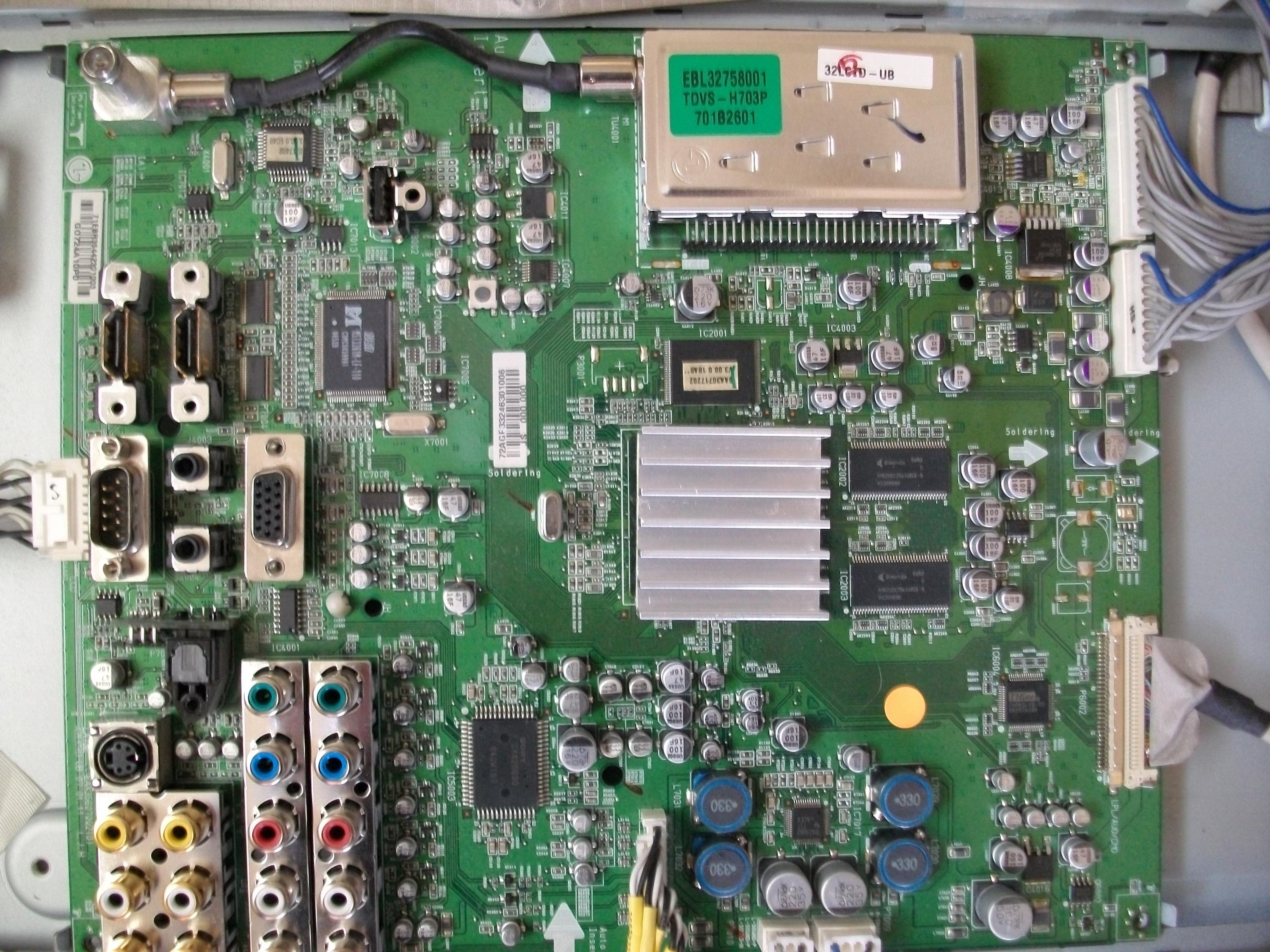

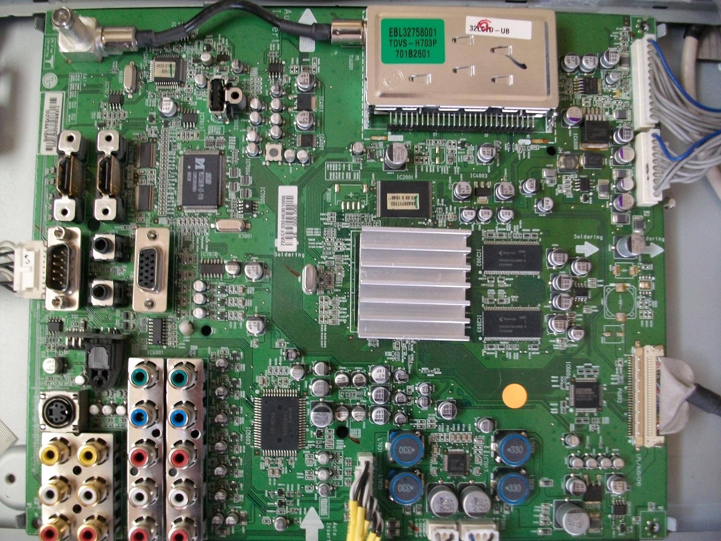

    Picked up this TV it was dead . Opened it up it had 5 blown capacitors. Replaced capacitors TV works great good picture, but has no sound. Hope someone can help on this tv, Thanks .For your info I tried it with a DVD player same result no sound good picture

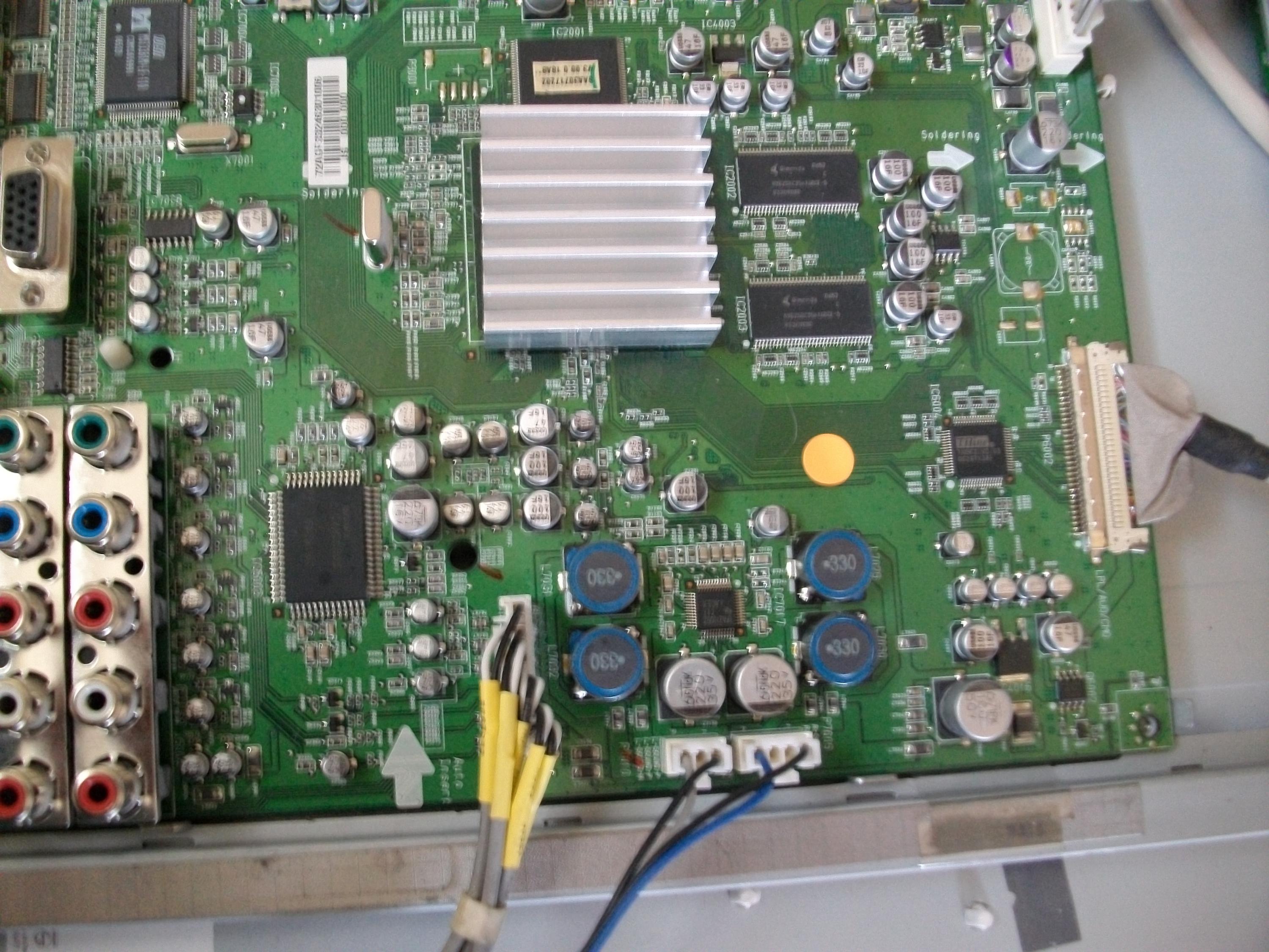

            OK, on the speaker connectors, can you unplug one speaker and see if you get sound out of one channel (repeat for the other connector.) If you get some sound out with one speaker disconnected, it indicates there is a short in the wire assembly somewhere or the speaker is shorted.

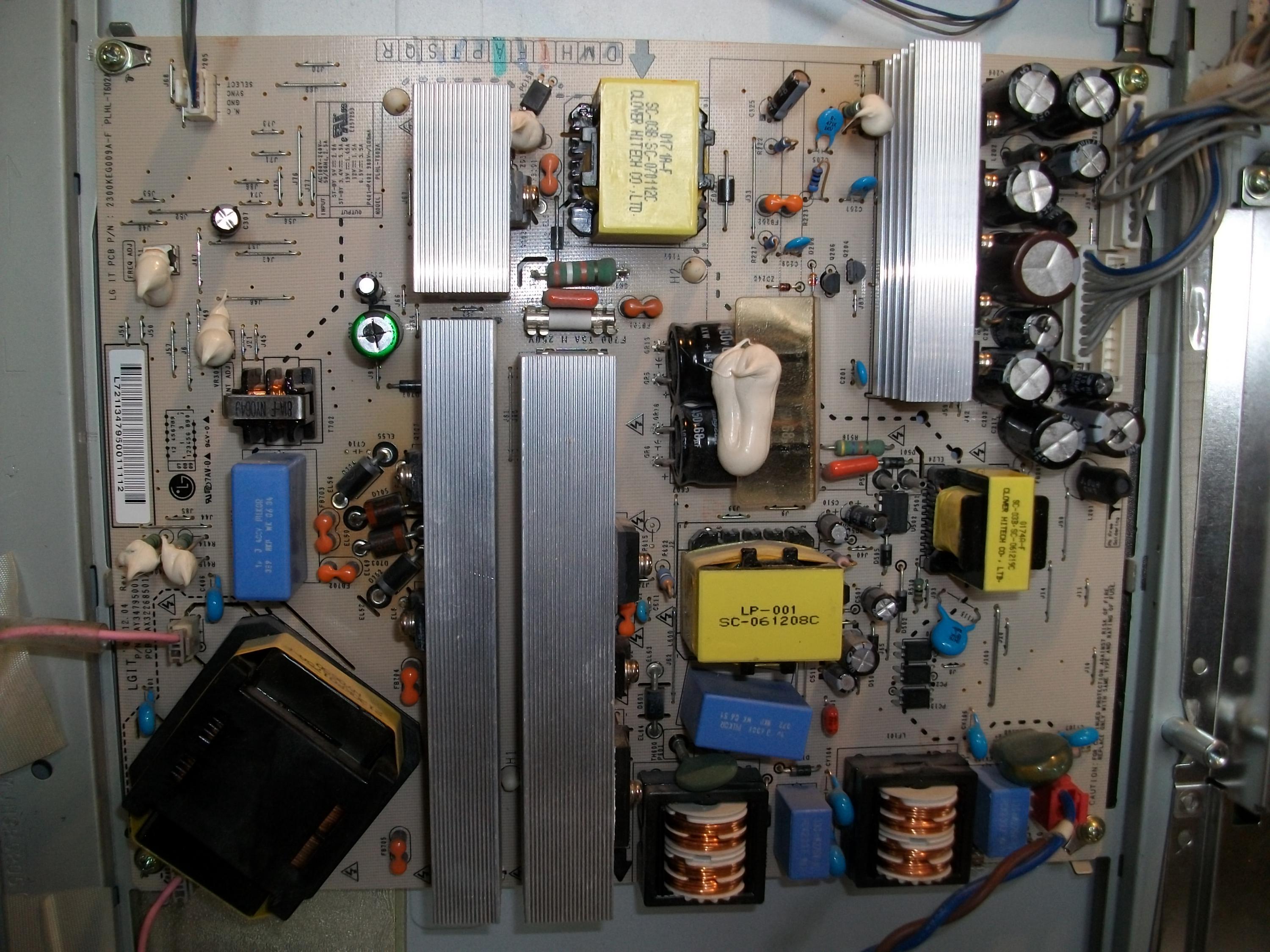

                            I tested the voltage on the PSB
                            3.4v- 2.41v
                            6v-5.98
                            12v-11.96
                            19v- 19.0
                            The only voltage that didn't look right is the 3.4v it was 2.41v could this be a problem?
                              Re: LG 32LC7D no sound

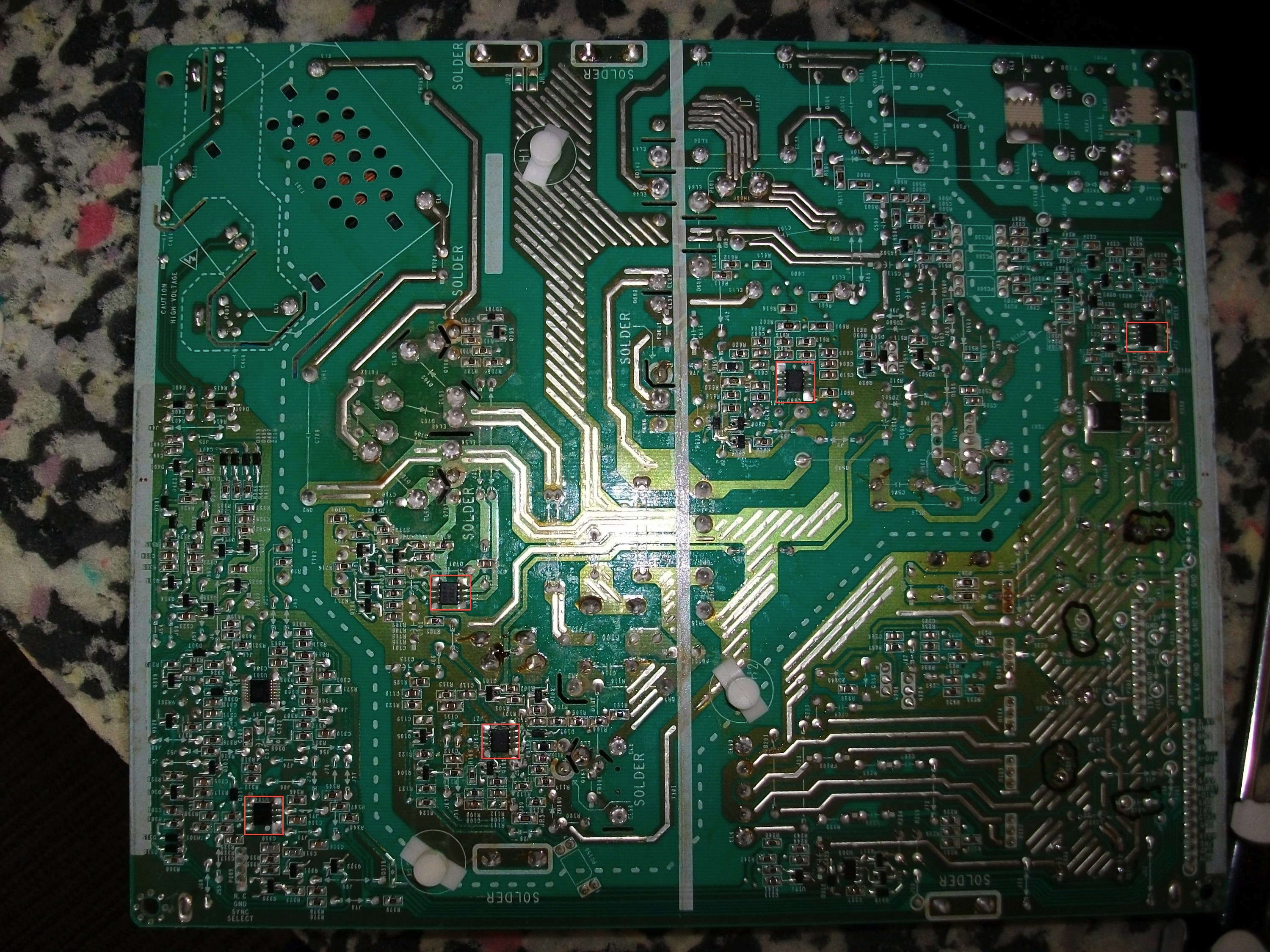

                              Yes, easily. It's a common problem on this model. On the bottom of the PSU you will find an 8pin IC marked IRU3037. Actually two of them. Replace both of these. One does 6V and one does 3.4V. I've only ever seen the 3.4V fail but I wouldn't rule out 6V failure. In addition I'd recommend replacing 3.4V & 6V rail caps as they can fail, unlikely to cause this but a good precaution.

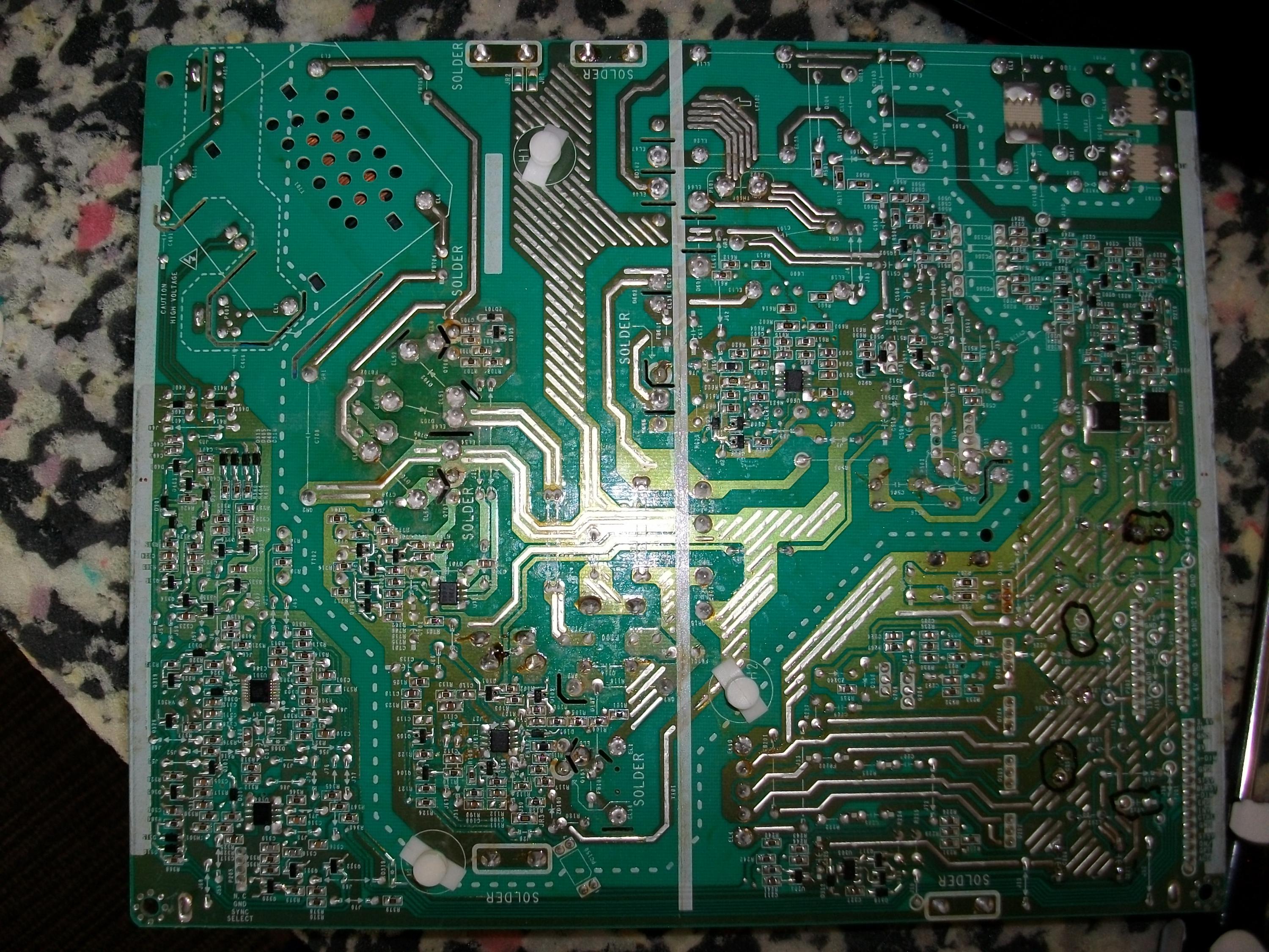

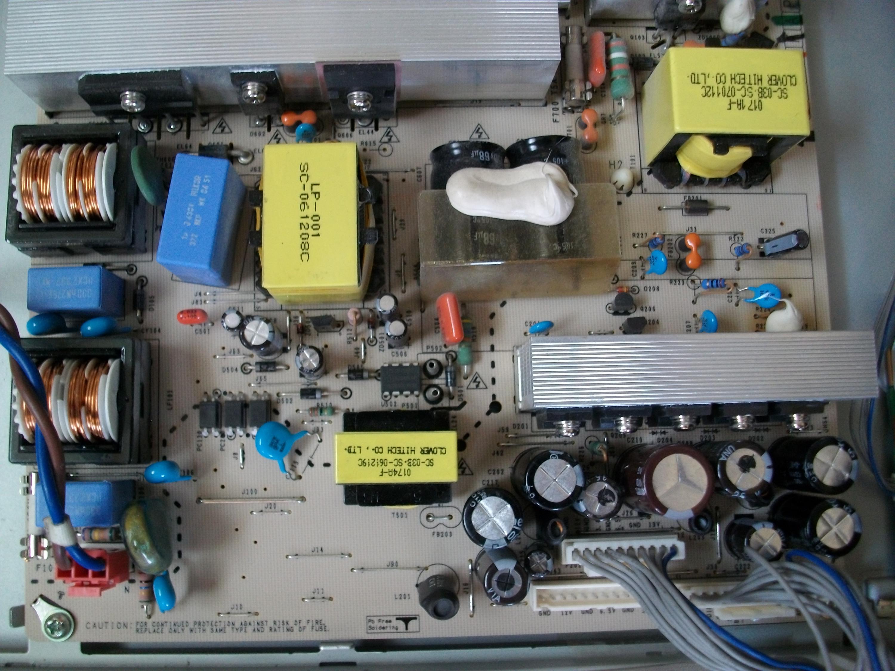

                                Tom66, I can't find the ic's you are referring to at the bottom of the PSU. I have replaced all the caps except for the 2 470uf caps .I have posted a picture of the PSU
                                  Bottom = green side, not lower side of power board, sorry for not clarifying.

                                      Tom66 can you point out the 2 IC'S you said to replace,Thanks I posted a picture of the board
                                        Sorry can't read the IC's but have squared 5 out for you to check for Tom66's suggestion. RU3037
