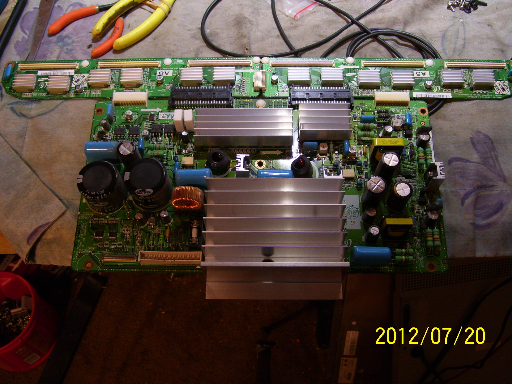

    OK, can you get a picture of the buffer boards and the Y-main?

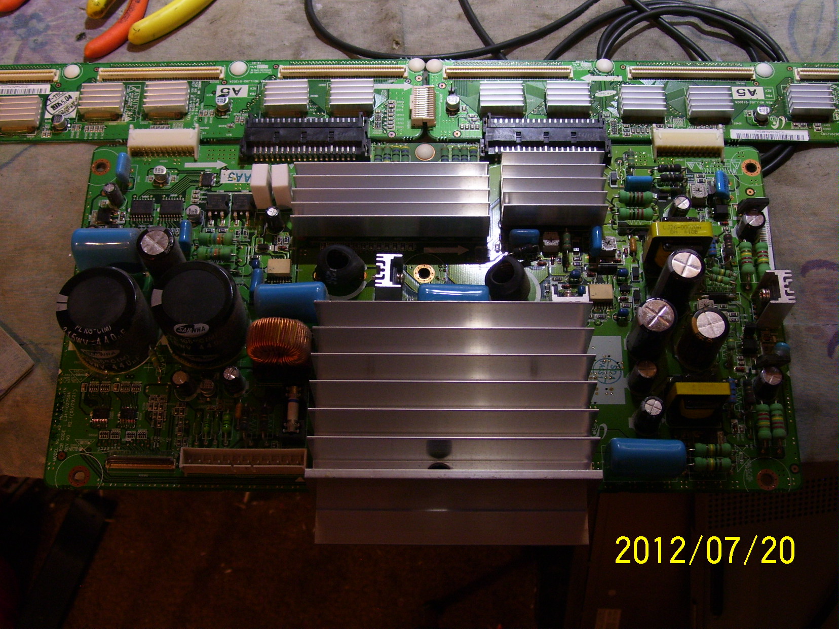

            I replaced the bad cap, it was a 100mf 50v, that didn't fix it and made no changes. Maybe just another problem getting ready to go at a later time. So while I had the boards out I took pictures. the cap that was bloated in the lower left corner by the little transformer. the one just above the big blue poly mylar cap.

              I did the drag the test lead across the buffer connections to the screen. and on the upper buffer board I found most of the pins leading to the top chip are shorted to ground, I know that this buffer is bad but I thought when a buffer is bad just a part of the screen is gone??? That is what the troubleshooting section of the manual says.
                Re: Samsung Model HP-R4272V/XXA 42in Plasma screen flickers
                The manual is wrong, a bad buffer can sometimes cause that symptom.
                The buffers on these sets are notorious for going bad, and sometimes taking the Y-main with them.
                You can try with only the top or bottom buffer and see if the set shows half a picture.

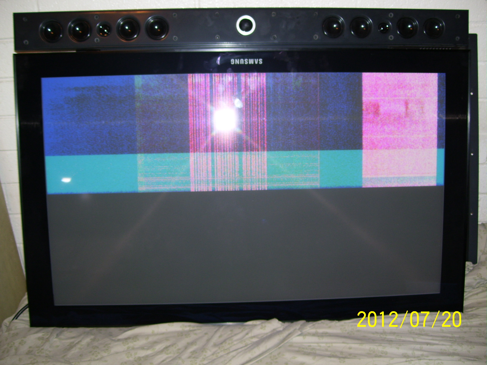

                    Ok I got half the screen but its all messed up, here is a pic of the set with the upper buffer removed... The TV is upside down in the picture

                        If the picture is not flickering, it is rare for the STK IPM to be bad. It looks like you may have at the very least a bad upper buffer, but possibly the lower one is bad too.
