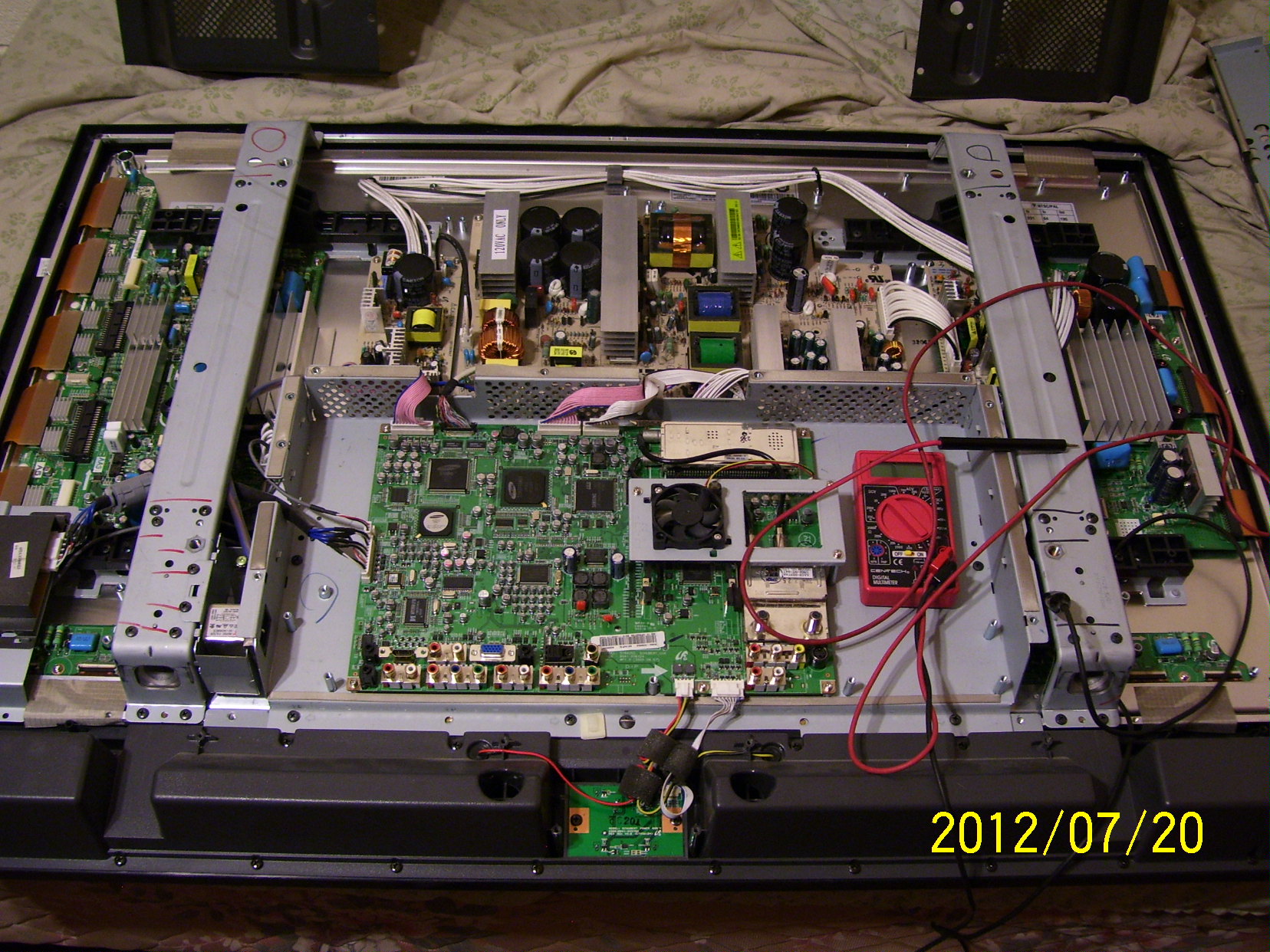

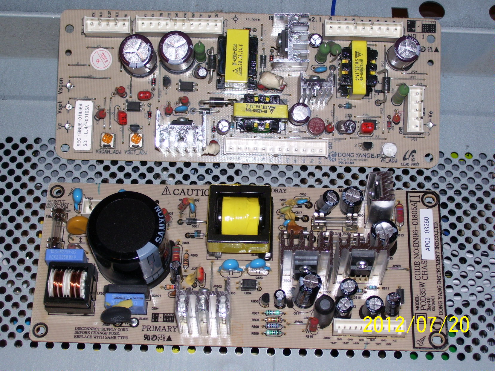

                          Re: Samsung Model HP-R4272V/XXA 42in Plasma screen flickers
                          Can I see a picture of each sub board?

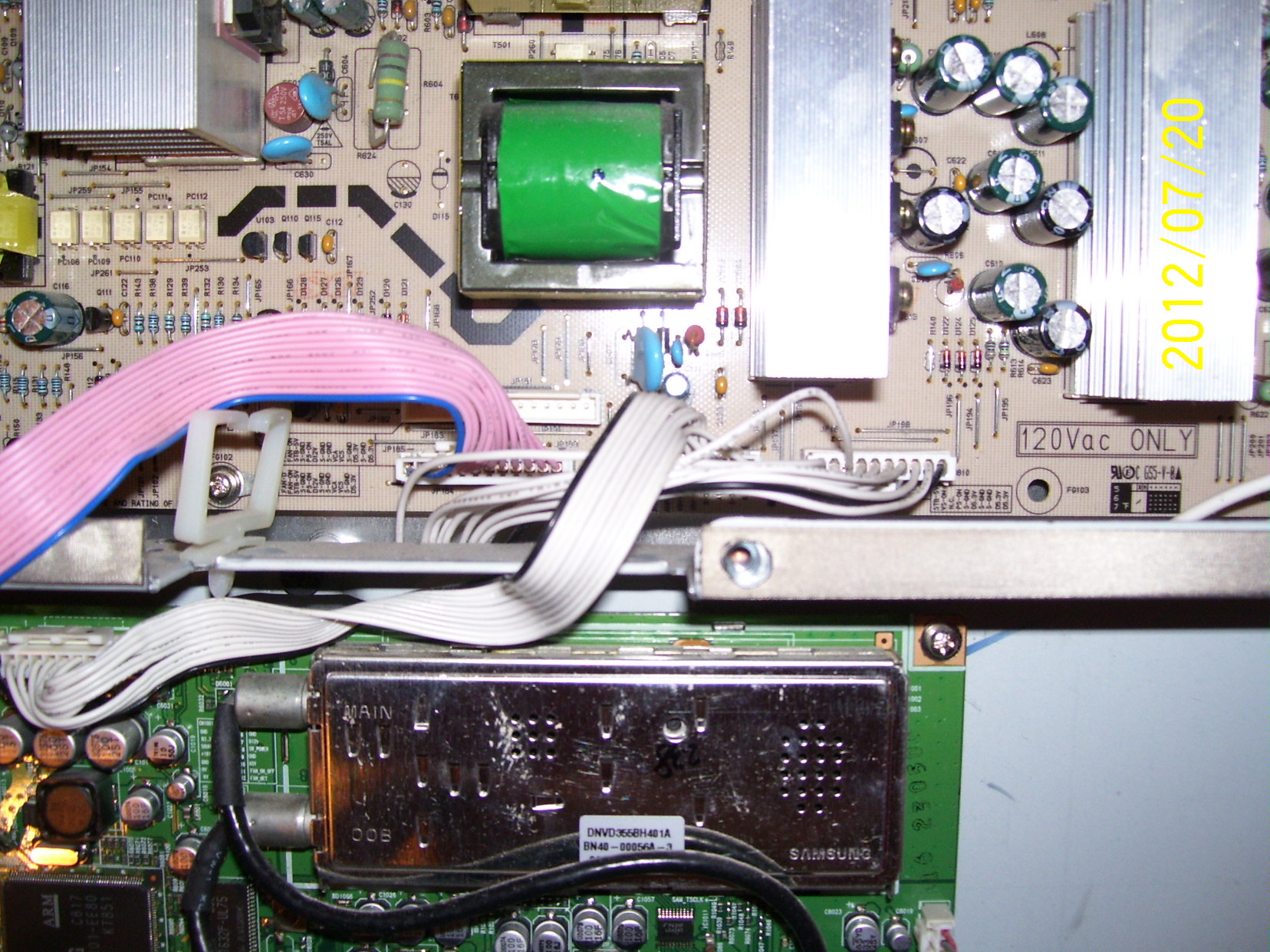

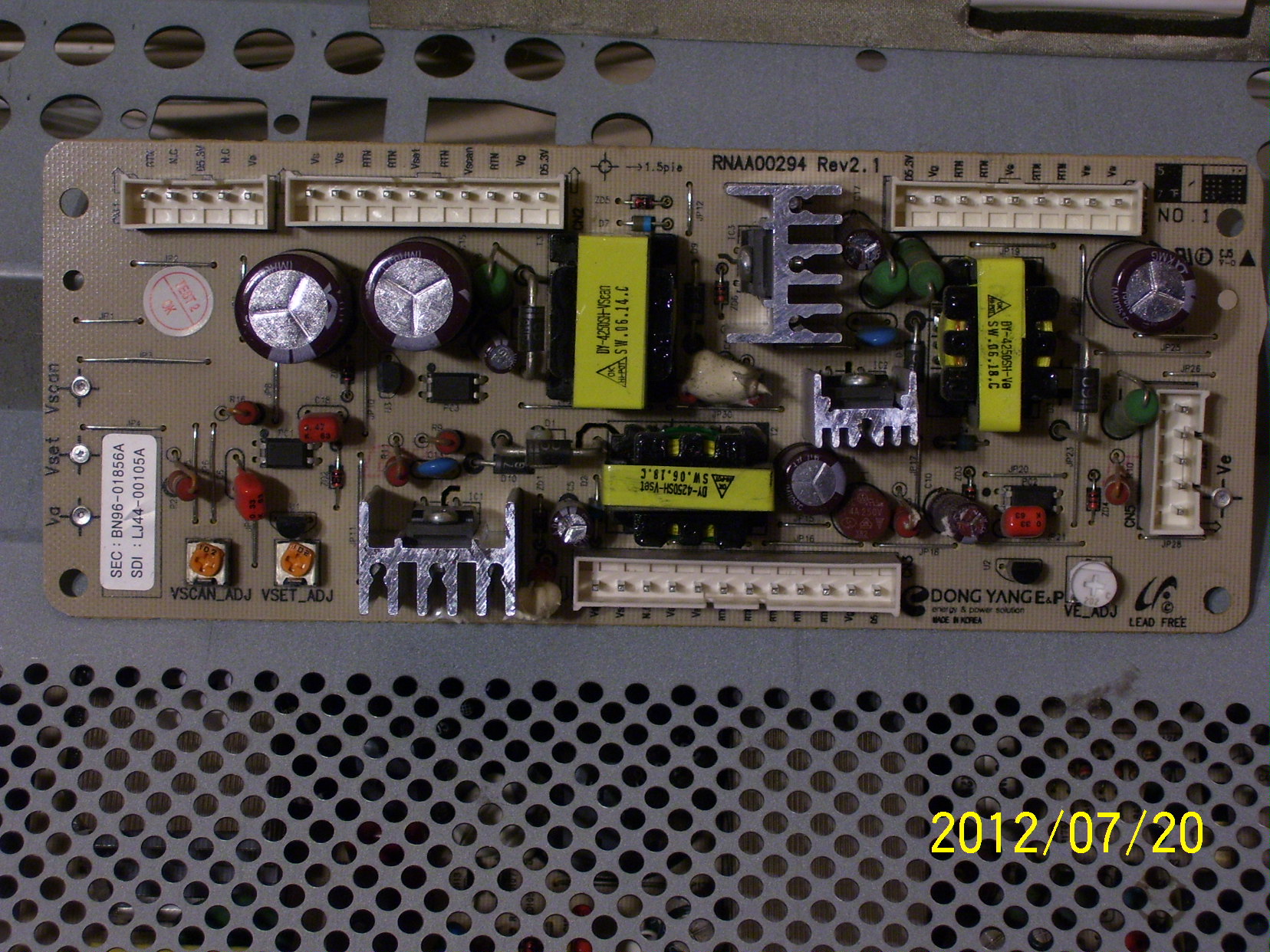

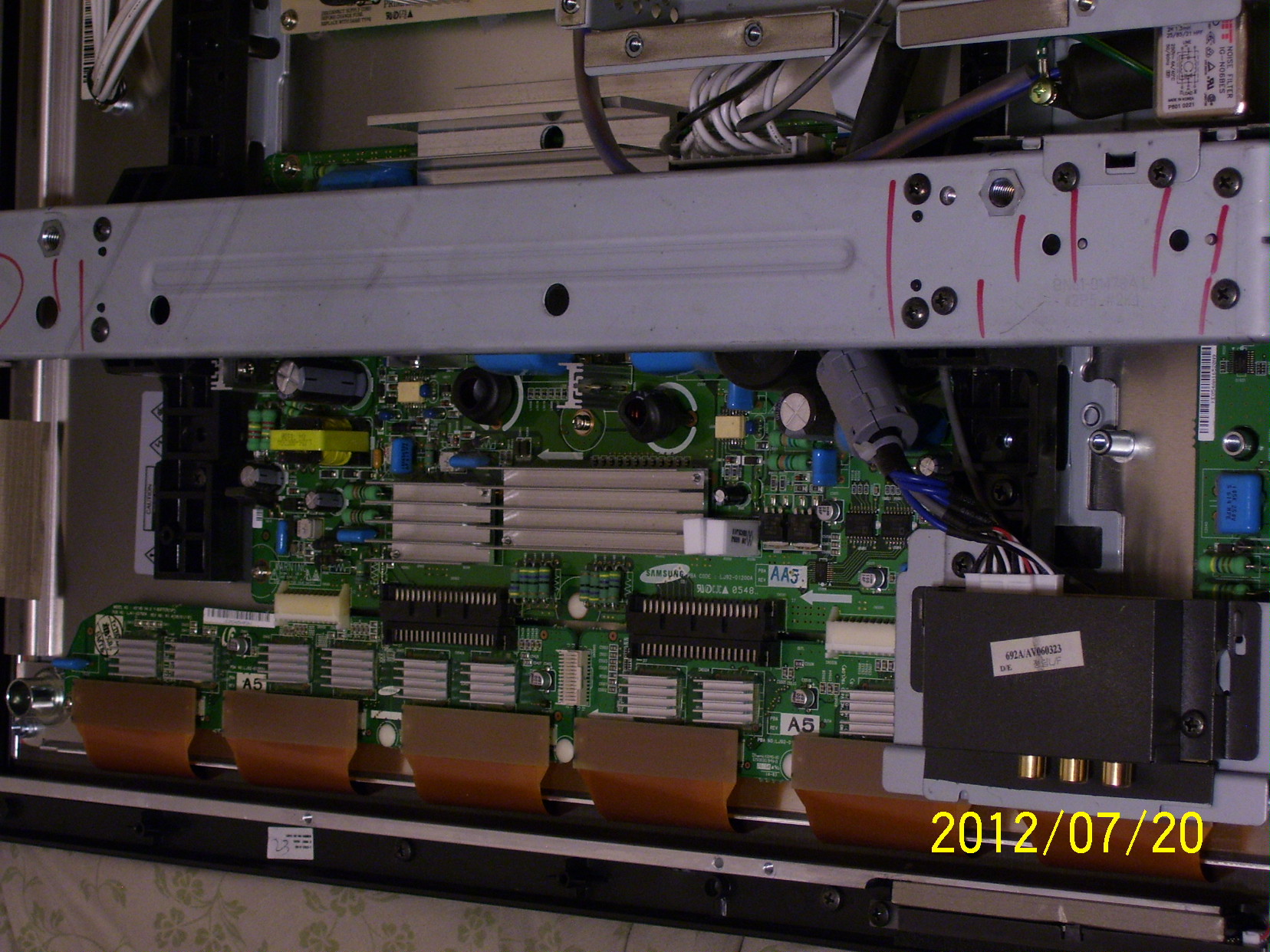

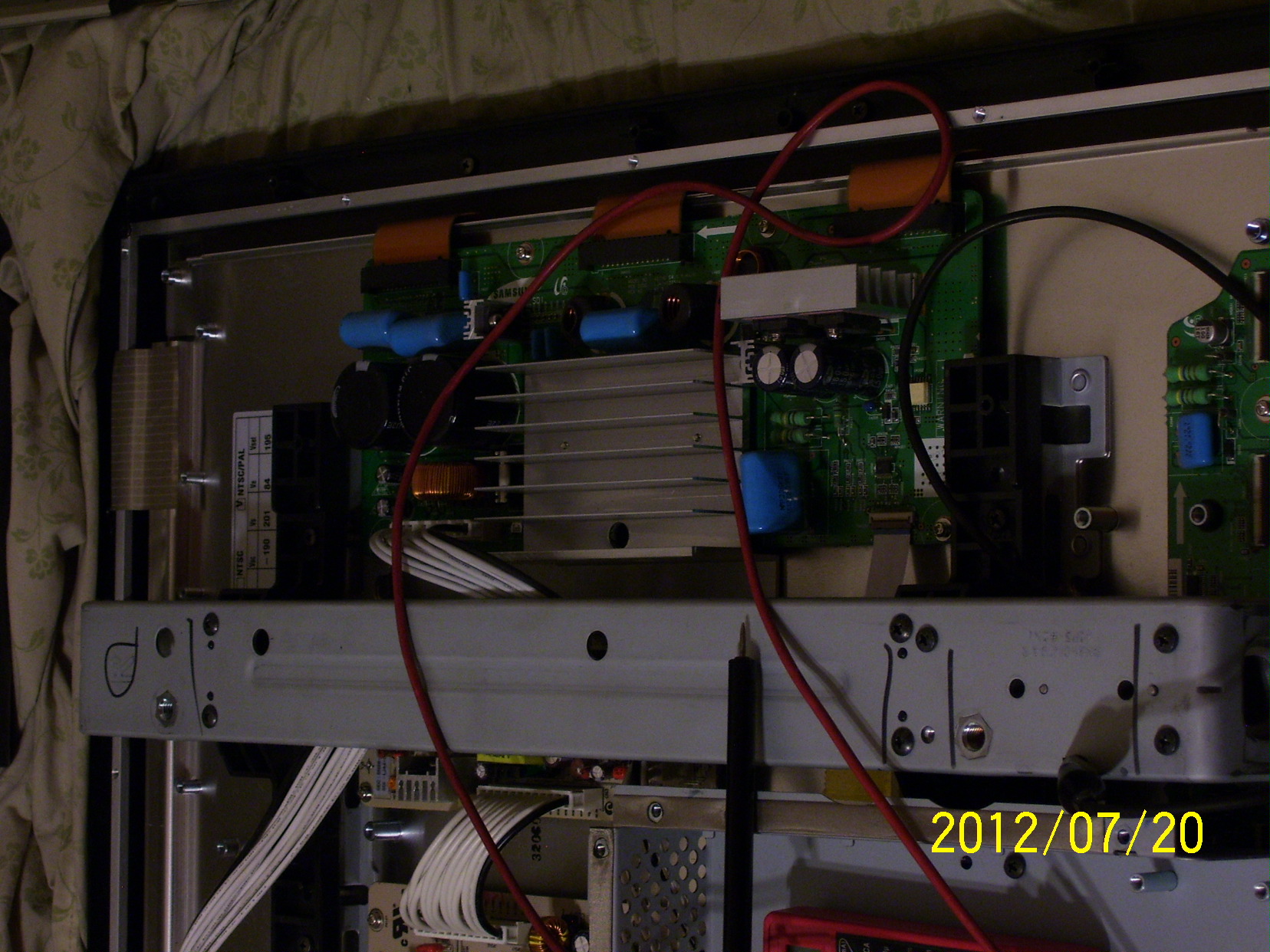

                                I had to remove them in order to get a good pic
                                  Vscan = -Vsc and Vset are testpoints on the topmost board.
