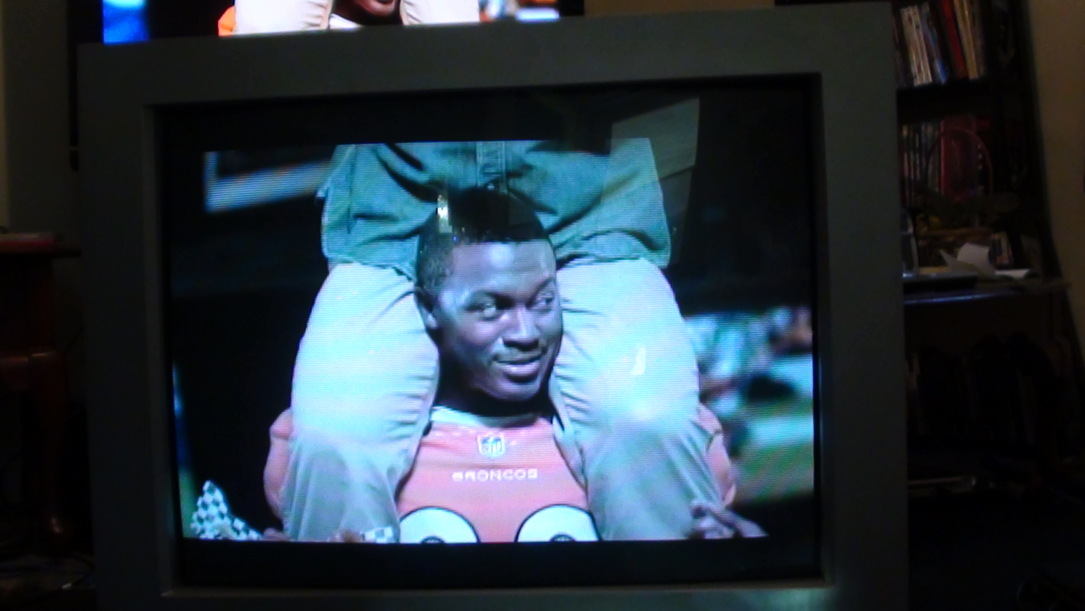

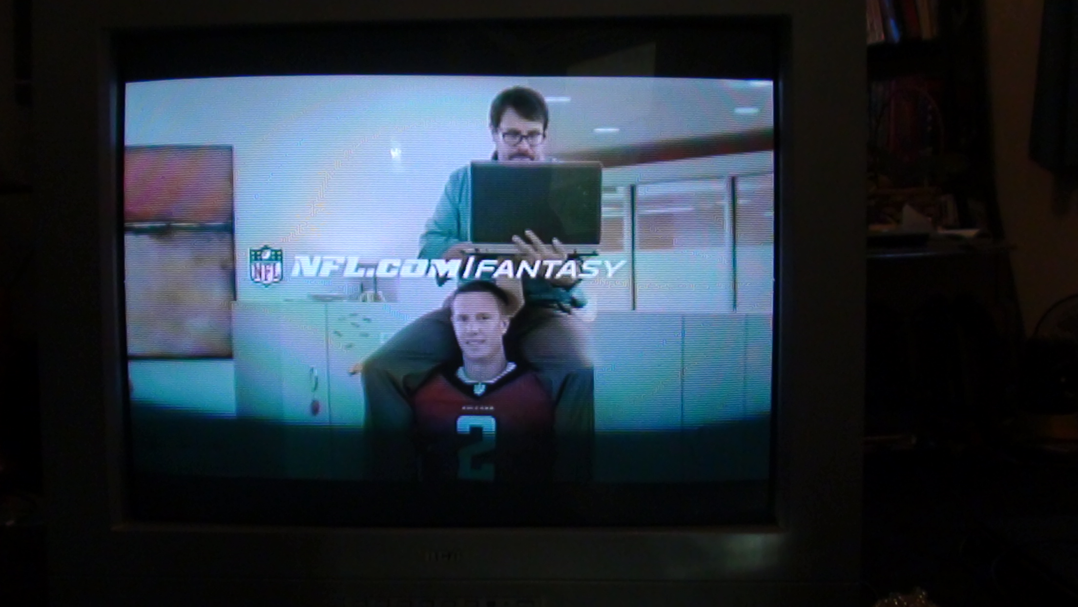

                              Attached are new pics of the screen, almost perfect! With the diode that I put in, the 4Mohm one, could it cause these problems now? The screen is a bit crooked and it doesn't fill the screen all the way. Almost all the way, but not quite.

                                The engineer put the diode in for a reason, and it's a $0.01 part, I'd replace it anyway.

                                  You can replace 1N4001 with any 1N400x. The fault you are seeing now is due to a different part of the circuit IMO, but doesn't hurt to replace the diode again with one that tests good (on diode scale, should read open on ohms unless you're accidentally touching both leads with your fingers).
                                  If the problem persists, check all voltages according to schematic, especially B+ and vertical amplifier. The power supply is low somewhere. Likely more bad caps.
                                    Oh yeah you're on the right track.
                                    Are you sure the TV is getting a 4:3 signal? That looks like a 16:9 image, and I don't see squashing.
                                    As for the crooked screen, that lies in the yoke position, and with it being an RCA, the yoke is likely bonded to the CRT.

                                          I think your TV is basically fixed judging from the last images you posted. I think your issue with the image not filling the screen is because the signal you're feeding it a 16:9 letterboxed image.
