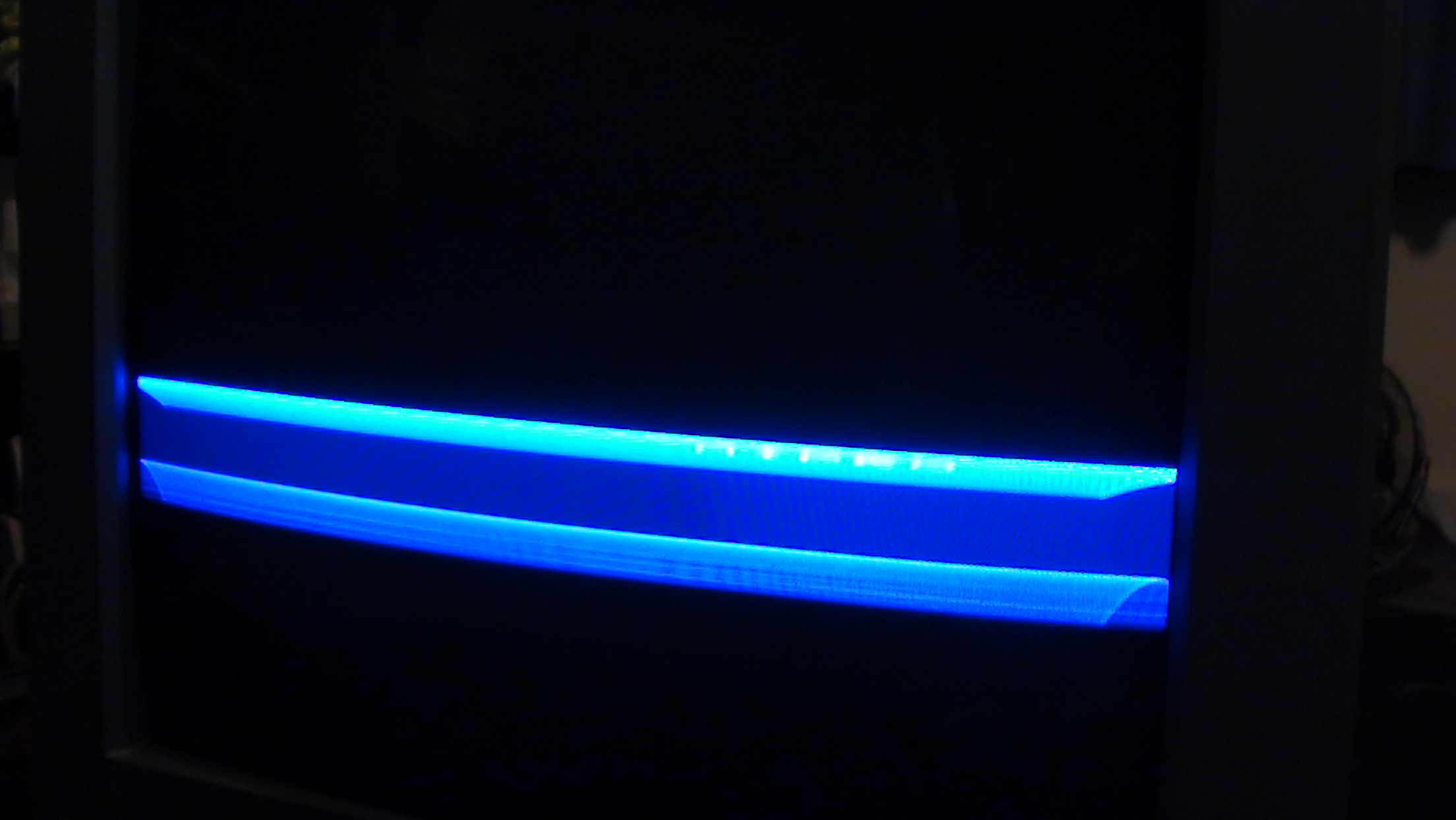

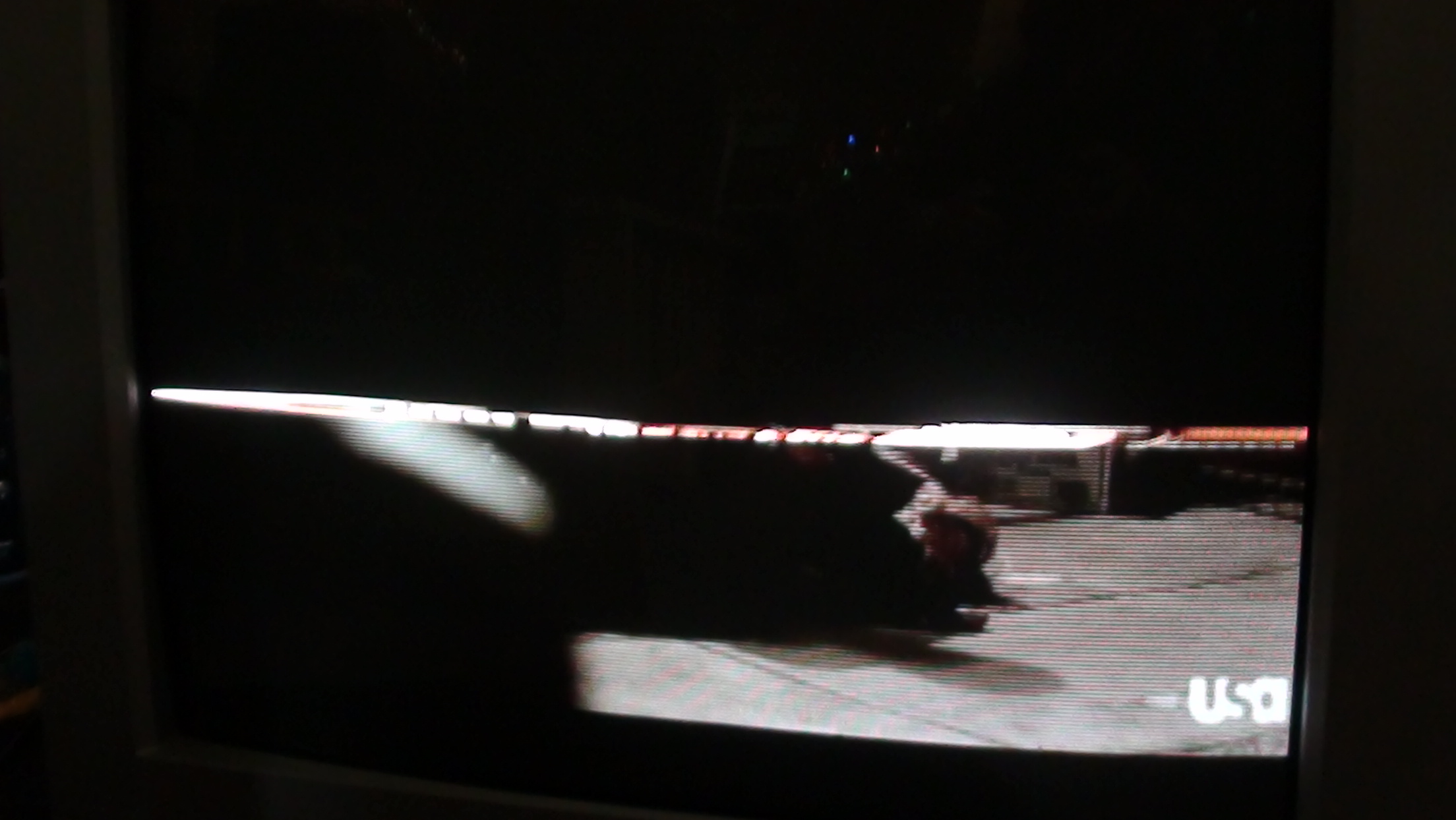

    Just got this TV a guy gave me. Said he was throwing it out and asked if I wanted it. I'm attaching a picture of what it does. Would this be a bad fly-back transformer? If not, any ideas what else might cause this? I looked at the capacitors and they didn't look bad. I did not test them with my ESR meter yet. I was reading on-line that if the horizontal lines where going across the top part of the screen, it could be a capacitor but because they're on the bottom too, I don't think it is.
    Thanks.

    Re: RCA 32V432T Possibly Bad Fly-Back Transformer?
    No your flyback is working. You have a picture.
    I'm seeing retrace lines and what looks like collapsed vertical. Start checking caps in the vertical section, and around the flyback.
    Also check for bad solder connections around the tuner, HOT, and vertical IC.

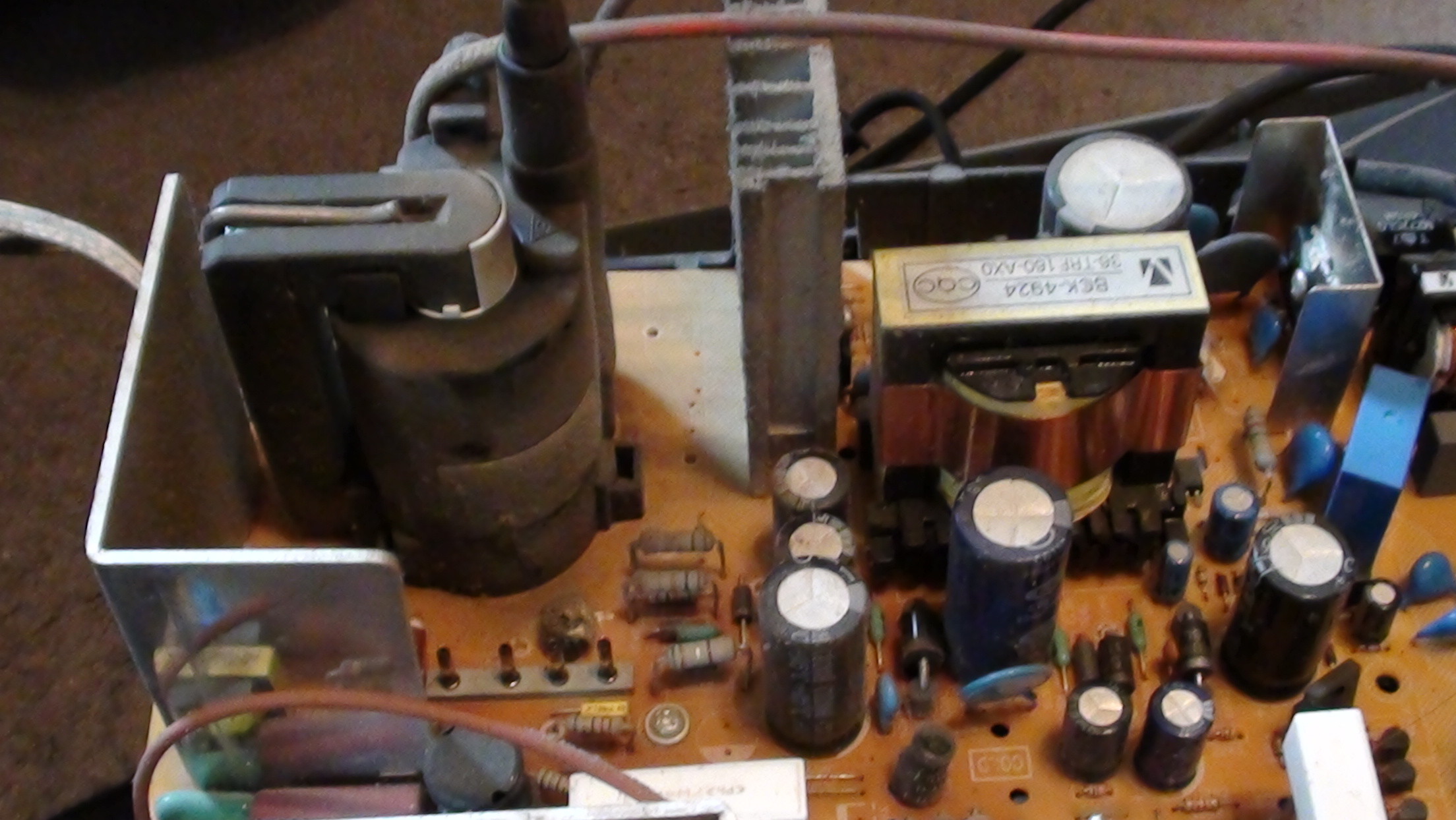

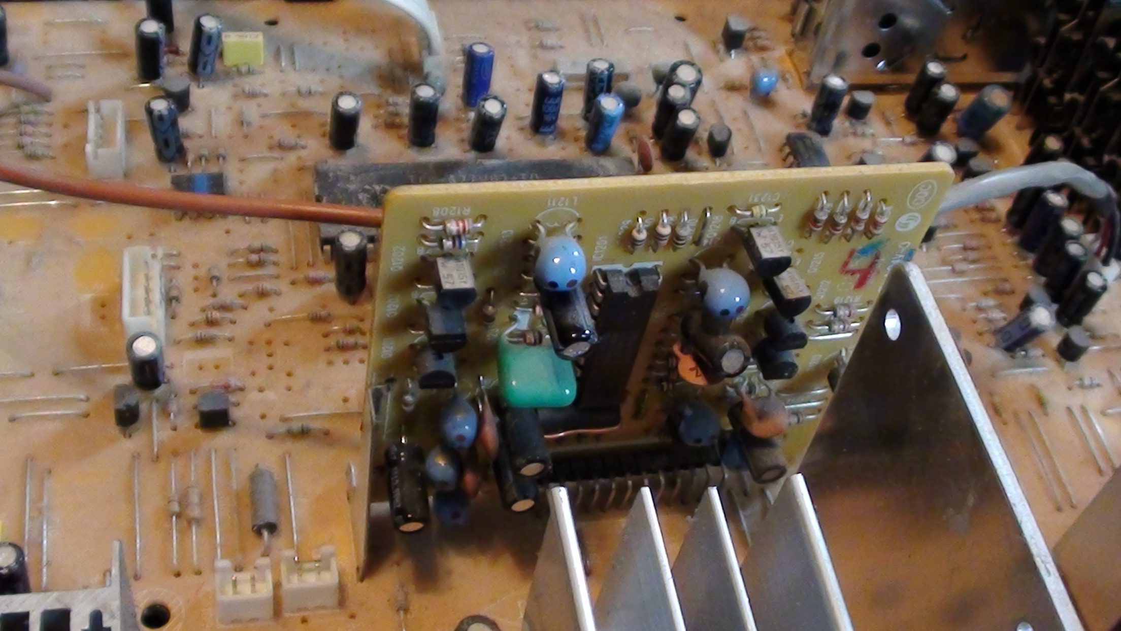

      Thanks for the reply. I don't know a lot about TVs. I will try and find a service manual. I think I know where the flyback is. I've attached a few pictures. I think it's the big black thing. I know where the tuner is. Not sure what a HOT is and I have no idea what IC is the vertical IC. I can easily see three ICs on the board. An 8-pin, 16-pin and a 64-pin. Thanks again for the help. I won't be back until around 8 or 9 tonight.
      Spork
      Last edited by Spork Schivago; 08-22-2013, 03:48 PM. Reason: Pictures didn't get added
      -- Law of Expanding Memory: Applications Will Also Expand Until RAM Is Full
        The vertical driver will be a big heatsinked IC which connects to the coils. It will be distinct from the HOT, which is near the flyback.
          I think your vertical IC is working because I see half a picture. Resoldering it wouldn't hurt though.
          I think you have bad caps in your vertical circuit.

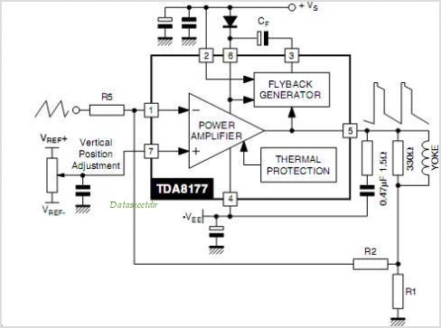

            attached is a schematic, note vertical ic is IC301 if you have a dvm post some voltage readings of IC301 using cold ground (ex:tuner shield) for your ground

                    I would check C302 (near IC301 TDA8177 vertical osc/op.), it sets the ramp linearity for the vertical oscillator. If the vertical problem changes a lot with brightness being turned up or down, it might be power supply weakness or the x-ray protection (C250/C251) activating - which can lead you on a goose chase...
                    Looking at IC301's pin DC voltages should help

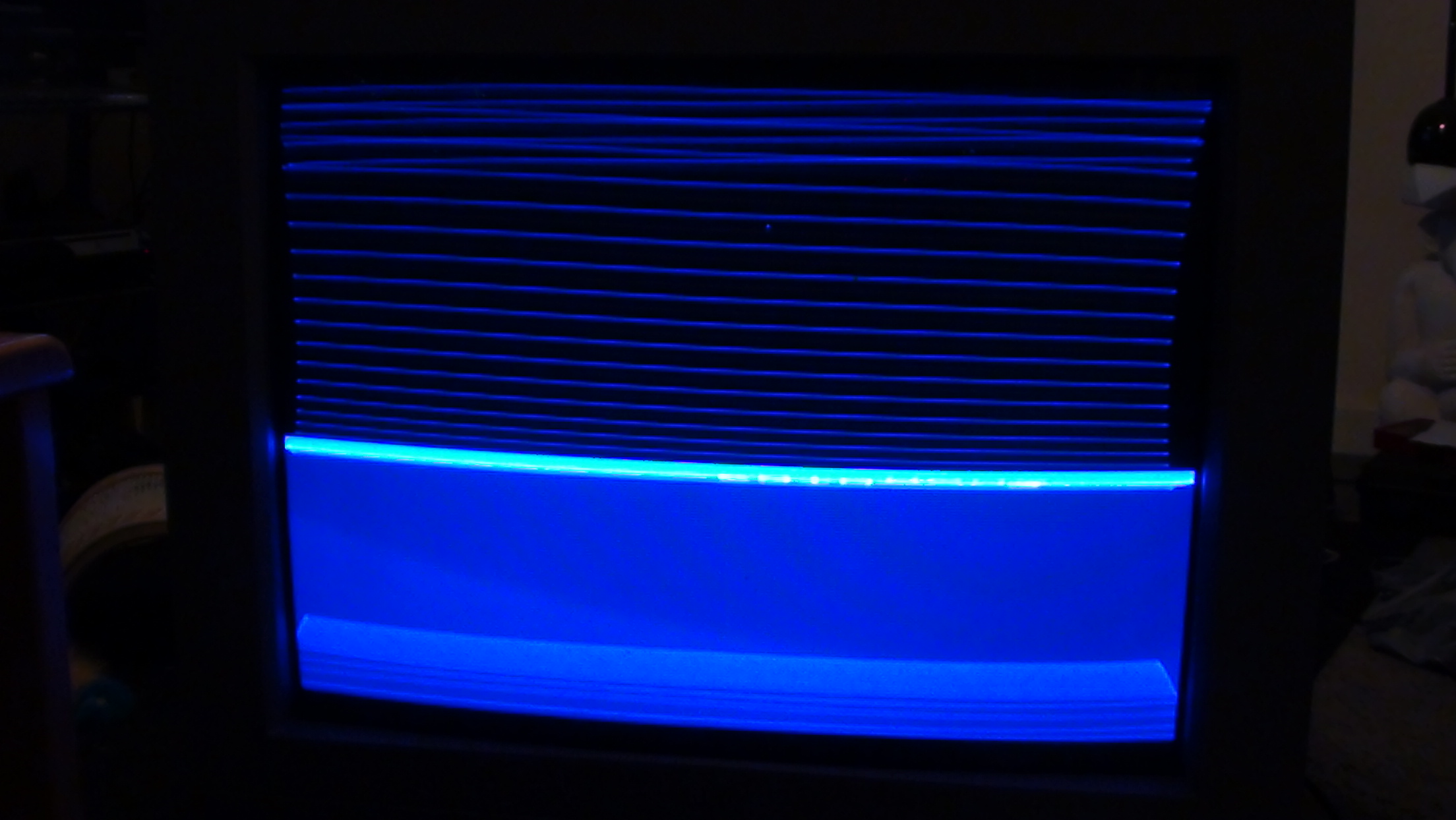

                        I found a 4.7μF cap from Radio Shack in a mixed cap bag. I replaced C251 with the new cap and it didn't fix the problem. I do believe the screen looks different now. There's still an issue some wheres else though. Should I post a picture of what it looks like now? I still see some retrace lines.

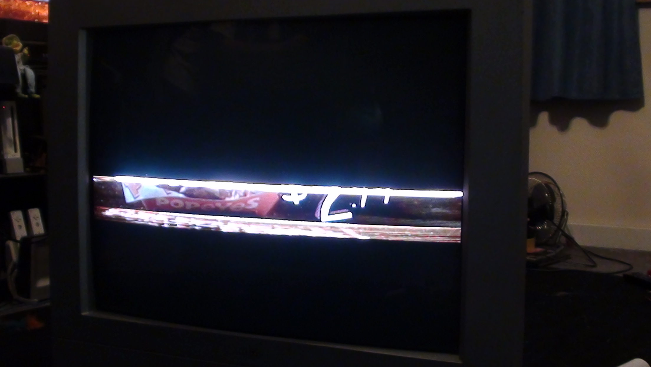

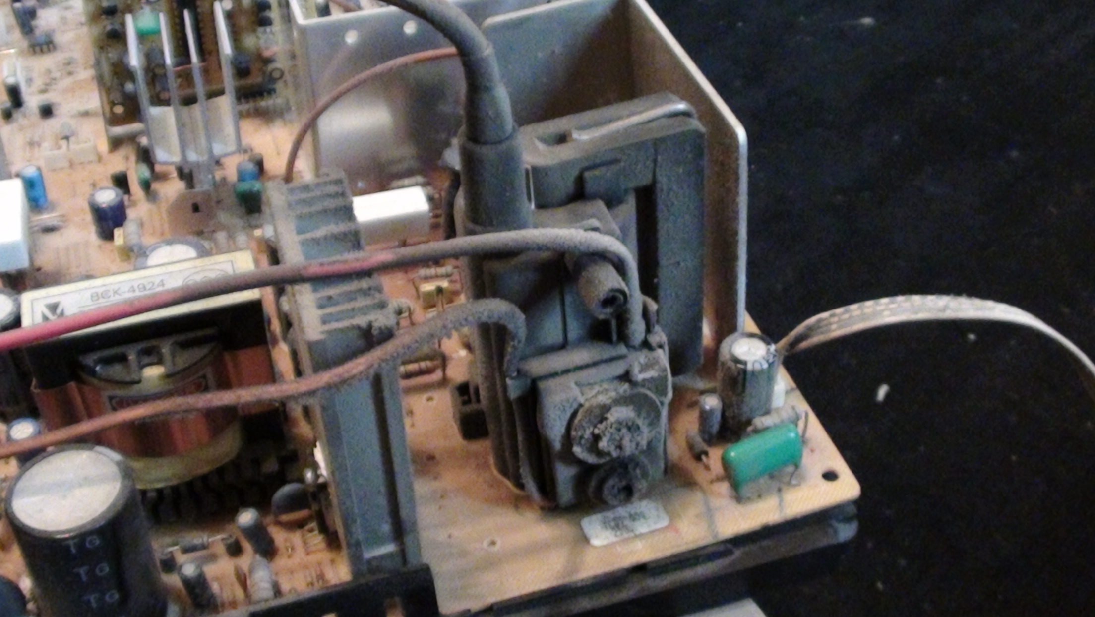

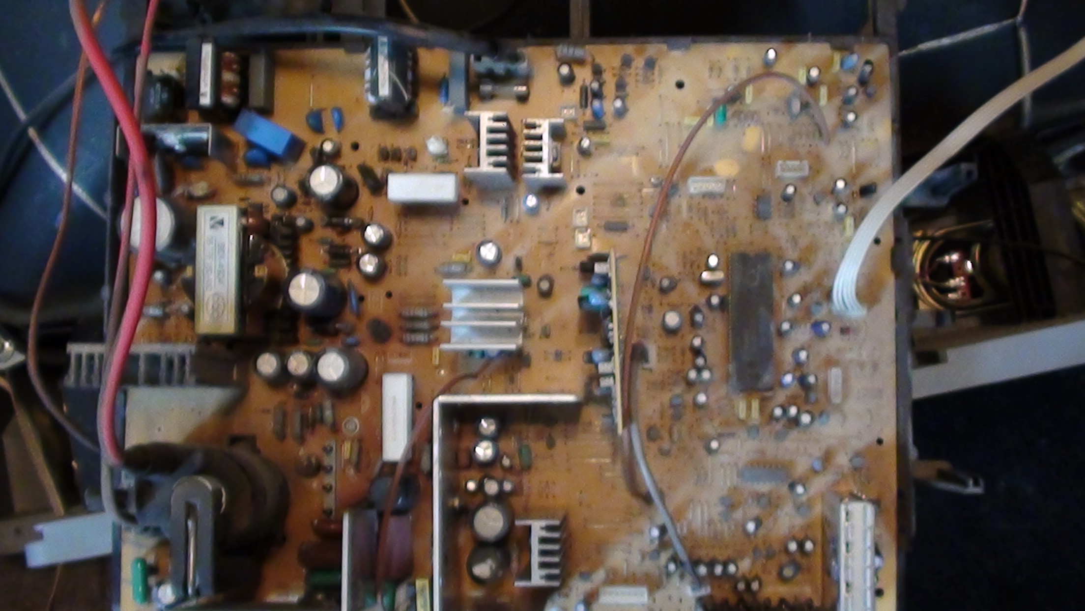

                          Here's some new pictures of what's happening now. Before I turned the TV right side up, I tried using a mirror to look underneath it to see if it was fixed and I believe I still saw some retrace lines. After turning it right side up, they appear to be gone. Not sure if that's because there's a bad solder joint some wheres or if it just needed to warm up a little or what.
                            Originally posted by redwire
                            If the vertical problem changes a lot with brightness being turned up or down, it might be ...
                            The problem does not change with the brightness being turned up or down.

                              yes another image please,also from looking at those last voltage reading you posted,those readings look very good,this chassis which is most likely a M134 is prone for eeprom corruption causing this vertical issue your having from the first picture you posted in your #1 post.IC001 is the eeprom ,also this chassis does use two different types eeprom, you would need to search for that using the complete model number (Example:32V432Tyx5) most of the new RCA eeprom already come preprogrammed,but there might be some minor changes possible for either slightly under scan vertical and horz which you would need the the alignment data information on how to access those parameters which I can provide if you need them.

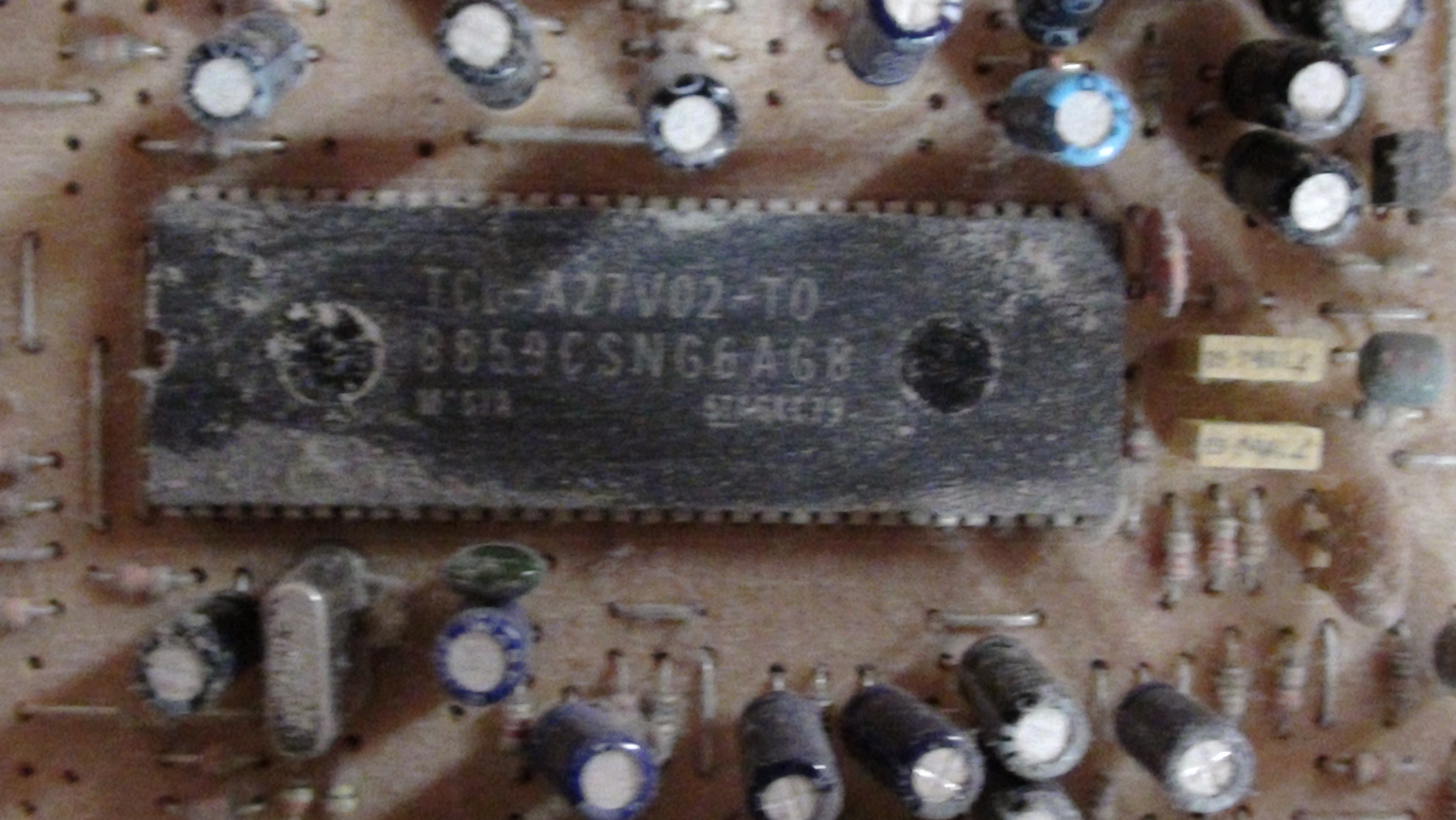

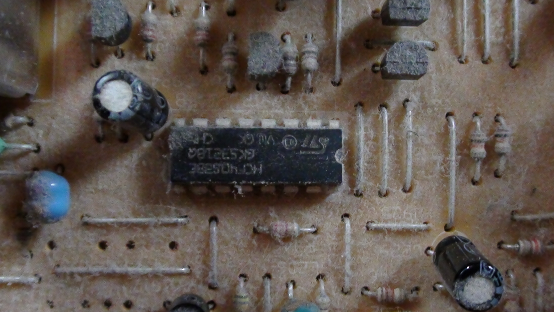

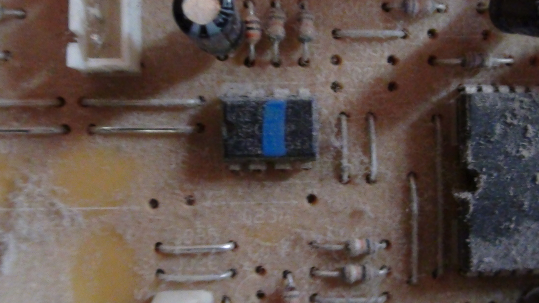

                                OK now from those additional images I would have to say eeprom corruption of adjustment parameters of vertical height,vertical linearity
                                Also Caution !!!! do not play for long periods with that collapsed vertical issue unless you reduce the G2 down to barely low visibility of issue on screen or you will have a phosphorous burn of that reduced vertical etched into crt

                                  Hello and thank you. It's definitely 32V432Tyx5 for the model number and the chassis is M134C. Where's a good place to get one of these eeproms from? I cannot seem to find one on E-Bay or Google. I typed 32v432Tyx5 eeprom. Any other suggestions?
                                  Also, we don't have much money. That's why we fix stuff like this and try to sell it. We usually give the cash to my parents to help them with their taxes on their house and stuff, however, because it's a bigger TV, I think I'm going to give the TV to my mum. Any idea how much it'll cost? Probably no more than 20$, right? Thanks.

                                    I'm not so sure the EEPROM's corrupt. You changed out a cap and got a very different image. And were I to hazard a guess, if there's one bad cap, there's probably more.
                                    I'm just going by the number of TV's I've fixed with vertical issues similar to yours. Are there any other caps in the area you can check?
                                    And actually your meter is fine. You need to test out of circuit. Remove the caps one at a time and test out of circuit. Replace any that test low or have high ESR. Then if the image is still messed up, look into getting an eeprom chip.
