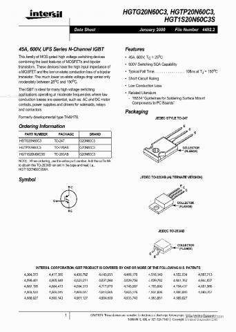

                    looks like q102 20N60C3 maybe faulty short circuit on 2 legs leads tested both ways

                        tom can you look at my edit please shot circuit both ways pins 2/3 and the 3/2 on diode test it has a insulation washer on the heatsink on this ic.

                            what do you think of these readings? looks like q102 20N60C3 maybe faulty short circuit on 2 legs leads tested both ways pins 2/3 and the 3/2 on diode test it has a insulation washer on the heatsink on this ic. data sheet in post 10 cheers tom. the last thing i am not sure is what a 7503 is its like a small rectangular resistor 2 of them by the ic thats blown cant seem to get a reading from them.

                                  It seems unlikely that a 32" LCD TV would use a 45A IGBT. That is something you would put in an industrial motor drive or 1000W+ power supply. Are you sure about the part #?
                                    Re: Baird x32dtv
                                    q102 in this parts list

                                        more than likely yes this out of circuit is short on diode test pins 2 and 3 both directions is this good or bad?
