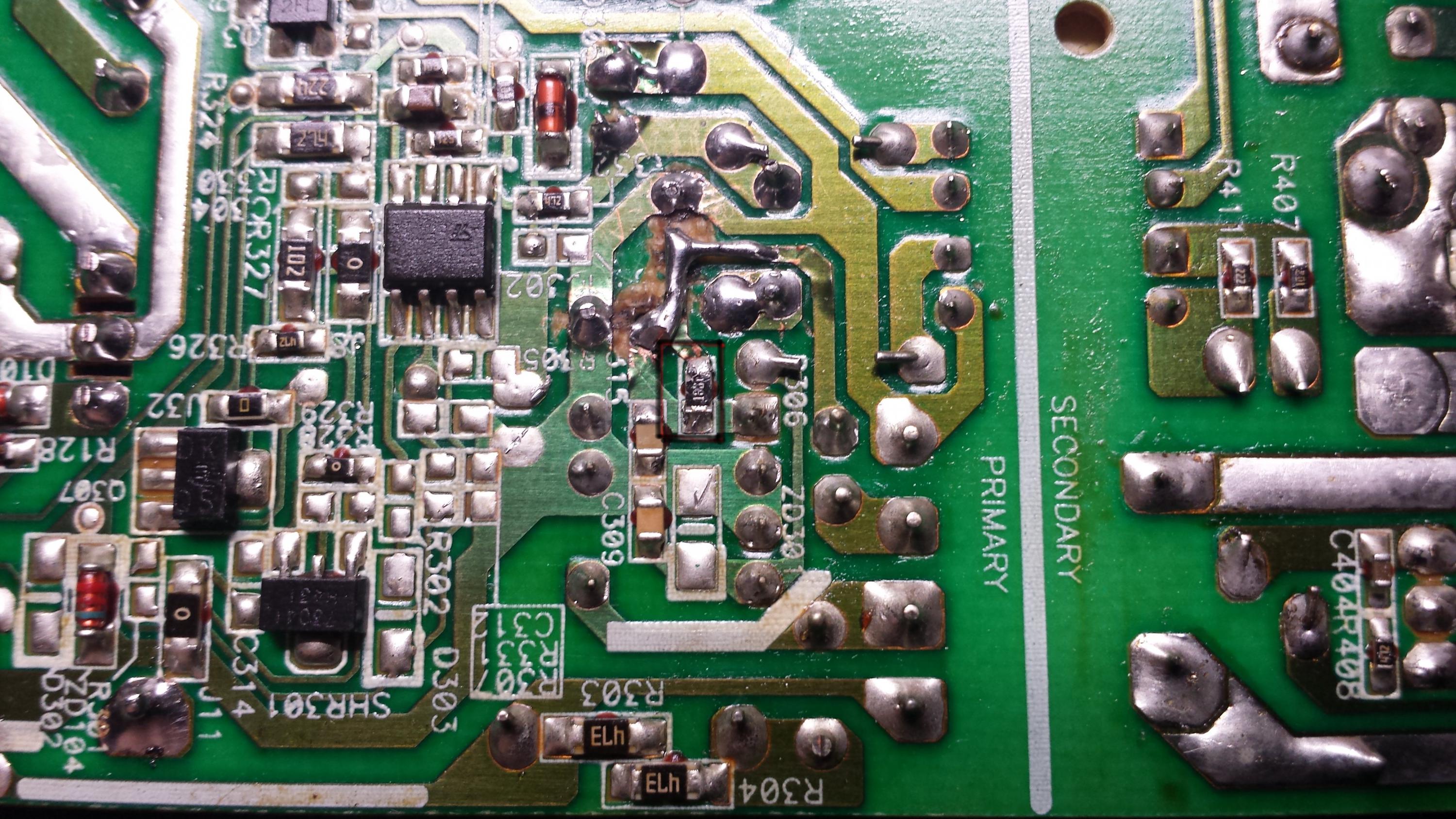

                    • ronan7
                      • Jul 2014
                      • Ireland
                      #50
                      Re: Baird x32dtv
                      Hi guys,
                      I have PHIHONG MODEL PSM210-417A-R powersupply now for fix with Wharfedale LCD set and somebody totally destroyed pcb around 5V stby area when tried to repair it before I got TV.
                      Would by anyone able to provide picture of bottom side of the pcb please?
                      On my board traces around IC 301 were damaged see attached picture and as there is no schematics I am not shure how everything is connected.
                      One smt resistor marked in picture has 0 Ohm and can't see value so please help identify if possible.
                      C307,C308 and C311 was also replaced and need those just confirm for value as well.I have now installed C307-470uF 25V , C308 and C311-470uF 16V on front side of the board.
                      Your help would be much appreciated guys.
                      Thanks for any answer
