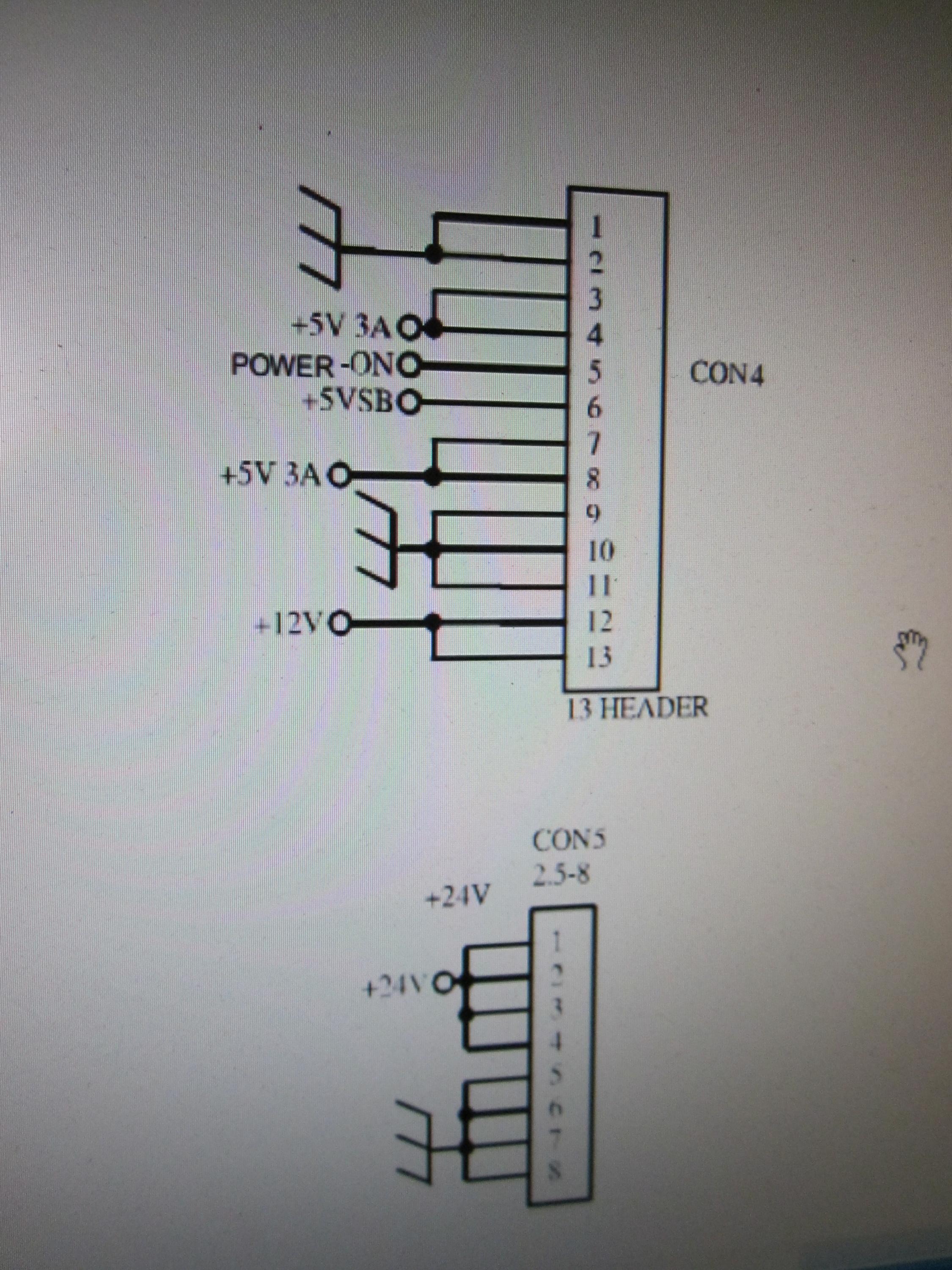

            will give it a shot thanks tom on these boards mlt 668 have two sockets that i can connect the 24 volt to inverter plugs connector 3 or 5 i have added the scheme.

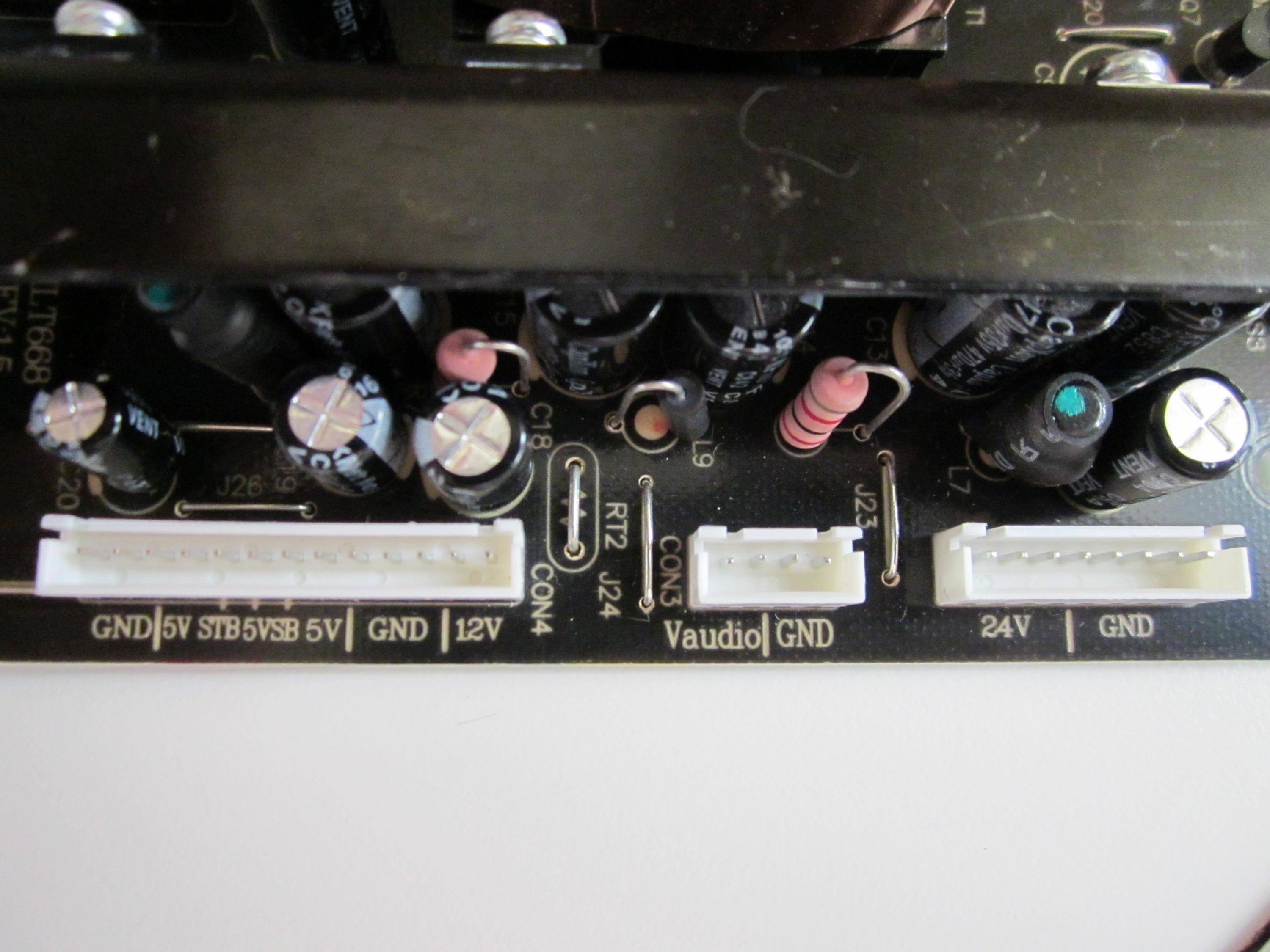

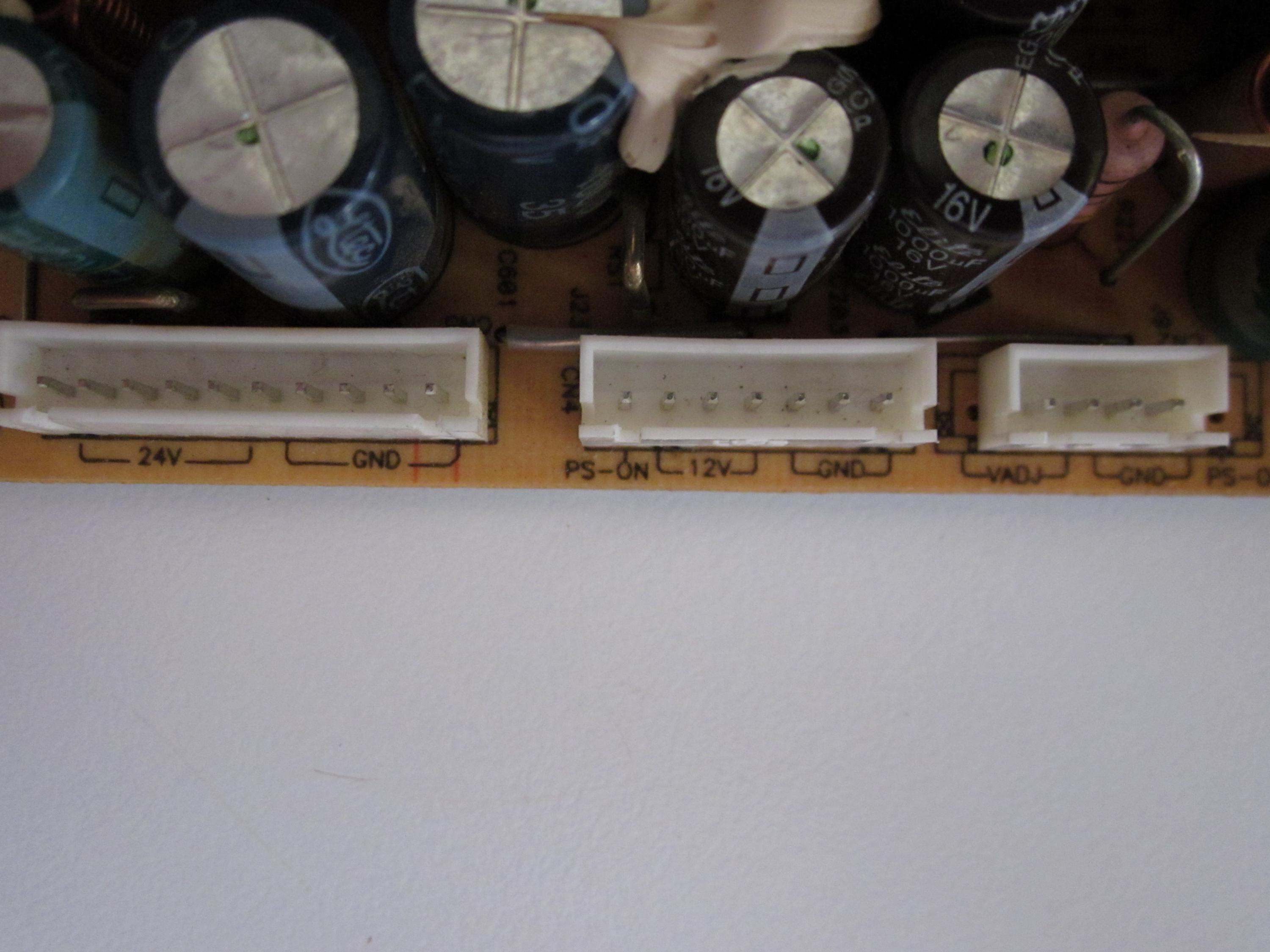

              the mlt 668 has just turned up i am just stuck on one wire as in where to put it the old psu has a pin marked ps-on with no voltage indicator the new psu does not have ps-on but it has 5v stb 5vstb 5v as i am only stuck on which wire to connect the ps-on wire to can you help?
                Re: Baird x32dtv
                Is there a pin marked STBY or REMOTE? A listing of all pins you are trying to translate would help.

                  Re: Baird x32dtv
                  in the pdf post 25 on con 4 i think it maybe number 5 i need to connect it to on the old psu its only marked as ps-on cheers tom

                    Re: Baird x32dtv
                    two pictures tom to go with the pdf left pic new psu right pic old psu.
                      #30
                      Re: Baird x32dtv
                      The PSON pin = STB pin.

                        Re: Baird x32dtv
                        just added new pic cheers tom appreciated will recap the new psu if it works out.

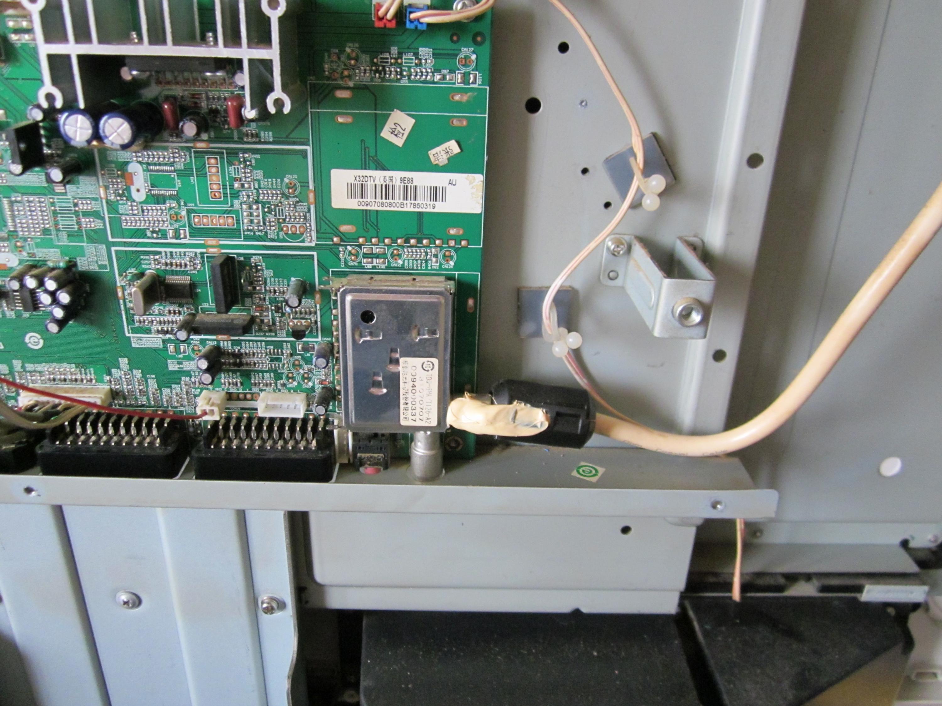

                          tom thanks for you advice tv works great with the mlt668 even the psu all four screw mountings lined up no problems a question should this be freeview? does have dvb tuner board in but could it be analogue not digital as keeps saying no signal even with good aeriel in.

                            Re: Baird x32dtv
                            What does the DVB tuner board look like?
                            Done a complete reset & retune?

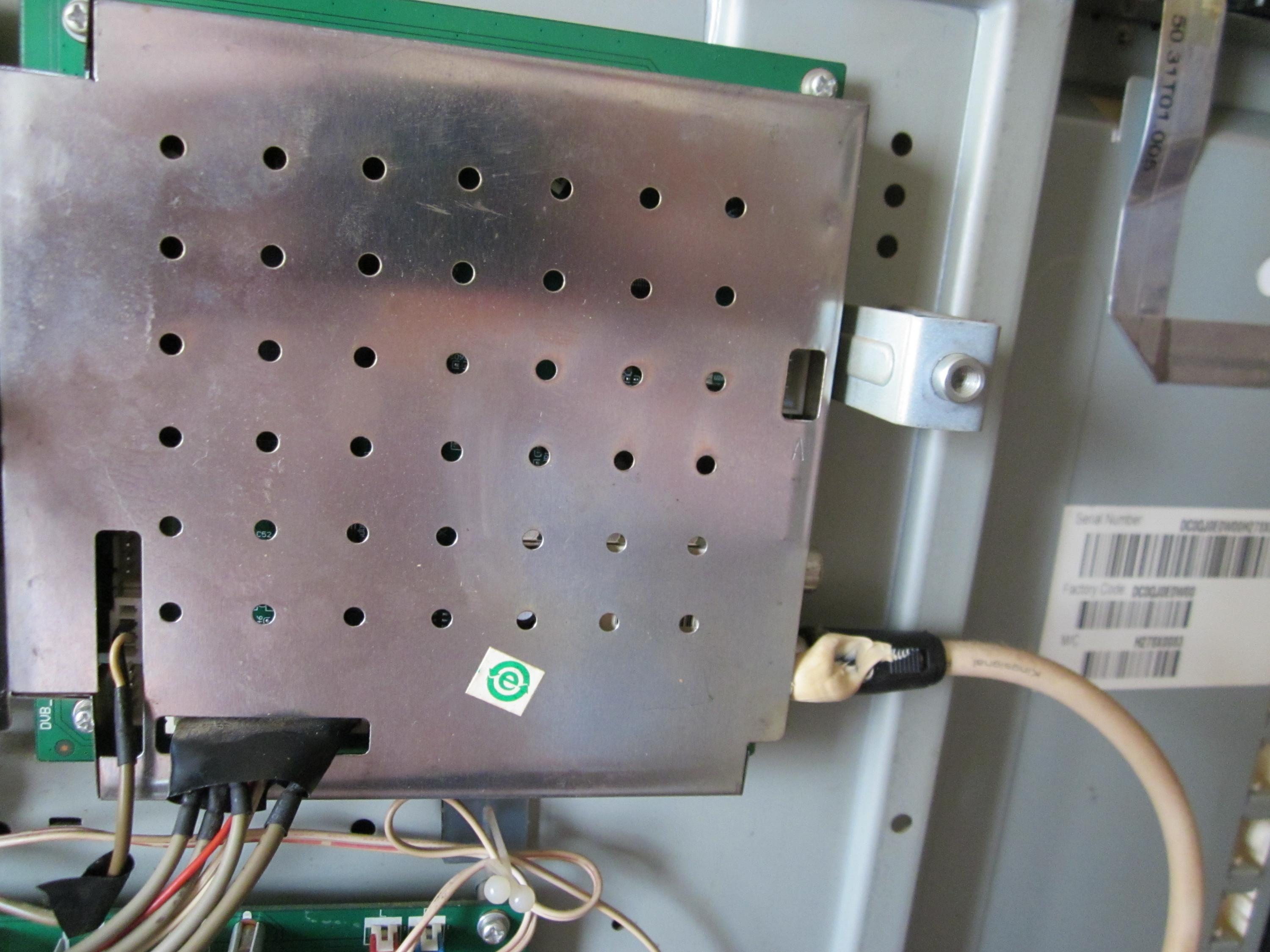

                              Re: Baird x32dtv
                              says on it dvb-t the aeriel socket on main board connected by a lead to dvb-t board
                              looks like analouge http://en.wikipedia.org/wiki/DVB-T
                                #35
                                Re: Baird x32dtv
                                DVB-T is digital freeview.
                                Does the set have a PCIMIA slot? For CI card?
                                Maybe you are on "analogue" mode and need to switch to digital... on some sets this is only possible with the remote control.

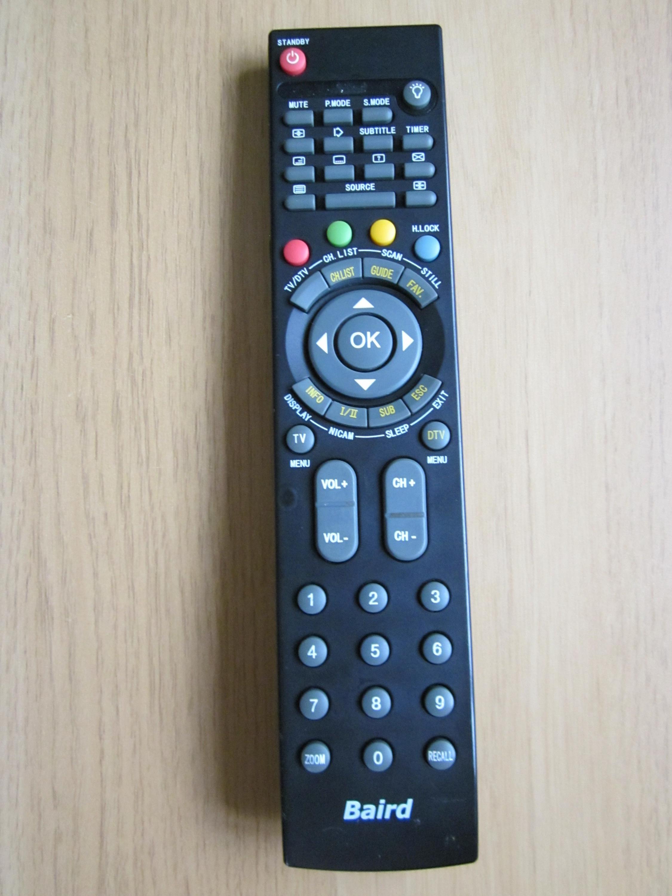

                                      i have the original remote control for the set which one key says dtv menu on it which does not work every other key on the remote does i have stripped the remote and cleaned it key does still not work i have cleaned a bit of trace on each side of the pad on the remote and linked with a bit of wire still does not make led on tv flash when i link any other pad it does flash and change channel etc i can get into dtv by the fav key ant then scroll through channels etc as in 103 itv2 etc still says no signal but may need re tuning as on my freeview box channel 38 is quest this set is bid tv on 38 so not sure. linking out the trace should of got me into the dtv menu but did not? maybe order another remote the analogue tuner searches ok just this issue with dtv.

                                        Re: Baird x32dtv
                                        On the old board there was 2 vadj pins 12v and 2 grounds where did u attach this?

                                          Re: Baird x32dtv
                                          do the vadj pins go to the audio on the main board was supposed to be 16.5 volts if i remember
