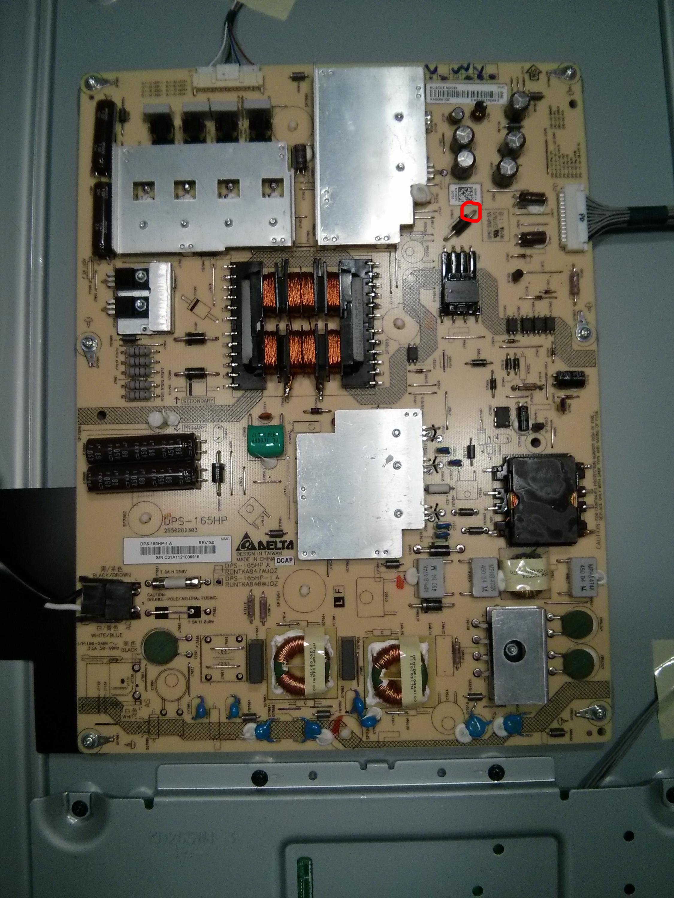

    I've got a Sharp Aquos LC-60LE633U LCD TV that all of the sudden will not turn on anymore. The TV shows no lights or anything when it's plugged in and the power button won't do anything.
    I've taken it apart and checked the fuses and the power cord and looked for any bad caps or burn marks but nothing. I have attached a picture of the power supply board.

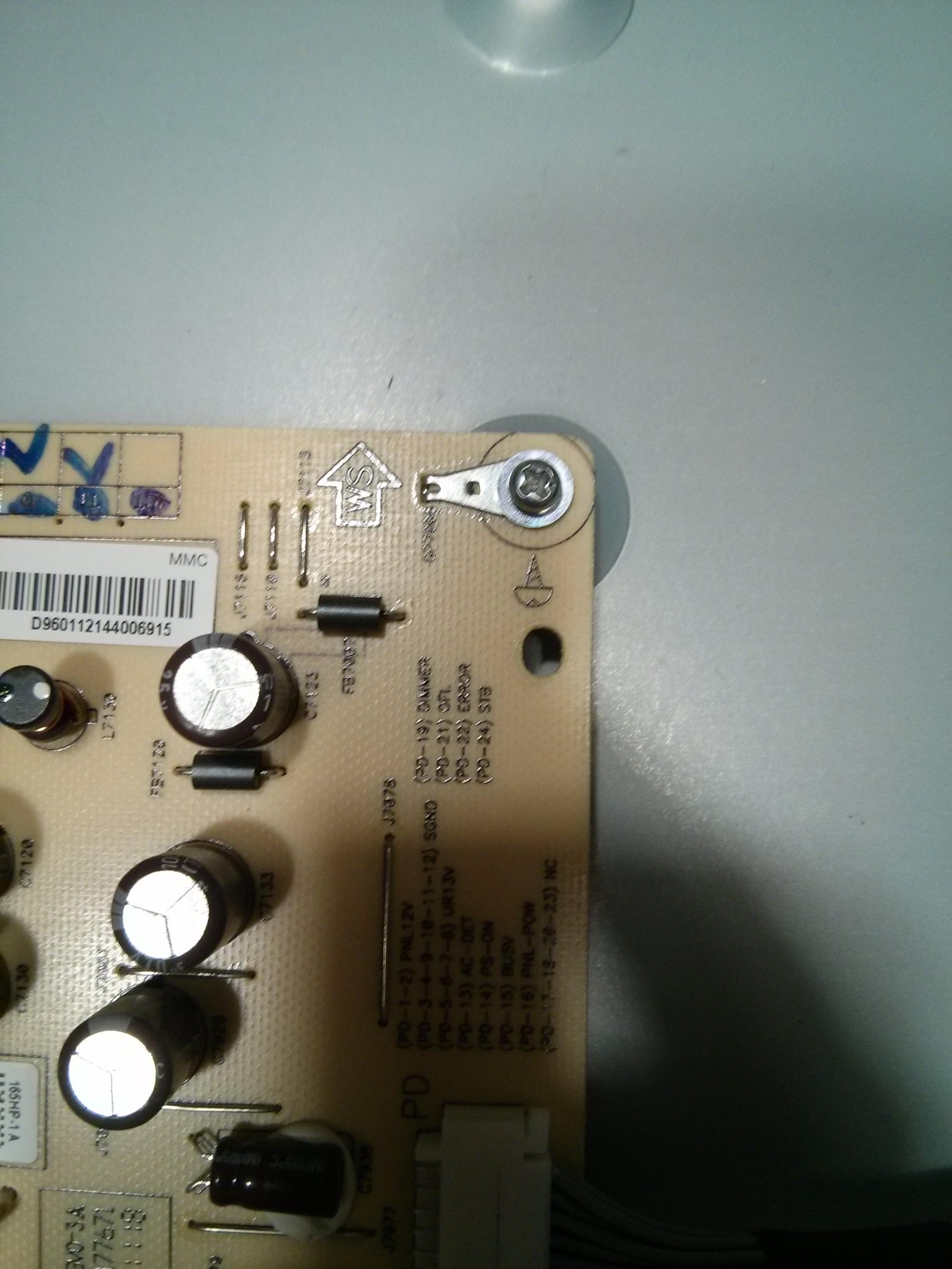

        I measured the voltage across the two caps above the power plug and got almost nothing, they both measure about 0.262VAC across the legs of the caps.
        Here's a close up of the power connector on the top corner of the board.
          Re: Sharp Aquos LC-60LE633U won't turn on, no lights
          For those please use volt DC range.
              What voltage do you see here? Red probe on marked point, black probe on the chassis.
              • pmontone
                • Aug 2013
                • 21
                Basically nothing .001 VDC. I was just checking that with my diode checkr on my meter and it looks as it may be bad. I get my meter to buzz on both directions of the diode.
                  Remove it to confirm, but you may have found the fault.

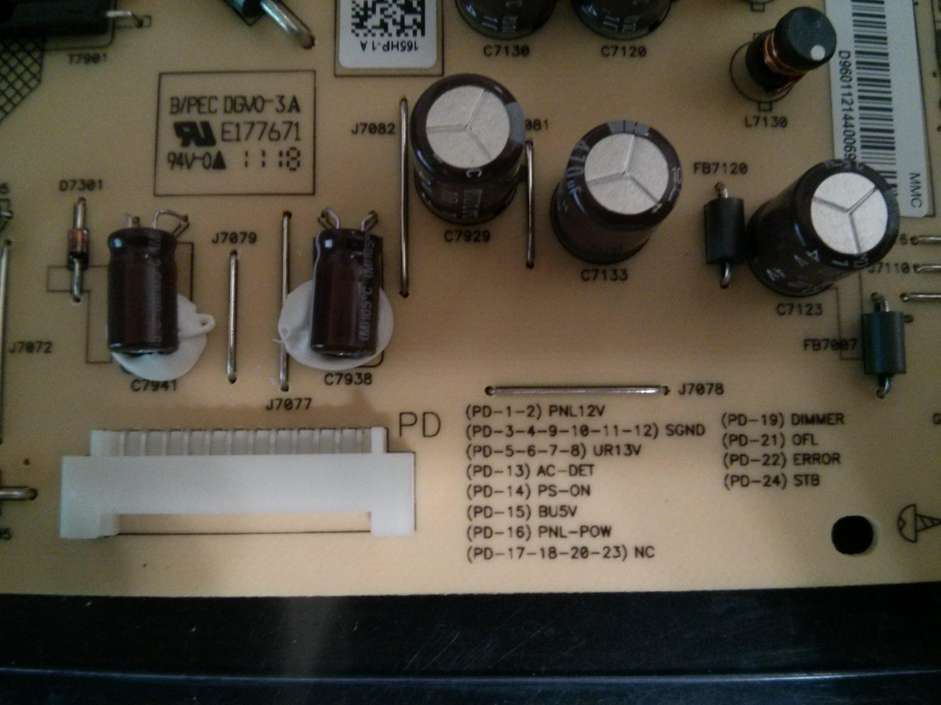

                      OK, along the connector from the power supply to main board, what do you see on each pin?
                      • pmontone
                        • Aug 2013
                        • 21
                        Everything is dead except for pin 15, it has 5.06VDC on it.
                        • pmontone
                          • Aug 2013
                          • 21
                          Here is a better picture of the power supply connector.

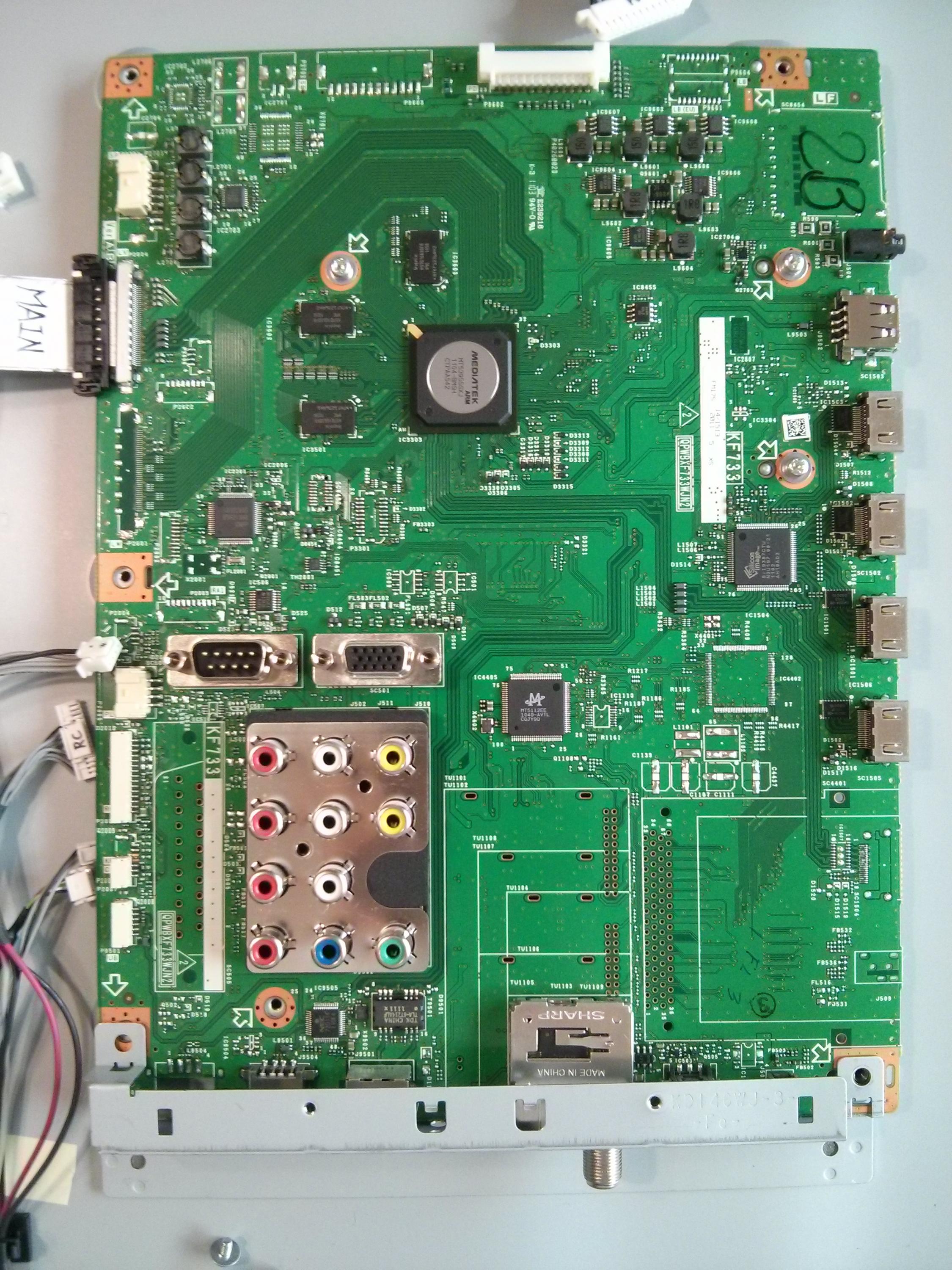

                            OK, the main board is getting 5V, but it is not doing anything. Time to look at main board, this is the board with video inputs on it. Please supply a picture of it.
                            • pmontone
                              • Aug 2013
                              • 21
                              Here is the main board.
                                Service manual available here
                                Can you provide a close shot around the connector from the power board on the main board?
                                I think the only option will be to replace the main board, detailed schematics not available unfortunately.

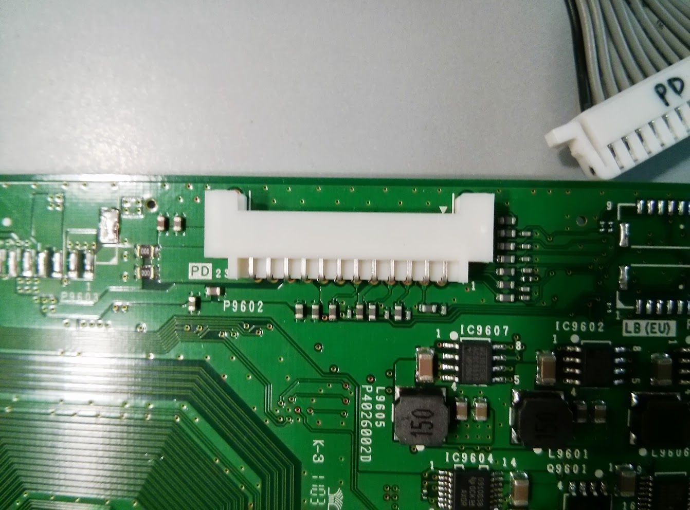

                                  Wait sorry this is the wrong one let me upload the right connector
                                  • pmontone
                                    • Aug 2013
                                    • 21
                                    Here is the connector to the power board.
                                      I was hoping to see fuses, but I don't see any.
