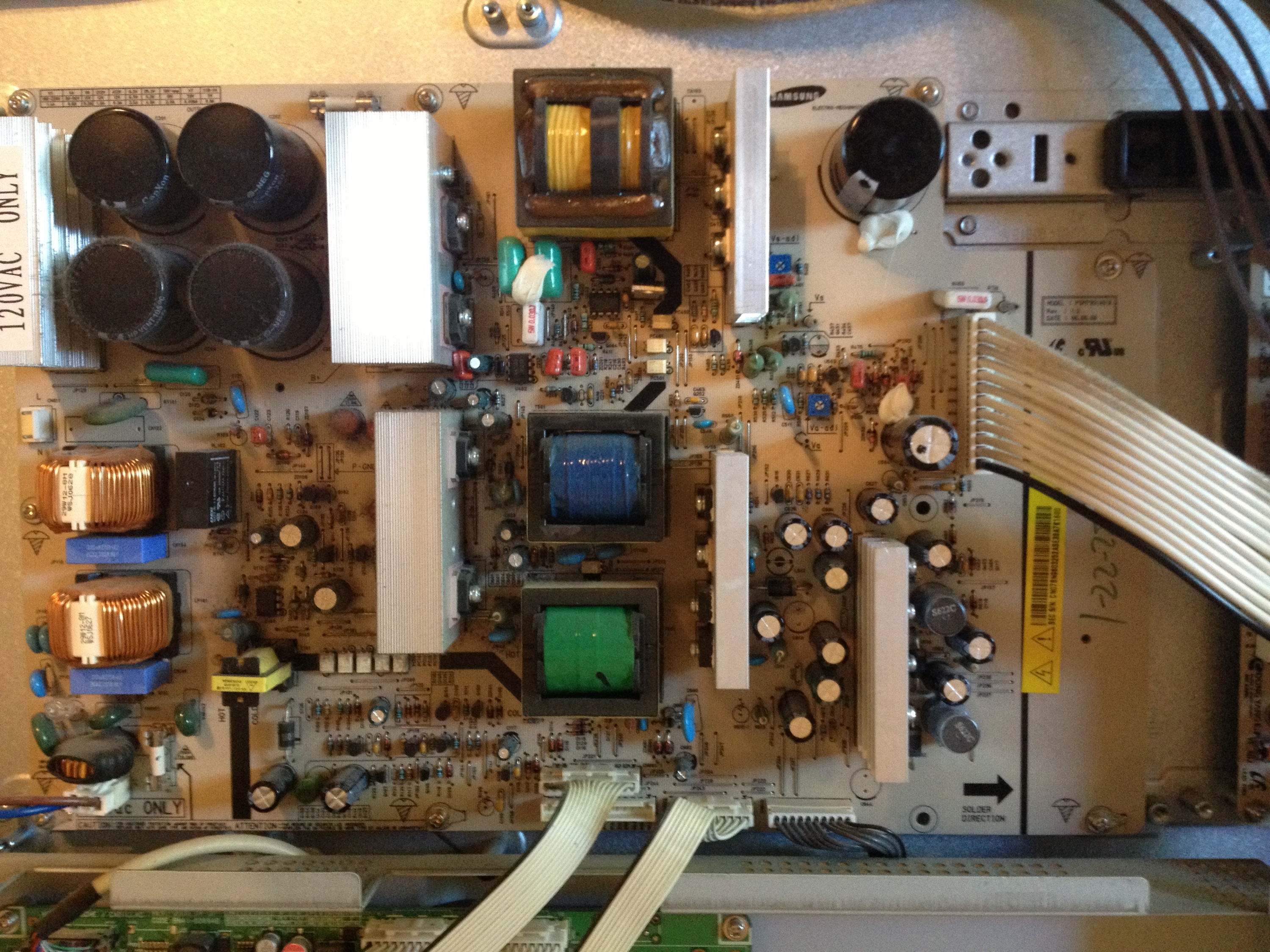

        Re: Samsung HP-S4253 - 5 seconds to black
        Please post a picture with the power supply board.

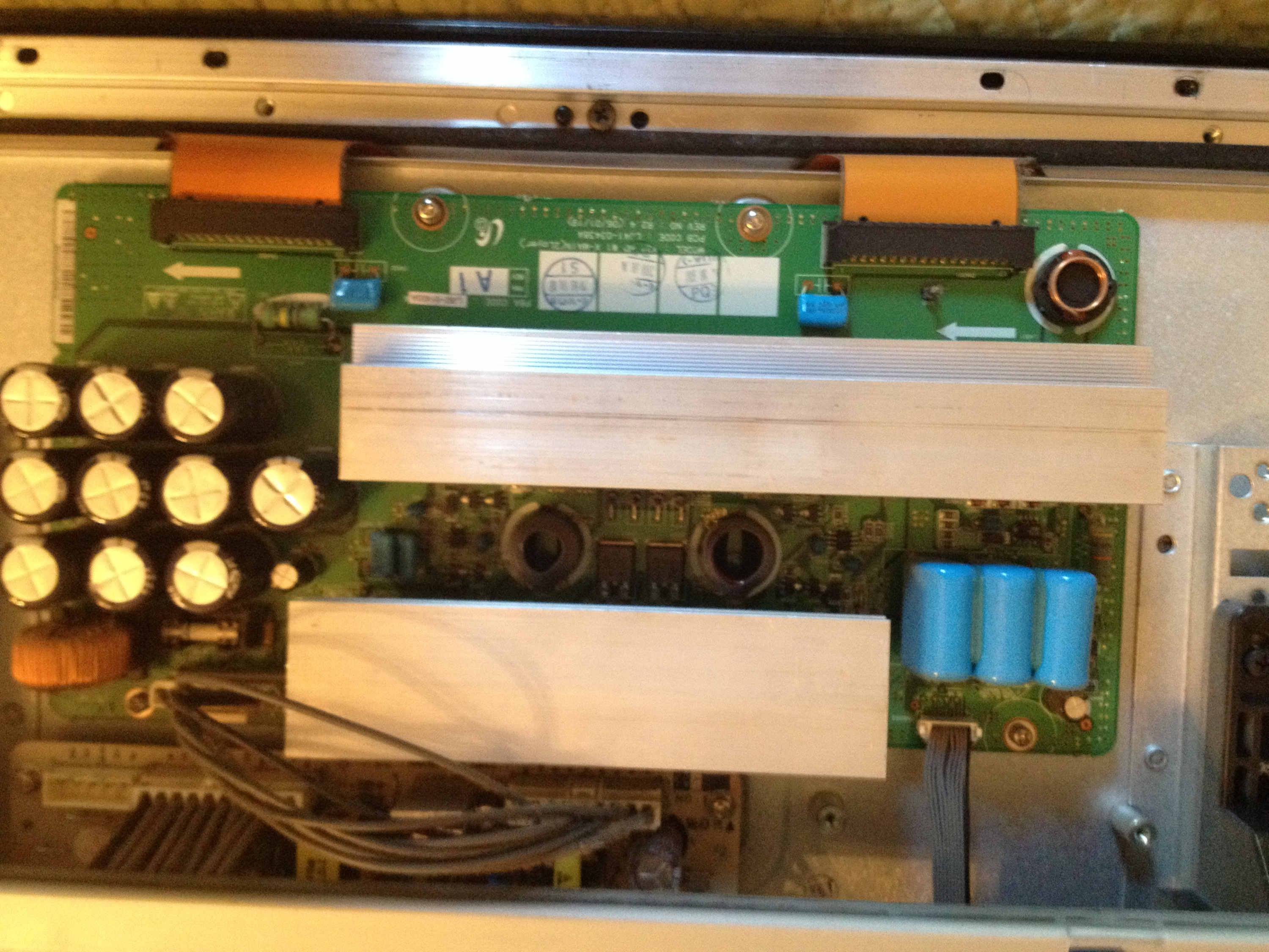

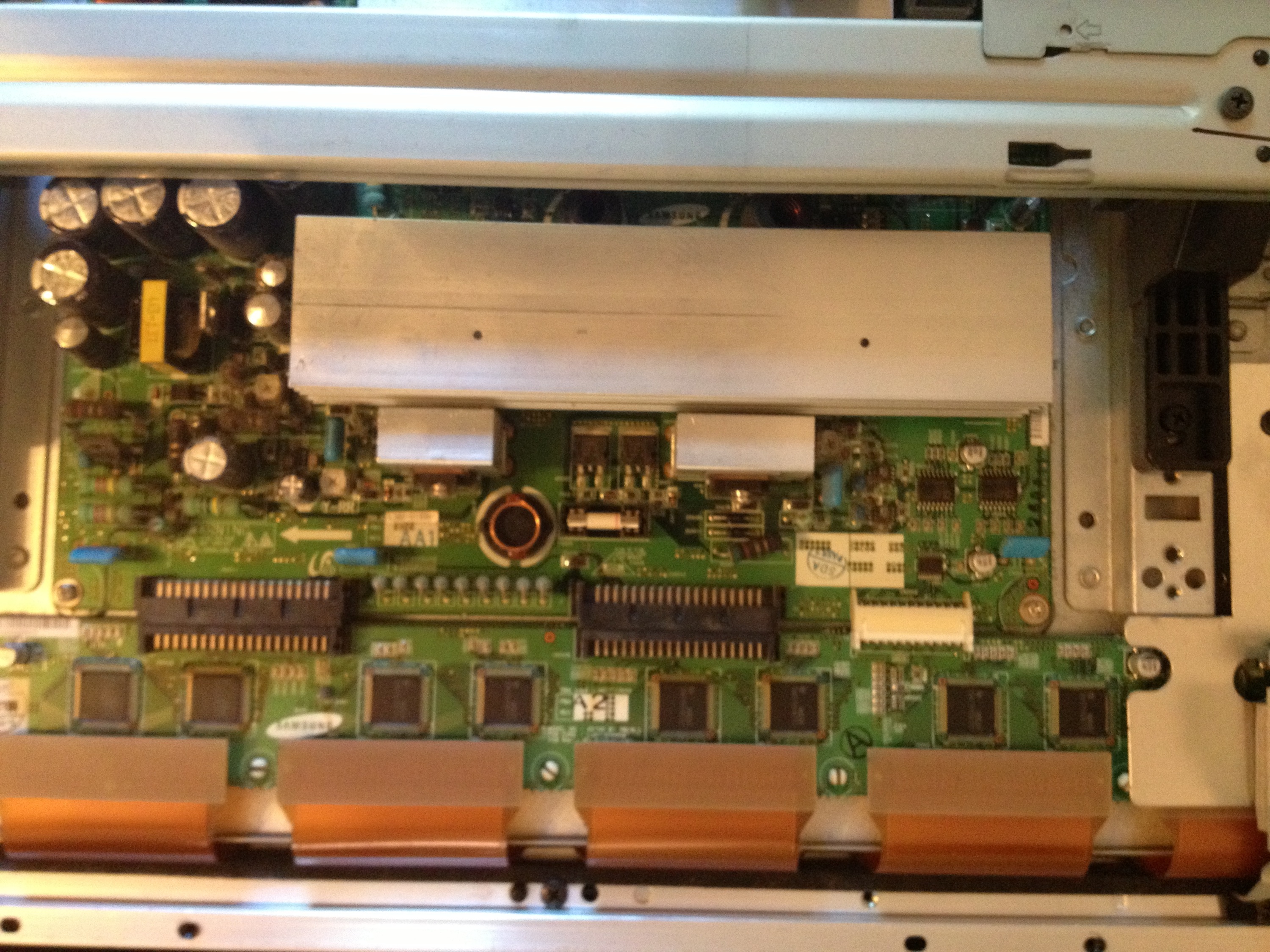

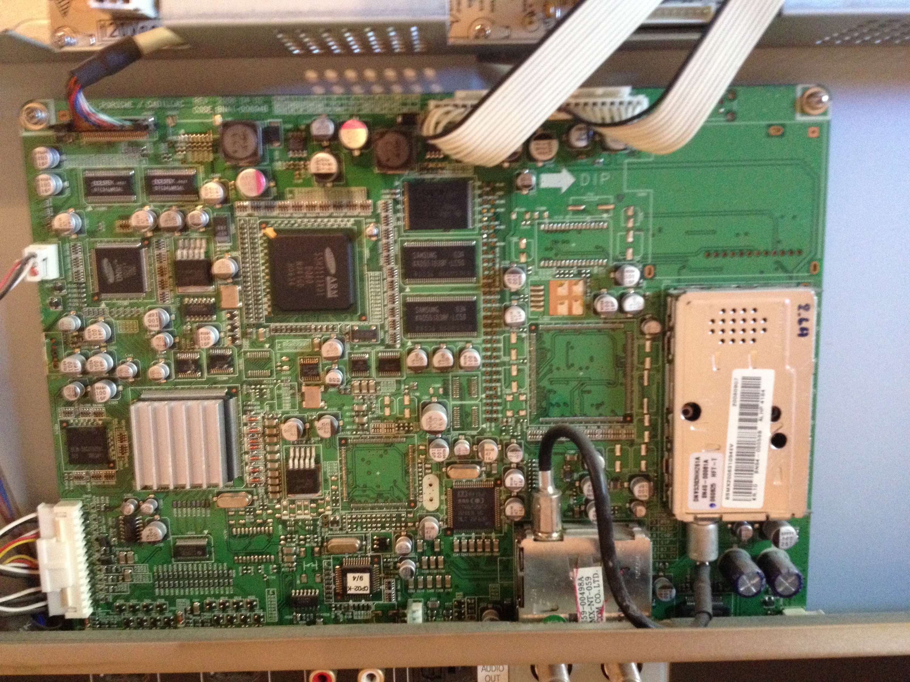

              Originally posted by tom66
              By fade out, do you mean a sudden loss of picture, or does it visibly reduce in brightness as it goes?
              First of all, sorry for such a late response. I've been super busy lately.
              By fade out, I mean that the image does NOT just switch off, but rather it takes about half a second from full image to completely black. There is still audio, but not image at all.
              In order to narrow it down to just the tv set, I disconnected all other components (cable box, game box, dvd, antenna, etc.) and switched the set on. I quickly brought up the setup menu and it showed for about one second before it quickly faded to black as well.
              Attached are images of the boards inside. I don't know which one is the power supply board.
