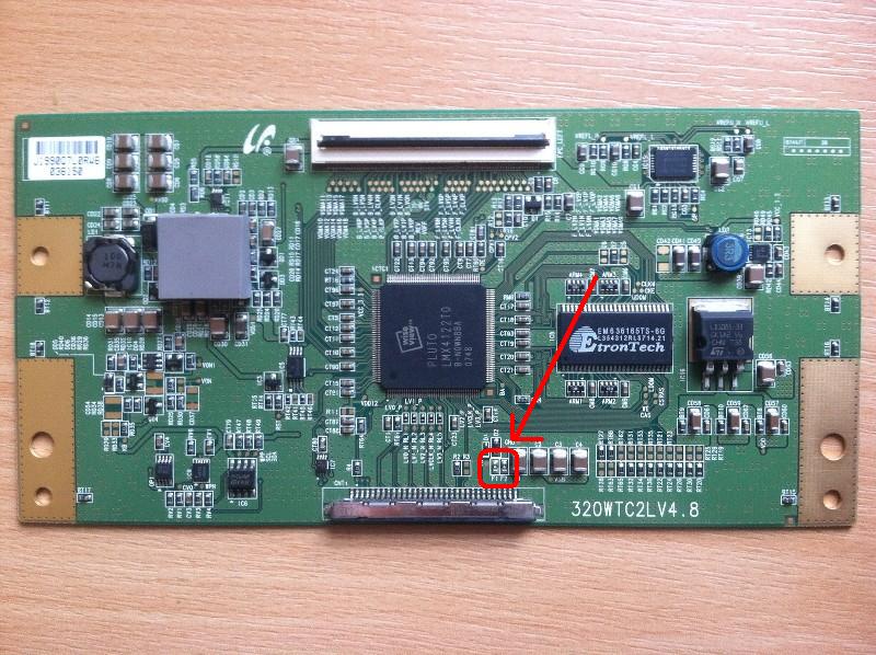

        Re: Samsung LE32R88BD sound but no picture
        The t-con is the small board that's located at the top of the panel. It should have its own fuse(s).
          Thanks, very helpful pic. I will check.

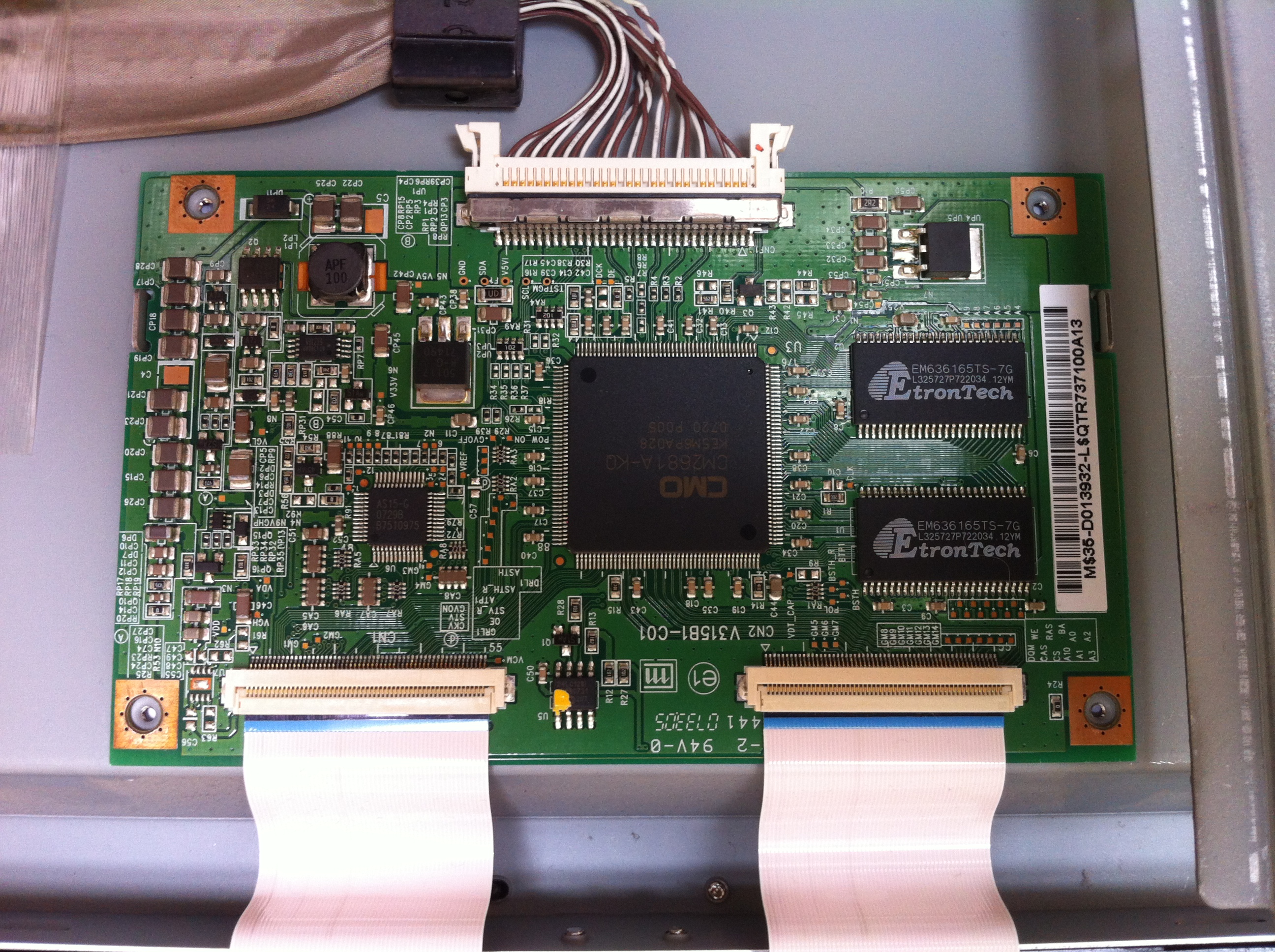

            I do not seem to be able to locate anything resembling a fuse on the t-con board. I might be missing it so I have uploaded a photo of board. Any suggestions would be welcomed. Thanks
              I see one at location "F1". It's at the right edge of the connector for the cable coming from the main board. It has "UD" inscribed on it.
                Yes, found it. Should this have voltage across it? If so, what voltage would I typically expect to find? And again, many thanks for your help.
                  Okay, I've just run some checks on fuse "UD". Measuring 5.1v to ground on one side of the fuse and 0v on the other-side. Also ran a continuity test on "UD" and it appears to be open-circuit. Is there any way I can safely temporarily bridge this fuse to check the board's function. Thanks
                    I believe you should be seeing something like 12V across the fuse, but I don't know for sure. Either way, your fuse is faulty. You can temporarily jumper the ends of the fuse with a piece of wire to test it.
                    A fuse I replaced on a Philips TV's t-con also had "UD" stamped on it. I replaced it with this fuse that was a little higher voltage: http://www.digikey.com/product-detai...5TR-ND/1206513
                    Edit: Instead of trying to remove the bad fuse and risking damage to the board, I just put the new one on top of the old one and soldered the ends of the fuse to the pad and old fuse.
