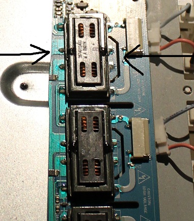

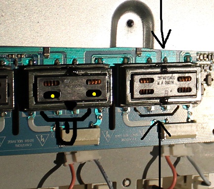

    just wondering if anyone can point me in the direction of this inverter transformer!
    board number- dac-24to42 rev-2c
    transformer number- 2874015400
    lcd parts don't have a comparable transformer and shopjimmy and ebay don't have the boards!

    Re: palsonic tftv815hd lcd inverter transformer!
    Try searching by LCD Panel model Number:
    CLAA320WF01U
    http://www.shopjimmy.com/dac-24t042d...t-inverter.htm
    The SJ photo is good enough to identify each component, maybe compare your board. Could be close.
    Sanyo LCD model LCD-32XR8DA may also have the same board/panel too.
    There may be a number of variants which may fit and do the same job.
    The transformer on the SJ board looks to be a different model but could be same size and pins. The PCB layout and components look much the same but check for yourself.
    http://www.ebay.com.au/itm/Inverter-...item3a6d29ee7f
    http://www.lcd-chip.com/ViewDetails10857.aspx
    If you look at this, shows same board as yours fitted to Dynex dx-lcd32-09. look at SJ and that link above also fitted to same model. Boards look the same different transformers used.
    http://www.usefulparts.com/tv-parts/...cd32-09-lcd-tv
      thanks tw, you have done it again!
      lcd-chip have the transformer! woo hoo!
      now i can finally finish another one that is laying around!
      fyi, the sony one wouldn't work, almost double the resistance, but i do enjoy the researching!
      thanks again!
