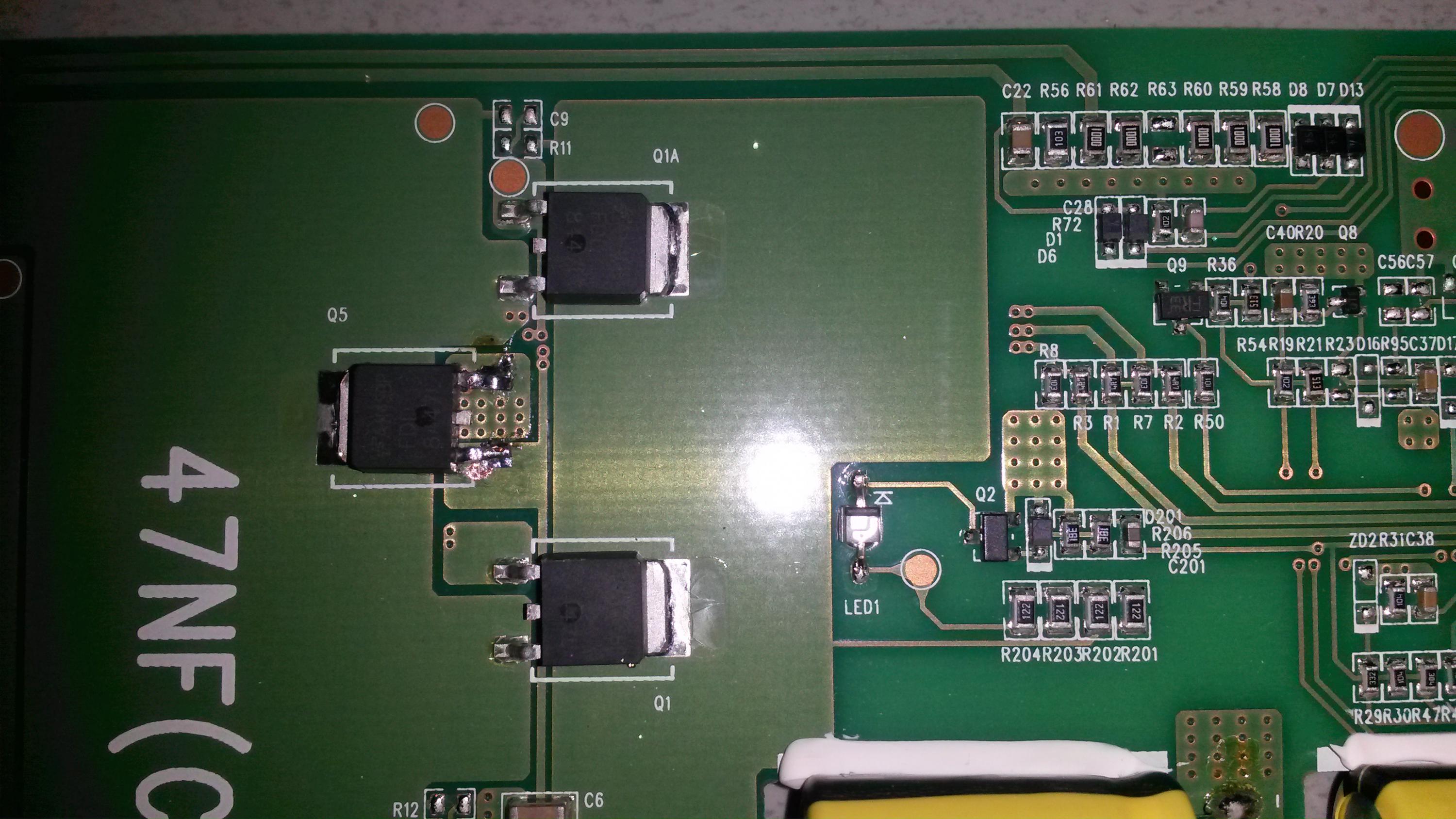

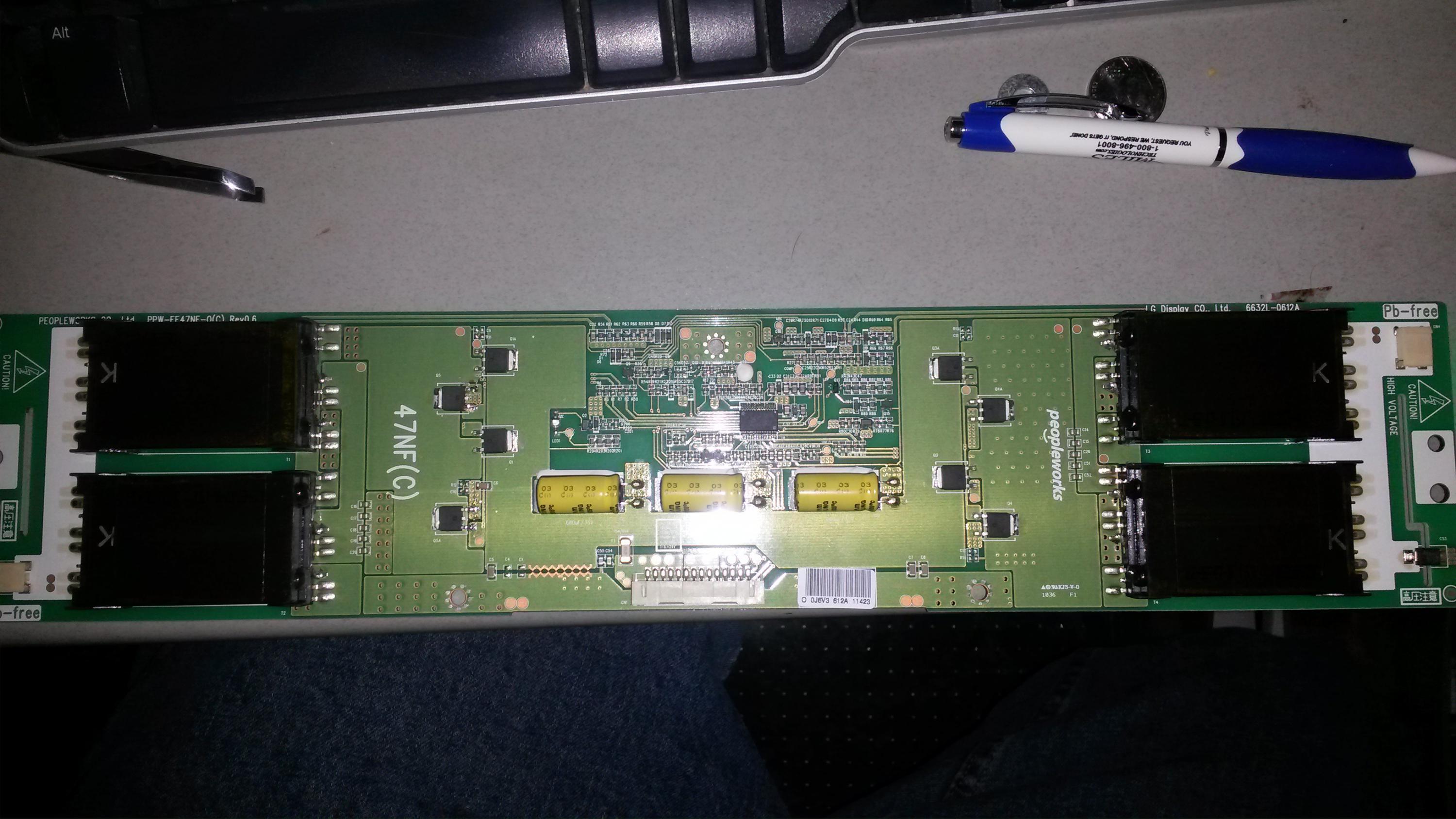

                    I just picked one up, same issue, and it looks like the inverter board is bad. No 24 or 12 V, pulled the cable from the inverter board, voltages came back. Found a shorted device, Q5 on the board. Trying to find a replacement.
                    Anyone have schematics for the inverter board? I'm trying to find information on it. The
                    device is AK45BP or AK458P. Looks like maybe from fairchild. Nothing on google anywhere.

                      Picture of this device? Maybe Alpha-Omega semiconductor.
                        Re: Vizio e470va tv white logo then bright white logo nothing on scren
                        My phone camera is only so good, so I posted two. One of the whole board and one of the bad transistor Q5. The board is a PPW-EE47NF-0.

                          Could it be FDD8447L?
                            You nailed it!...Stupid me, I thought it was a date code....lol. I have another inverter board here from a samsung, going to see if there's a compatible mosfet on that one.
                              Nope, have to order the mosfet from ebay. 4 Pcs for 5 bucks and free shipping. Thanks for your help!
                                Ordered the mosfets, blew out again. I'm thinking a bad transformer, so I replaced the inverter board and it worked fine. Nice picture.

                                  I just picked up a E470VA on CL. Same issue. Inverter short would turn off the power supply. I replaced all 8 of FDD8447L. Now works great except a random reset. Next task, updating firmware.
