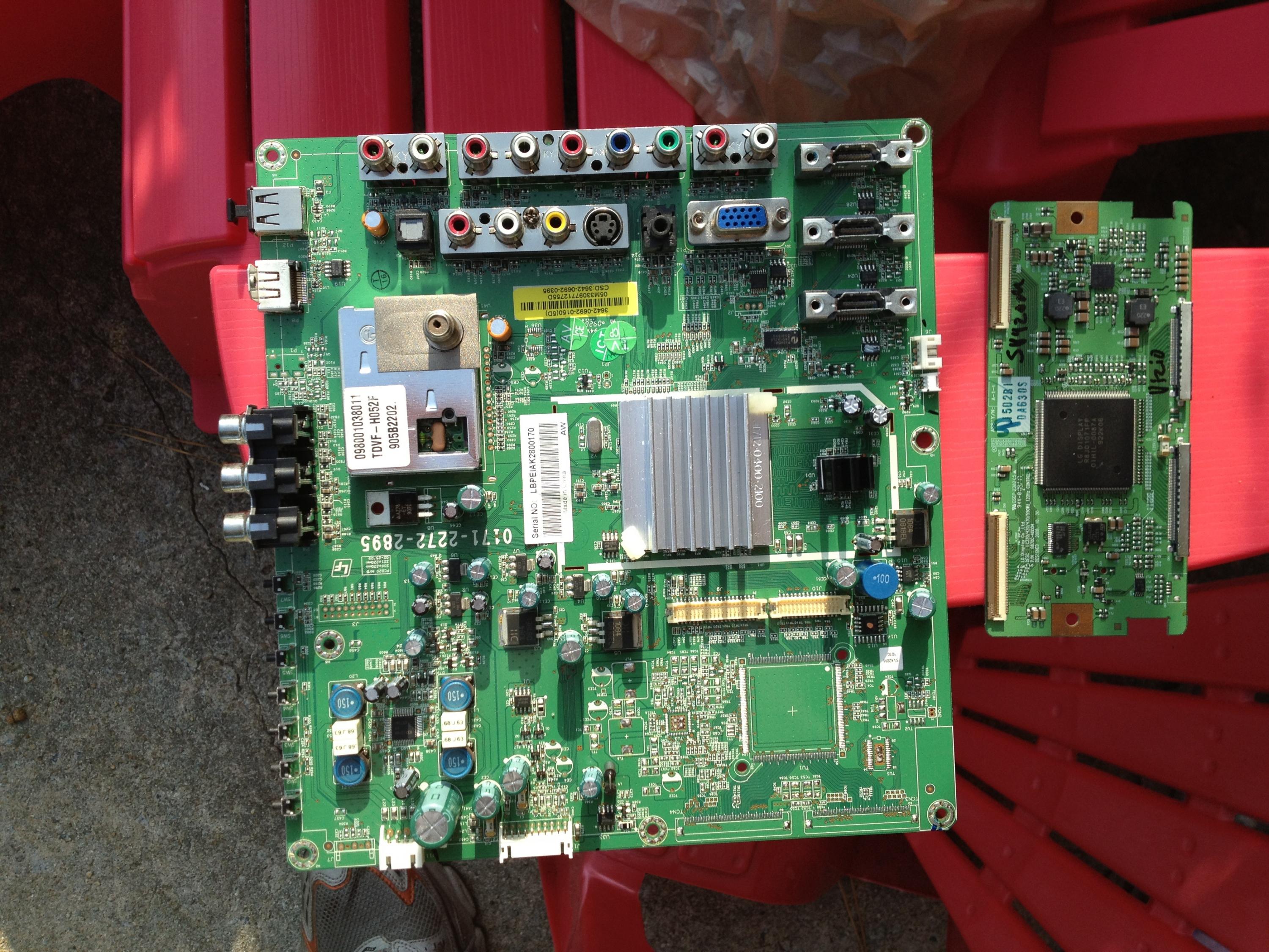

    I recently picked up a Vizio SV420M LCD TV that had gone through a lightning storm. It does not turn on at all. I believe I have narrowed it down to the main board being bad (at least) but would like some input from others. The 5 amp fuse did not blow, has no extra resistance. I have tested the power supply/inverter and backlight, they seem to work fine, the 12v will output when the power supply is forced on, both backlights work when the inverter is forced on. The weird thing is that when the left TCON board cable (right cable on the main board, the wider one) is plugged in, the backlight does not come on when forced. I don't see anything burnt or obviously damaged on the front of the TCON board. In any case, the TV doesn't respond at all regardless of the setup, the Vizio logo doesn't light up at all either.
    Would buying a $20 TCON replacement be worth getting first over a $100 main board replacement, or would you even bother with the TV due to the risk of having a damaged panel? I'm not sure how much damage the small (I'm assuming since the fuse is fine) surge could do to the panel itself. There is also a 6 piece repair kit for the main board for ~$30 but I think it's all surface mount replacements and I'm not really wanting to try surface mount soldering. There is also a $30 EEPROM chip replacement, but same deal with the soldering, and I don't think that will fix what appears to be a dead main board. I don't really have any extra parts or major equipment to do any further diagnostic with, only a DMM. Thanks in advance for the help.

    Hi dejo87. I believe I may have both a main board and a Tcon for this set at home of unknown status. I picked the set up with several others some time ago. The screen was smashed and several parts had been removed. I don't even know if the main board is good but I'd be willing to work something out with you at a major discount over a new one if you'd like to give it a shot with a money back guarantee if it doesn't. Let me check the model number out for you this evening and let you know.
    I'll message you when I get home from work.

      The mainboard part # is 3642-0692-0150

        Post a pic of the tcon and main board on here for me to compare. I get home around 5:30 - 6:00

          http://imgur.com/a/h0xVT#0
          If you're not familiar with imgur, hover over the picture, click on the cog in the upper right corner, view full resolution

            Ok. Looks like a match. I'll message you shortly with details.

              Fixed! Thanks for the parts aaronwt6
