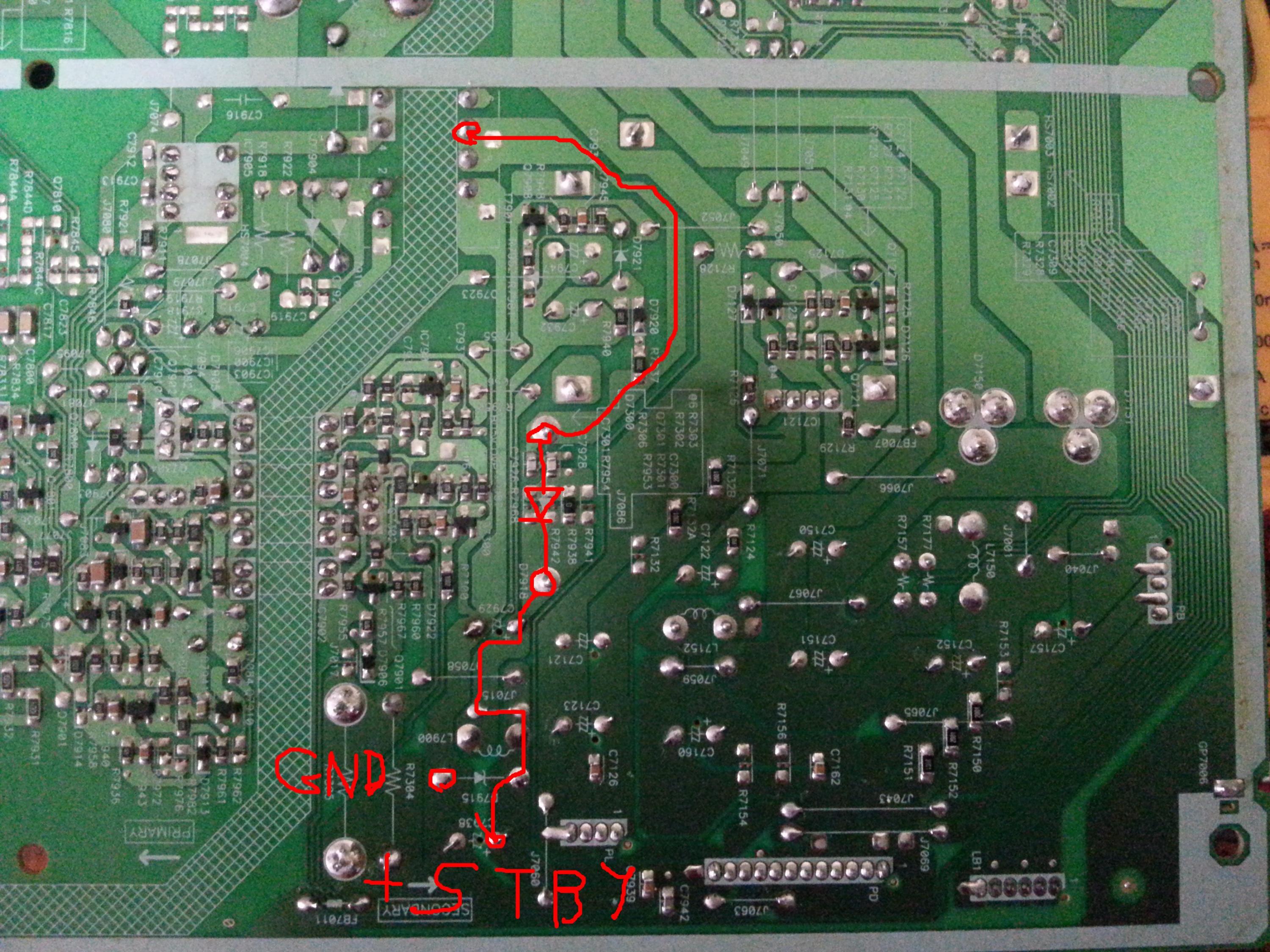

    This tv is having some power problem that's seriously a bit weird. It turns on when plug in power cable, from red turns to green then after few seconds, the relay cuts off and nothing there after. When led was green, the picture was ok and sound was ok for few seconds till the relay clicks off and nothing at all form there. Have to unplug and plug it in after 10 to 20 minutes and it repeats the same process.
    Any kind human able to help me on this? Anyone has the service diagram? Already re-solder all the cold joints with flux. Still no luck. Any help will be highly appreciated.

          Manage to replace the tny264pn IC, power came back, from red turn to green but no picture, and then red and green started changing lights and a few relay clicks and then no power again as usual. Looks like the IC is blown again. Replaced the caps around and still no go. Any idea anyone can help?
            Re: Sharp Aquos LC-46A77M Power Problem
            The power relay which is turn on by the main board, so if you monitor the 5V STBY, is it always there and steady when the relay clicking?
            I cannot read the labeling around the connectors to see what they are, can you provide close up pictures?
              I'm sorry I do not have a service manual for this model so I couldn't trace where to measure the 5v. I used my multimeter and measure the switching ic legs and it only showing 2v.
                Then we will need good closed up pictures of the board, whole both sides, then in small section so we can see the traces and able to read the component designators and any labeling of the connectors.
                    For example:
                    http://s807.photobucket.com/user/bud...?sort=3&page=1
                    Have attached the pictures, pls have a look

                      Updates, 470VAC present at the big caps
                        Kept the unit cool for many hours then turned it on, it works fine with the picture and sound which only lasted for like 15 seconds then the relay clicks off and everything blackout there after. Cant turn on, cant switch on, nothing. Does this means that the power board is faulty? All caps replaced brand new, check all resistors, re solder all cold joints. Still no go. Can anyone help?

                          Theres 4 units of K3569 Field Effect Transistor Silicon N Channel MOS Type and 1 unit of PQ30RV31 Variable Output Low Power-Loss Voltage Regulator on this board. Checked the k3569 for fault and all 4 of them reads perfectly fine on my meter. Unable to check the PQ30RV31 regulator though.
                            We still haven't checked the 5v standby smps circuit yet!
                            What is the part number of IC7905? It is the chip by that small transformer. This will be the 5v standby control chip. Once you tell me the part number, I can direct you to which pins you should test.
                                  Originally posted by ben7
                                  What is the voltage across pins 1 and 2?
                                  It measures 6v ac across pin 1 and 2 after turning on the power. Pls note i measured this without plugging any of the sockets to the tv. Just the board only with power and the best part, the relay clicks on immediately upon turning on power without even being plugged to the tv. It clicks off when turn off power. I put the black probe on pin 2 and red probe on pin 1.
                                    See the STBY power supply output as indicated, monitor that Voltage and report the reading when the TV acts up and when it is working.
                                      When the relay clicks, 4.86v present.
                                        How about when the TV is turn off (since this is STBY power supply, it is always running the minute you plug the TV into the AC outet)?
