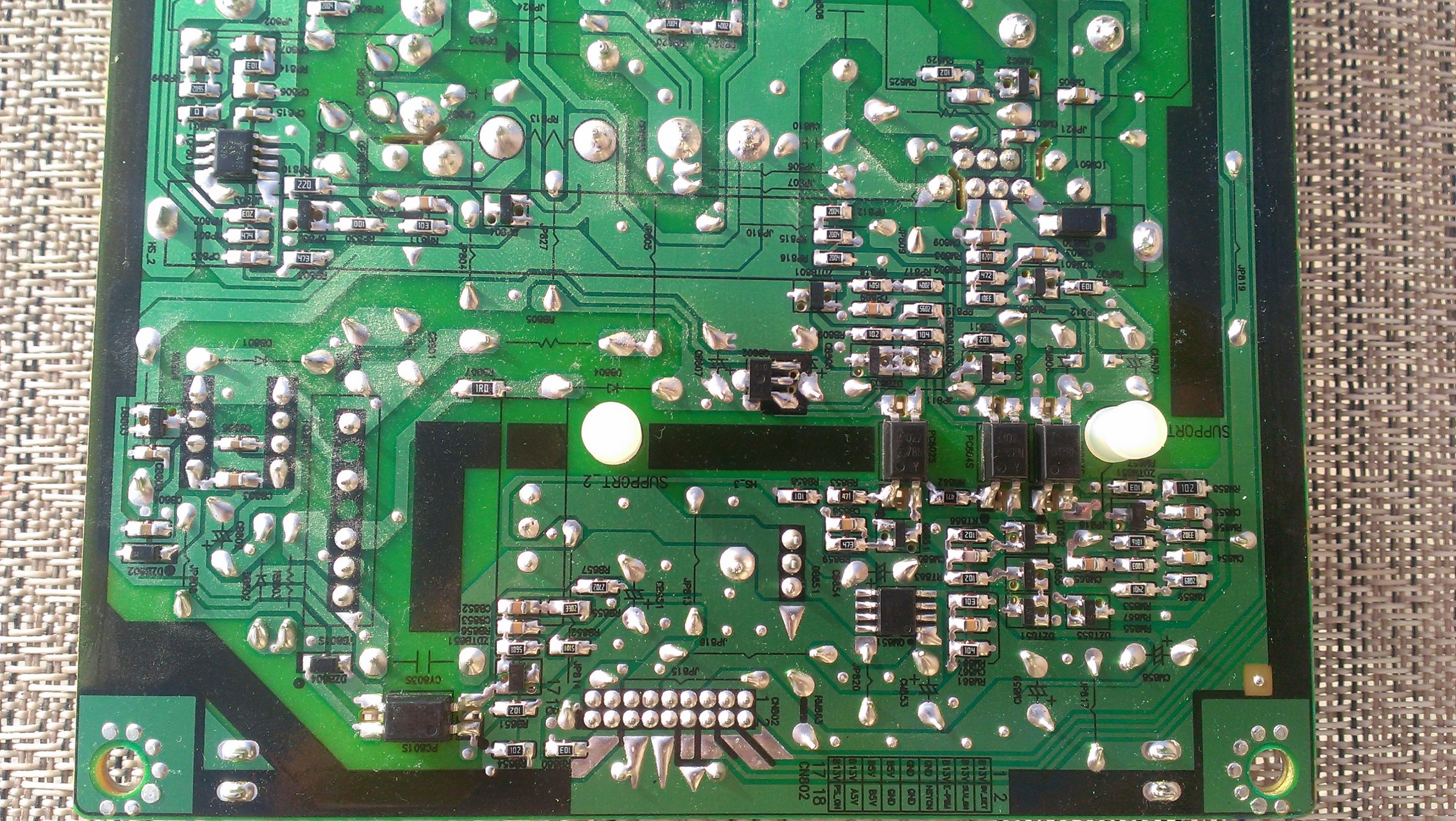

    Samsung LN32C540 - Plug in, shows standby light. Unit won't do anything else.
    Under the direction of another thread with the same model, I unplugged the logic board form the power supply, and got 5.13V from A5V. After jumpering A5V to PS_ON, PSU did not put anything out on B5V or B13V. Suspect power supply board failure.
    The thing is, I don't see any physical oddities on the board at all. No bulged caps, no burnt traces, no discolored resin.
    Is there anything I could do to diagnose this board further?

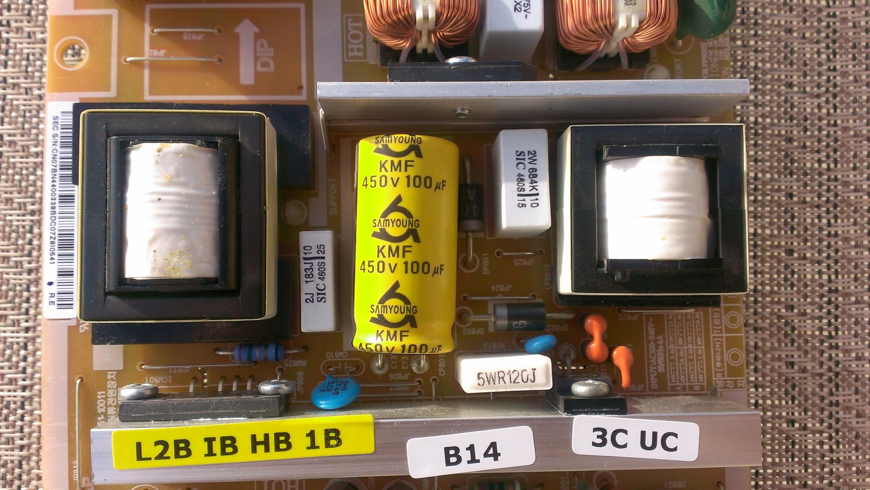

                      Possible no need of replacing IC. Measure capacitance CM808 and if it is not 18nF then change it and tadam...

                          My case, an Samsung LE37C530 series (Power Supply- DONG YANG BN44-00338B Model: P2632HD_ADY) had the same trouble- TV only in standby, not turn on; I changed only the CM808 capacitor and noted it was a little inflated. However, I didn't find the right one to change (18nF 630V) so I put an 10nF 2kV from an old desktop PC power supply, TV works fine!!!
                            Re: Samsung LN32C540 - Standby Light only.
                            Using 10nF instead of 18nF, the transformer will not get full drive Voltage, so to get the correct drive Voltage on the Primary winding the drive circuit will have to work harder since Xc is about twice as much as before.

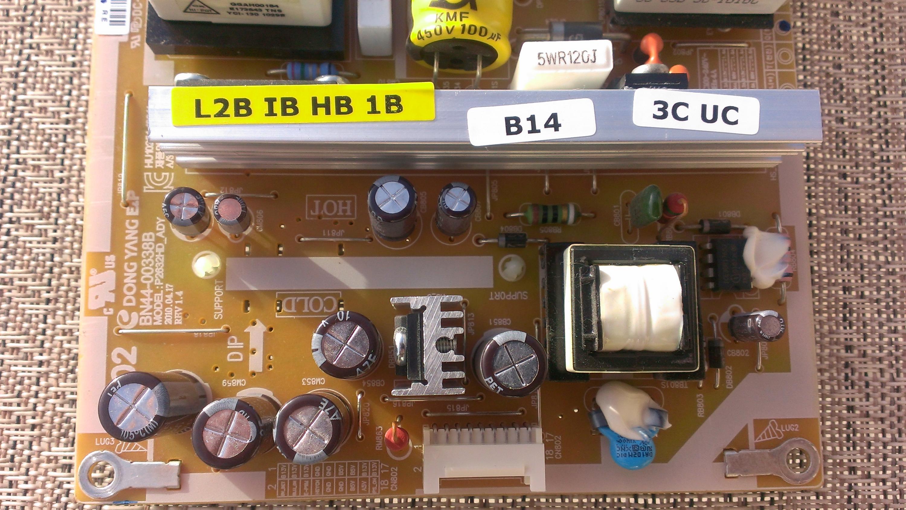

                              I've pulled my BN44-00338B power supply board, and tested the capacitor at CM-808 per https://youtu.be/ASMOVbOZac0. I get a bit over 8v, which, according to the vid. means my cap is bad. I'd like to replace just that cap, since a kit for all of them is $23, but that one alone looks to be in the $4 range.
                              My question is, on the cap's label, what do the numbers to the right of the vertical bar indicate? I can find versions on ebay that look to be rated the same, but have different number on the right side of the black bar.
                              http://www.ebay.com/itm/2J183J-SIC-4...-/161260169142
                              Mine has a '10' over a '19'. Is that related to physical size/pin-spacing?
                              Again, thanks for contributing to the community here, and thanks for any help!
                              Zach
                                You should check the capacitance of that cap, but more likely it has lost its capacitance.
                                The lead spacing is 15mm.
                                SIC capacitor spec: https://www.badcaps.net/forum/showth...589#post600589
                                The kit does not come with that cap, most kits just provide the electrolytics caps.
                                The cap per that picture is 0.018uF 5% 630V, Polypropylene cap.
