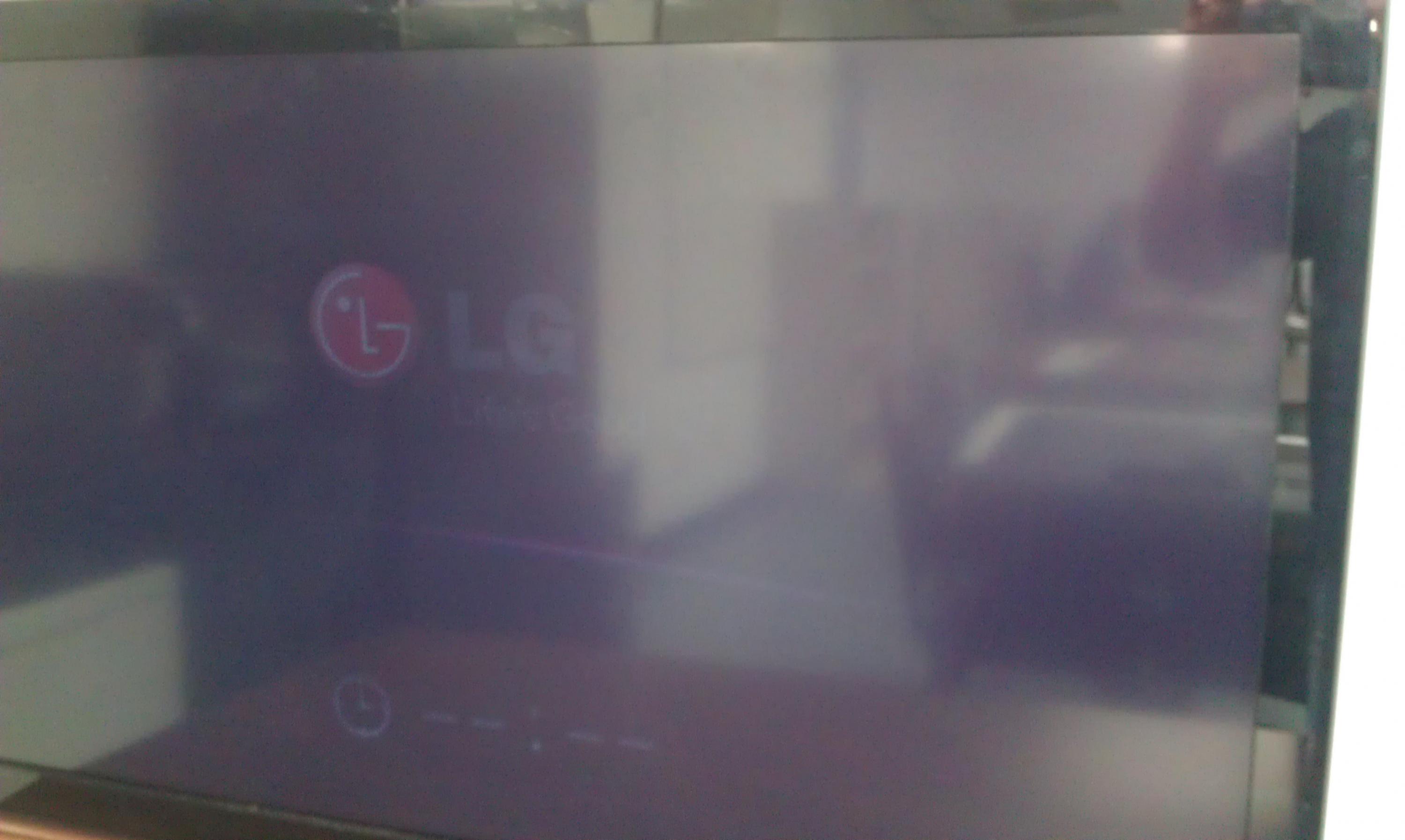

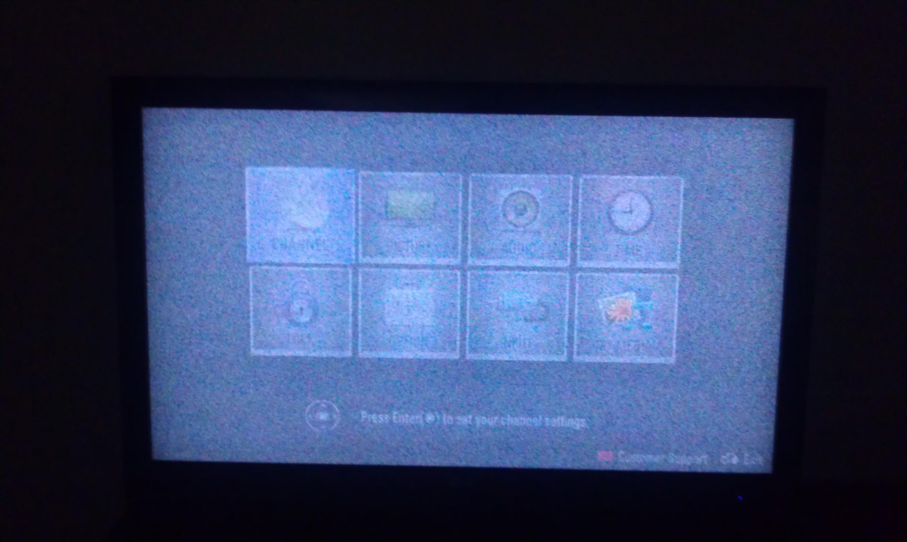

    History: I replaced the Main Board and Power Supply. The TV now powers up but the display, including menus, is snowy. I replaced the T-Con board and that had no effect. The power-up screen / time screen is clear which makes me think the screen is not damaged. Could I have gotten a wrong replacement main board? firmware? Any help will be appreciated.
    Original Main board : EBU61369602
    Replacement : EBR73308816
    Re: LG- 42LK450-UB.CUSY.LH Snowy Display
    Can we see the time screen? Odd that the main menu is affected but not the time screen?

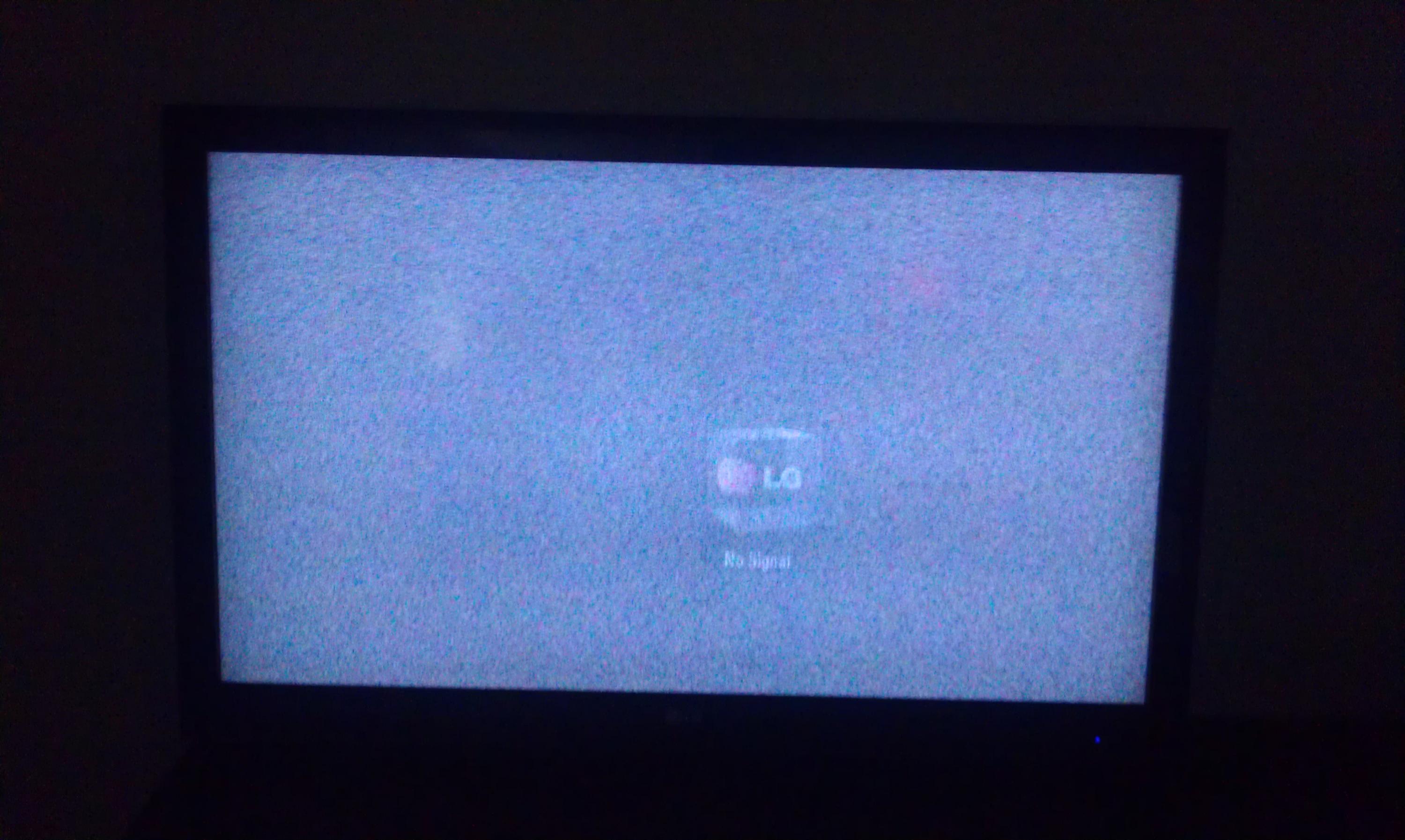

      Very bad picture, but it flashes off so fast its hard to catch it. But the LG and blank time are clear with a solid black background. Then the "no signal" animation starts with the snow..
      Thank you for the help!
        Hmm... If you turn down the TV's backlight or brightness setting does it reduce? (crazy idea)
          Changing the brightness has no effect.
            Does that mean it could be the main board?
              It looks like a main board issue to me, but first I would try a factory reset:
              Hold MENU on TV and MENU on remote. Hold for around 10 seconds.
              If password prompt shows type 0000 or 1234.
              When the service menu appears, select the RESET option.
                I had a 32" samsung that had a similar problem. The previous owner had replaced the main board with one from a 46" set. He used the number on the board, not the one on the sticker. Maybe the same problem?
                  That is my thought too. The board with matching numbers was for a 42lk520 not a 42lk450.. If the factory reset suggested above doesn't work I will order another board and give it a shot. I also wondered about a firmware issue. This model came with either a VA or IPS screen...I am not knowledgeable enough to understand if that would be a factor.
