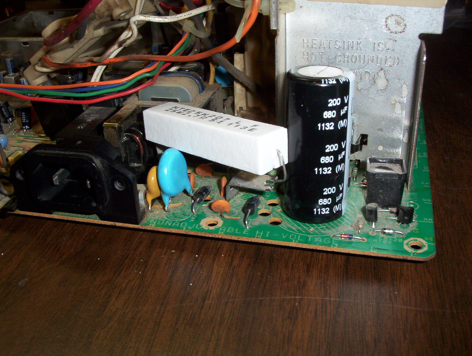

0.05 ohms is basically shorted, do you mean 0.05 kohms or something similar?
from your posted reading on SCR4101 it's bad RCA replacement part# 194320 when replacing don't forget to reinstall the small insulator back to the heat sink before installing SCR

If the insulator which mounts behind the SCR transistor isn't damaged ,then yes you can reuse,but as a rule thumb if my new transistor has one supplied with it I always replace with new one.The increase wattage on your replacement resistor will be ok,yes you can apply some heat sink compound to the Horz output want hurt
Mmmm, no. Won't power up, and I smelled something funny. That resistor got pretty hot, and it was maybe plugged in for 30 seconds. Oddly when I flipped the switch on the power strip that the TV is plugged into, a lamp that's also on that circuit dimmed for a second. I think this means I have a major short somewhere.
Yep, the fuse is blown now.
I don't know if it's worth pursuing this further. I think I have a fire hazard on my hands.
busted solder joints on the h-drive transformer are common.
anything that runs hot or mounted to a heatsink should also be resoldered.
put your meter in diode test and check e-c on the board where you removed the hot.
you might read the damper one way but should be open except for charging a cap.
e-b will be low.if not look at the h-drive secondary and solder joints.

does your meter have diode function? If so with set unplugged what is your reading @ horz output in set? reading should be to HOT gnd . neg probe HOT gnd, pos case of transistor reading, then reverse leads for second reading.
also during your previous removal of the Horz ouput did you make sure you put the transistor insulator back onto the transistor before mount back to heat sink?
What transistor insulator? Oh that plastic on the back of it? Yeah that's fine. Doesn't matter I would think because the HOT is attached to the heatsink with a metal clip.
So you want me to set my meter to diode function, clip the negative lead to the HOT heatsink, and the positive to the casing of the HOT? Well, doesn't make sense, but did that and got no reading either way.
I don't have the schematic in front me it's on my desk @ work but you should get a reading in 1 direction E-C which Emitter is HOT gnd and no reading the reverse direction i'll review the schematic Monday and post again
What i'm looking for is potential low resistance or short on the 150 volt raw B+ which would take out the 2.7 ohm resistor and open the fuse
