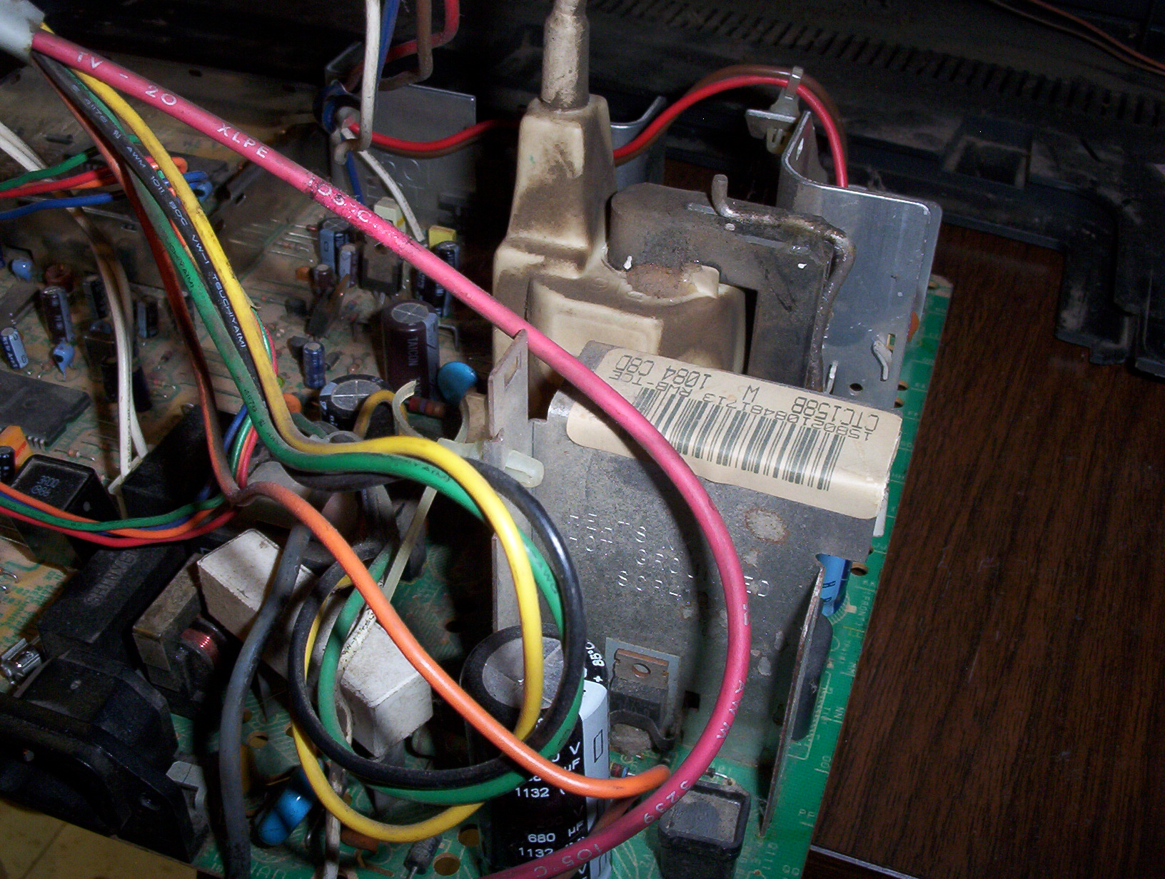

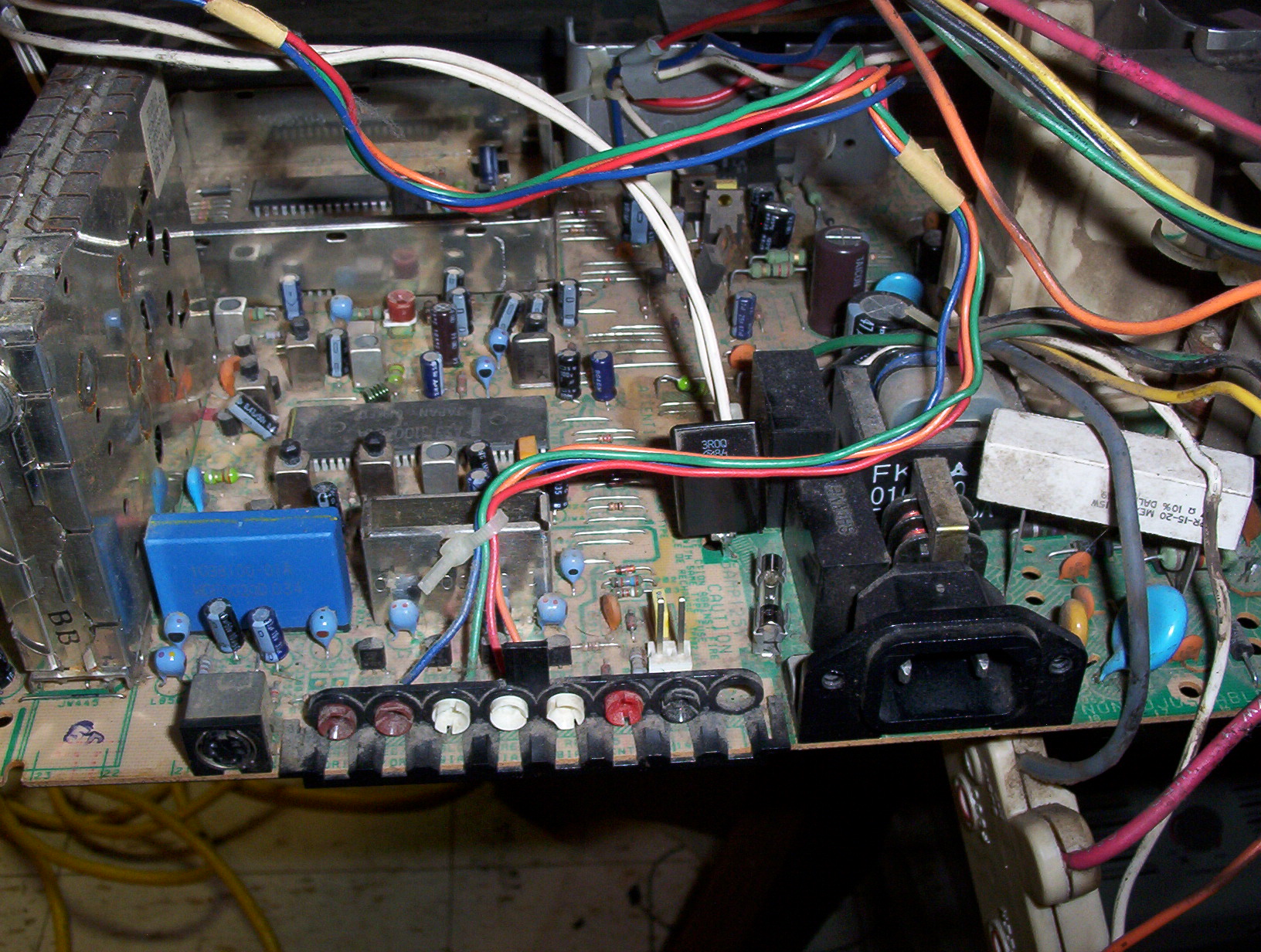

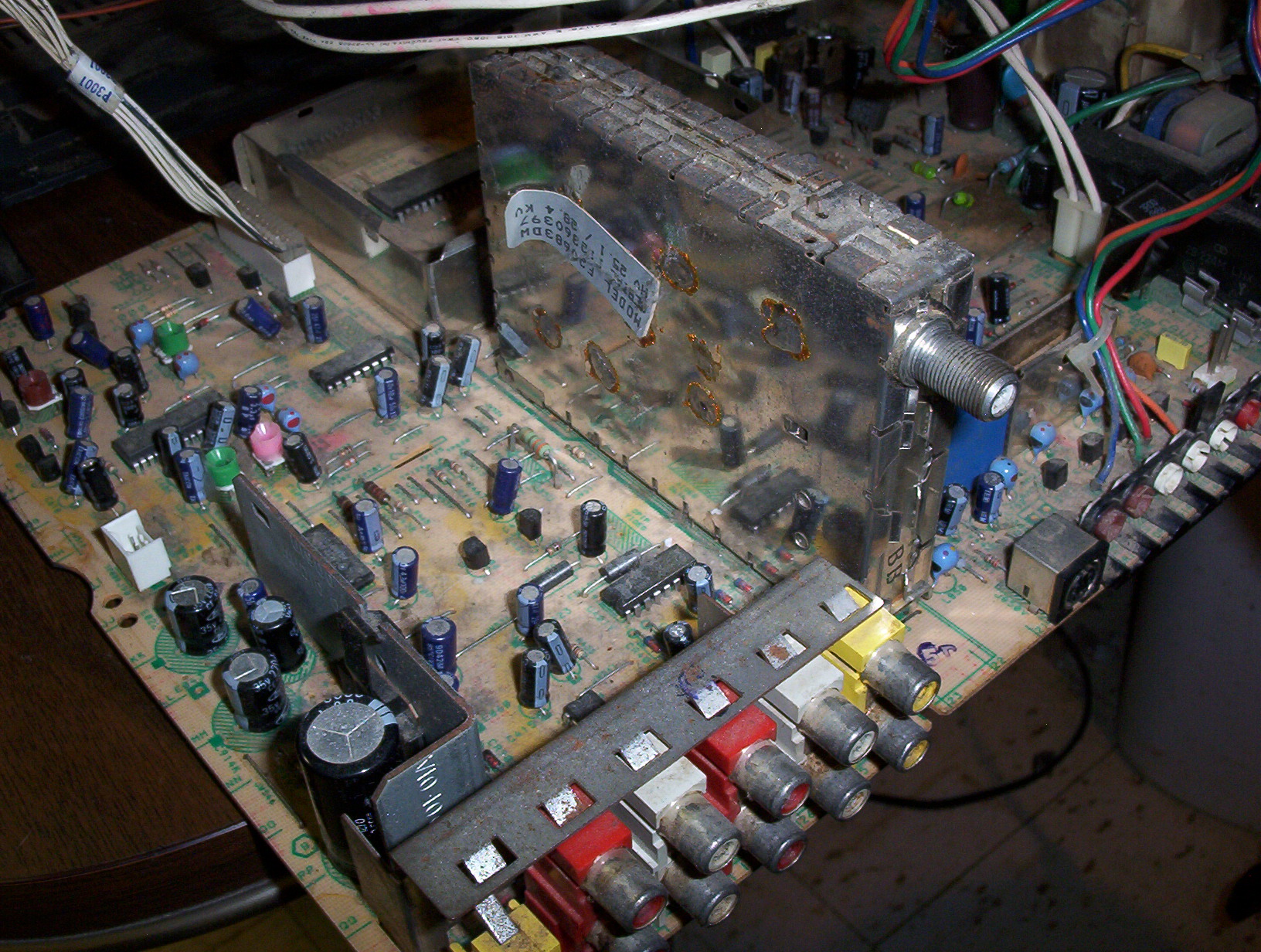

    I have the TV apart now, and pics of the chassis are attached. If you're familiar with the chassis, you might notice the thermistor is different. I jury rigged in a thermistor from another TV because the junky one that Thomson put in fell apart when I touched it.

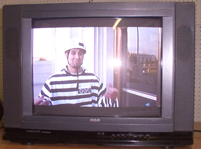

    What does the front of it look like? It it one of those Dimensia models? Those were badass back in the day.

      Here's a picture of it from back when it was working.

        Since you said you moved it around, I immediately suspect a cracked solder joint or two.
        Have you checked the HOT?

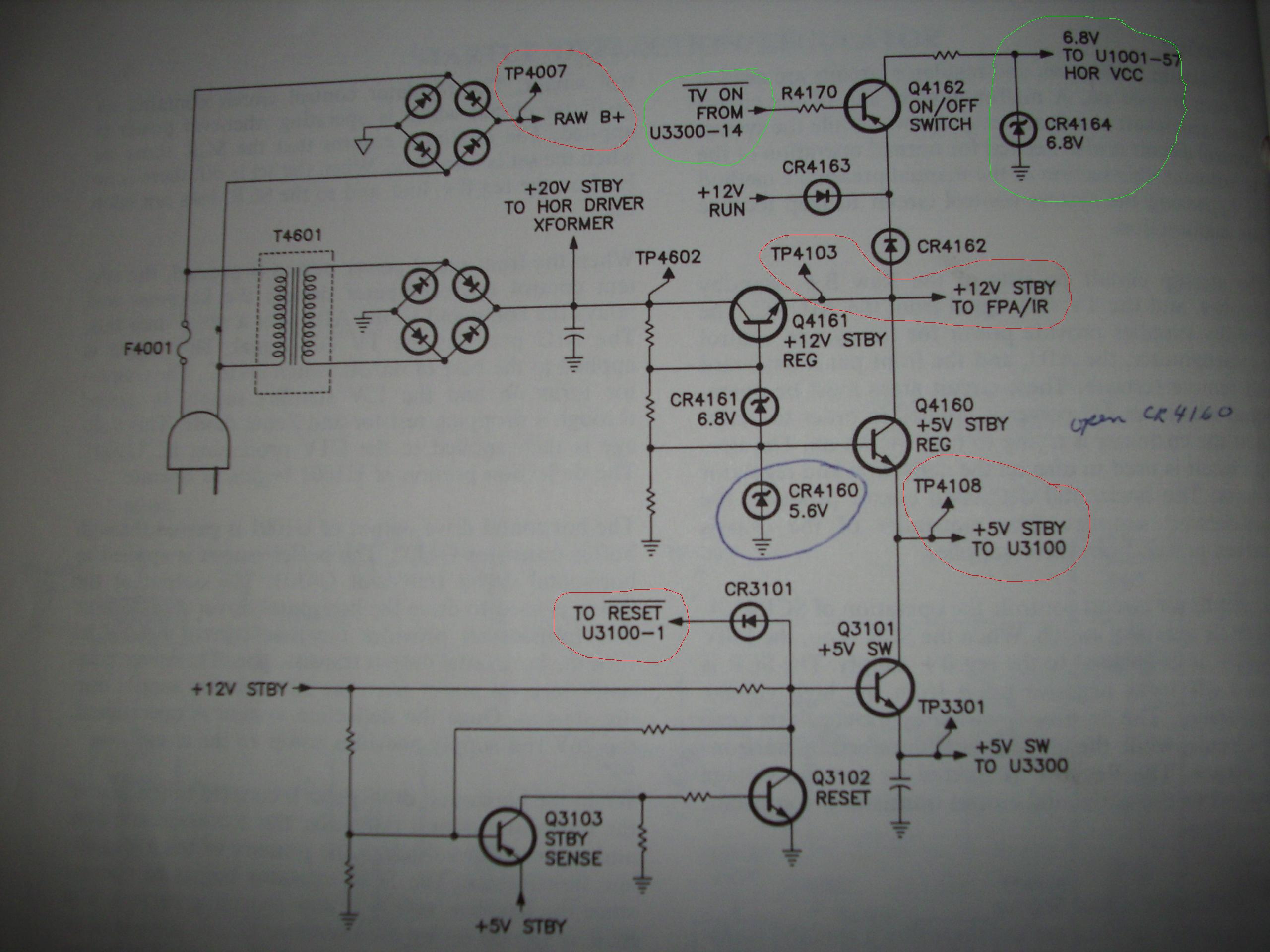

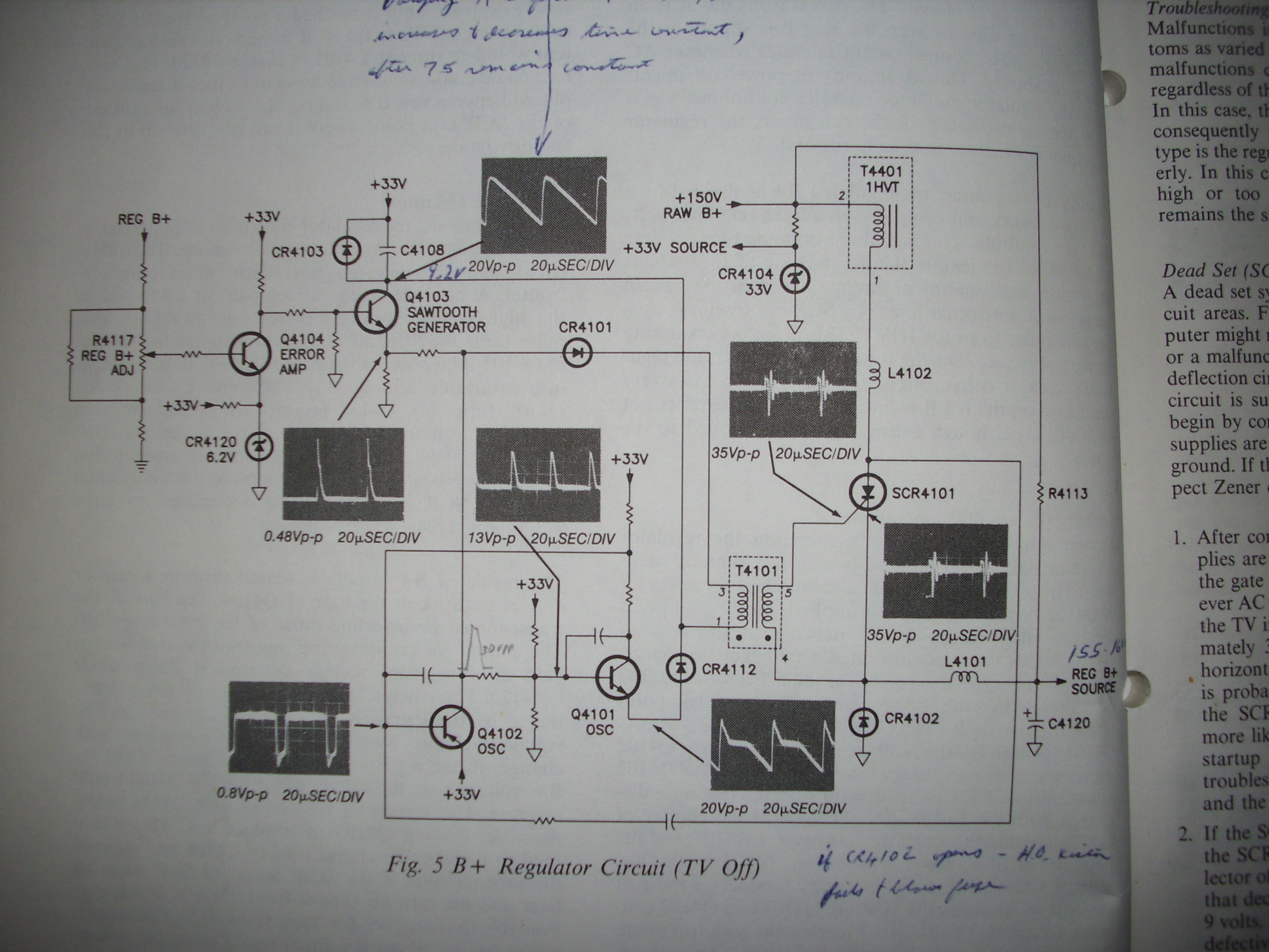

                    couple things to check to make sure your start-up circuit is working.The items circled in red is a start,now if you have all the standby voltages take look at the two circled in green,these to are necessary to kick start the horz drive ic make sure both of these are occurring when the power switch is depressed will go further upon these results hope this is a help attached is partial schematic of the start-up circuit

                      I think the micro is running. The button panel is hard to get to, so I grounded to the tuner can and started probing pins where the front panel connects to the chassis. Got a 4.6 volt reading on one of the pins, other pins read at 13 or 20 volts. If there's a specific pin I need to test, let me know.
                      RON CET, okay that's helpful! I'll start looking for those.
                      Well it's helpful in that it labels the components, but where on the chassis would R4170 be?

                        Re: RCA ColorTrak 2000 (CTC 158B) won't power on.
                        look on on top and bottom edges of board you'll see numbers @ top and letters on side you use those like a map to locate components on the board R4170 and Q4162 are located @ k42 location on board

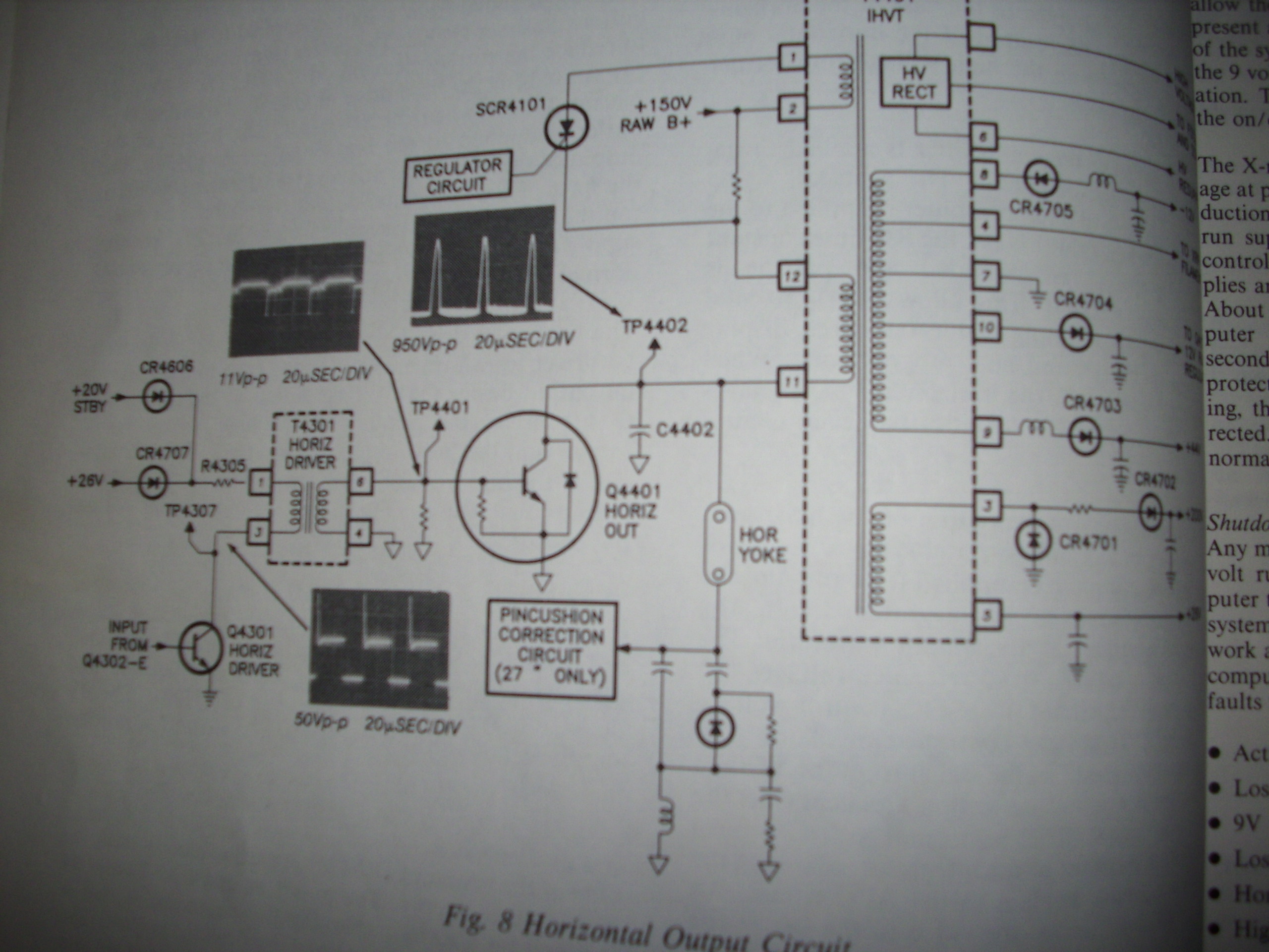

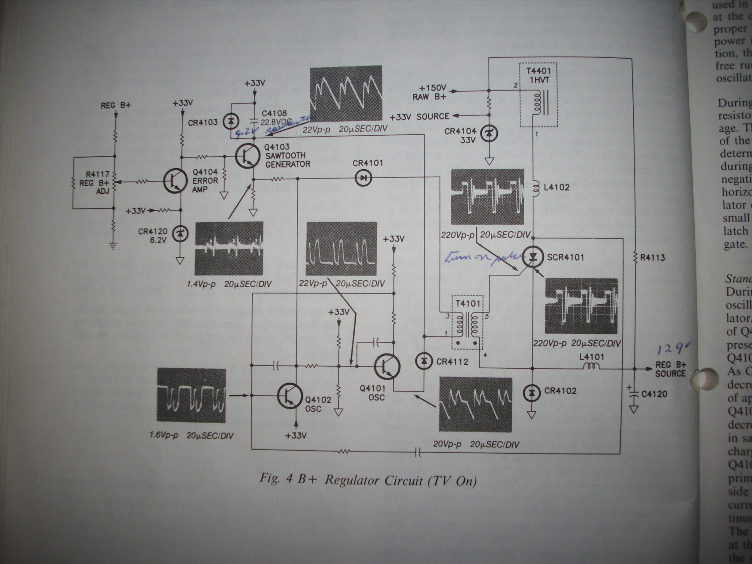

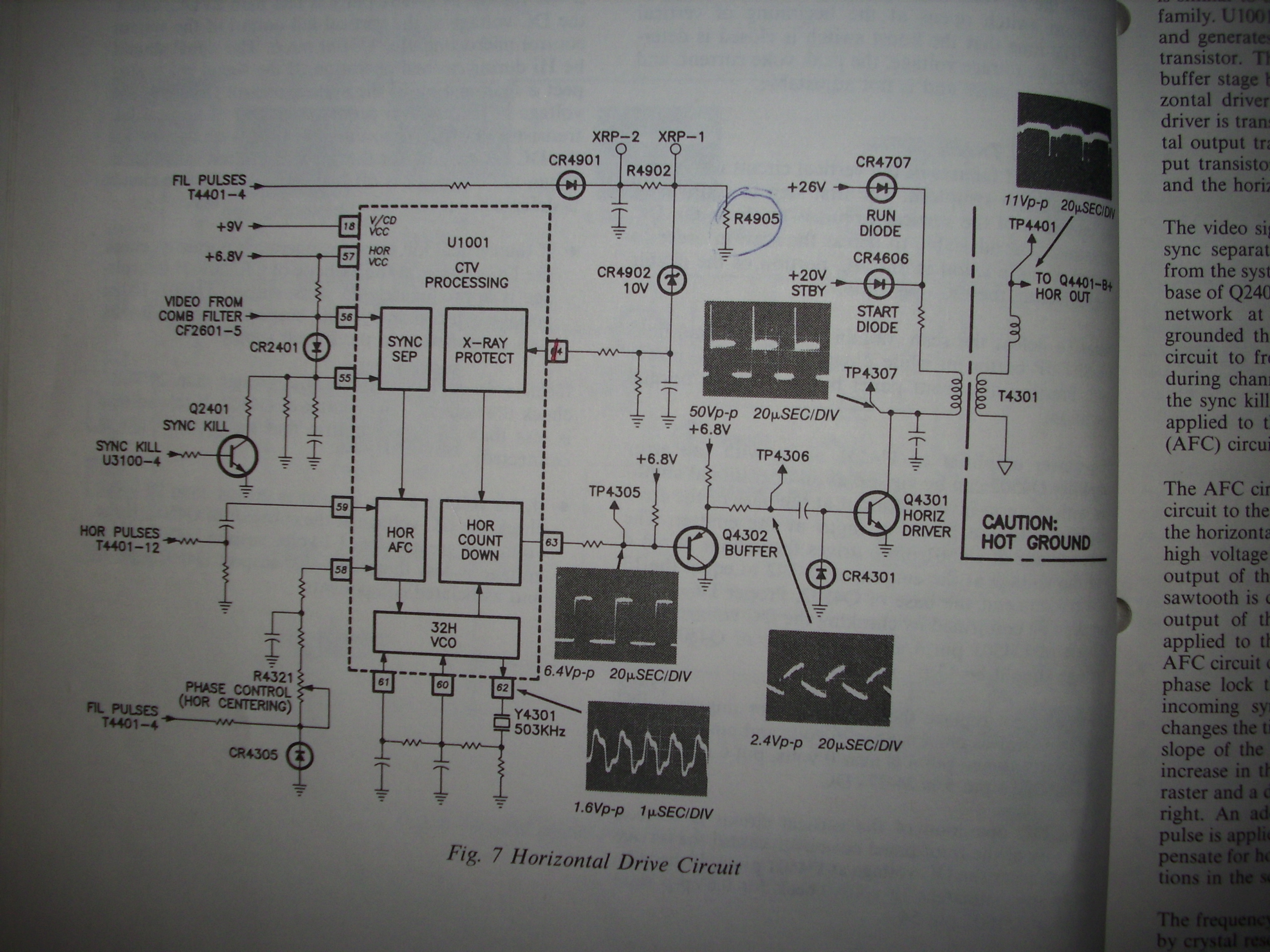

                              Attaching images for regulator run mode and off mode,horz drive,horz output
                              NOTE!!! voltage readings with triangle mark are reference from HOT gnd
                              with set plugged into ac and in stand-by mode you should have approx 145/150 volts dc to HOT gnd @Q4401 and when you press power button when set goes into run mode you should have approx 130volts dc to HOT gnd @Q4401 this tells me that your regulator circuit is working,now if the set is pulsating or trying to start but shutsdown then tries start again you might be missing a run voltage example 26 volt run 9 volt 6.8 volt

                                Okay, the heatsink for the HOT says it's HOT grounded. Should that be where I test? Where should I connect the leads of my multimeter?
                                • RON_CET
                                  • Jun 2012
                                  • 217
                                  yes you can use the heat sink for your HOT gnd,so your neg or black test lead would attach there if you can get to bottom side of chassis I would use pin12 of T4401 for your voltage test with your pos or red probe of your meter set to about 200volt scale for readings if you can't get to bottom then locate TP4008 @ 29G or G29 for your reg B+ for the Q4401 Note!!! service lit says not to read voltage directly @ Q4401 casing with multimeter
