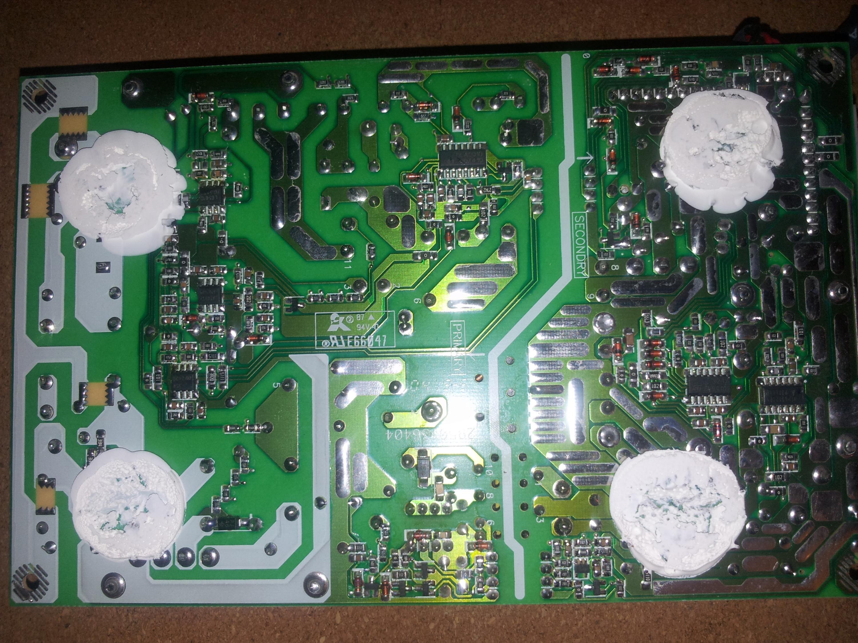

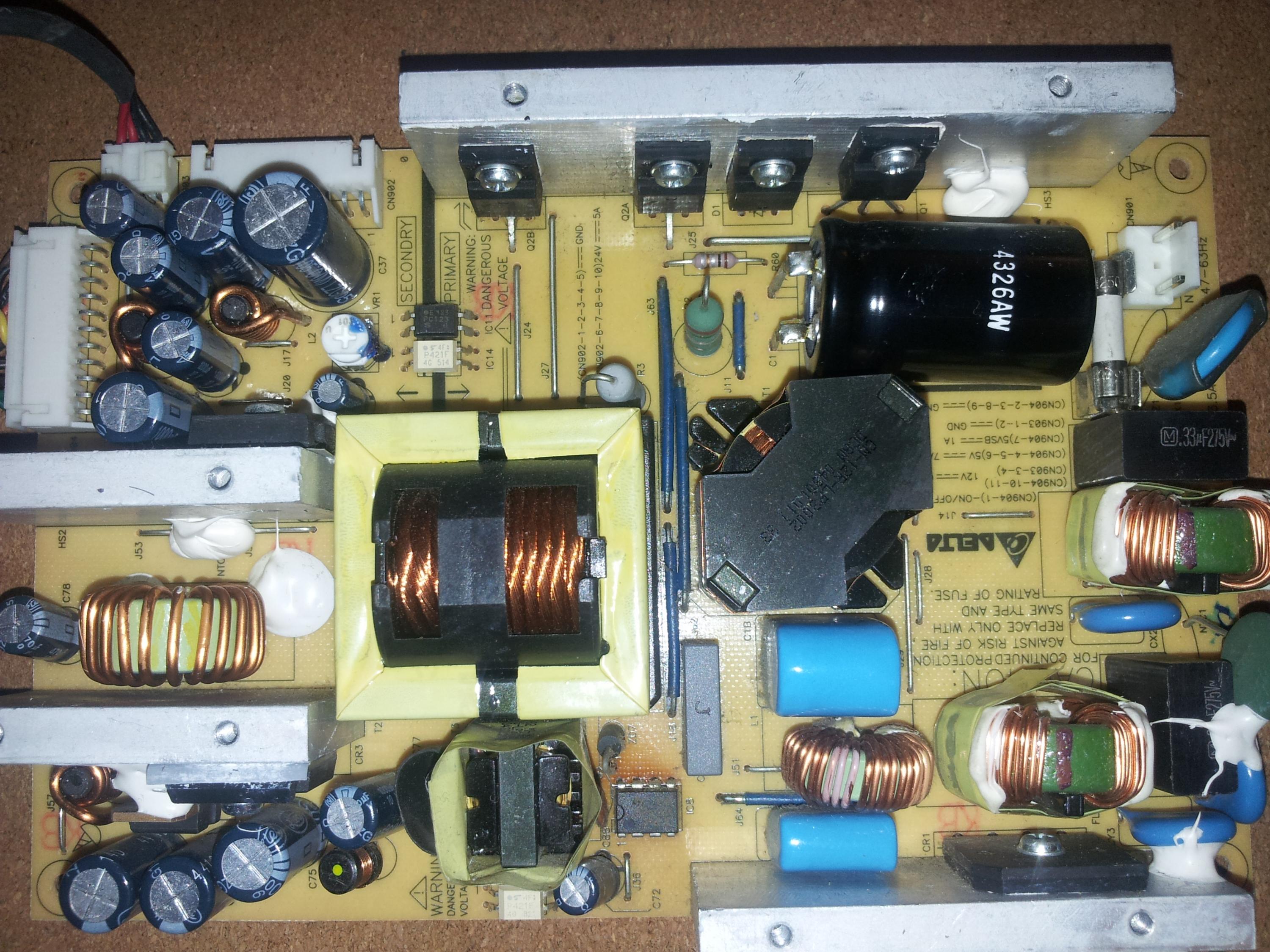

    Medion MD41527 PS b/d hissing/crackling noise
    PS b/d: Delta DPS-210EP B Rev:00
    The moment the rocker switch is turned on (tv comes on in standby) there is a hissing/crackling noise (possibly arcing) coming from the PS b/d, I have managed to locate the culprit which appears to be the large blue cap just under the transformer, after a few seconds the noise stops until the tv is turned on, out of standby, the noise then persists all the time the tv is on.
    Is it just likely that the cap needs replacing, what one do I get and where, thanks.
    Cap - MM225K 450V
    Re: Medion MD41527 PS b/d hissing/crackling noise
    There are other possible causes of this. Check the voltage across the large 400V cap. If it's low, then you may have a PFC problem causing the hissing/crackling noise.
            380v when first powered on then settles down to 320v, this is in standby.
            Switch on from standby, goes back up to 380v and remains constant whilst the tv is on. Occasionally dips to 379v.
              OK, that's fine. Are you sure the noise isn't coming from L1, the coil next to the capacitors?
                Well, I touched the 2 blue large caps and the coil but the vibration mostly seems to be coming from the top blue cap and when moving each of these components its the top blue cap moving that makes the noise change.
                I could try resoldering the joints but they look good from the solder side of the board.
                  I would try dabbing glue on L1, if that doesn't work then it may be the capacitor. Note that in some cases those capacitors can be microphonic (produce noise from current flow), part of their operation, not something which can be avoided easily.
                    The noise is quite audible and the volume on the tv would need to be turned up loud to drown out the cap noise, so not normal operational noise which I have heard before on some tv's and knew theres not much that can be done about it and in any case not very audible so can be ignored especially when the casing is put back on.
                    • notallbad
                      • Oct 2012
                      • 1190
                      OK, i have glued the coil but not much change, maybe slightly reduced but thats probably due to the glue being packed between the coil and cap.
                      I think I shall try re-soldering the joints to see the results then apply glue between the cap and transformer side.
                        Re-soldered - no change.
                        Really do think its the cap at fault.
                          Datasheet for MM225K 400V Cap available here:
                          http://translate.google.co.uk/transl...38%26bih%3D520
                          Metallized polyethylene terephthalate film capacitor
                          Will just any 2.2uF 400V +/- 10% tolerance poly/mylar cap do?
                            Must be polyethylene, cannot use class X or Y.
                                  Thanks Tom
                                  But the dimensions seem excessive, mine is approx. 16mm long, 20mm high and 13mm thick.
                                  If the ones I order are truly 31mm long, 29mm high and 31mm thick I will have difficulty fitting it on the board in its original location.
                                  • notallbad
                                    • Oct 2012
                                    • 1190
                                    There is a heatsink plate that fits over the top of the boards, not shown in the photo, so the height is an issue too.
                                      Not sure then how to solve the issue, as it looks to be a hard to find part.
                                        Two smaller capacitors in parallel?
