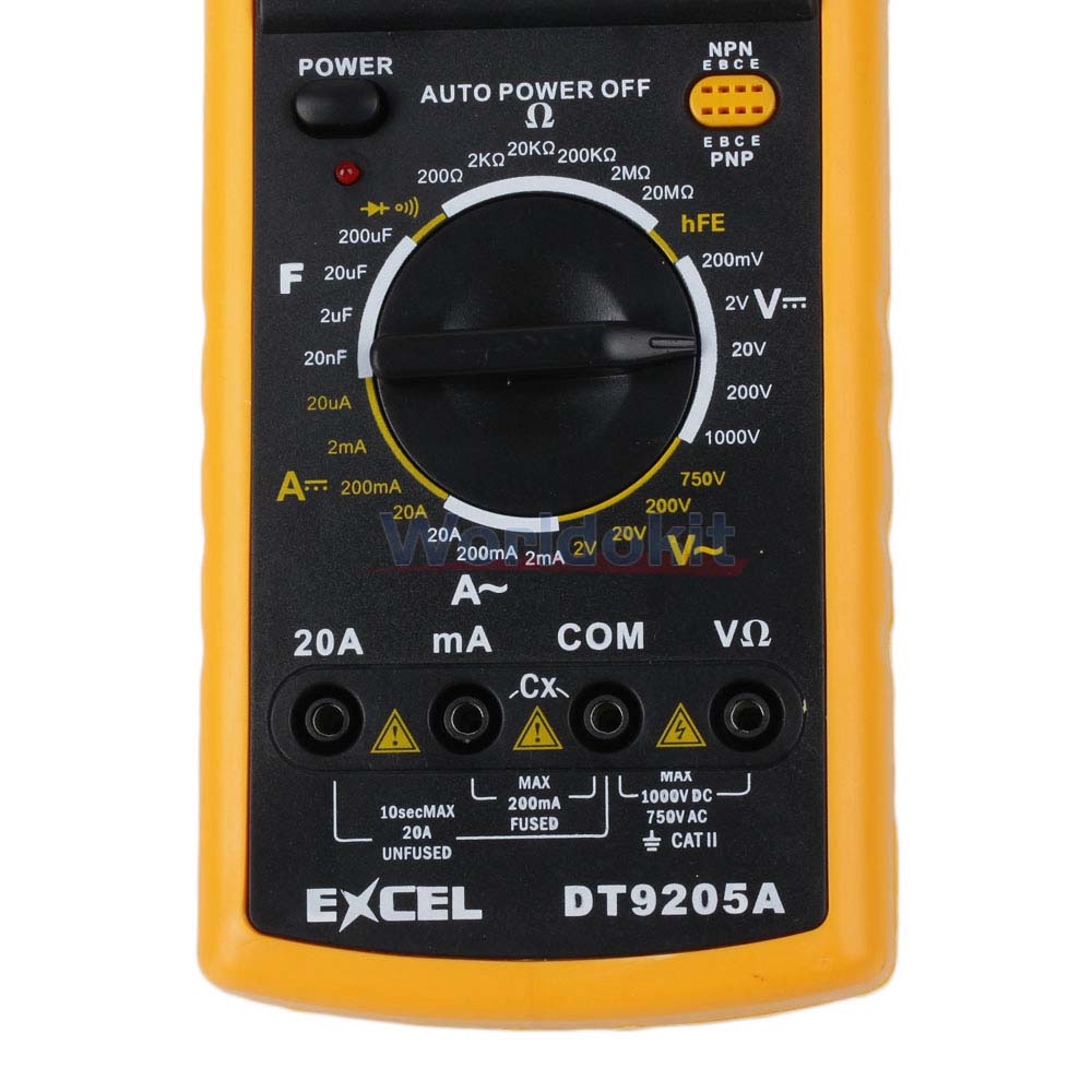

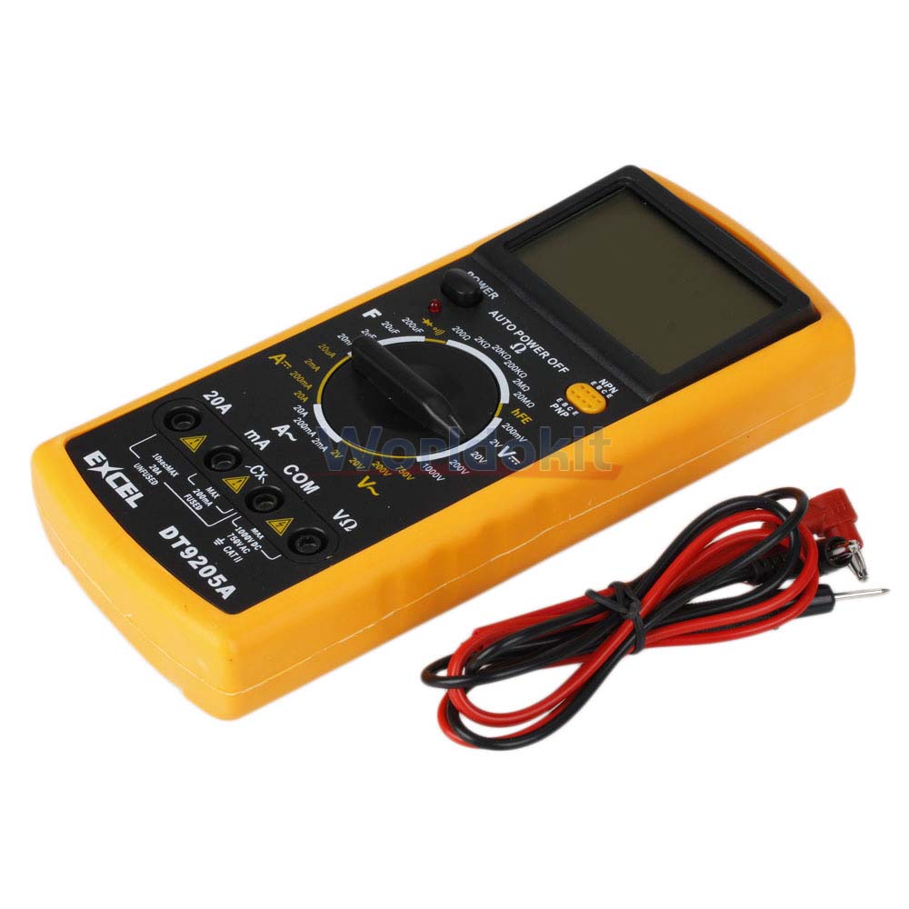

    Which meter are you using? Can you post a link or pic of it?
    LG Plasma Mal-Discharge Correction Service
    • dyel
      • Jun 2013
      • 19
      #42
      Re: LG Plasma 50PA5500
      There you go.
      • capkid
        • Oct 2010
        • 1339
        #43
        Ok, you need to set it to the 200V or 1000V range. VS is usually around 200V, while VA is around 60V. Check the label near the top of your panel for the exact spec.

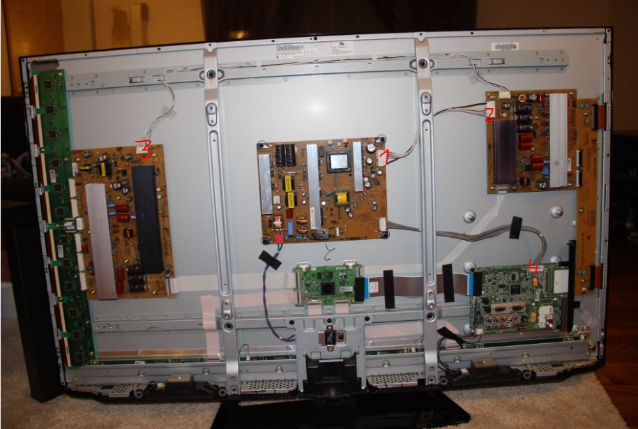

                    So, the following happened:
                    1. Disconnected Z-sus from the power supply - VS - 0, VA - 0 (200V is set up);
                    2. Disconnected Z-sus from Z-sus board - VS around 3.0, VA - 0;
                    3. Connected Z-sus, disconnected Y-sus from Y-sus bourd - VS around 3.0, VA - 0;
                    4. Z-sus and Y-sus connected, the control board is disconnected - VS around 3.0, VA - 0;
                    After I connected everything back, the TV stopped clicking and VS around 3.0 (versus 5-6 before).

                      I'm not sure I understand what you did in steps 2 & 3. If you meant to say the following, it appears that your power supply is faulty:
                      2. Disconnected Z-sus from Y-sus board - VS around 3.0, VA - 0;
                      3. Connected Z-sus, disconnected Y-sus from power bourd - VS around 3.0, VA - 0;
                      You can try to repair the power supply or just replace it. It looks like there are quite a few available on eBay for under $25.

                        Thanks! Will try to buy a new power supply.
                        Hope the picture provides more details.
                          #52
                          Those tests with the resistor jumpers in place? If so, bad PSU is likely the cause.

                            Hi All! I bought a new (used) power supply, set it and...my TV WORKS!!!! Thanks everybody for your help! It was interesting.
