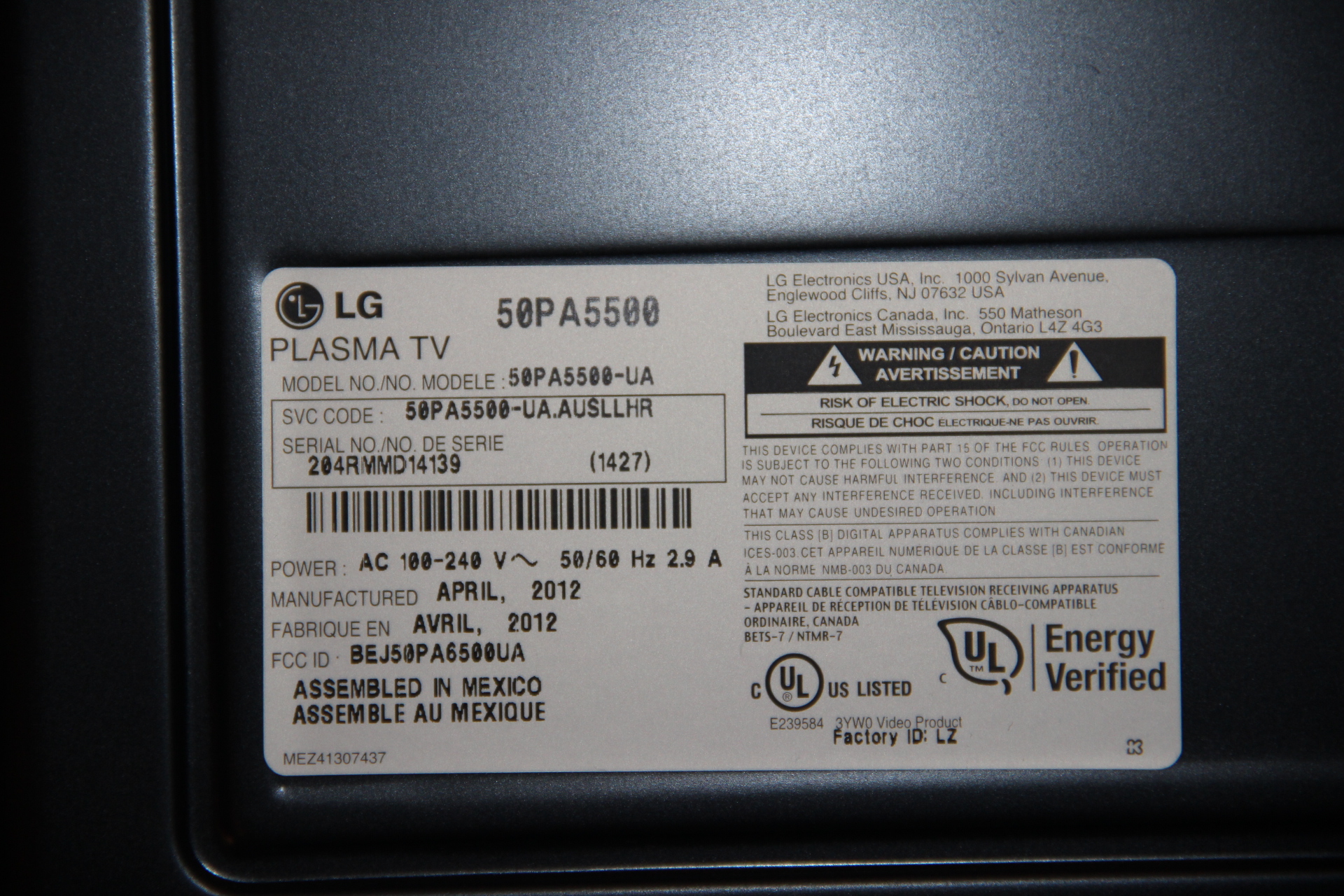

    So we had a really bad storm the other night and now my TV doesn't work. Everything else on the surge protector still works though. What happens is I plug the TV in and it will come on for maybe 30 seconds or so. Picture is fine sound is fine. Then the screen just goes black and the sound quits, but you can still tell its powered the screen is just black. It will not respond to the remote or buttons on the tv. The only way to turn it off is to straight unplug it again. Then I have to wait a good twenty minutes or so before it will do anything again. Would appreciate some thoughts or advice on this, as I've never really dealt with this before.

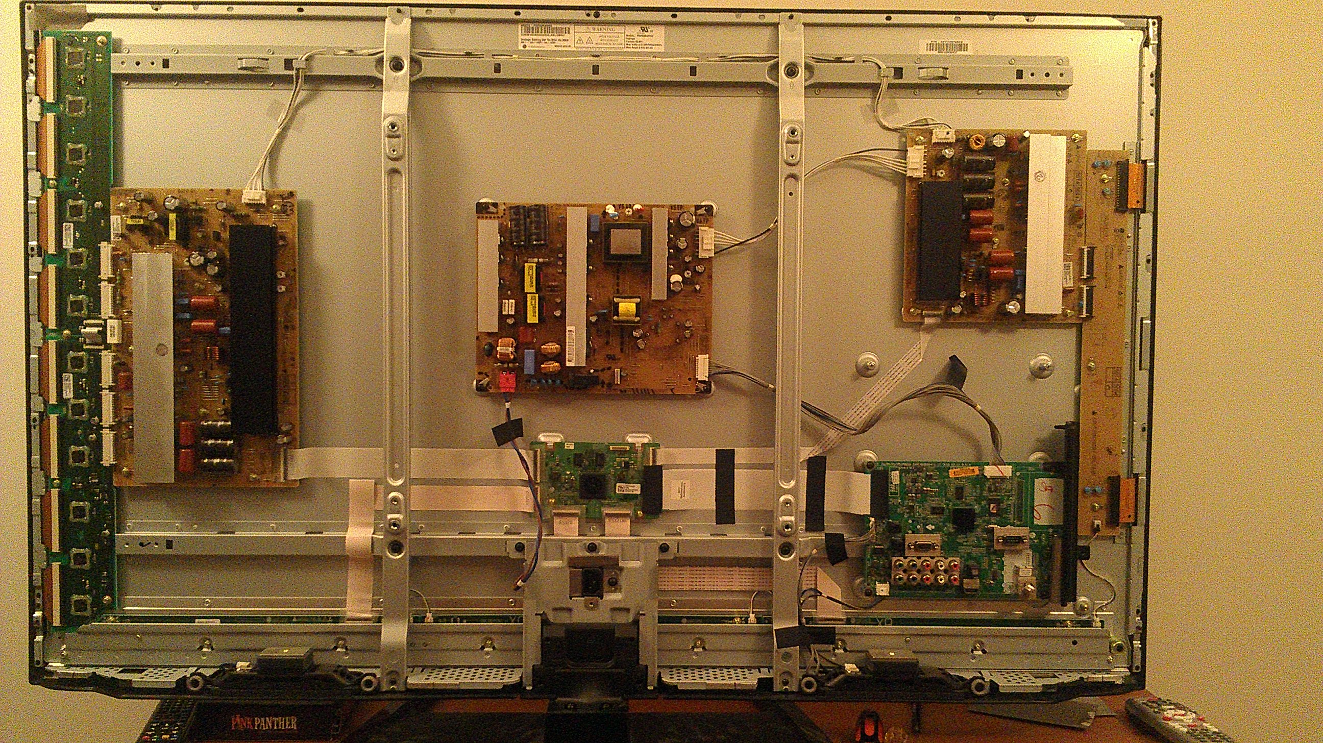

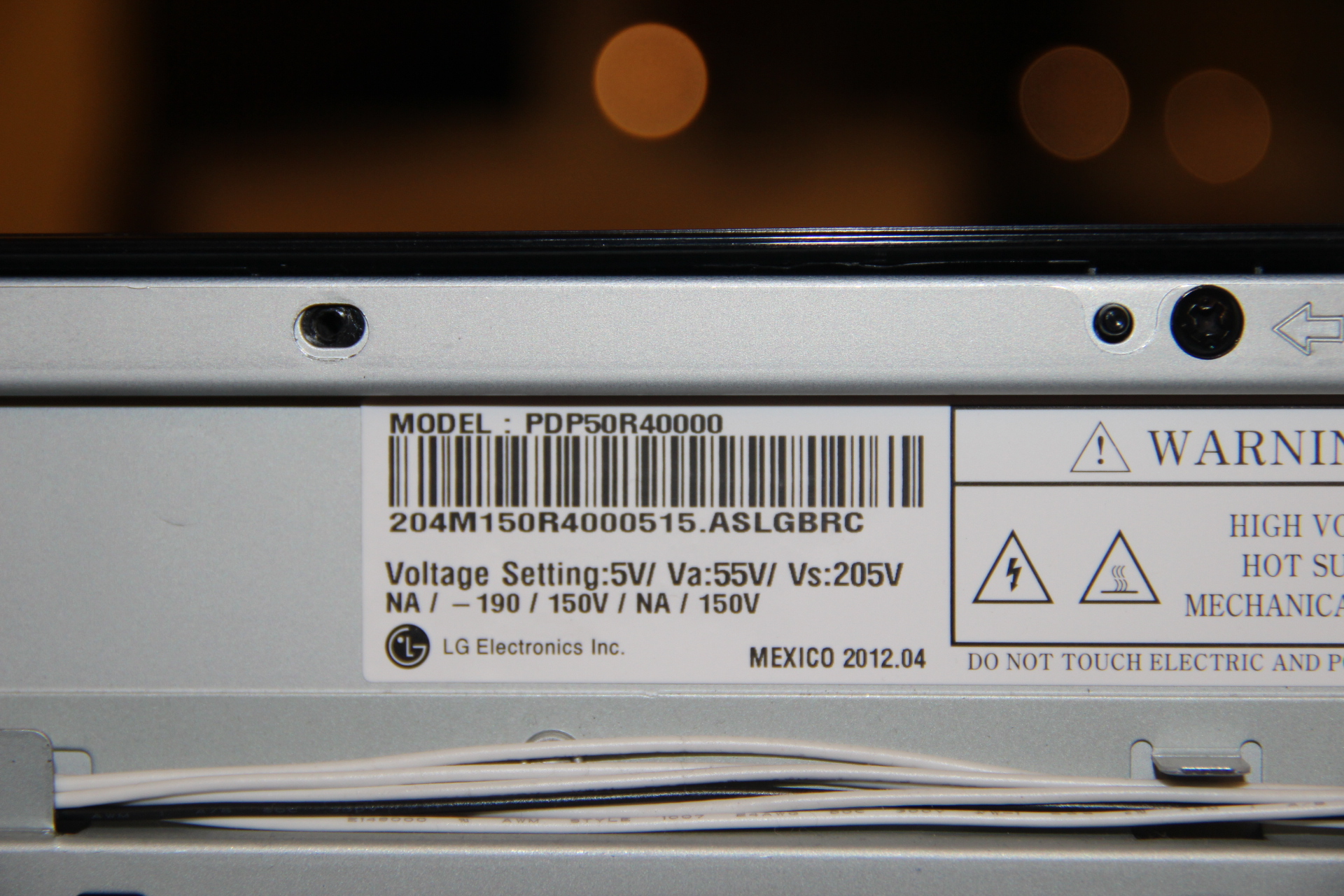

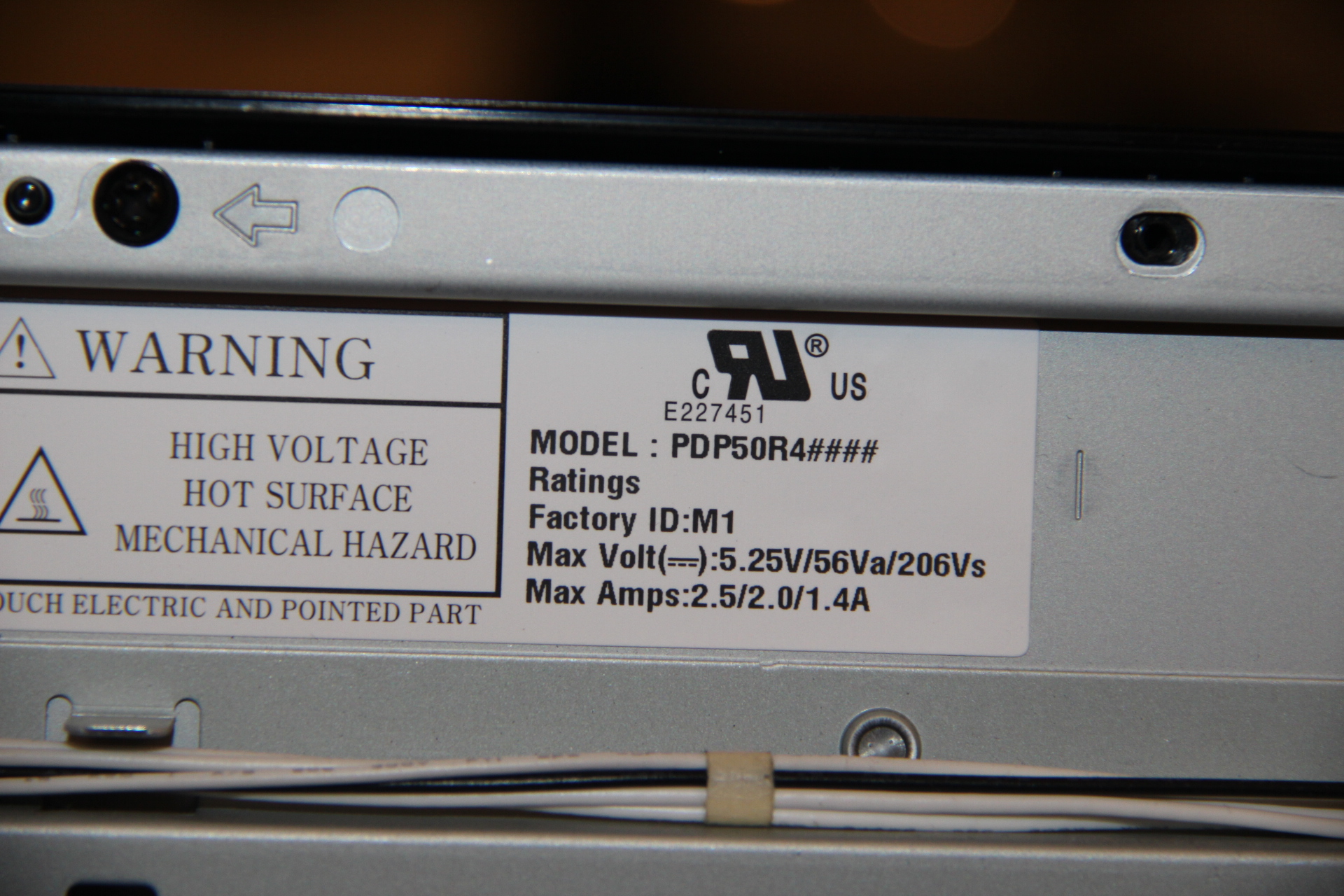

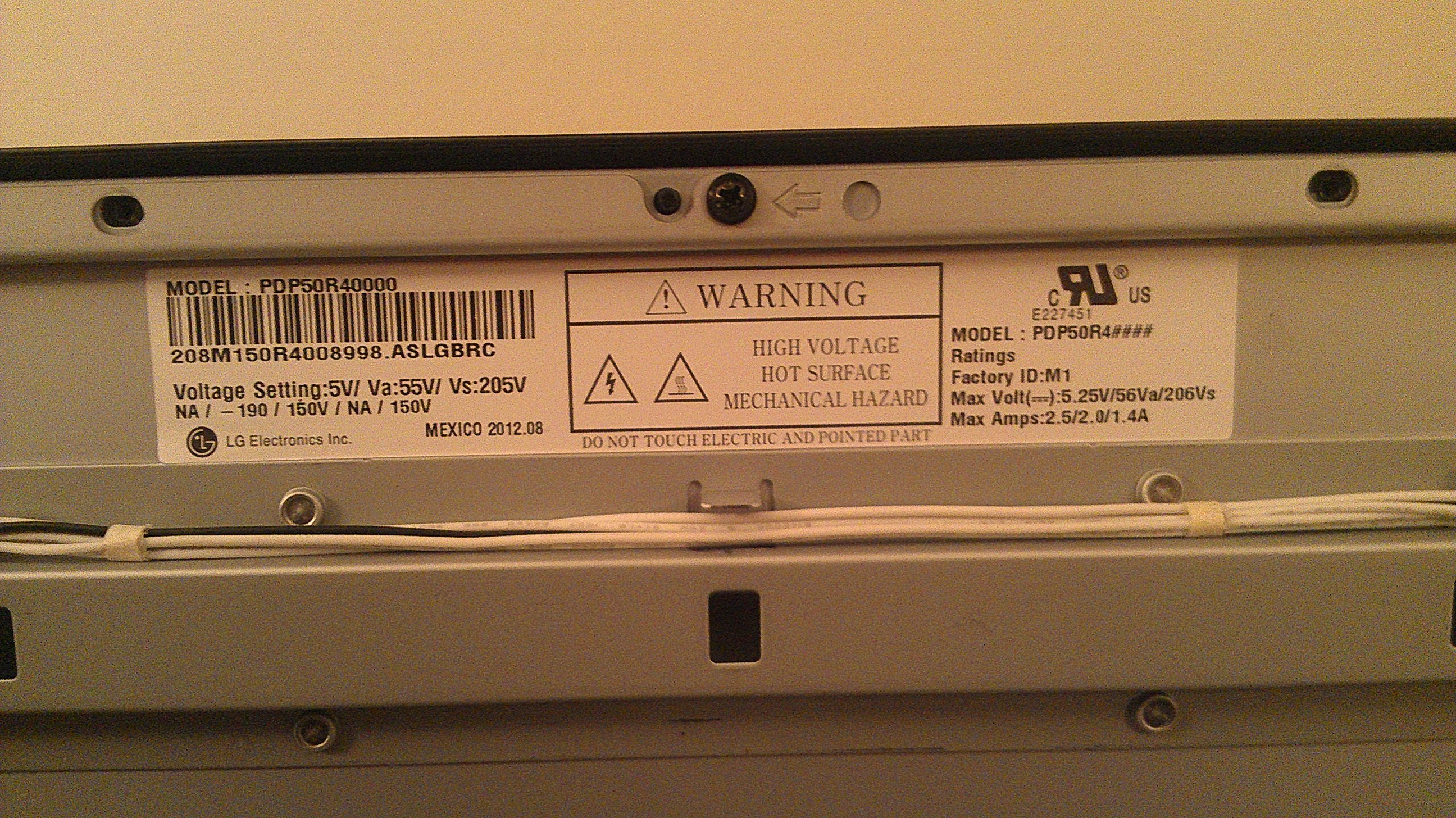

          You should provide some pictures of inside the TV ("the chassis") so we can see what parts are inside the TV. Ideally one of the overall layout, one of the "LG Electronics PDP 50R123456789" sticker (inside the unit not on the rear) and one of each major, large circuit board.
          The test only requires a bent paperclip or a small piece of wire, to engage the test point which can be marked on the photos.

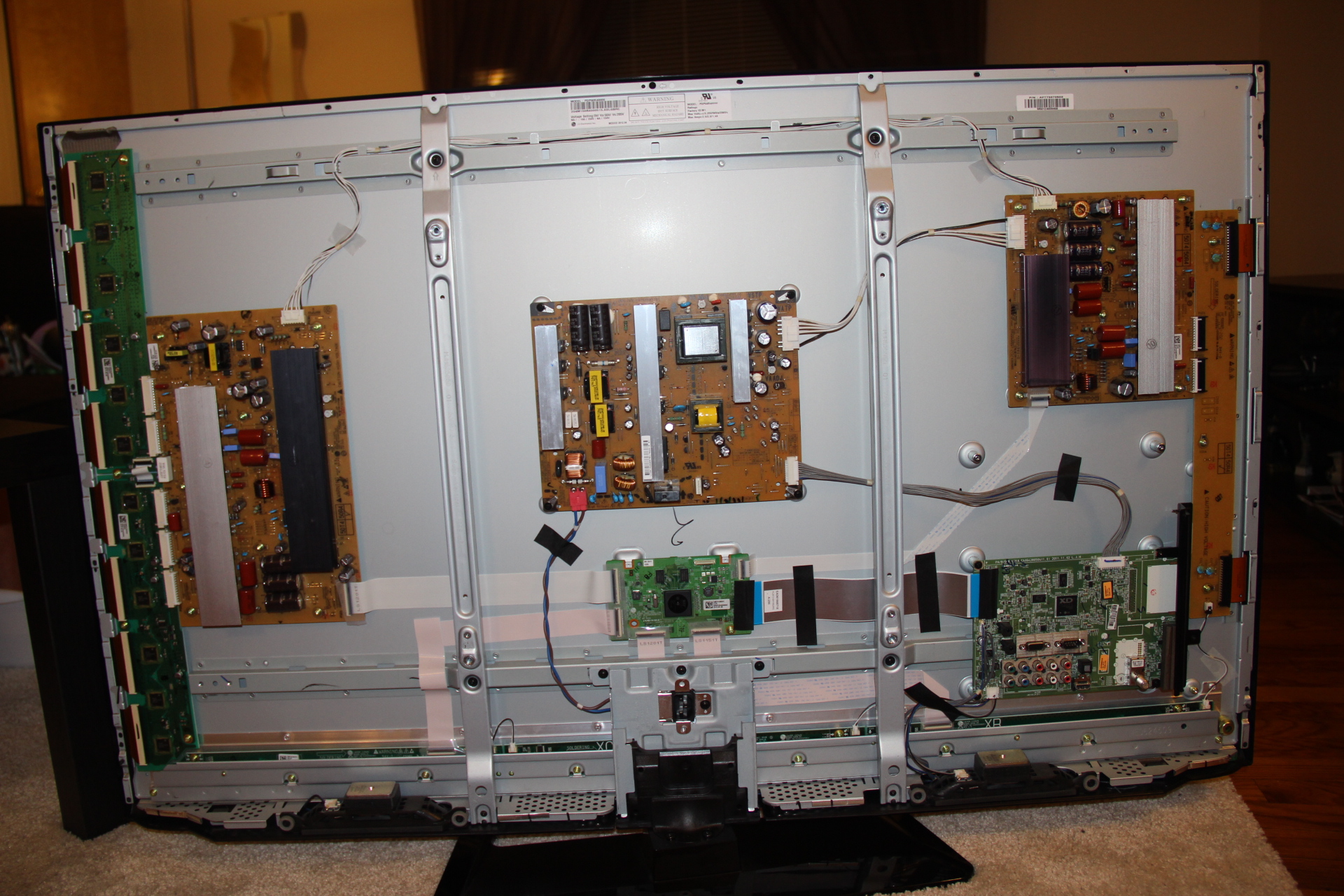

            Reading this thread, I got that there is a quick test. But you need some photos. As the author has not provided, so let me.

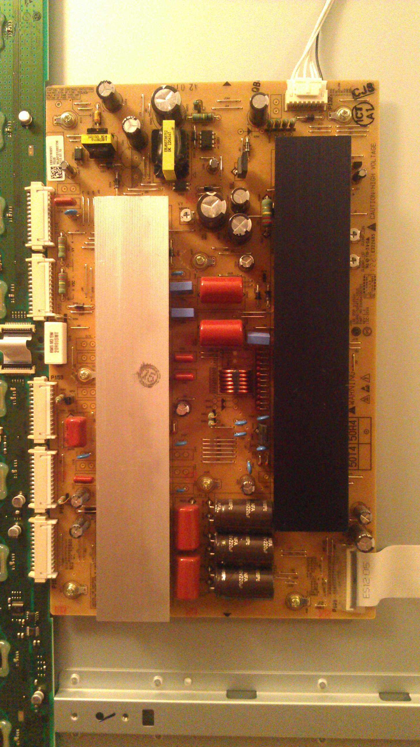

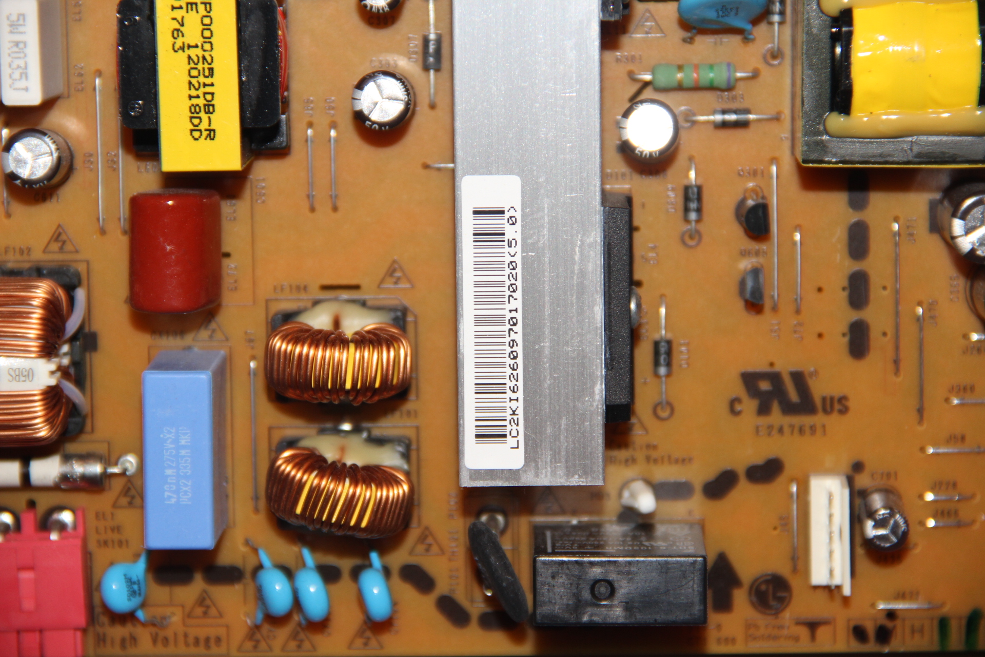

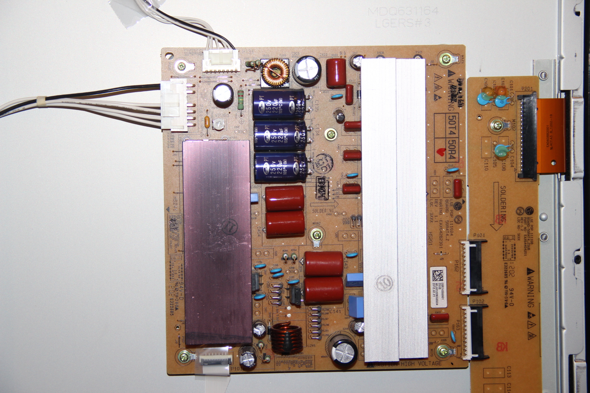

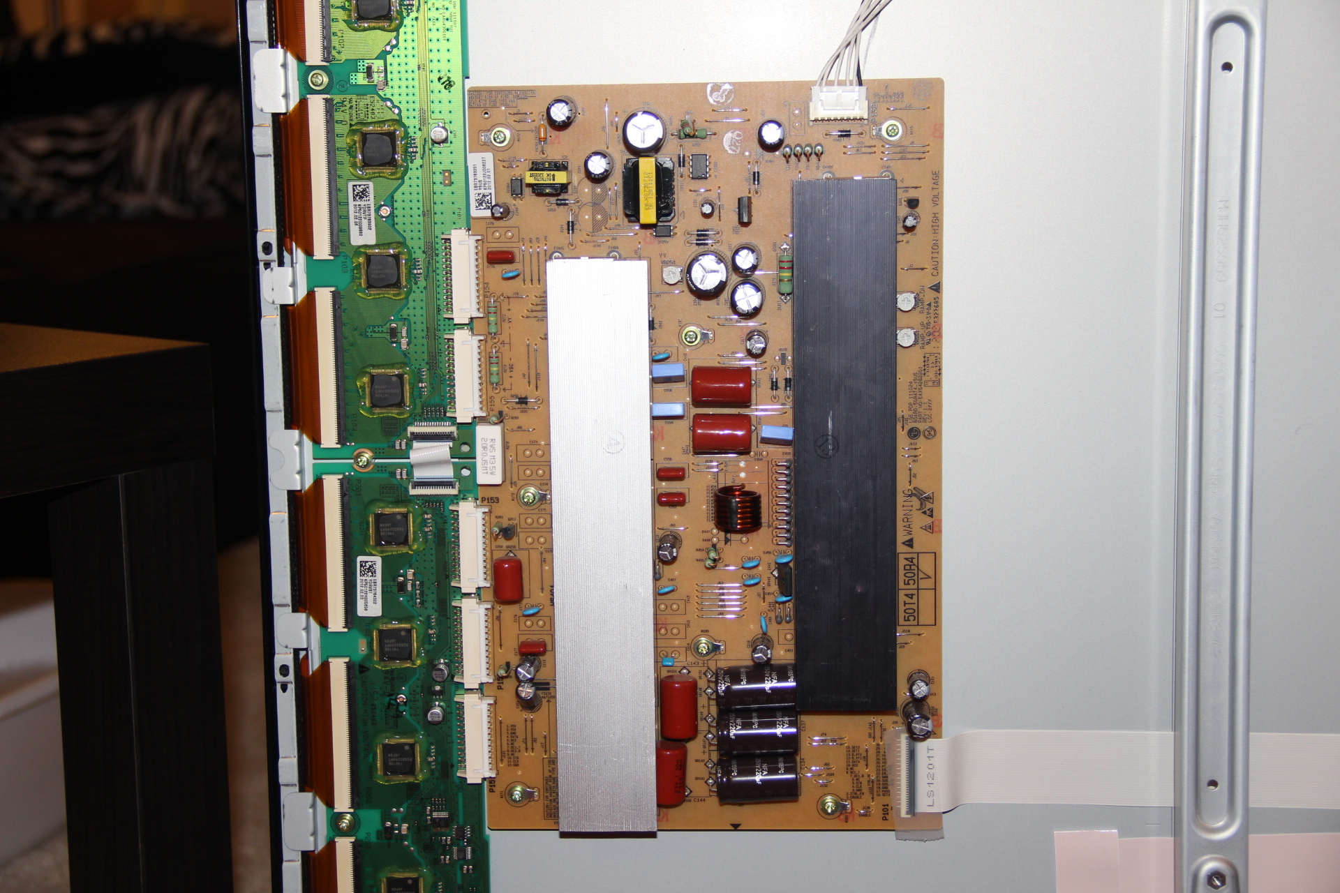

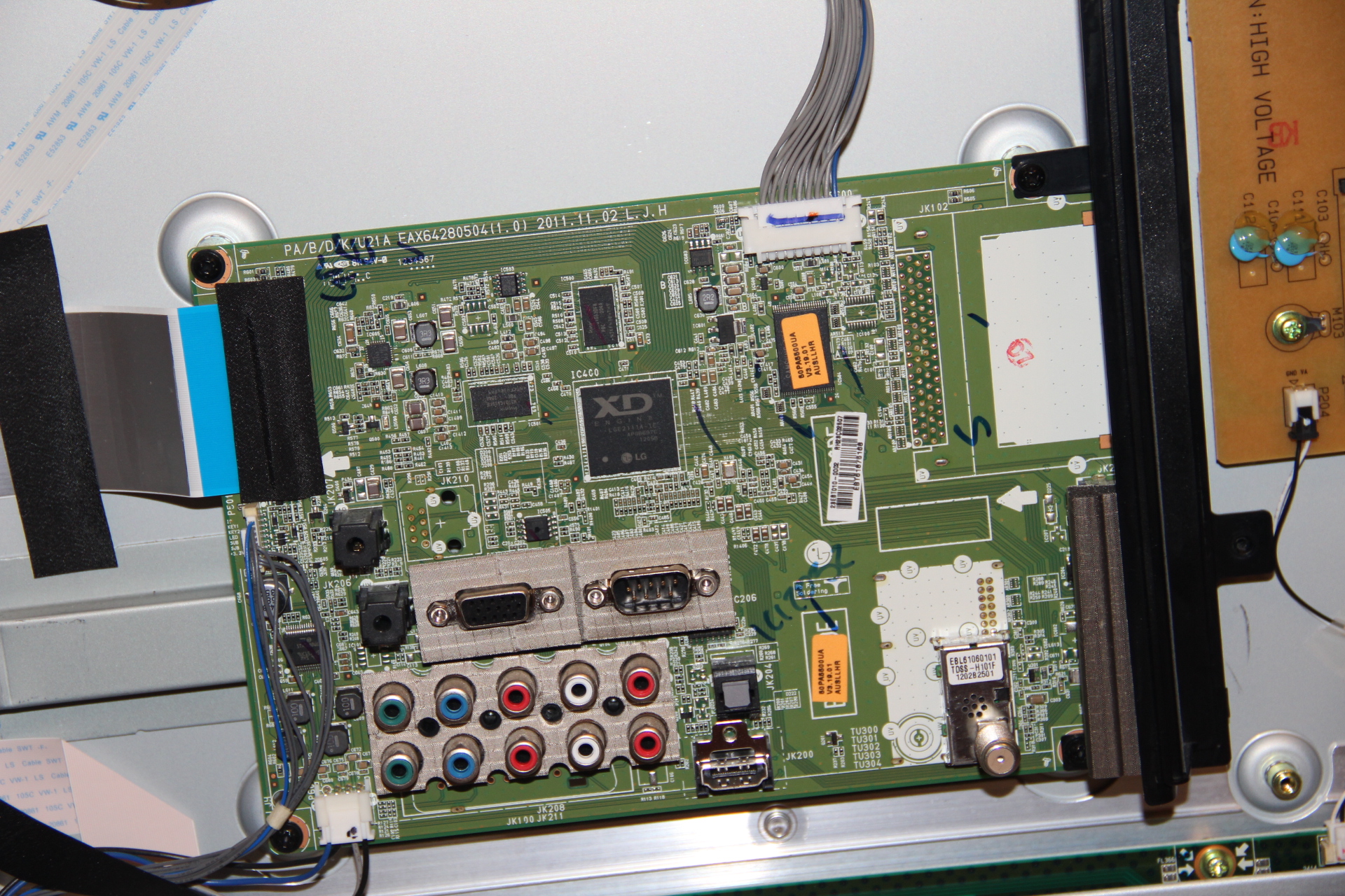

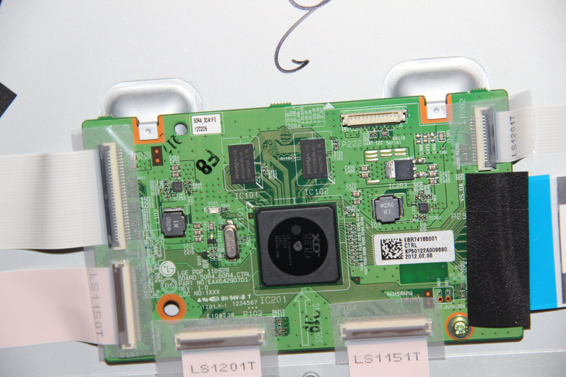

              Re: LG Plasma 50PA5500

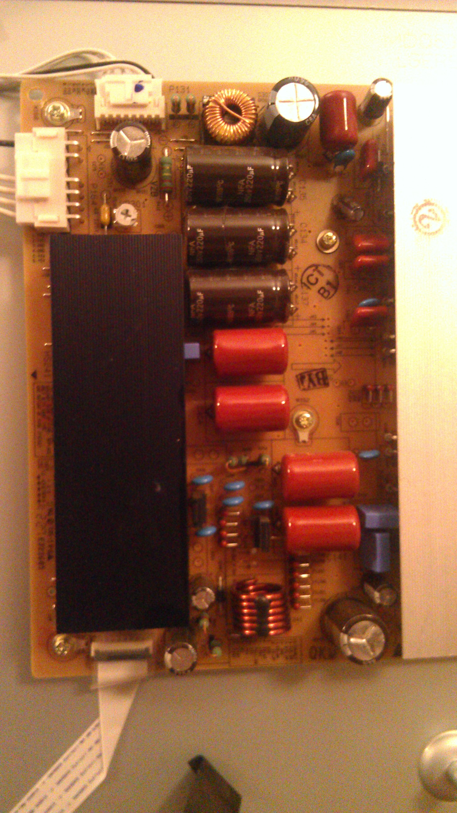

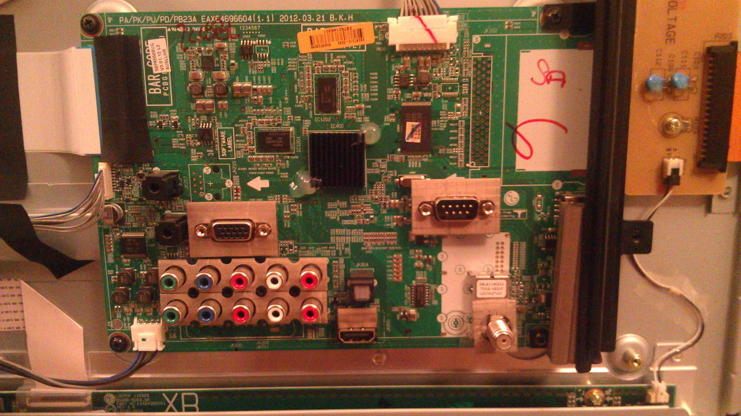

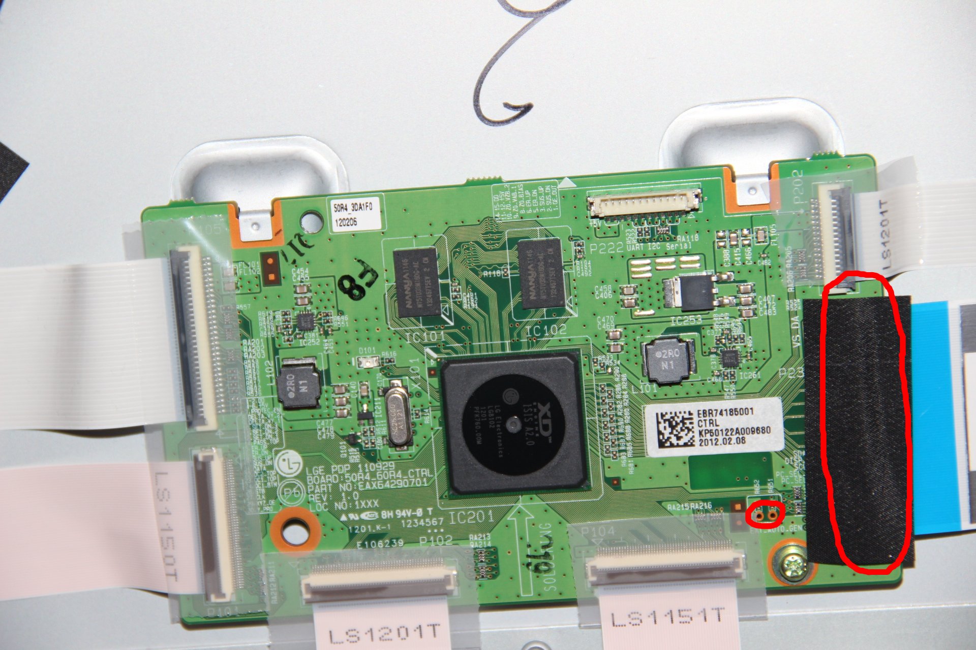

              okay here are my inside pics
                OK, this will apply to both of you.
                Unplug the power to the unit from the plug.
                Disconnect the red highlighted connector (covered with tape.) Keep the tape, you'll need to reconnect this later.
                Place a wire jumper across the other highlighted points - EXT AUTO GEN.
                Power up the TV.
                You should see a test pattern, something like this although it may vary slightly:
                http://www.youtube.com/watch?v=xgrvRc2JVVQ
                If you do, the problem is almost certainly the main board (99%), so you can replace it and your TV should be fixed. After replacing it, I recommend installing any firmware updates that LG have supplied, which may make it more rugged.
                  For reference, this is the main board, the above board is the control board.
                      With everything back to normal, can you see the screen lit up in the dark (when power applied)? Or does set just click-click? More likely to be main board or sustain board than power supply.

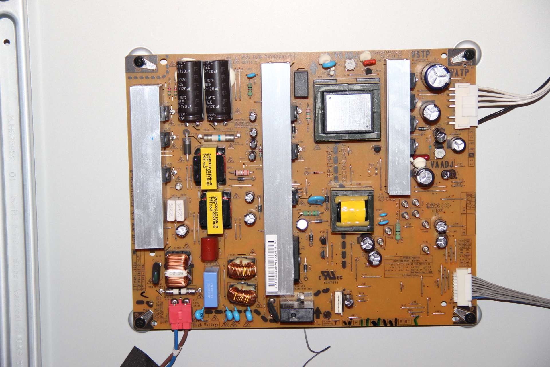

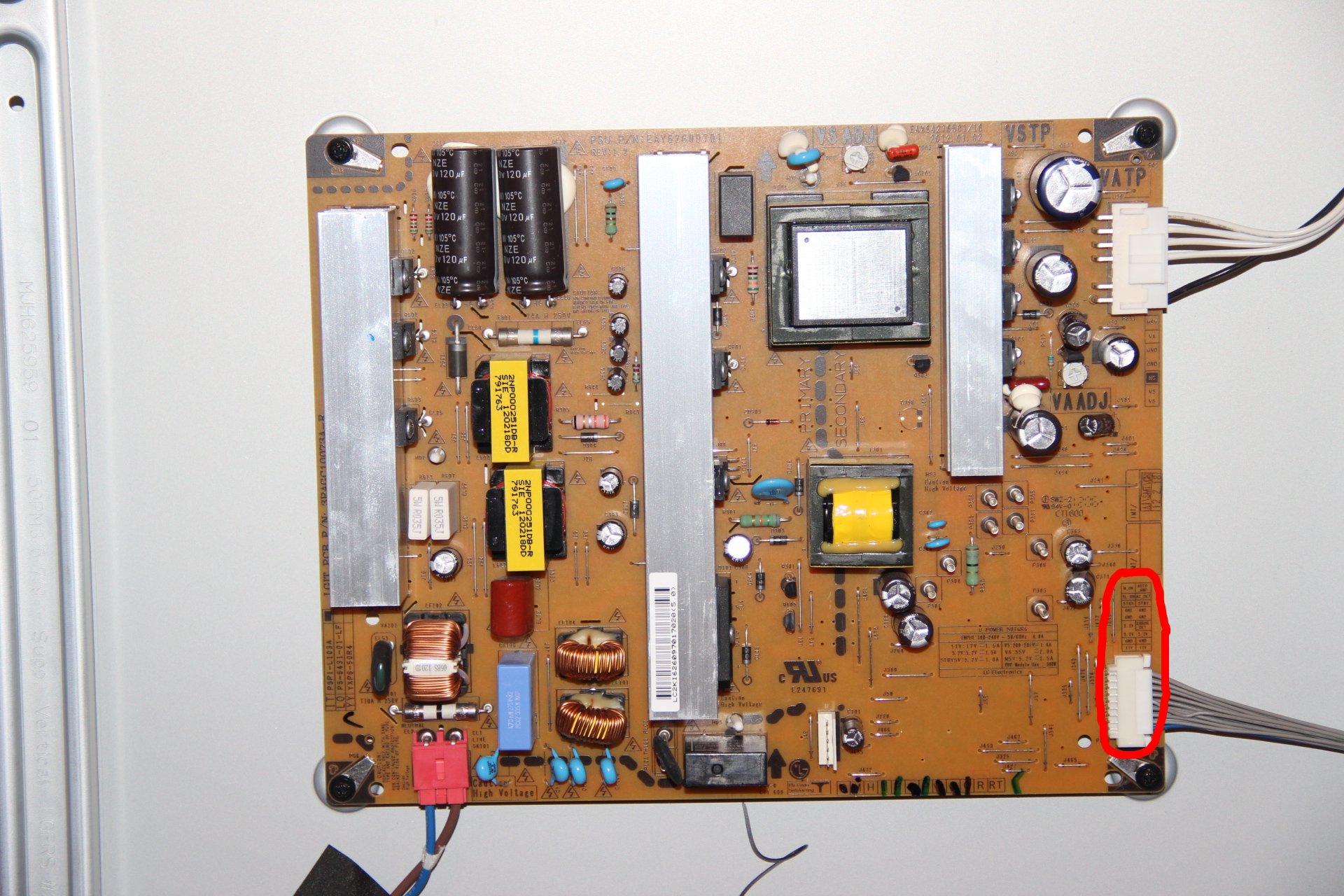

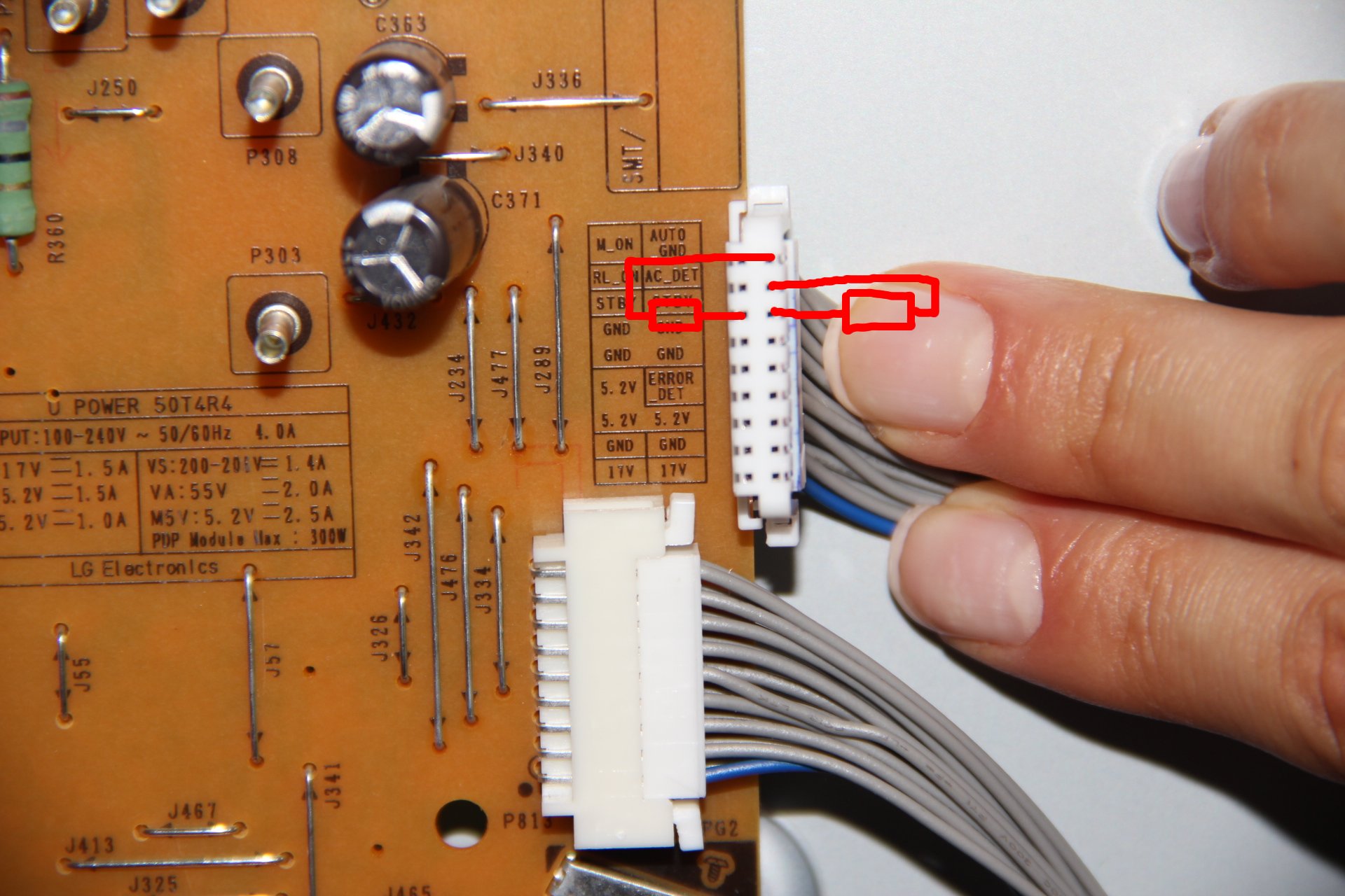

                          I meant that the screen glows slightly when powered, but in this case, it apparently does not. In which case you will need to make two jumpers on the power supply to turn it on. You will need to acquire some resistors with leads ("through hole resistors.") Any value from 100 ohm to 470 ohm is usable, but lower is better.
                          There is a grid of pins on the power supply. The connector must be unplugged on the main board end (the board with video inputs) and left connected to the power supply.
                          Resistor must be connected between STBY and M_ON and STBY and RL_ON; the jumper on the control board should also be present and the appropriate cable unplugged too.
                          Then the screen should come on and show test patterns if it is a main board issue, otherwise it may be a power board, sustain board, or other fault.

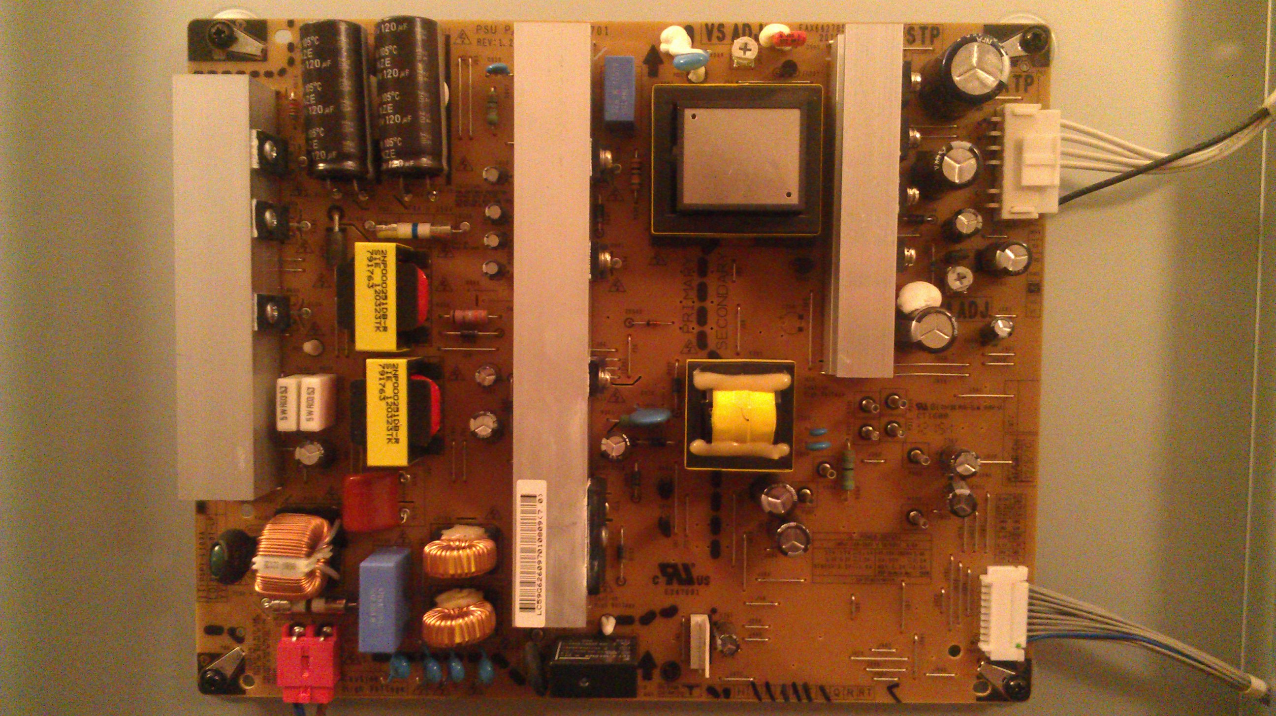

                            Now it's a next level .

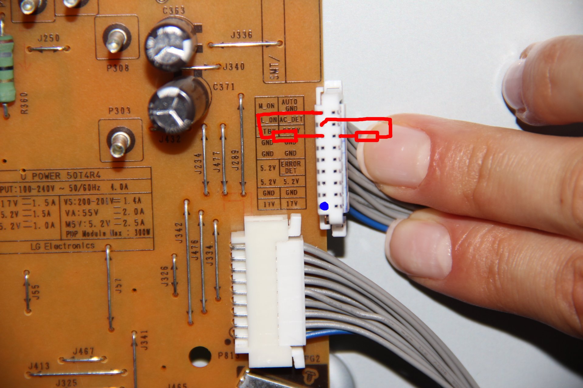

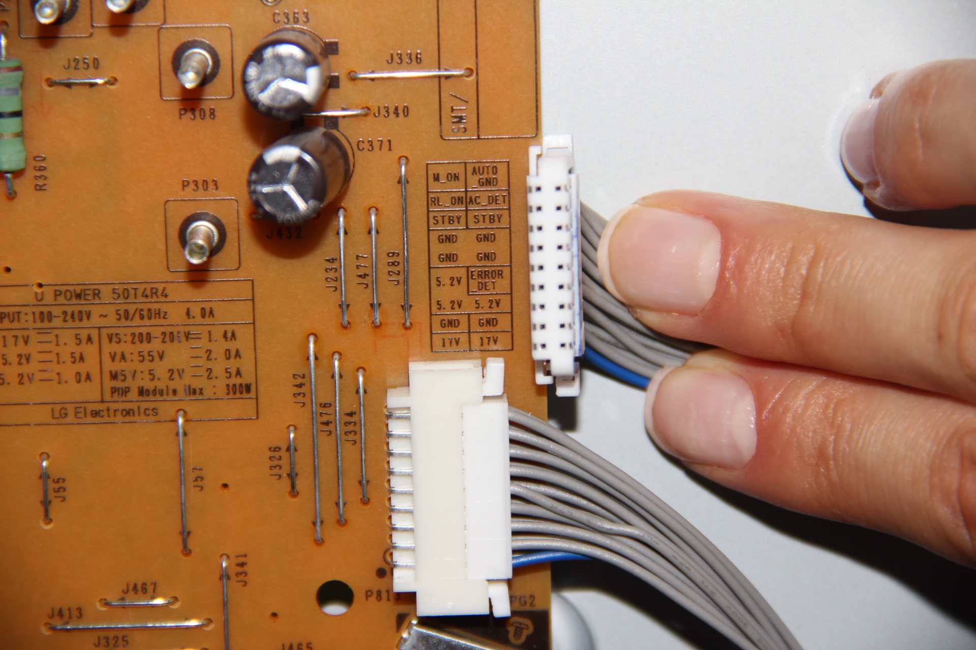

                            1. Could you provide a picture of a resistor with leads ("through hole resistors.") (sorry, but I'm ignorant in this question). I googled it and got some picture about it.
                            2. "There is a grid of pins on the power supply. The connector must be unplugged on the main board end (the board with video inputs) and left connected to the power supply." - it's easy - done;
                            3. "Resistor must be connected between STBY and M_ON and STBY and RL_ON" could you show in the picture, what spot should I put a resistor? (I attach the according file);
                            4. " the jumper on the control board should also be present and the appropriate cable unplugged too." Now I know what is that "power supply", "main board" but do not know where "control board".
                              Here are some resistors. You can buy them from RadioShack, Fry's and other electronic shops. Buy the smallest or second smallest you can. If the clerk asks, you want a "1/4W 5% carbon film resistor" ("one-quarter watt five-percent") with a value of "100 ohms" (but if they don't stock those, try 120, 150, 180, 220, 270, 330, 390 and 470 ohms.) Should be under a dollar for around 10 resistors.
                              As for the connector, you'll need to bend the leads of the resistors and put them how I've highlighted. Get them in the right pins but the exact position isn't critical and they can go either way around (i.e. they are not polarised.) Try to make sure that they don't touch each other. NOTE: This image assumes the blue wire is in the place I've highlighted; if not, flip/rotate the connector until it is or you may damage your resistors or power supply.
                              The control board is the board you put the EXT AUTO GEN jumper on. In this instance, you want to leave that jumper in place and also keep the cable that connects between the main board and control board disconnected.
                                Now it's almost clear what to do next.
                                Only one concern regarding to the note "this image assumes the blue wire is in the place I've highlighted".
                                The blue wire is in the place I've marked. Should I still follow the schema you drew?
                                  In which case follow this diagram.
