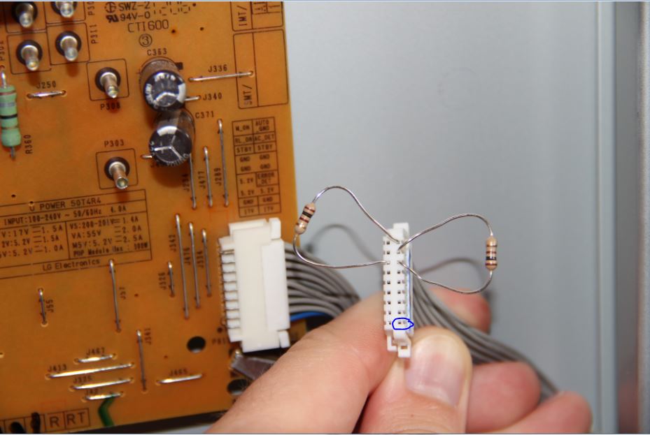

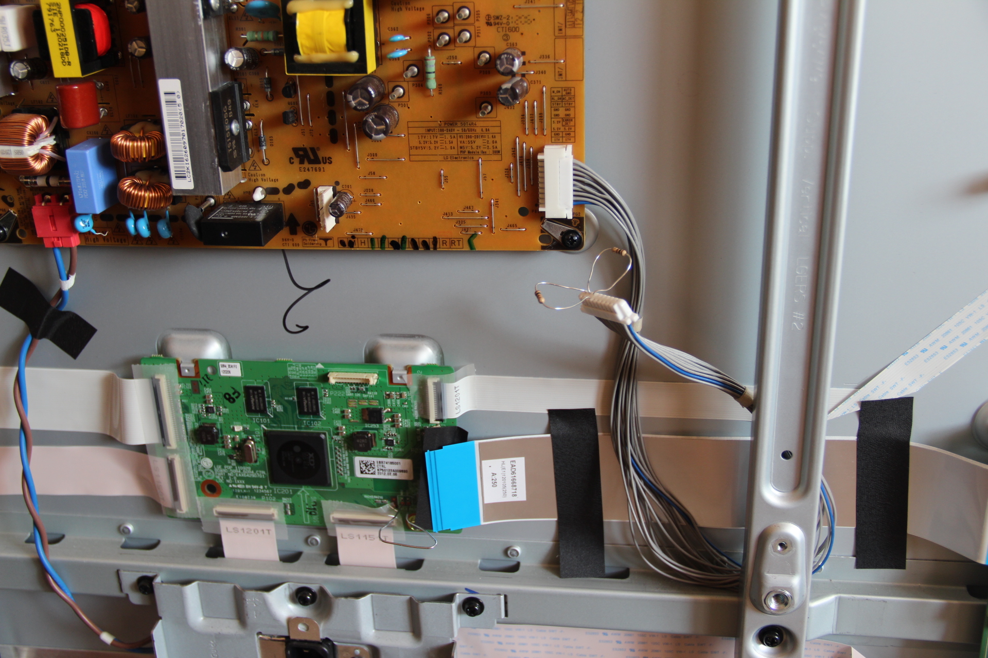

      I followed "Test_2", the same:
      - Click by click from power board;
      - black screen.
        Re: LG Plasma 50PA5500
        OK, can you show me how you have set up the resistors?
        Does the screen glow, visible in a dark room?
        Next step will be isolation of the circuit boards.
          Please see the files.
          Right now it's not dark, but i'm sure that there wasn't any glow.
          Need to see in the picture
          • dyel
            • Jun 2013
            • 19
            Have I set up the resistors correctly?
              They appear correct. At this point you will need a digital multimeter, do you have one?

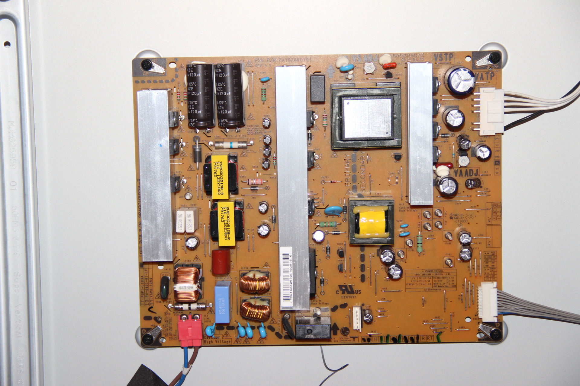

                  You can check the VS and VA high voltage to see if the power supply is working or not.
                  A basic digital multimeter, available for less than $10 from good shops, will do well.

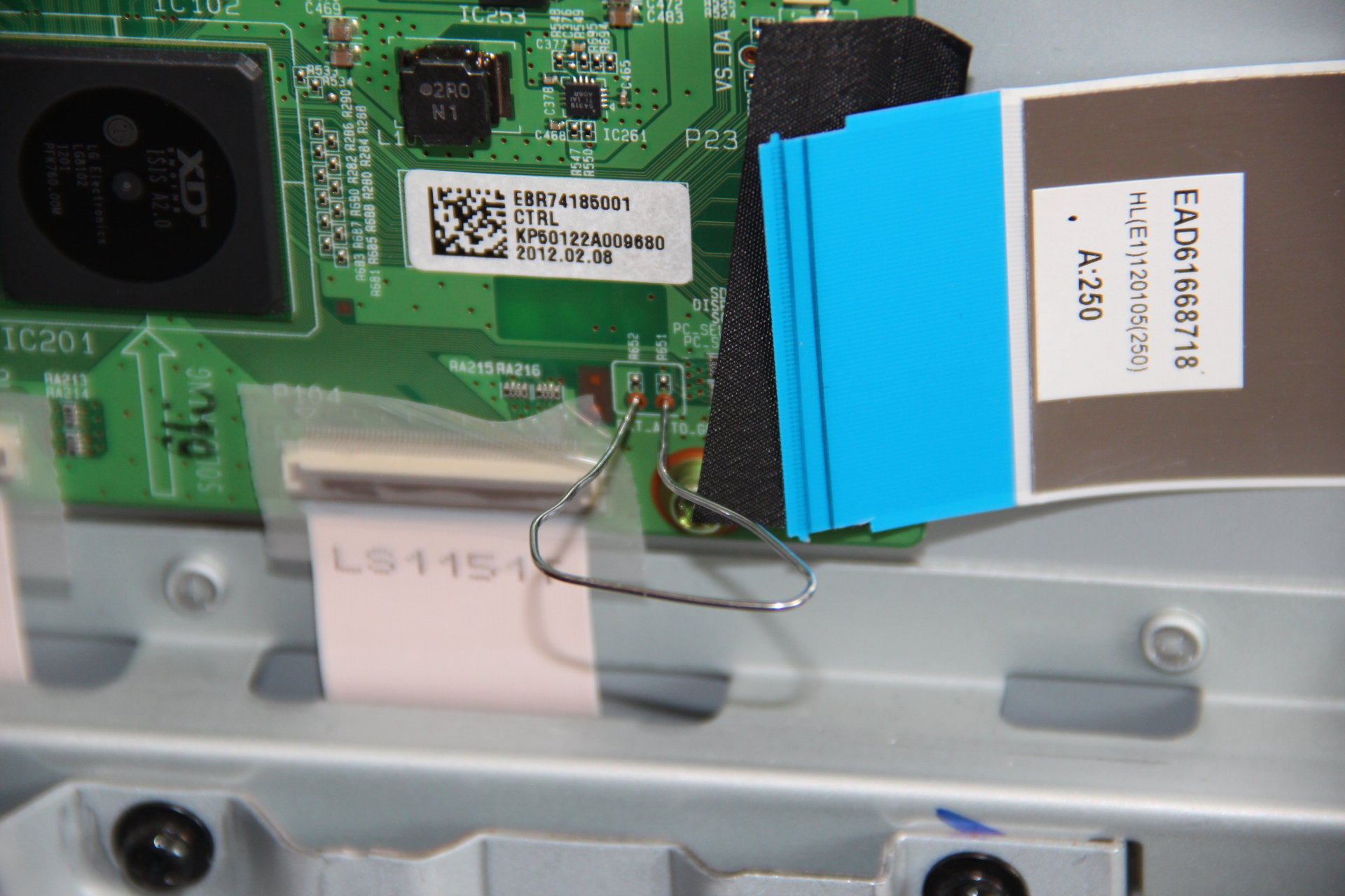

                    #29
                    hm..okay so I got the new main board and put it in. connected everything back plugged it in and it started cycling through the test pattern. I thought well that's odd so I redid the step you had me do earlier minus the bridging And it still went through the test pattern. Only now I have white noise with the pattern where as I didn't before
                      #30
                      Check under the control board to make sure you have no stray conductor/wire (holes on EXT AUTO GEN need be open), and make sure the cable between the main board and control board is correctly connected.

                        #31
                        I dbl checked all that and I can't find anything that seems to be wrong....I even put the old board back in and without the jump it still does the test pattern too. only without sound.
                          #32
                          Well, that is very unusual. Nothing under the board at all? Any scratching or contamination between the holes you bridged?
                                    I got a multimeter. Could you draw in the picture, where should i put the negative and positive lead to check VS and VA?
                                    • capkid
                                      • Oct 2010
                                      • 1339
                                      #38
                                      In the upper-right hand corner, there are two jumper wires labeled "VS TP" and "VA TP". Place your positive lead on each of those, respectively, and place your negative lead on a metal part of the TV chassis.
                                      Edit: I didn't realize that Tom was still online. Kind of late for you, Tom
