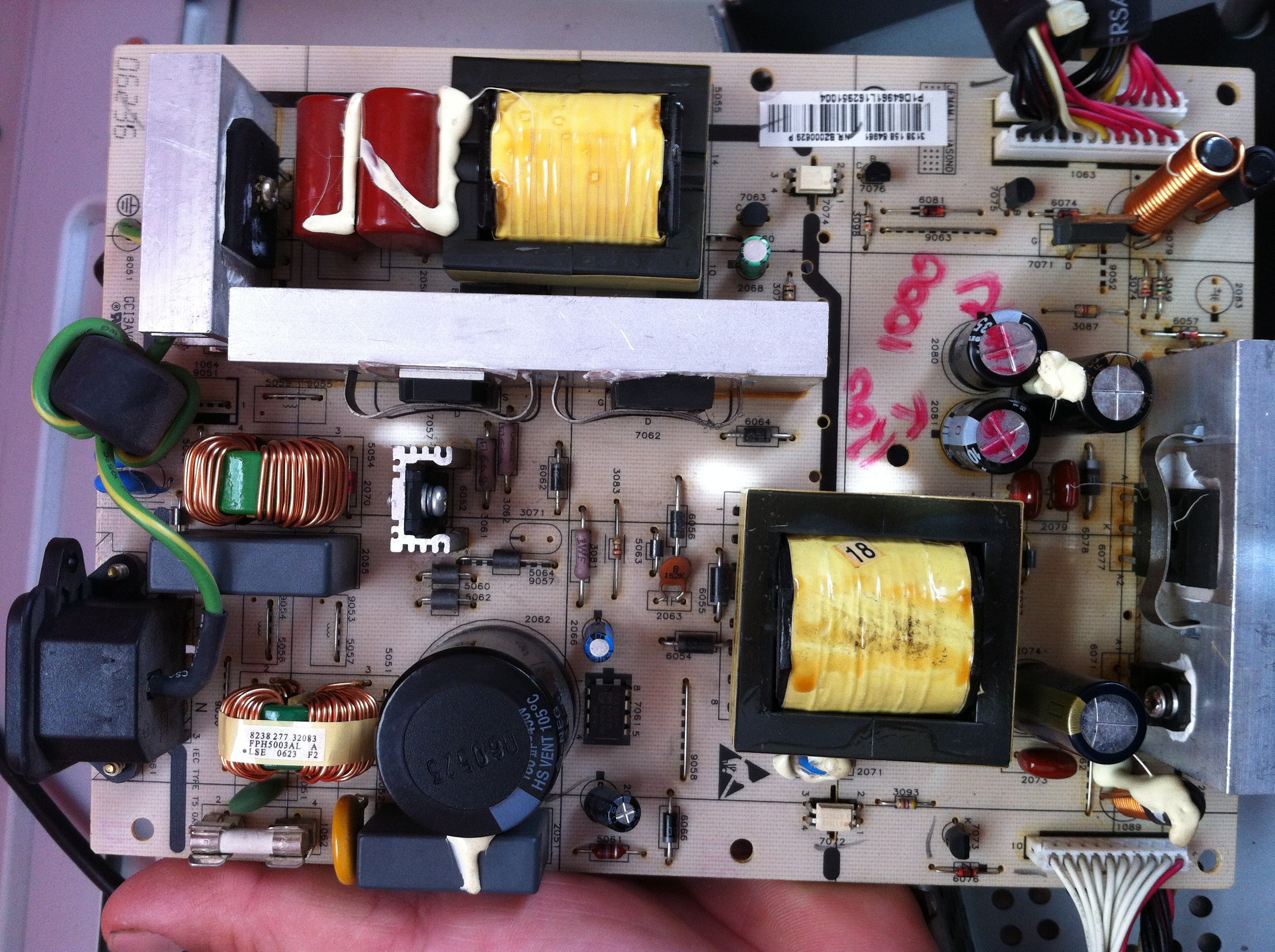

    hello, so long story short is my lcd magnavox did not turn on yesterday
    so i open it again and one of the capacitor was bad ( capXon 1200uf 35v) so in local store they sold me ( nichicon 1000uf 35 v ) so today i change it , but still nothing not even blinking light !!
    But i can hear wierd sound coming from the power board , like hissing ?
    here is my short video where u can actually hear the sound
    http://m.youtube.com/watch?v=vlP7nQB_Bes&feature=plcp
    please check the video and if u have any idea what can be the problem let me know . i dont really wanna buy all parts from the board ...
    thank you
    Re: Lcd Magnavox , ID : 37MF231D/38 DEATH. PLS help
    It's not a great idea to replace a 1200uF with a 1000uF. In addition with one bad cap it's a good idea to replace all of them on the secondary.
    A common issue on these boards is a failed diode on the primary side. Can you post a pictre of your power board?
      power board :

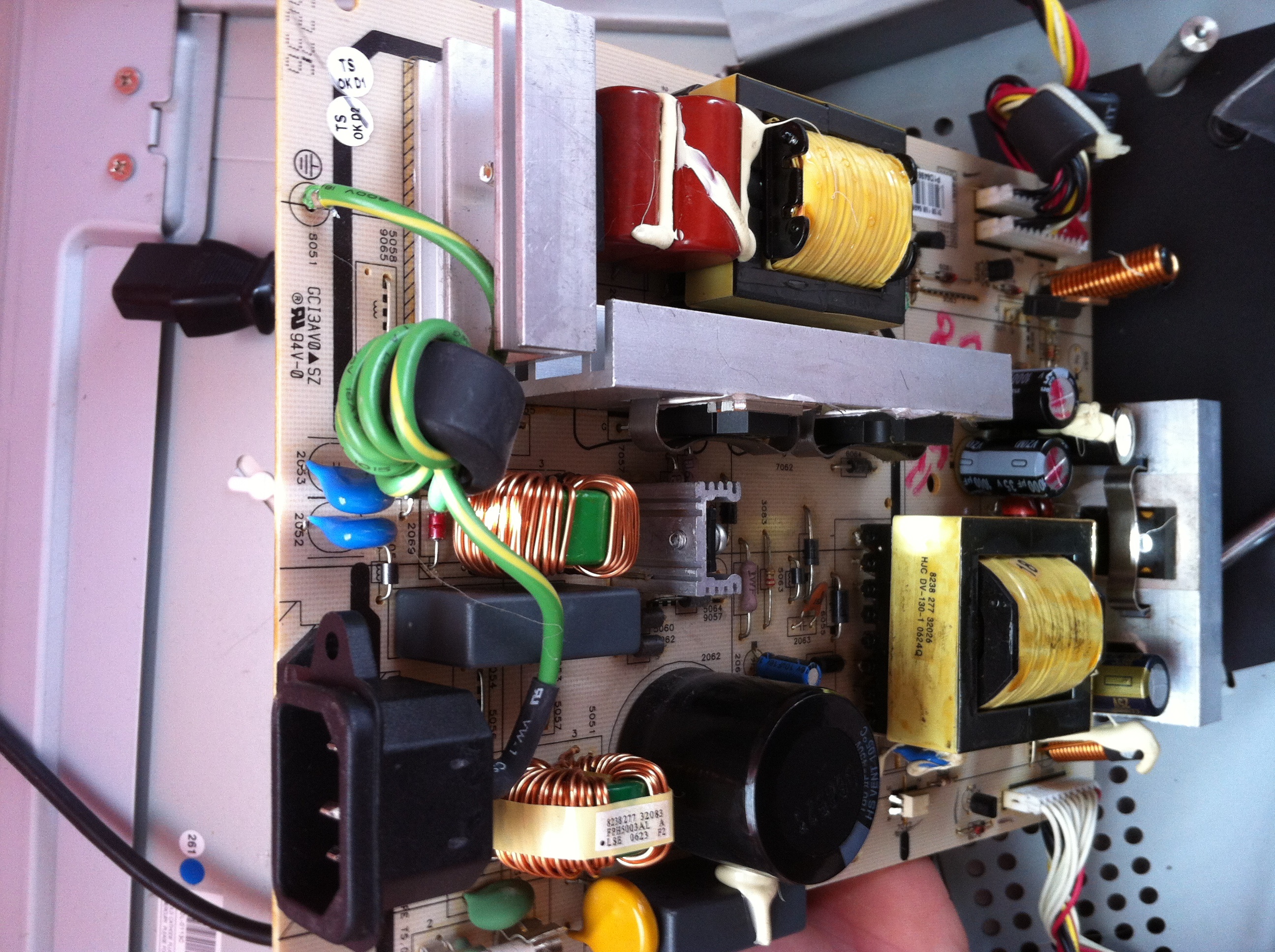

        power board pic2
              Diodes 6064, 6056, 6055, 6054 should be checked for shorts.
              Replace the VZ with Panasonic FM/FR/FC (available from digikey or other good suppliers)
                hi , so i just replace all three caps with Panasonic caps ,
                BUT right now i dont have any sound or light nowhere its just death ((
                any suggestions ???
                    Hi all , fast question ...
                    I find out that fuse blow out after changing caps .. So I order new one but the old one says
                    LF.T5AH250VP The new one says T5A250V is there any difference???
                    Because I try the new one and still no power and the new fuse did not blow .
                    Also I check the diodes and did not find bad one yet ..
                    Any idea about the fuses ?
                      just tried another fuse and it blowout right away ! a short right ?
