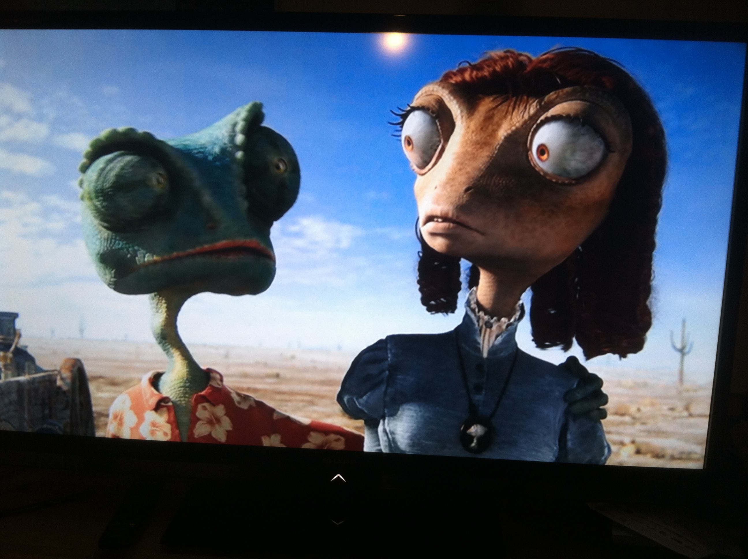

          Found a PSU on eBay for $45. I figured it was worth it to not have to spend the time fixing the old one. Looks like I didn't need the main board after all.
            Re: Sharp LC-52LE830U Lightning Strike No Standby
            The IC was only a few bucks but it depends on how many other components were damaged, good job fixing it. How's the picture on this LED-LCD compare to a good plasma? Sharp LED-LCD are supposed to be the market leaders.
            • johnboy1313
              • Nov 2012
              • 1959
              That was my concern. There's a chance that not many other comonents got zapped, but there's a chance that several other components, including those tiny little surface mount ones, got zapped. There's also a chance that something else would go out shortly after getting the old one working again. I figured for the money, it was worth it to not have to deal with it.
              I've only played one movie through it via the Netflix app but it seems to be pretty nice.

                                      I found another. IC2005, I swapped it. It powered on! I've gotta connect something to it to verify that the HDMI is working. Fingers crossed.
                                      • johnboy1313
                                        • Nov 2012
                                        • 1959
                                        #39
                                        IT WORKS! Tom you are amazing. Thank you!
                                          #40
                                          Fantastic, enjoy!
