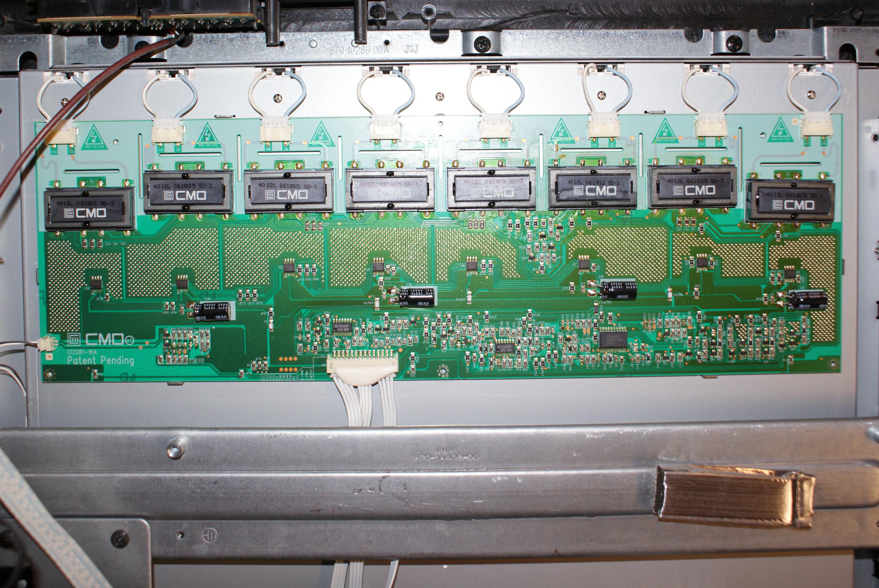

    I need to verify correct output voltage for 12v. 5v and 24v outputs correct. 12v reads 16.7v. Symptom is no pic. I can see white noise on screen with a flashlight. No back light. I don't Want to tear down any further until I confirm power supply is correct. There is a good thread on this,but the voltage question was not answered. Also any other thoughts or tests on correcting this are Appreciated. Thanks for any assistance. - Kevin
    Re: Insignia NS-32LCD voltage reading 12vdc
    is it reading 16.7 with no load? (i.e. just your DMM connected)
    If so it may just be poorly regulated (which may also be a fault in itself) and/or reliant on the load to pull the volts down to 12.
      Do you have the pictures of the inverter board? Most power supply has the 12v and the 24V to be generated by the same transformer, so I would expect the 24v to be high also since the inverter is not on, so basisally, no load on the 24v either. The battery for the meter is good, it tends to give higher reading when battery is low. 24V reads OK?
      We need to find out if the inverter board is receiving the bl_on and the Dimming signals from the main board or not and if all the fuses checked out OK on the inverter board.

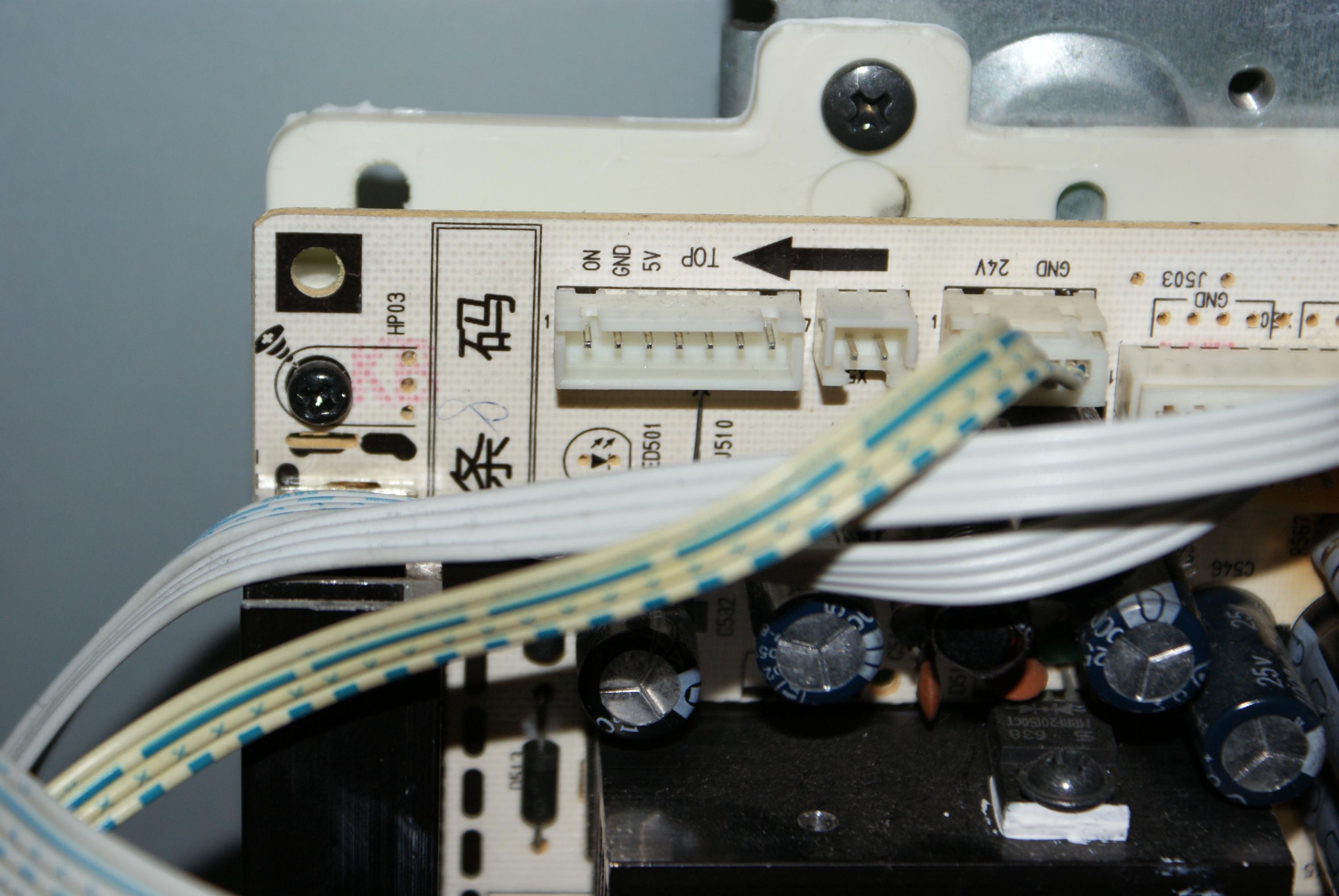

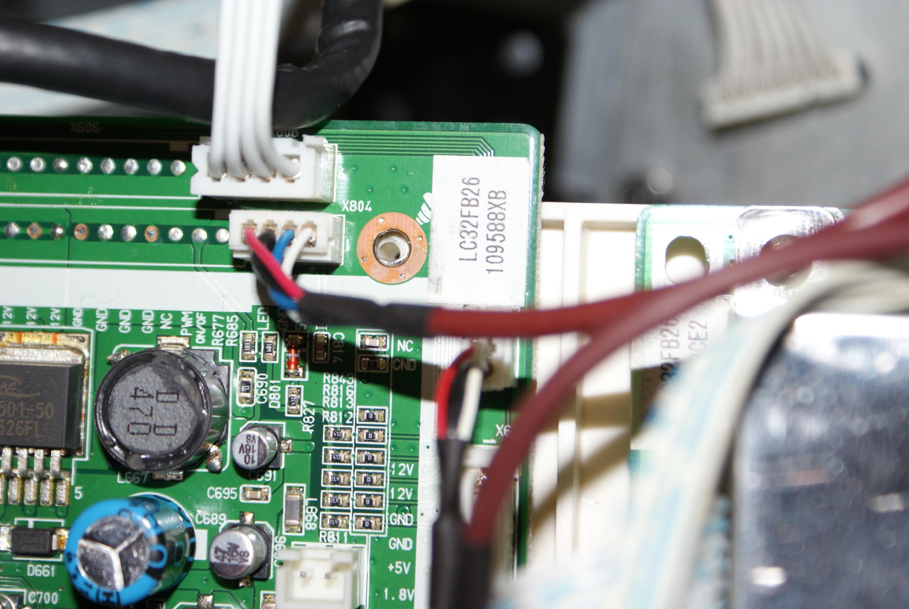

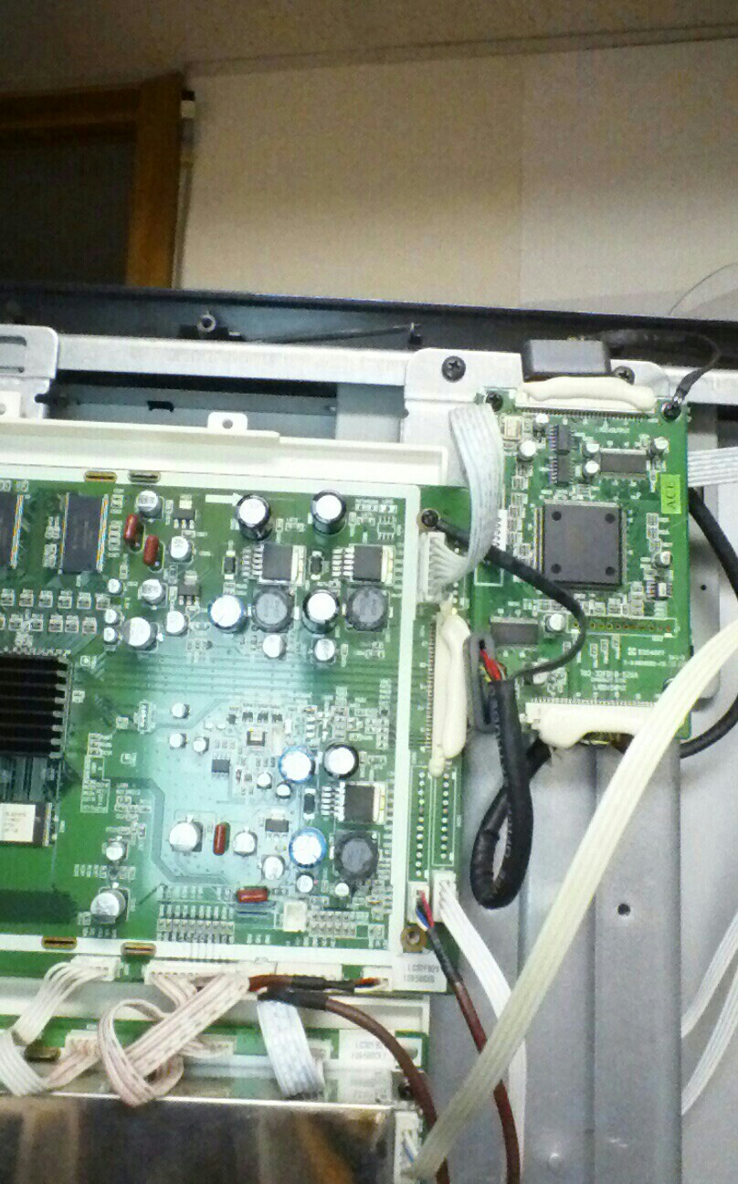

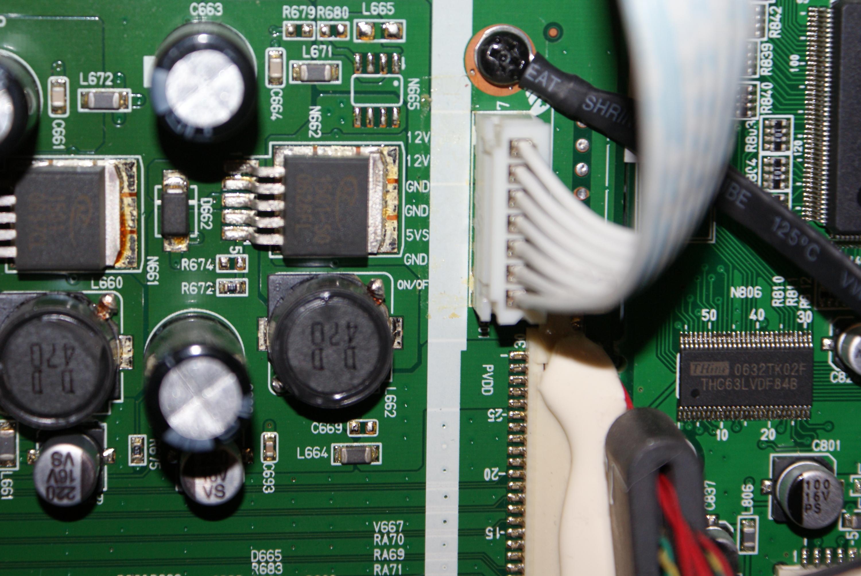

          No load. 24 Volts Volts good. The 12v is in ribbon cable with 5v and on pin to main board. 12v is marked on main board, not power supply. attached a couple of pictures.
            12V is for the audio amplifers, so I will need to see good clear pictures of the inverter board next, report any labeling next to the connectors, I need to see which pin is the BL_ON (or ON/OFF, or I/O, or Inv_ON), and pin for the Dim.

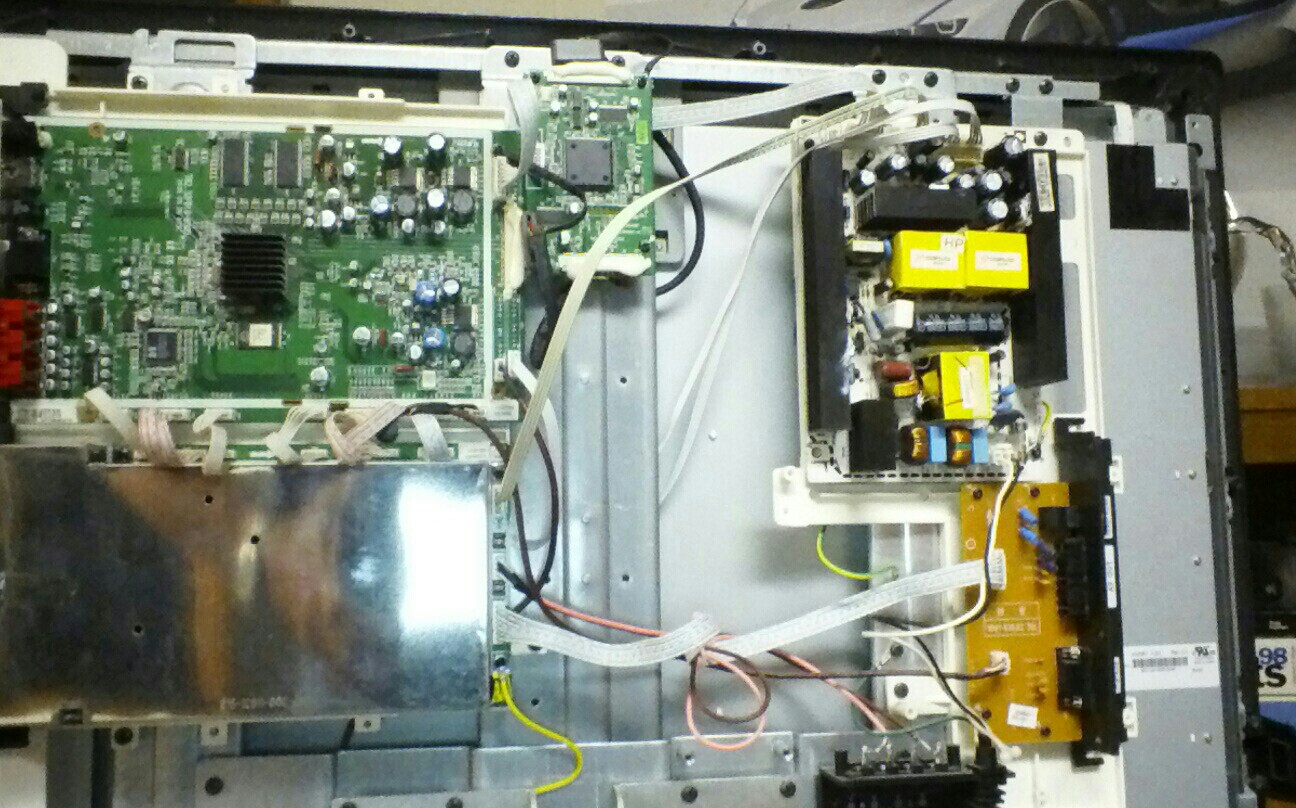

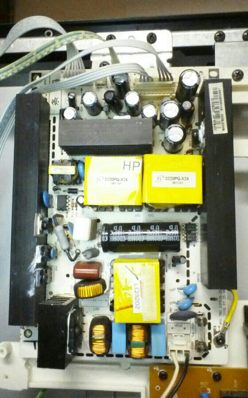

              Is this what you need to see? When you refer to inverter board is it the Power supply or another board?
                It is the big long board under the metal cover, there will be a bundle of the wires between this inverter board and the power supply 24Vdc connector. Looking at the back of the TV, it will on the left side I believe.

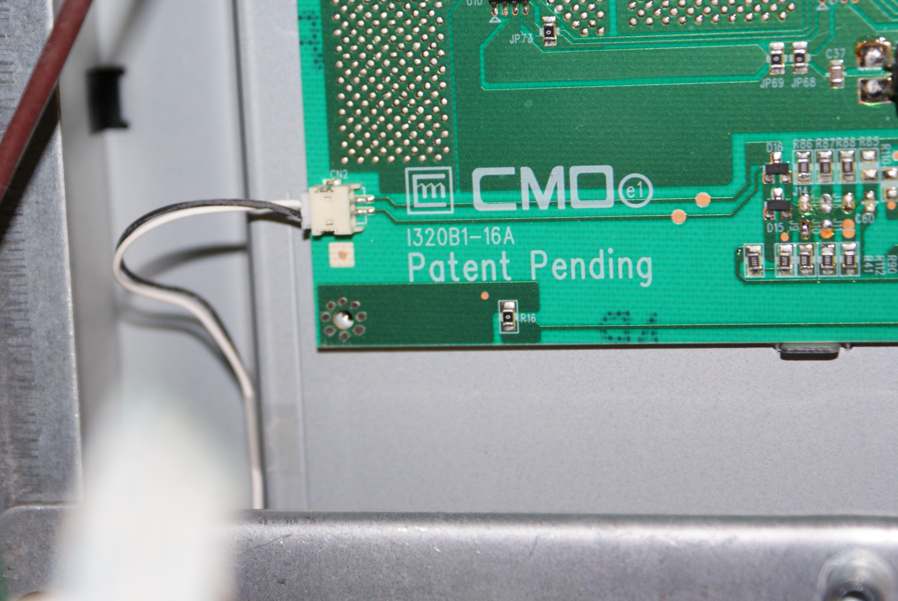

                    If the board is made by CMO, we will be looking for small black fuse with either '15' or '20' printed on top of the body.

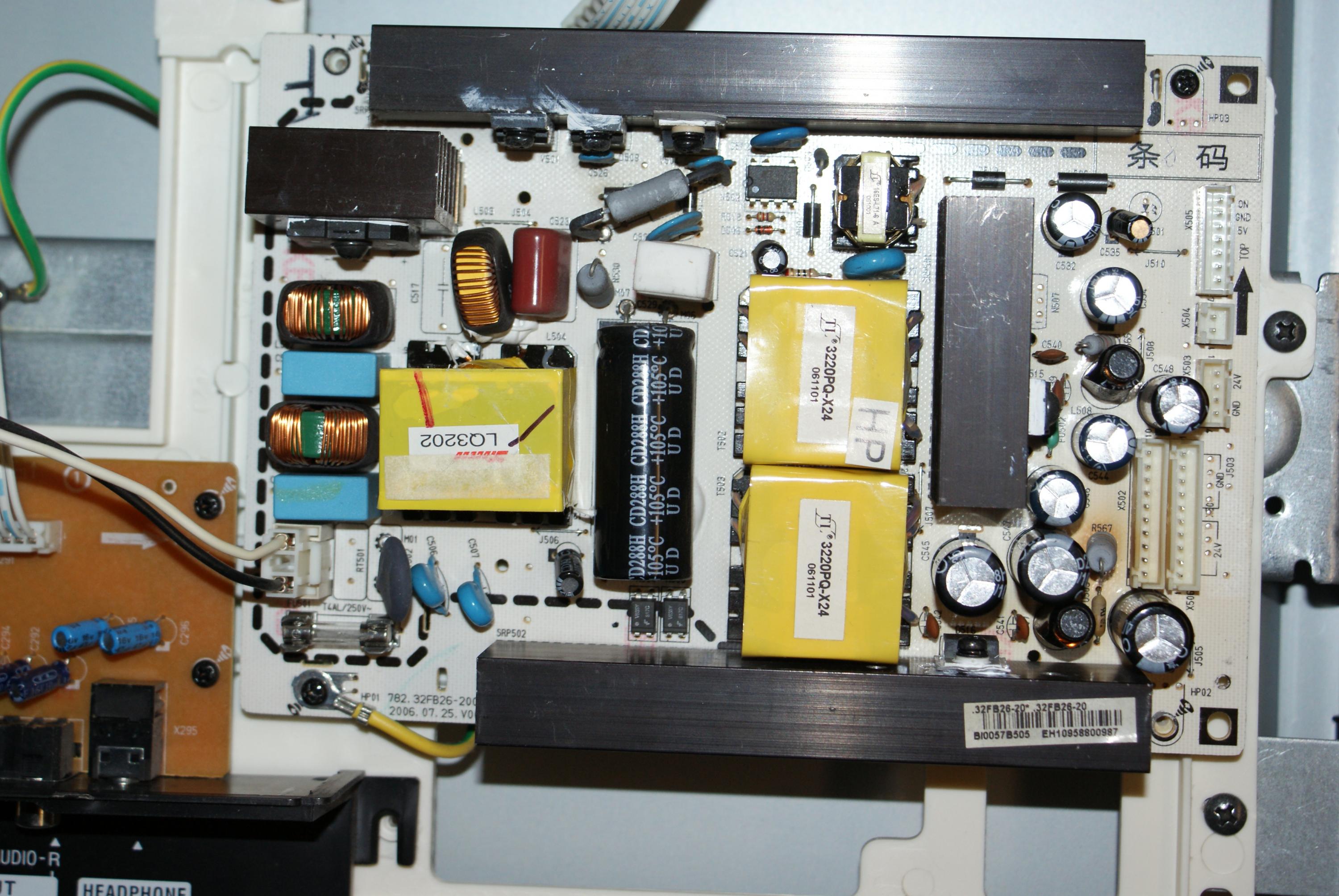

                      I worked on a similar model before, "12V" is used by the audio amplifiers and should measure around 16 to 18V.

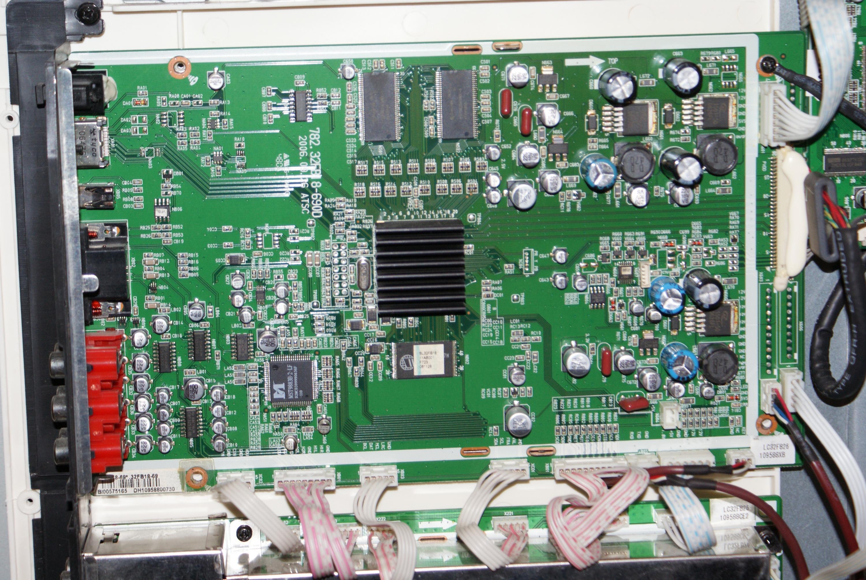

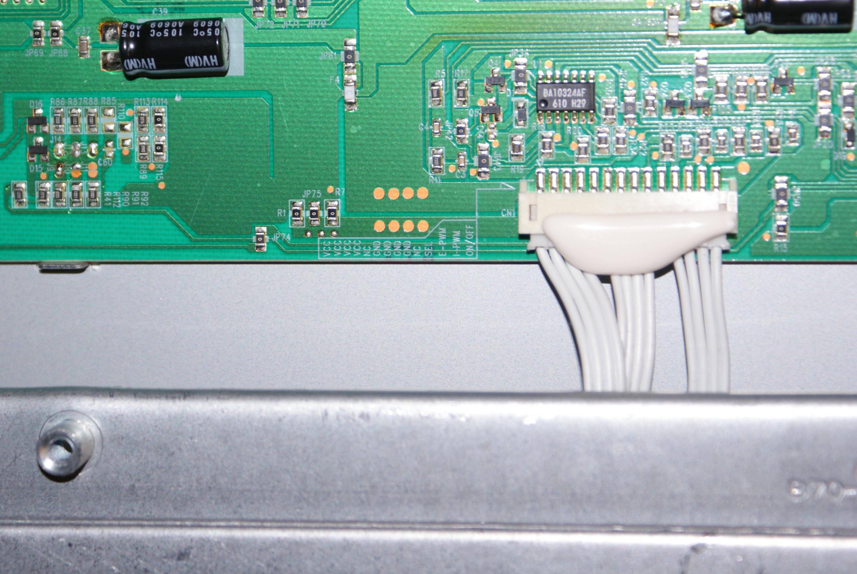

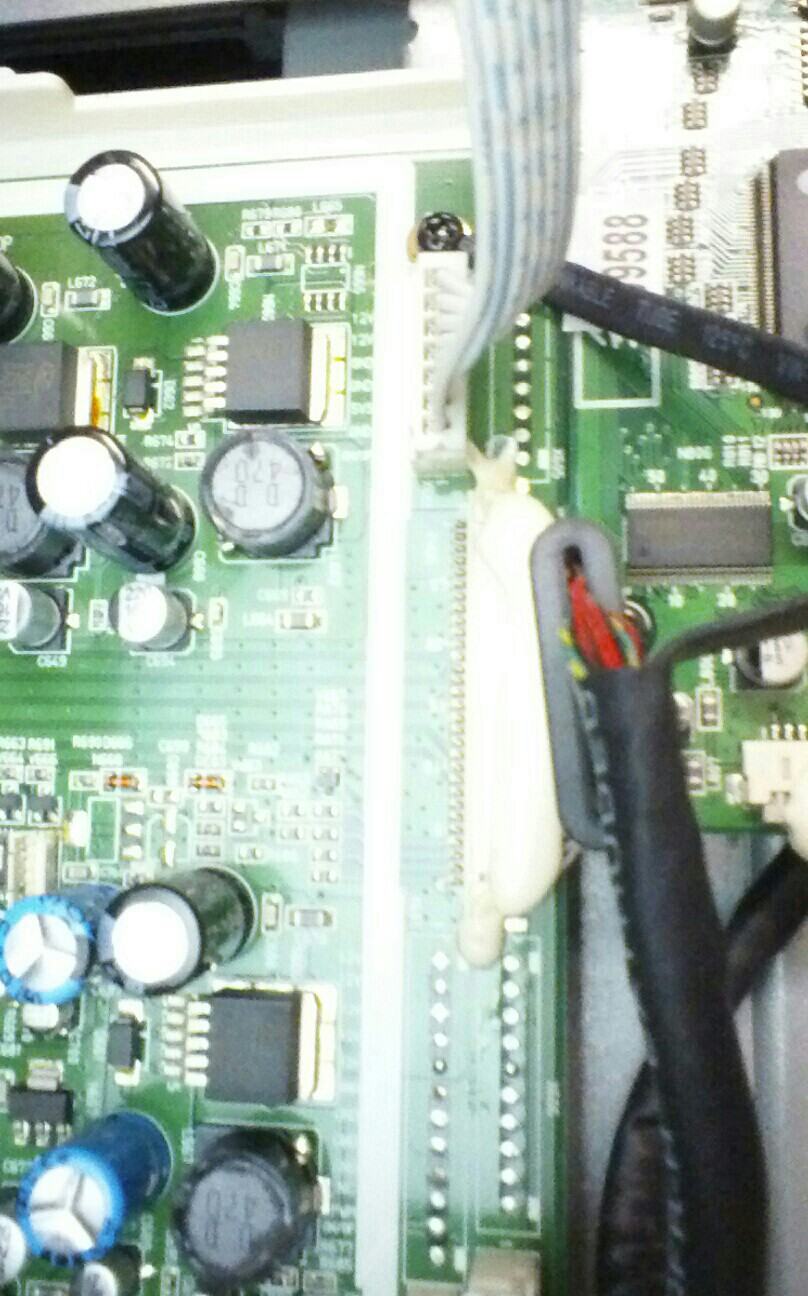

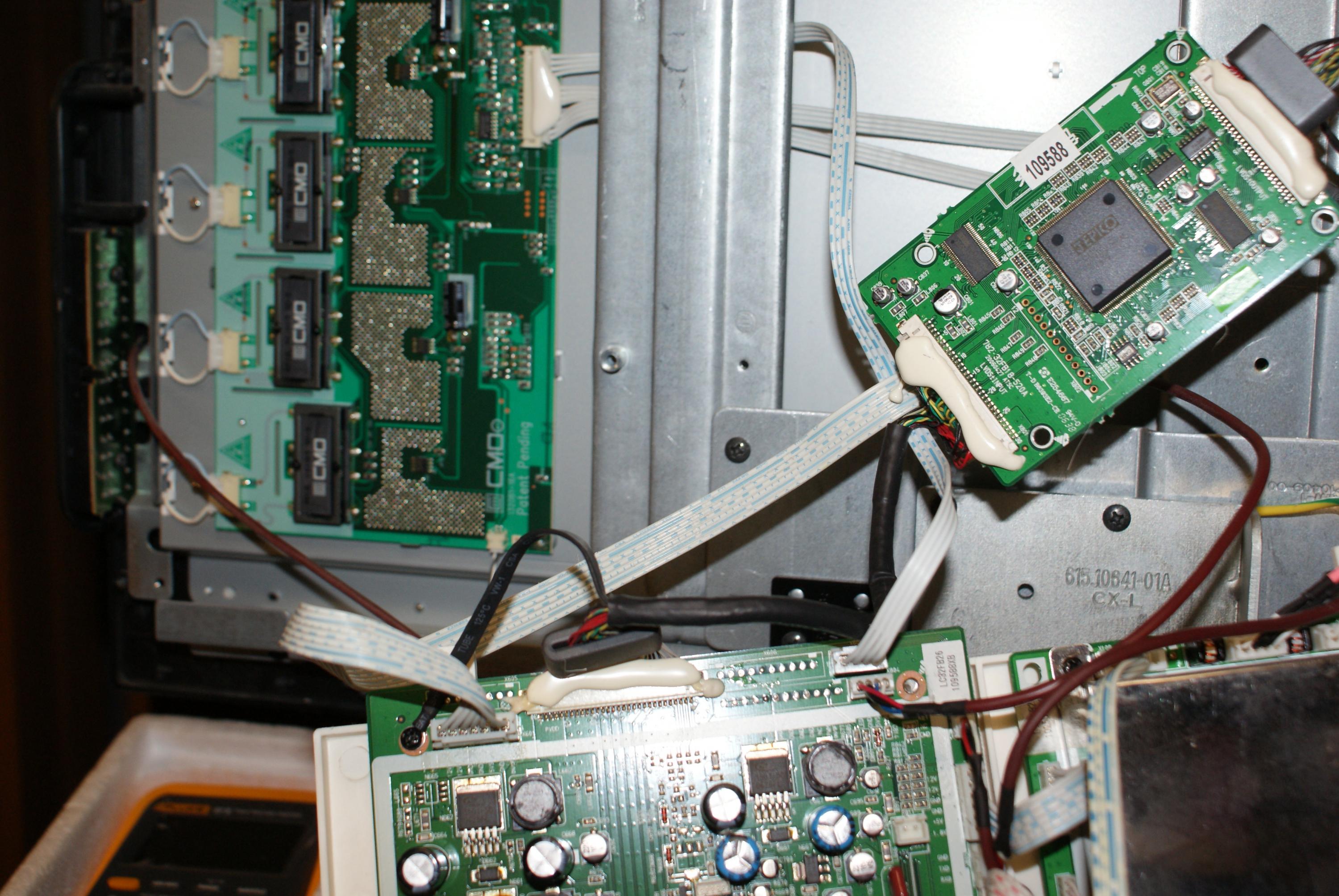

                        Here are the pictures. It was not as bad as I thought. It is CMO. I will look for fuse. Also included picture of main board and cable to inverter connector ribbon cable. on/off is top pin on board and right pin on main board.
                          Found F5 (labeled 15) just to right of 2nd cap from top. see 3rd picture. No continuity.
                            That could easily cause this problem. Replace it and it should work.
                              Again, referring to 3rd picture, the third from top component labeled CMO appears to have discolored. You can see the rings on the input side. Is this a replaceable component? Is this the inverter? Would this cause fuse to blow? Also, where is a source to get a on-board fuse? Or can I use a different style. Board reads .75A/76V.
                              Thanks-Kevin
                                That's probably dried glue or marks from a tool. Usually that fuse is the only fault. However, the devices (transformers) can be replaced if necessary.
