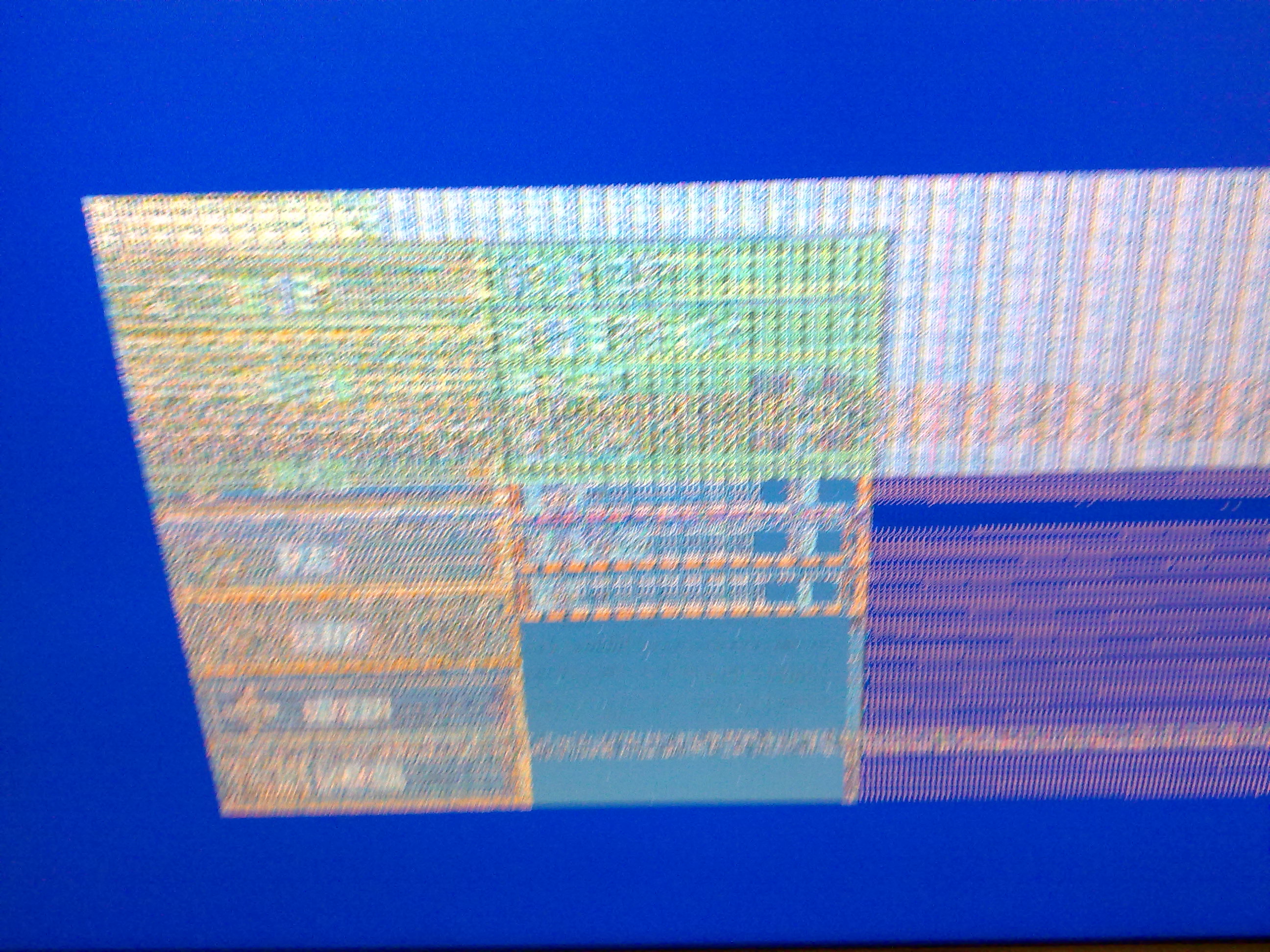

    Hi
    Got one of these and I first thought it was LVDS/T-Con or screen tabs, I have replaced the tcon and lvds with a known worker...its not that, I have pulled the front screen sheild and played about with the tabs and does not make any difference whatsoever...not even a flicker

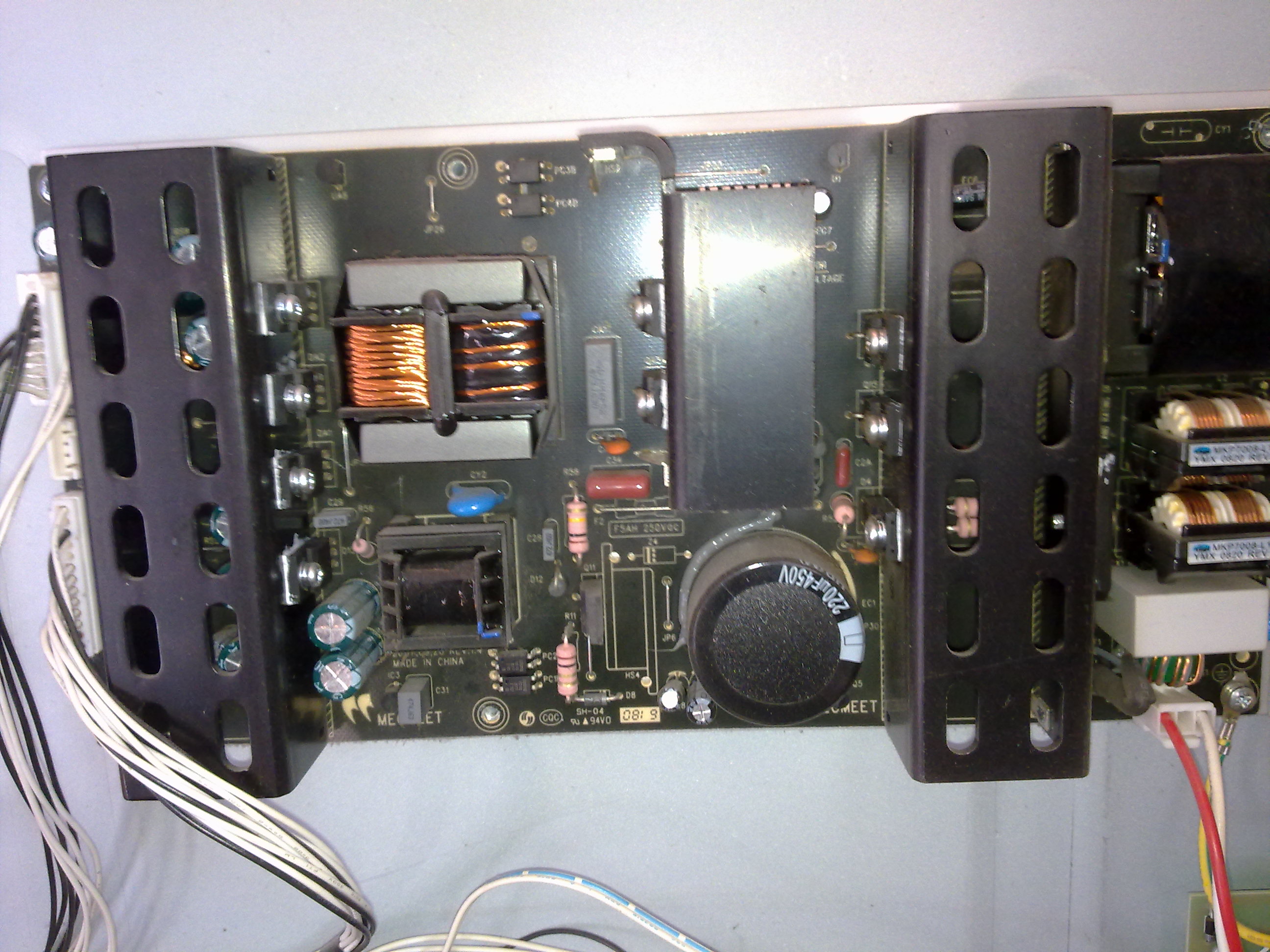

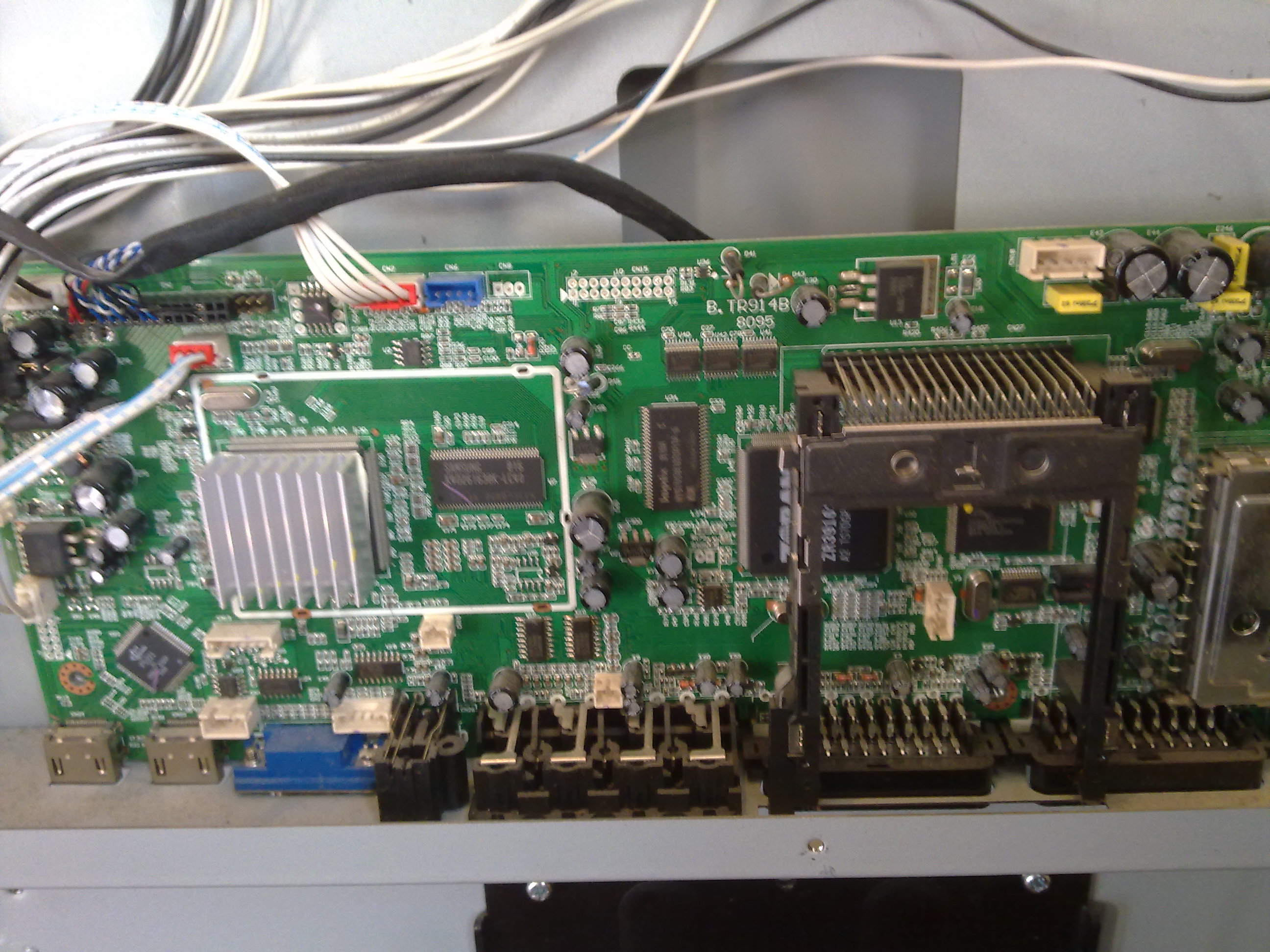

    The main is one of those nasty boards that seem to eat eeproms for breakfast and the psu is a megmeet MLT range. (Although crap the caps under the shield look ok)
    Does this look like a main or has the screen gone bad

    I'm thinking it looks like a corrupted EEPROM or main board
      Re: Cello TP3730DVB Screen/Picture Fault
      Screen's fine. Not t-con. Possibly main board in some way -- probably wrong format, possibly wrong t-con in set installed (or main board set incorrectly.) Corrupt eeprom is possible.
      Press SOURCE then 2580 and you may be able to access service menu. Set should be on. Then turn TI MODE off.
        Its not letting me get into S/Menu, it looks like it is trying too, but then the box that pops up instantly switches off again
          EEPROM may be very corrupted due to bad software design.

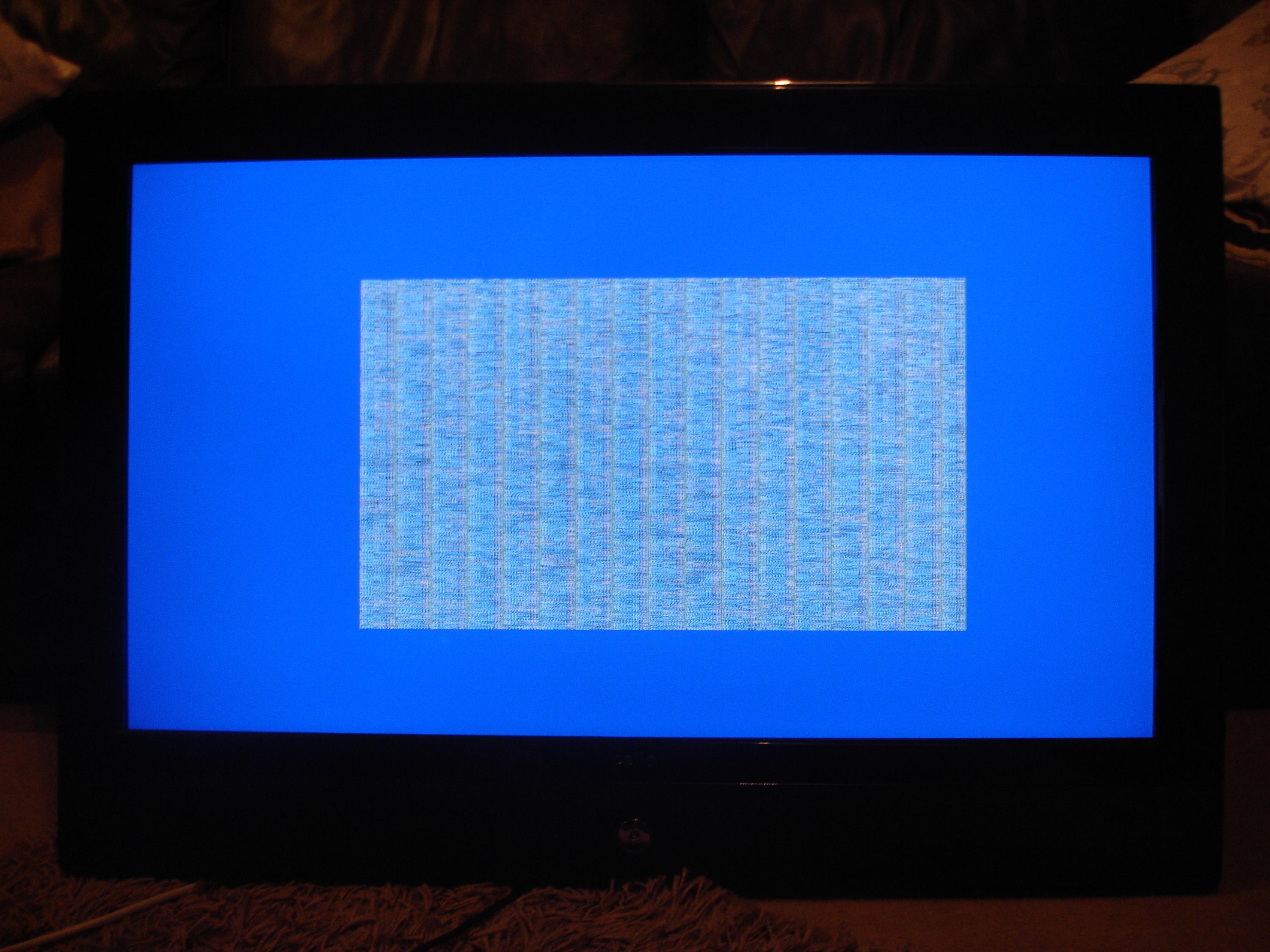

                Just picked up a Cello 3730DVB cheap, with a very similar screen fault to yours - although not as readable, but it seems to be trying to get into the menu when you press the button

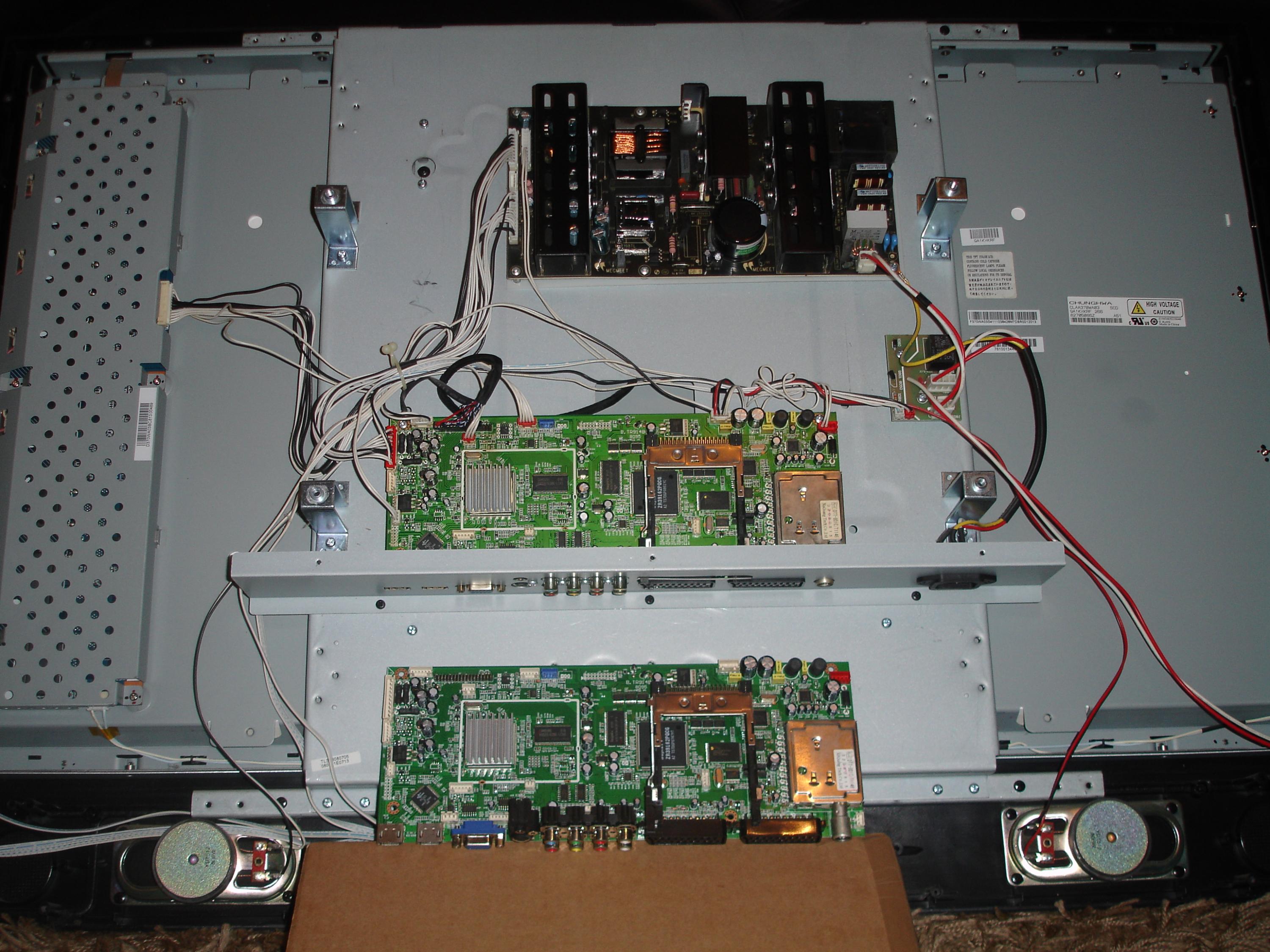

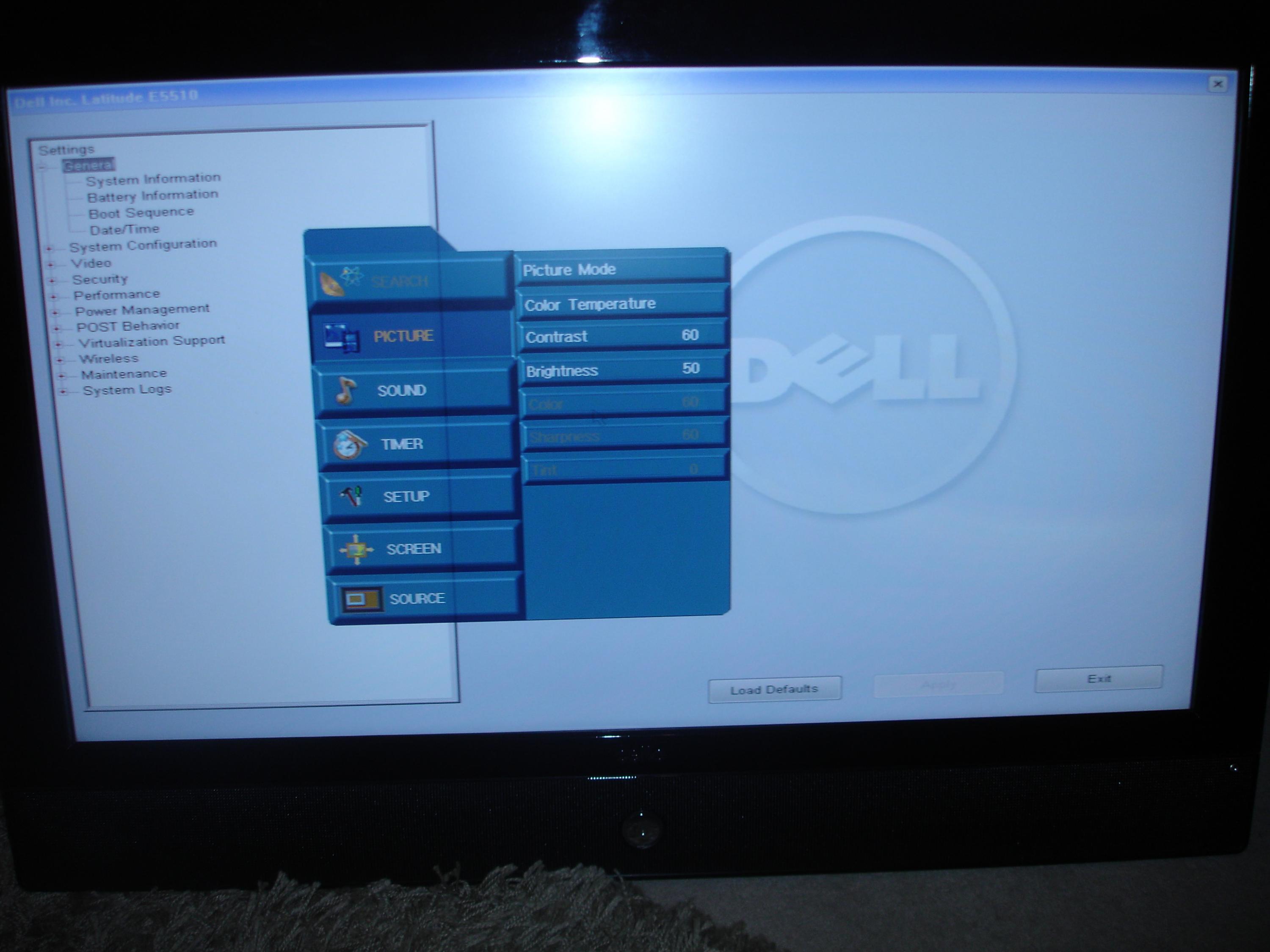

                    Quick update... Board arrived today and just finished fitting, now works perfectly (see attached pictures before and after with my similar fault as a reference to others). So signup I wish you luck with mainboard as it should resolve your problems too!
