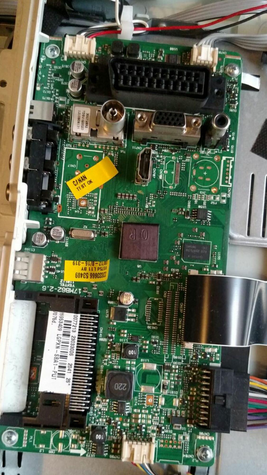

                      • kisspachyousee
                        • Feb 2016
                        • 7
                        • Italia
                        #31
                        Re: Vestel 17MB62 Chassis
                        what make and model is you tv it maybe advisable too check all the voltages on the psu are correct and also if this is a led set too check the led voltages as if failed you wont get backlight
                        my problem is that the standby LED always blinks and does not turn on the TV, I changed the power, I think it is the corrupted firmware

                          #32
                          maybe a faulty eeprom ic try freezing it and see if the set starts up

                                #35

                                  #36
                                  Edit ! i see your set set uses a different mainboard 17mb62 that video i deleted is for the 17mb82 totally different board
                                  my guess its the one ic u158 i think it is hopefully a more experienced member will advise us but freezing that ic still may work if it dosent you may have too remove the eeprom and re programme or replace it
                                  what is the the tv you have what is the lcd panel number used in this tv (usually on a white sticker on the metal tv chassis) as we maybe able too find the exact firmware

                                    #37
                                    I tried to freeze the chip but did not get lucky... the led when i turn on flashing.
                                    panel is LG lc260wxn
                                    main is 17mb62-2.6
                                    tv is SABA model lw26a200

                                      #38
                                      I can not find the correct firmware for my TV, if I knew that there was one compatible, I could try to buy a windbond programmer. would you help me?
                                      ----------edit
                                      I seem to have realized that TX and RX for Winb25Q80 serial connection are pin 10 and 12 of the scart socket, is it correct?
