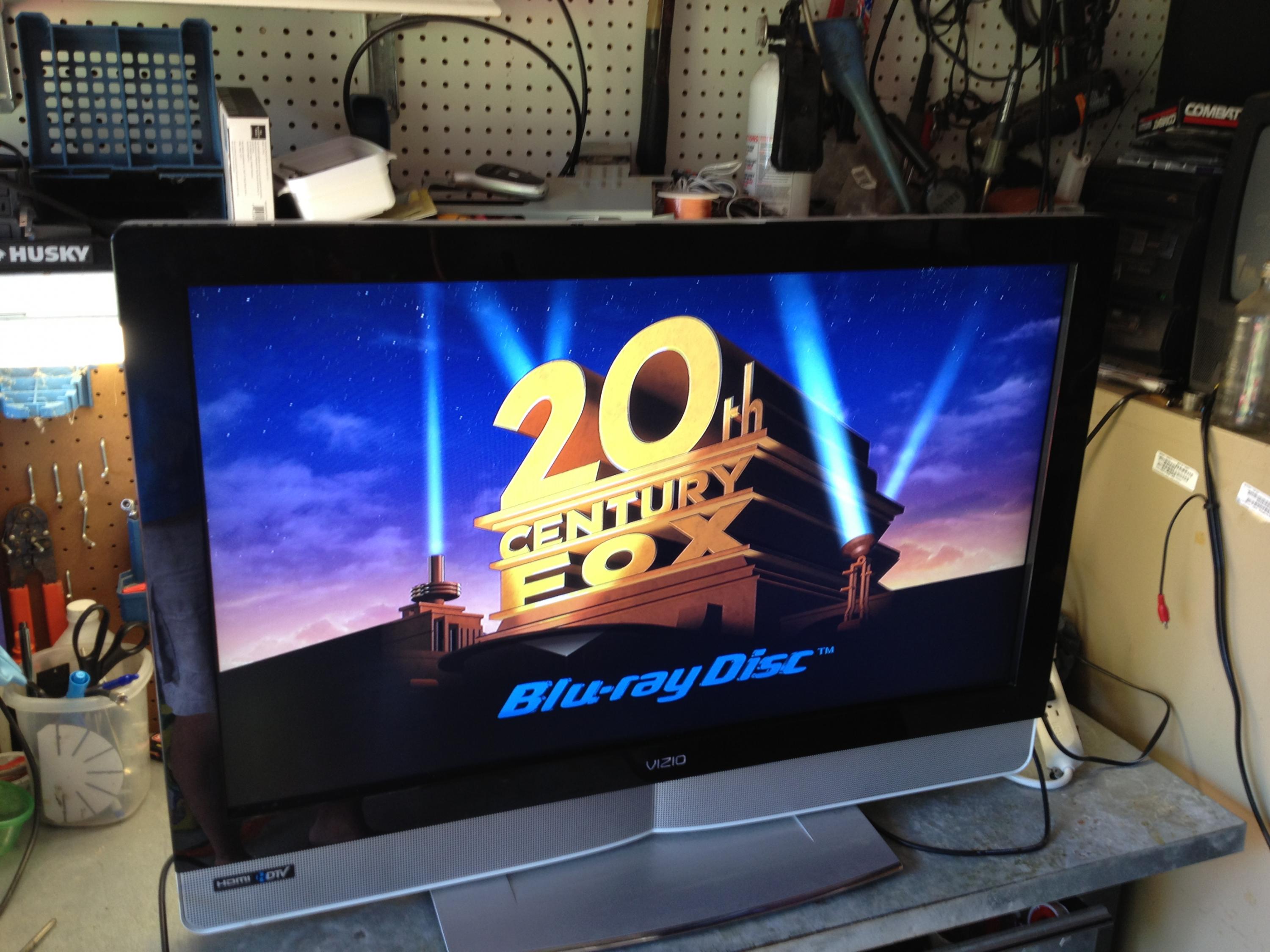

Vizio VX37L backlight not coming on
    Re: Vizio VX37L backlight not coming on
    3.11V is too low though for 3.3V regulators. If the main board crashes it may turn off the 24V, but I'm not sure about the 12V. Ideally you would fix the regulators first so a baseline of correct main board operation can be established.

        Are you now getting 3.33V on regulators?
        I thought you had 3.11V but you've edited the post?
        Because 3.33V is fine, we would need to look elsewhere...
          U16 seems to be the only low one. That's why I said check the edit. Sorry again about that.
            U16 is fine; -25 = 2.5V output.
              Ah, ok. I've got to go pick up dinner for the family but I'll move on to the next step in a bit. Not sure if you saw above in the thread but I unhooked the control board completely yesterday and still could not get the voltages on the supply to hold steady when I power it up.
              I did that by putting a jumper from the STBY to PSON. Not sure if that's the correct way to go about it but it seemed to work.

                  Just a note I had mentioned U1 earlier which is a 7805 on the control board. Pretty sure it's part of the 12v circuit which explains why I have nothing on that one at all.

                    12v and 24v are generated by the same power transformer. So if you use 1k resistor between the PS_ON and the 5V STBY pin, then you should see the 12v and the 24v come on.
                        Ok. Tried that and the 12V is still missing and the 24V acts the same as before. Starts our around 14V and drops to 1-2V quickly. I'll have to get back to this one sometime next week.
                          #32
                          Got this one going. Just swapped the whole supply. $25 for it on Ebay shipped. I may look at the old one later.
