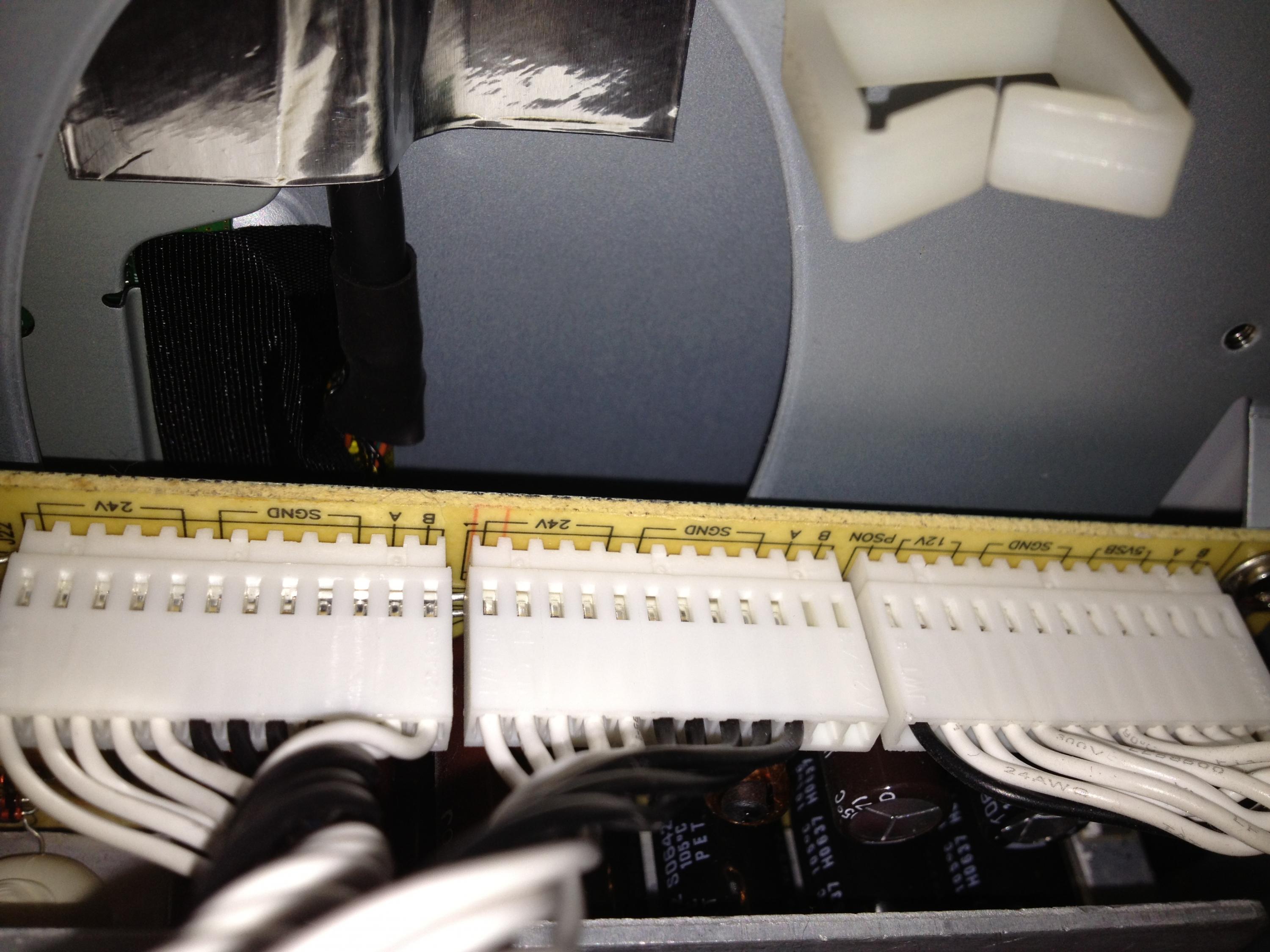

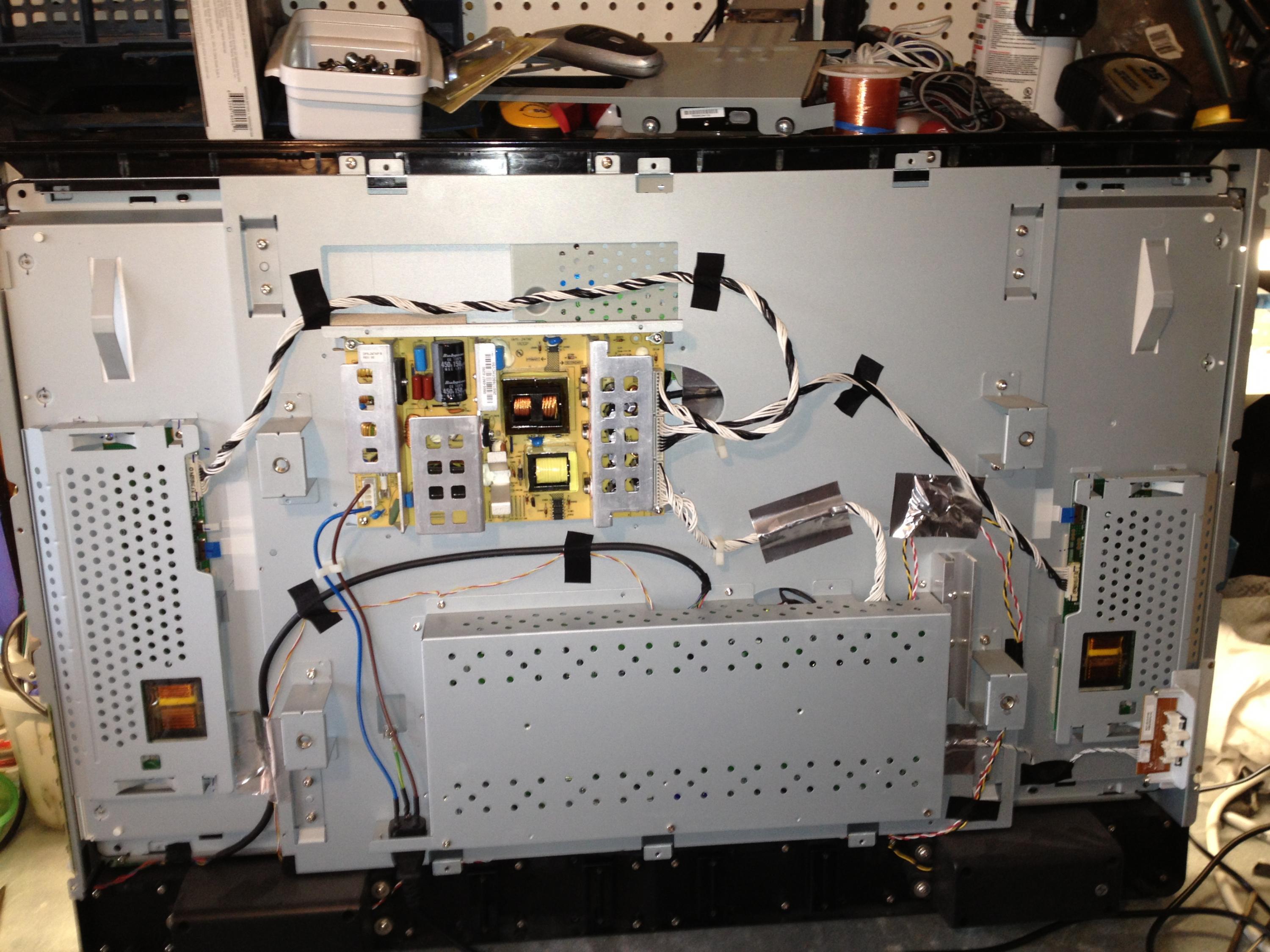

    Picked this one up today for $25 and came home and took the back right off. Vizio light turns from Amber to White when I power it up with the remote or button the side. Started by testing the standby and as expected, its putting out 5V. When I power it up, the PSON shows 5V as well so I figure the control board is working. Moving on to the 24V outputs, they start out at 14V and quickly drop to 1-2V. I've pretty much decided it needs some work on the supply but thought I'd post for knowledge and reference in case someone else needs it. Opinions welcomed on where I could start with testing the supply for repair or if there could be another problem causing this.

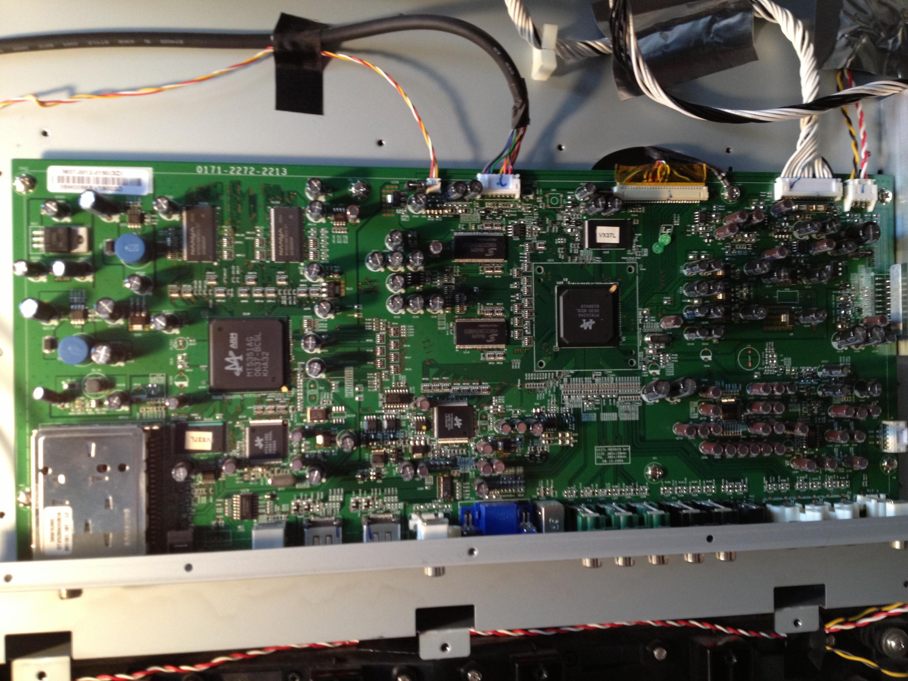

      Check U7 and U33 on the main board per this thread.

          I would check all the regulators just to be sure, but the common failure ones are the U7 and U33 as indicated by Johnboy.
          Does the PS_ON drop out when the 24V drops down? How about the BL_ON (it is one of the A, or B pin)?

            Haven't had a chance to look at U7 and U33. PSON holds steady at 4.98V when I hit the power button. 5VSBY holds steady at 5.03V all the time. All three pins labeled 'B' show 0V all the time. All three pins labeled 'A' show 0.2V with the power off and 2.96V with it on. I'm assuming that 3V must be the BL-ON trigger but I guess maybe it should also be around 5V.
            Oh, and there is absolutely no reading at all on the 12V pins regardless of power state. I can also unplug the control wires completely and jump from 5V STDBY to PSON and get the same effect. 14V on the 24V pins that quickly drops to around 1-2V and stays there.

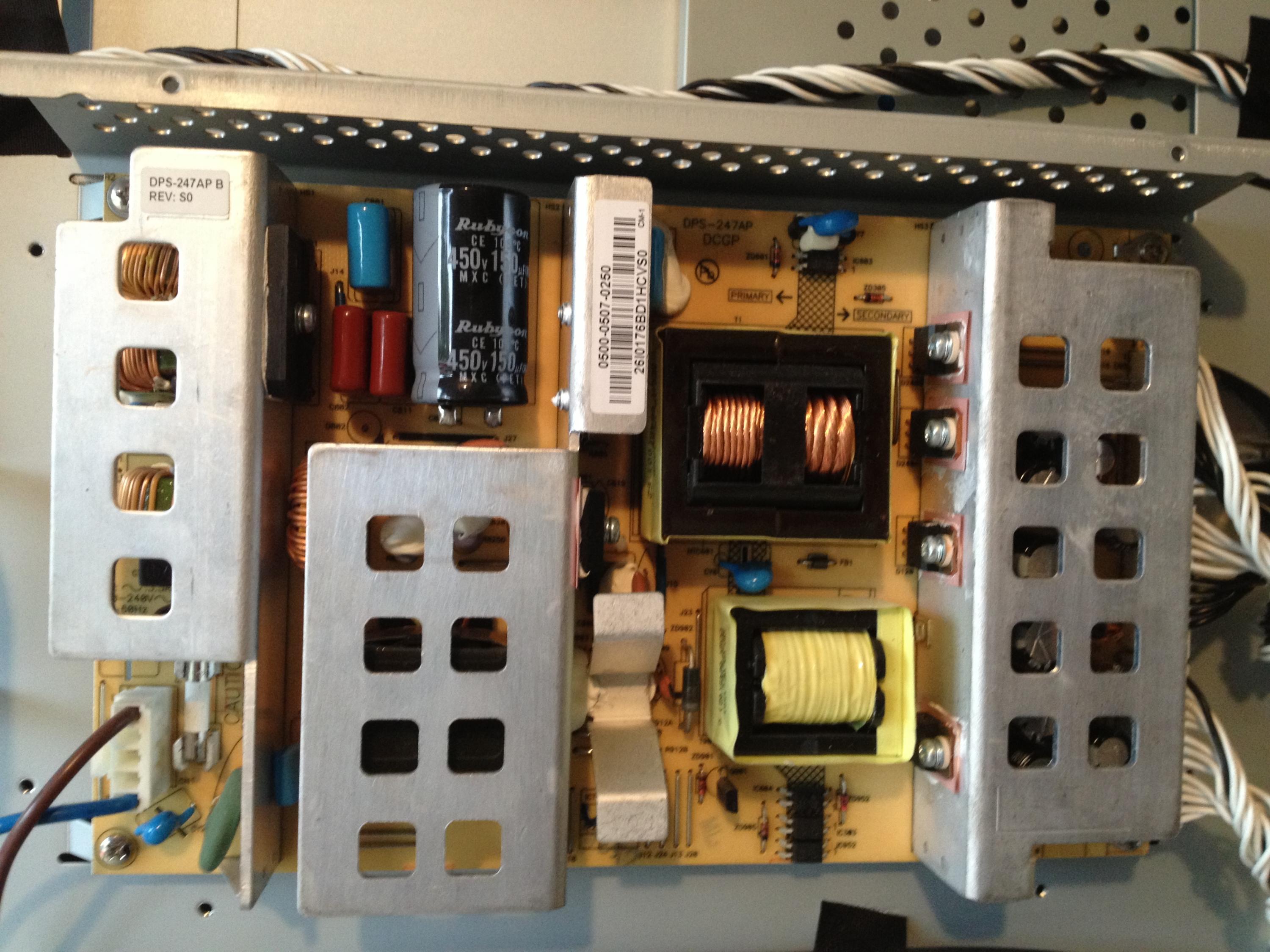

              Doesn't hurt to test that inverter transformer too (T1)
                Re: Vizio VX37L backlight not coming on
                OK, so it looks like we need to work on the power supply first to get the 12v/24v working first.
                So lets see if the PFC Voltage booster circle is working or not fist, when TV is plugged in but not turn you should have about 160~170VDC on that main 450VDC filter cap, then it should go up to about 380~390V when PS_ON is present.
                Be careful since you will be working in the hot side of the circuits so do not touch anything with your hands, measure the voltage directly at the two legs of the cap, make sure not to slip the probes!

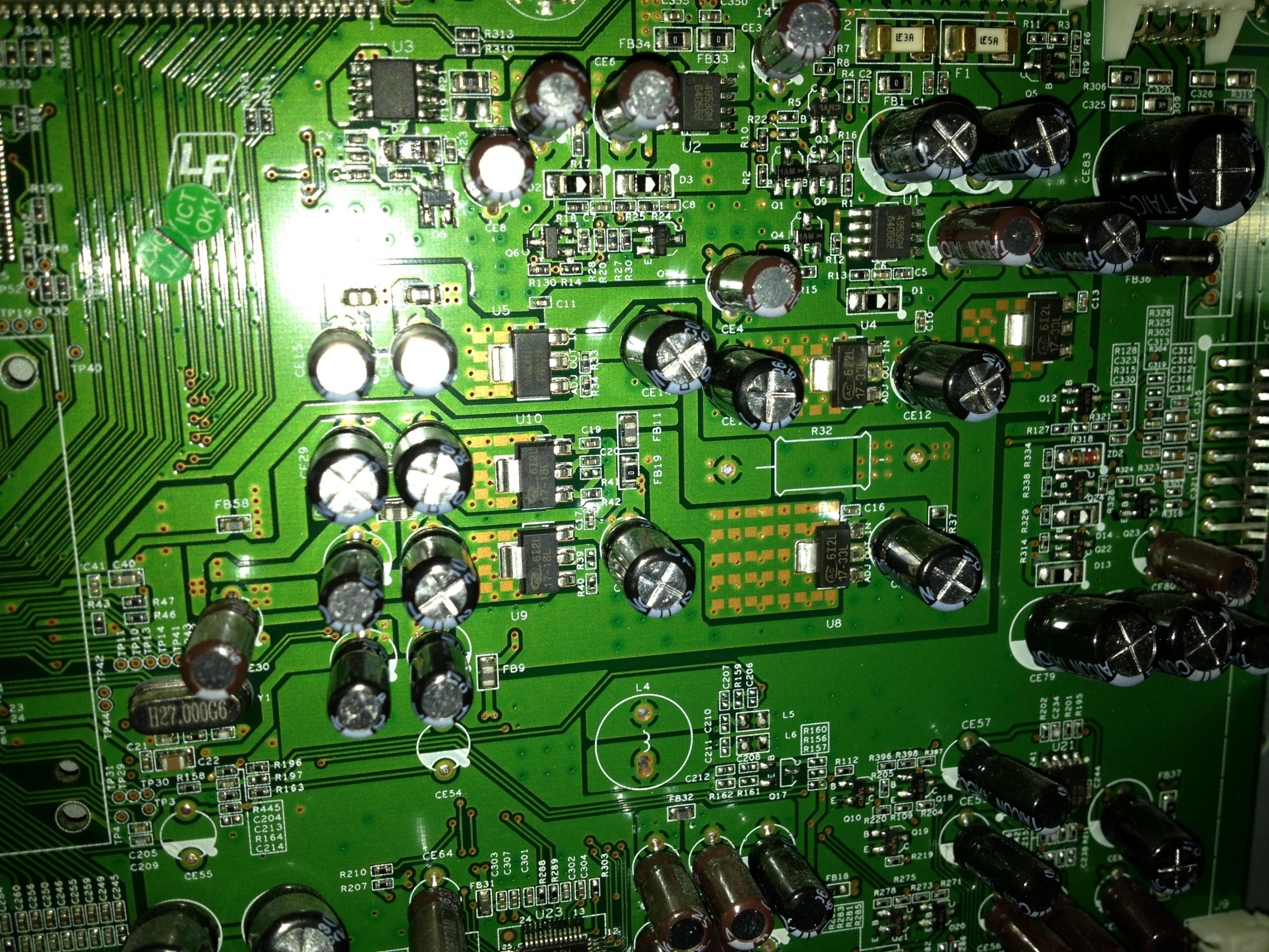

                    U7
                    0V
                    1.82V
                    3.02V
                    U33 appears to be an IC
                    Main cap I have 172.2V with tv in standby and 407V with it on.

                        Tons.
                        U5, U10, and U9 all have those same readings
                        U8, U4, and U6
                        0V
                        3.33V
                        5.11V
                        I'm looking at others now
                        U16
                        0V
                        2.52V
                        5.01V
                        DU2
                        0V
                        3.3V
                        5.01V
                          U8, U4, U6 and U16 are suspect. What are the part #s on them?

                            Now this seems strange. DU1 in the upper left of the board that seems like a higher current regulator has only 0.544V in and nothing out.
                            • aaronwt6
                              • Apr 2013
                              • 855
                              • US
                              I rechecked readings on those. Wrote them down wrong. See above
                              U8 and U4
                              Part number
                              6I2L
                              17-33L
                              U16
                              Part Number
                              6H3L
                              17-25L

                                      Well multiple regulators are all reading low which is really strange.
                                      So I'm going to suggest you replace all of U4, U6 and U8... Did you update U16 I swear it said 2.22V before?
