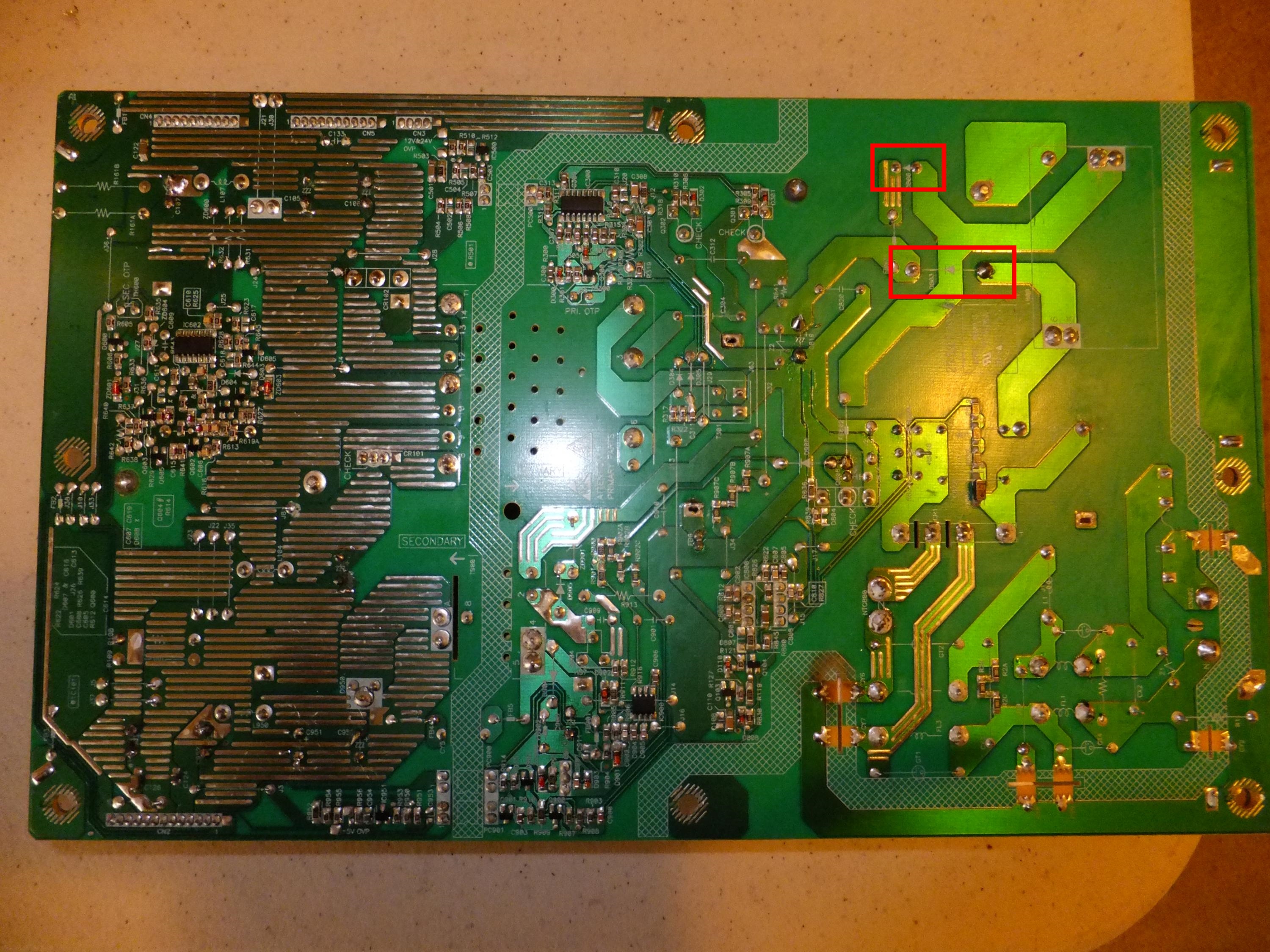

    Re: Sanyo DP37647 no backlight

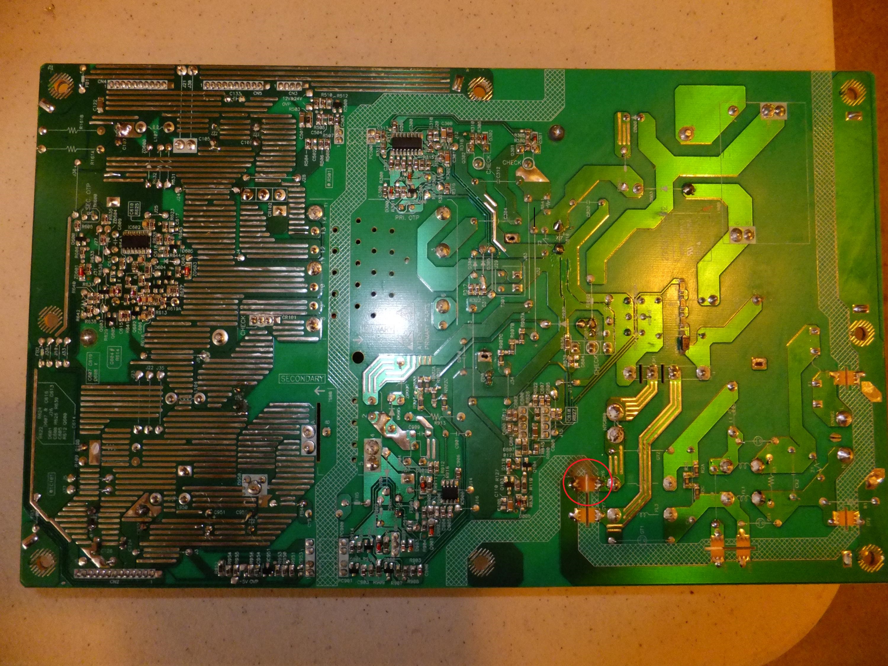

    From VCC Pin 7 to GND Pin 1 I get a steady voltage of 14.11 volts DC. Now the backlight flashes rapidly all the time, whatever I did caused a change somewhere. Pin 6 I am getting just over 2 volts and pin 2 I getting just over 3 volts. The rest of the pins nothing.
      So Budm, do you think that IC is bad or is it something else? $50 for a used PS but I rather fix the one I have. This is a tough one.
        Accorrding to the spec sheet of the PFC IC:
        VCC (Power Supply)
        The VCC pin is the positive supply of the IC and should
        be connected to an external auxiliary supply. The
        operating range is between 10V and 21V. The turn-on
        threshold is at 11.2V and under voltage occurs at
        10.2V. There is no internal clamp for a limitation of the
        power supply.
        So you do have enough DCV to run that PFC IC Controller ICE1PCS02, but you are not geeting te Boosted Voltage.
        I have to locate the Diodes in the PFC section to see if they are bad, in the mean time you should inspect the board real close to see if you have any cold solder joints or not.
          Please check those two diodes I marked to see if they are OK.
            Sorry, got busy because I had to catch up on other stuff. So both of these diodes test out good. I am going to replace the Y Capacitor located where I circled on the board just to see if it make a difference, just because there was a arc there I suspect it may be bad.
              Well, changing that Y Capacitor did not make a difference. I guess my next step is all the polyester caps and see what happens.
                X (for L and N, and Primary to Secondary), or Y (for L and G, N and G) are not needed for the circuit to function. X and Y caps are for AC line noise filter , do not waste time dealing with X/Y caps. PFC circuit is the one you need to concentrate on.
                Those two Diodes I marked, what resistance do you get when you test it using Ohm mode on the meter.
