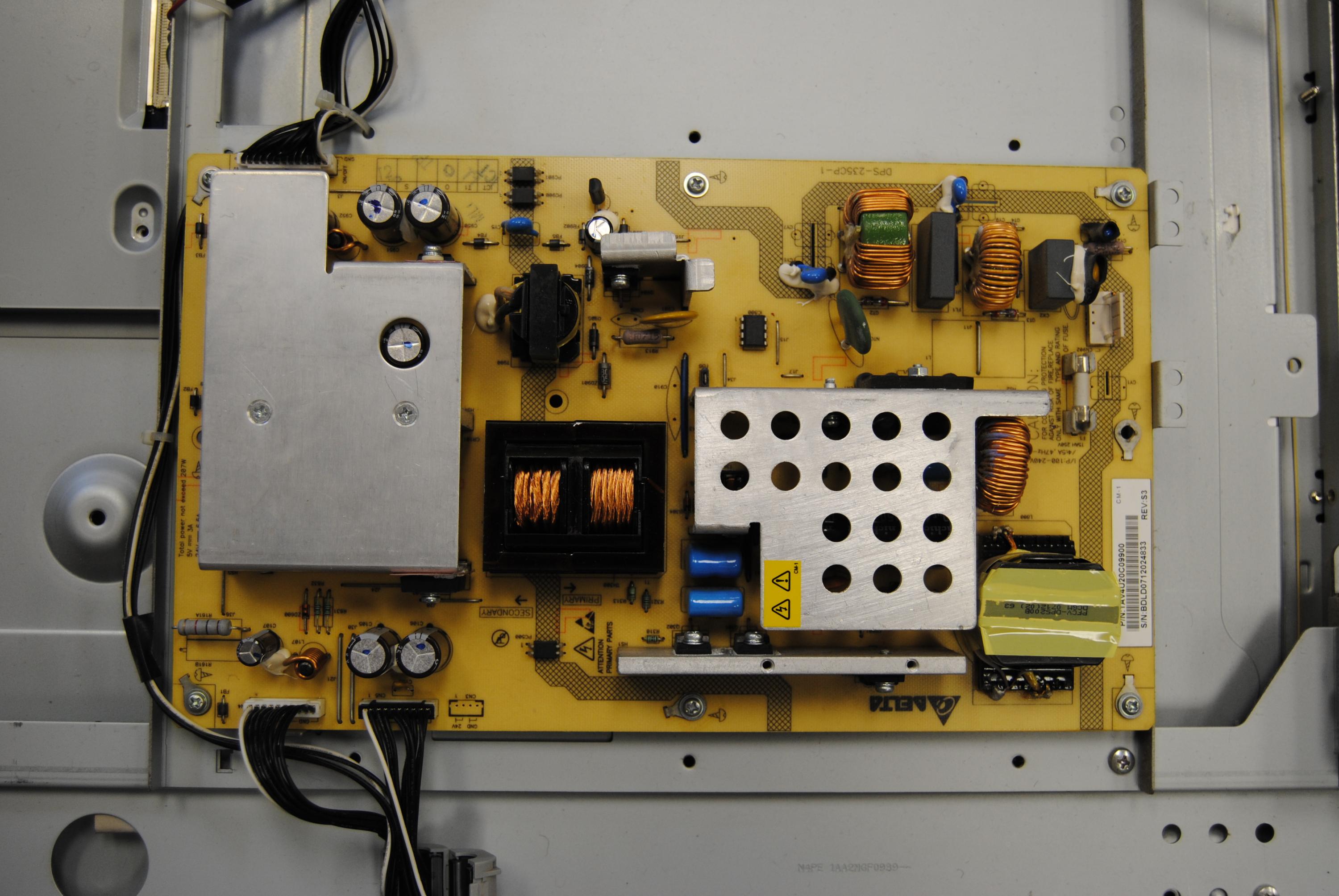

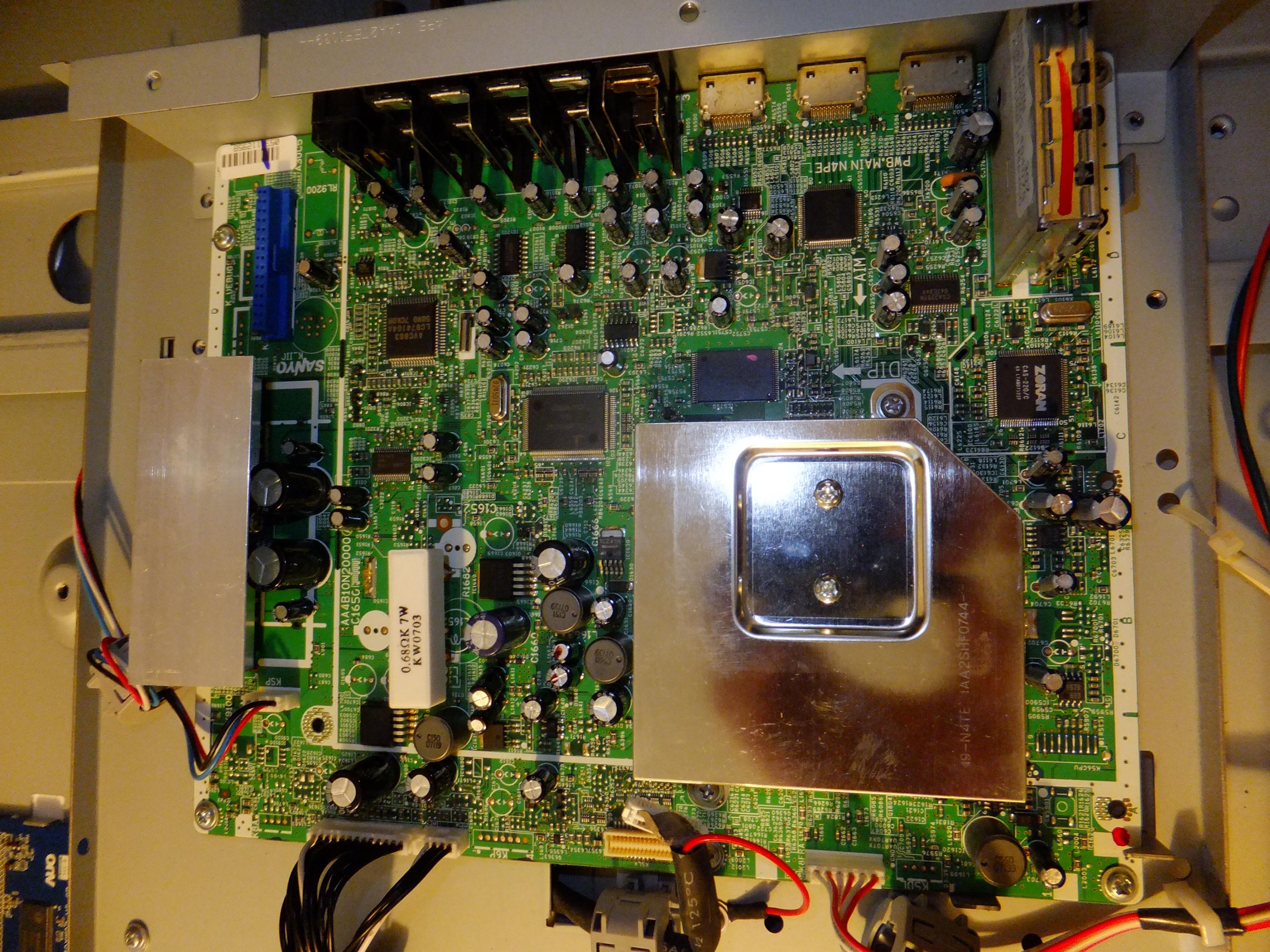

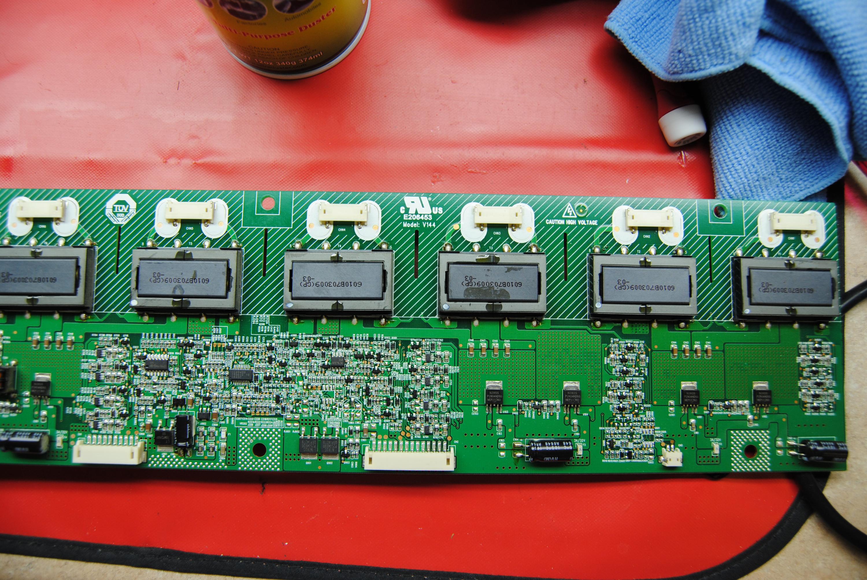

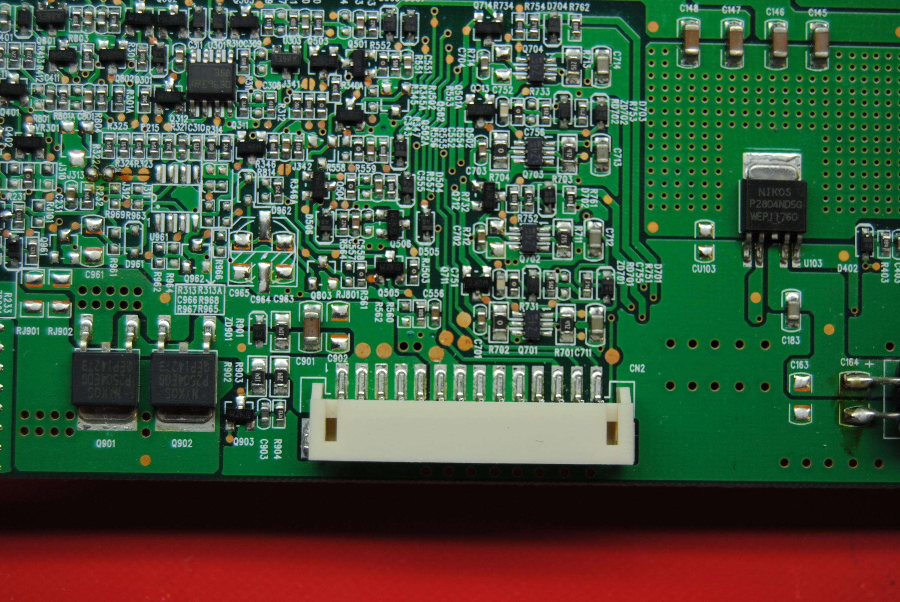

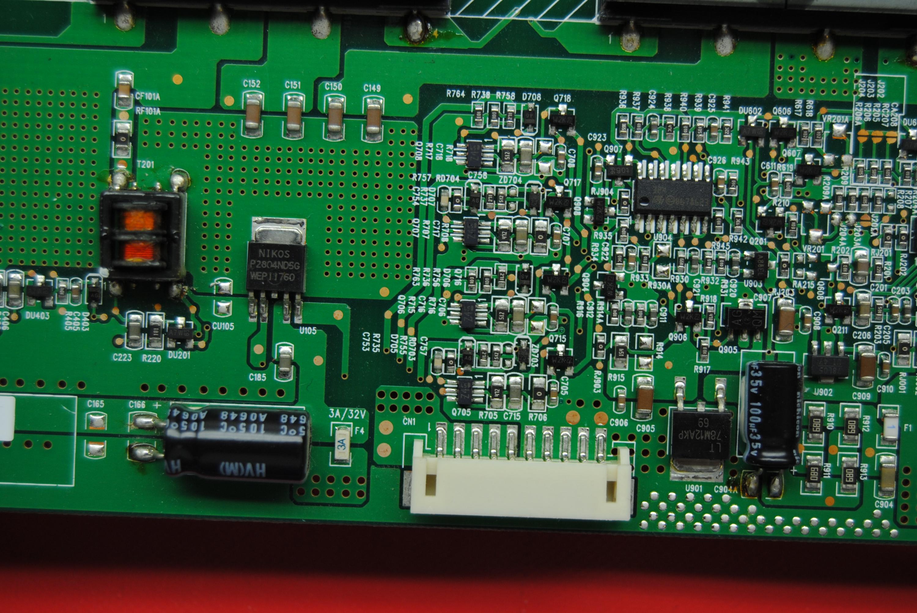

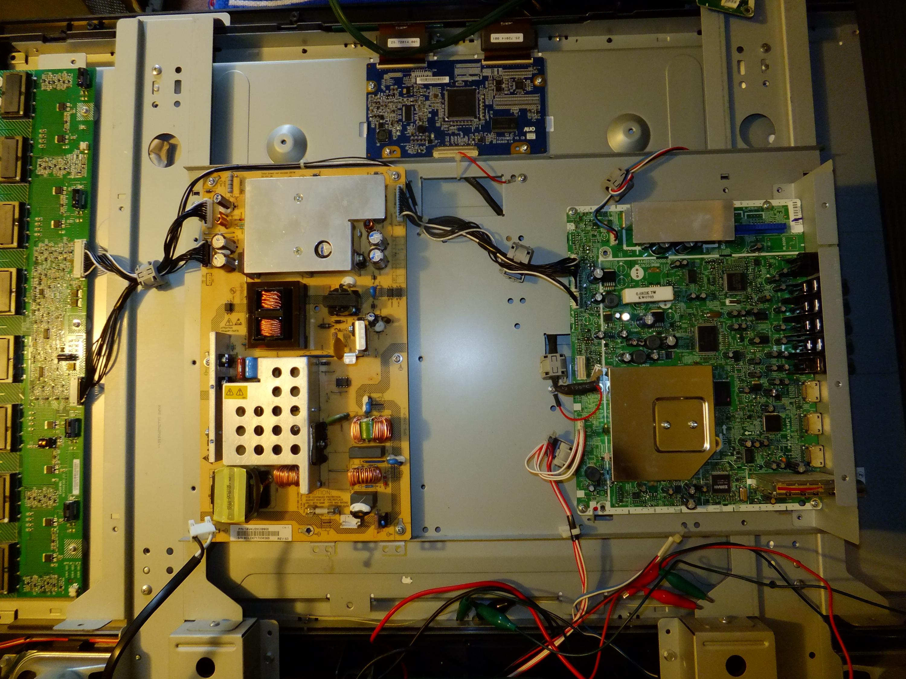

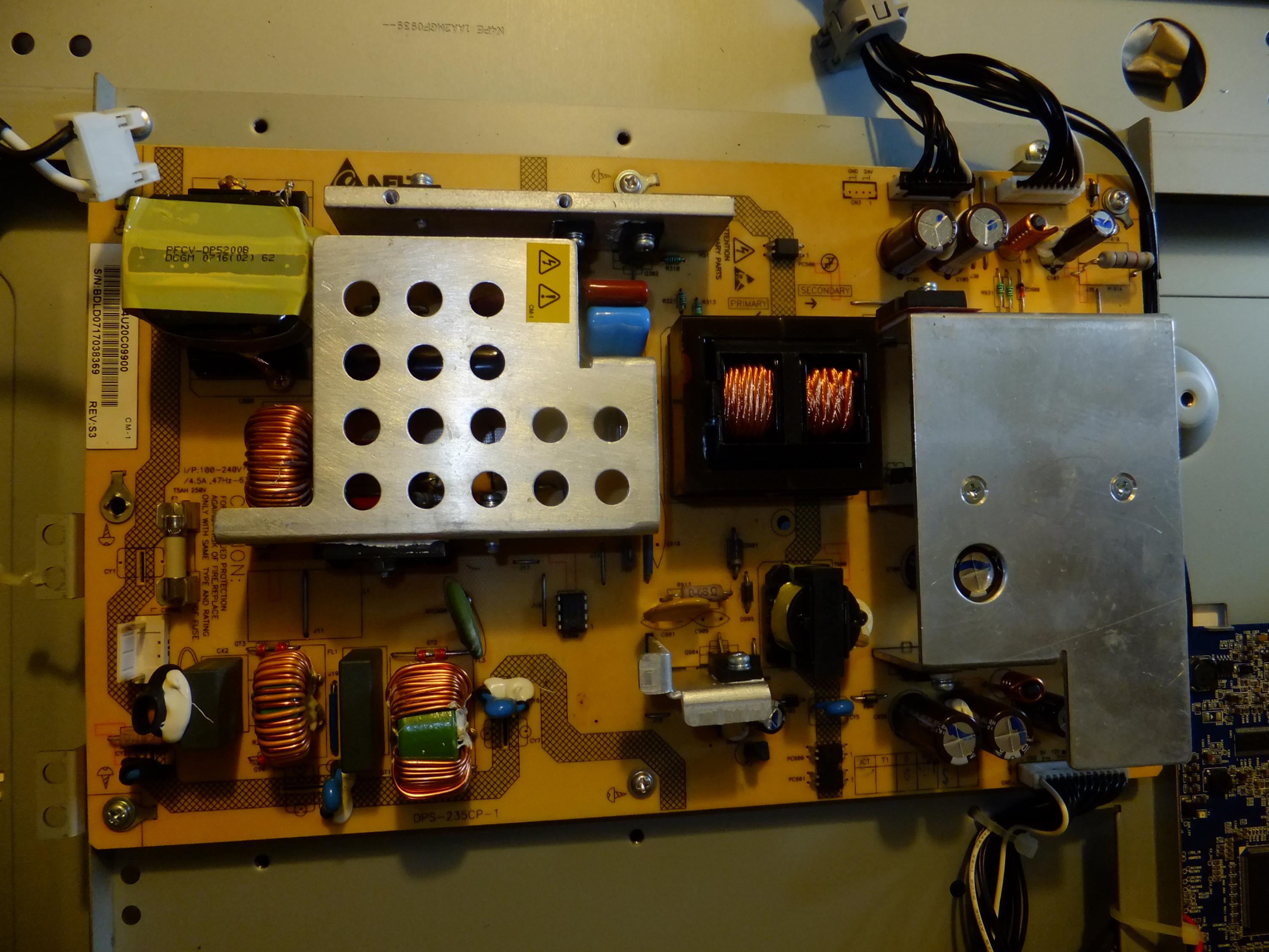

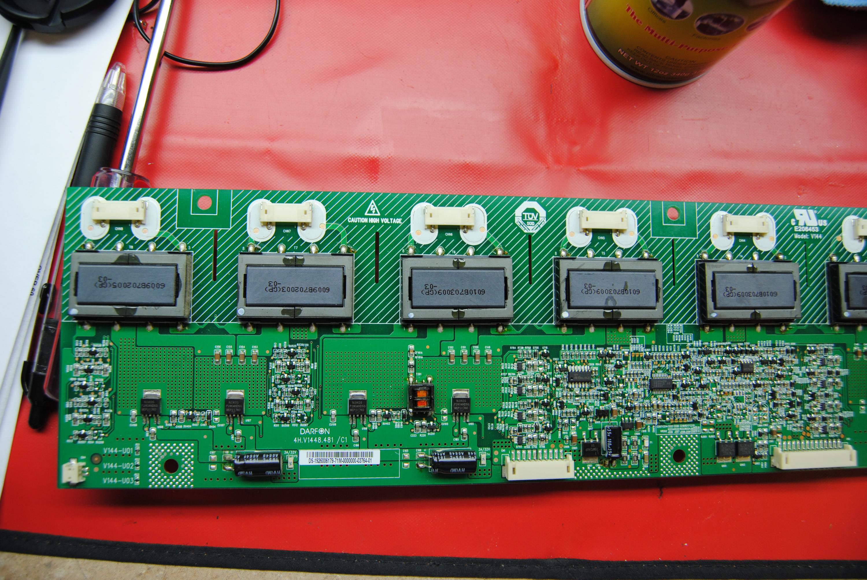

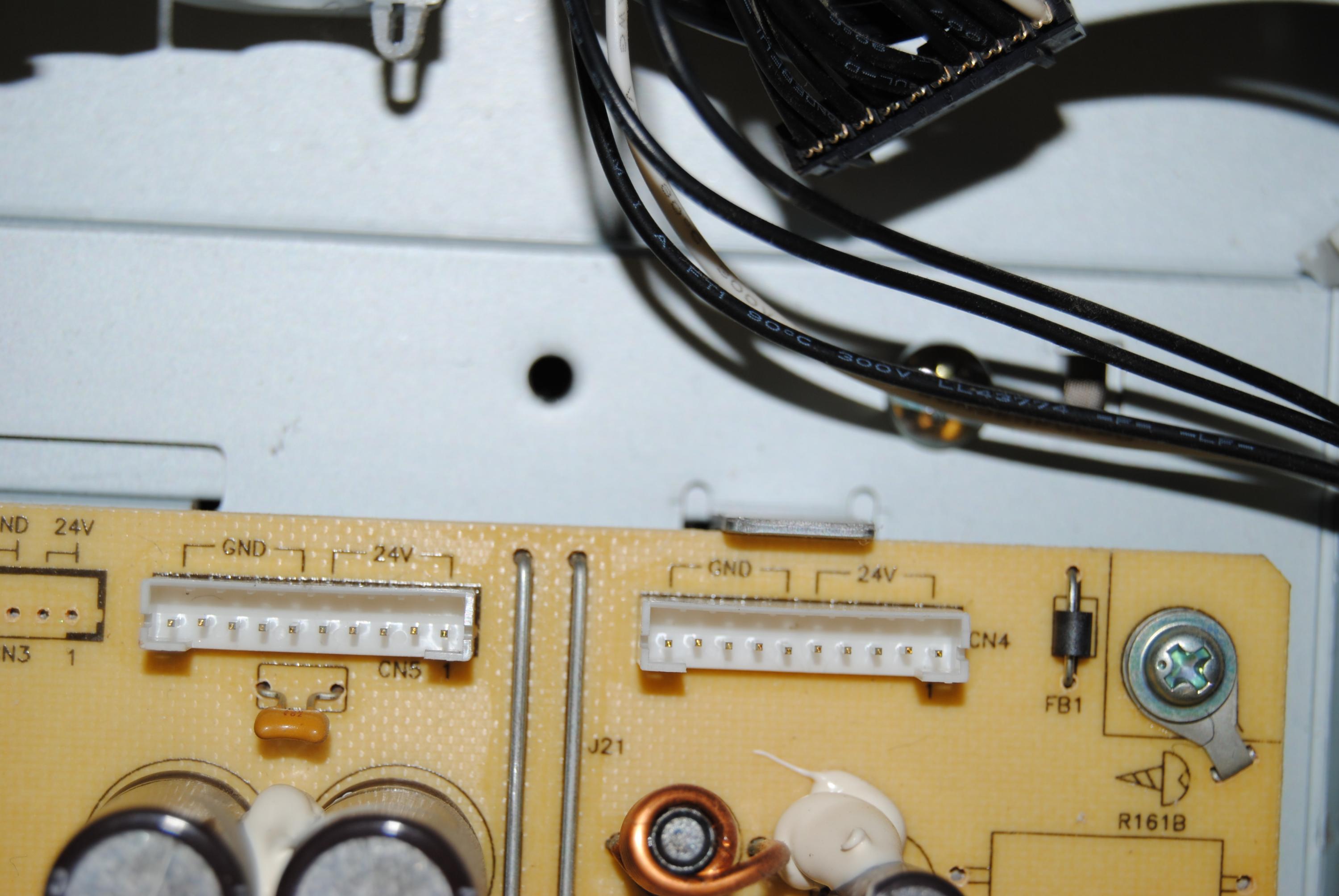

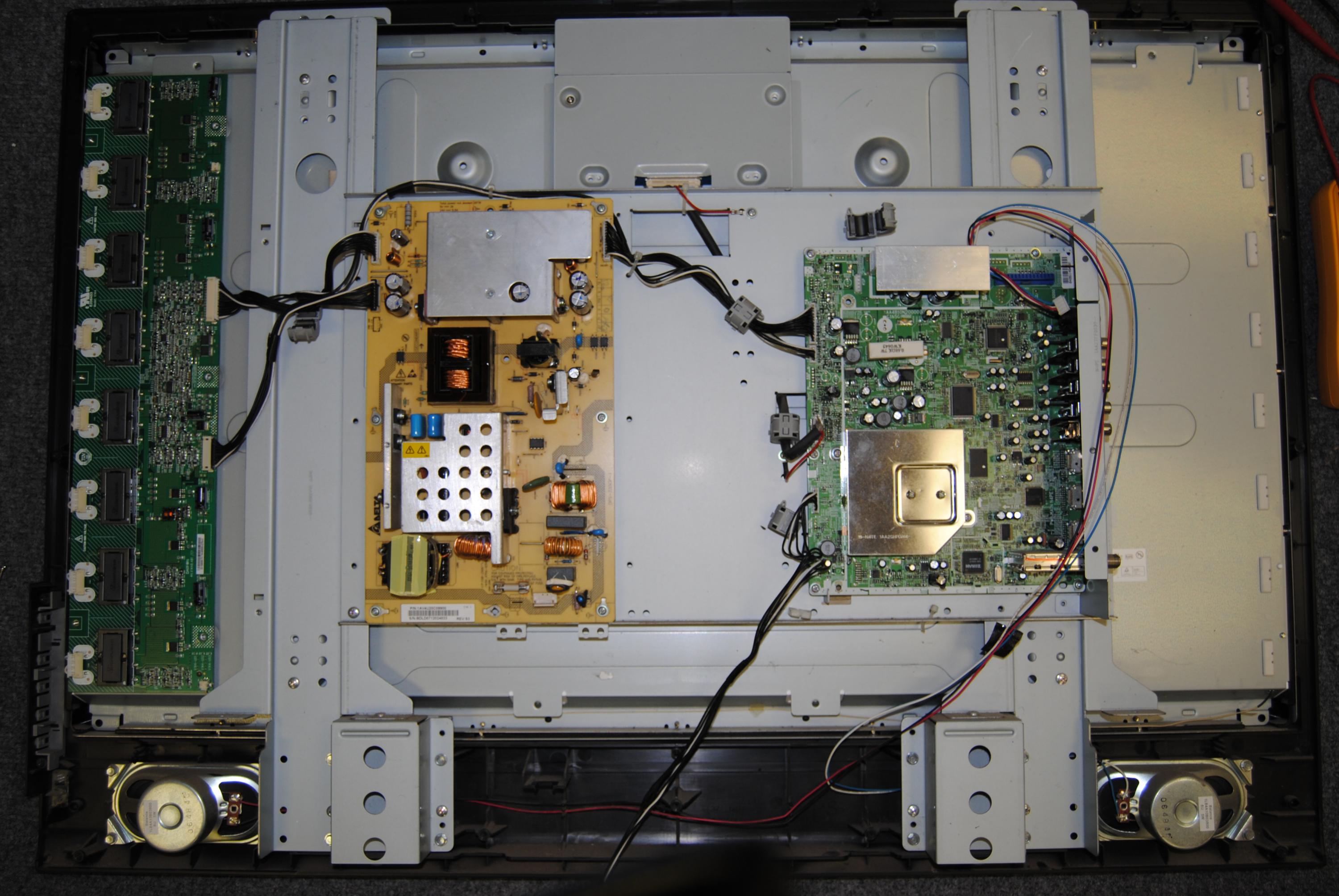

          Upload good clear picture of the boards, closed up picture of the inverter boards, especially around the connectors so we can see if there are any voltage labeling on them. We are looking for BL_ON (INV_ON or ON/OFF) signal, 24V pins on the inverter board,
            Re: Sanyo DP37647 no backlight
            I've attached an overview picture, the power board, connectors to the inverter, the inverter board, and the connectors from the power board. The 24V lines coming off of the power board are what I'm testing ~16V.

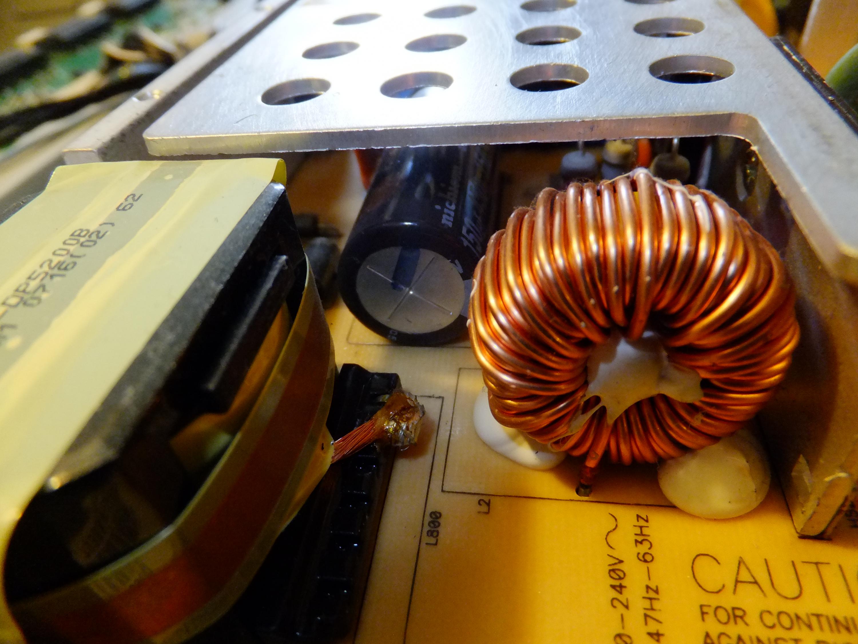

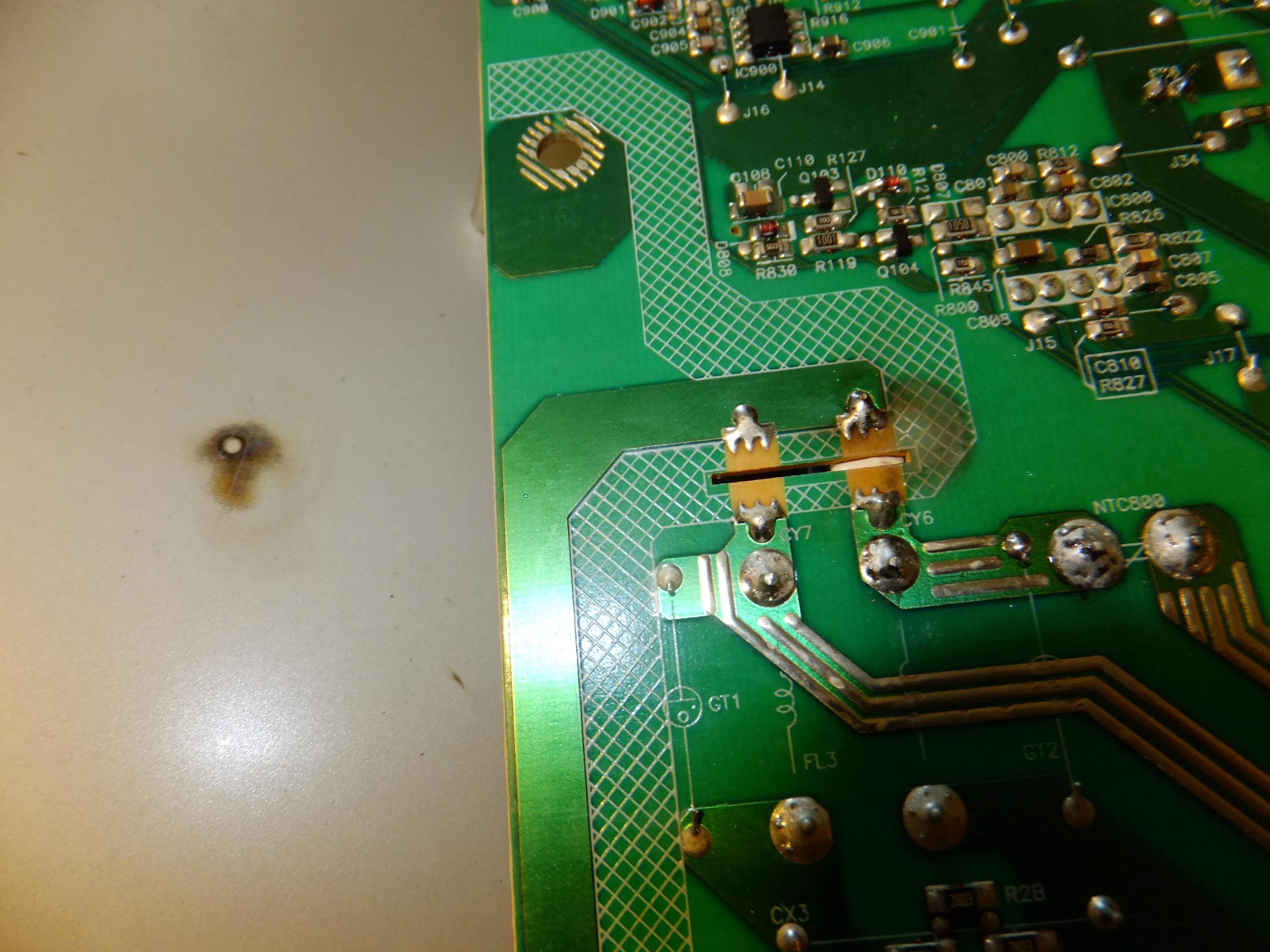

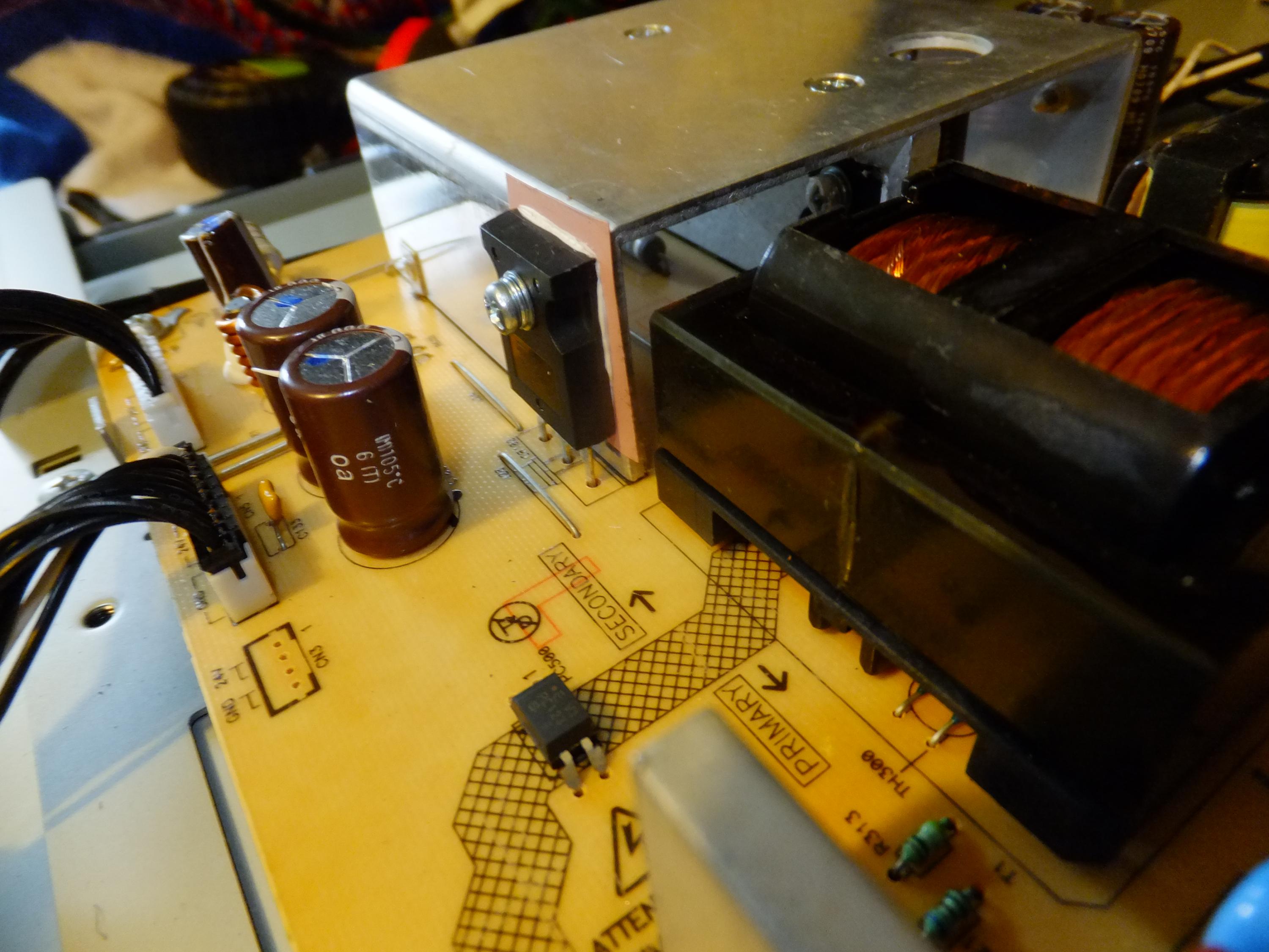

                              167.7v with the power off, I press power and it goes down to 163.00 and the backlights flash. I found 4 weak caps on the PS and changed them, not making any difference. I also changed out the main cap with one closer to the value of 150uf. Also it seems that at one time there was an arch from the PS to the frame, I included a picture. Sounds like it could be the PFC Voltage booster circuit as you describe, but I am not sure just what that is.

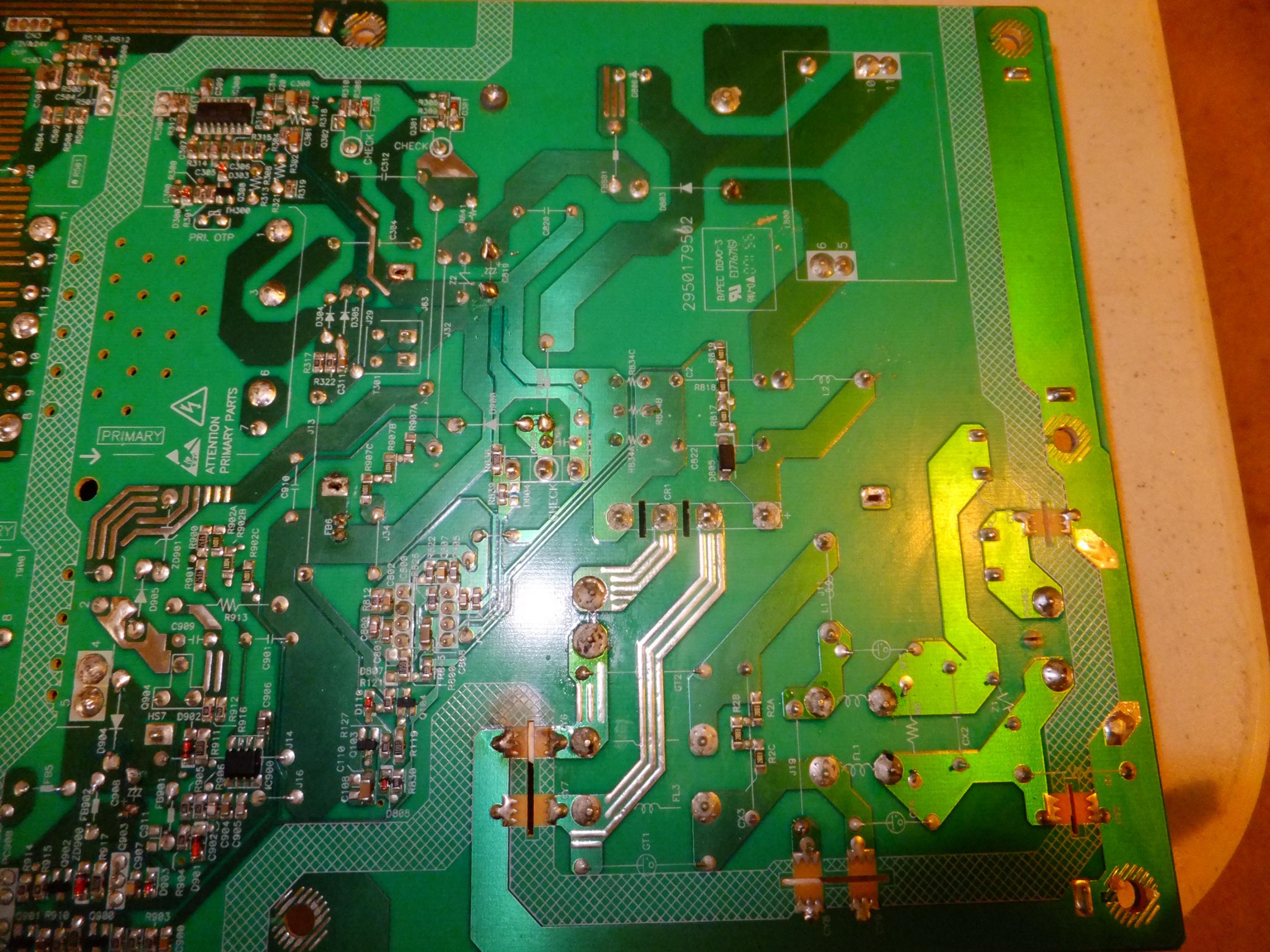

                                So you are not getting boosted PFC Voltage.

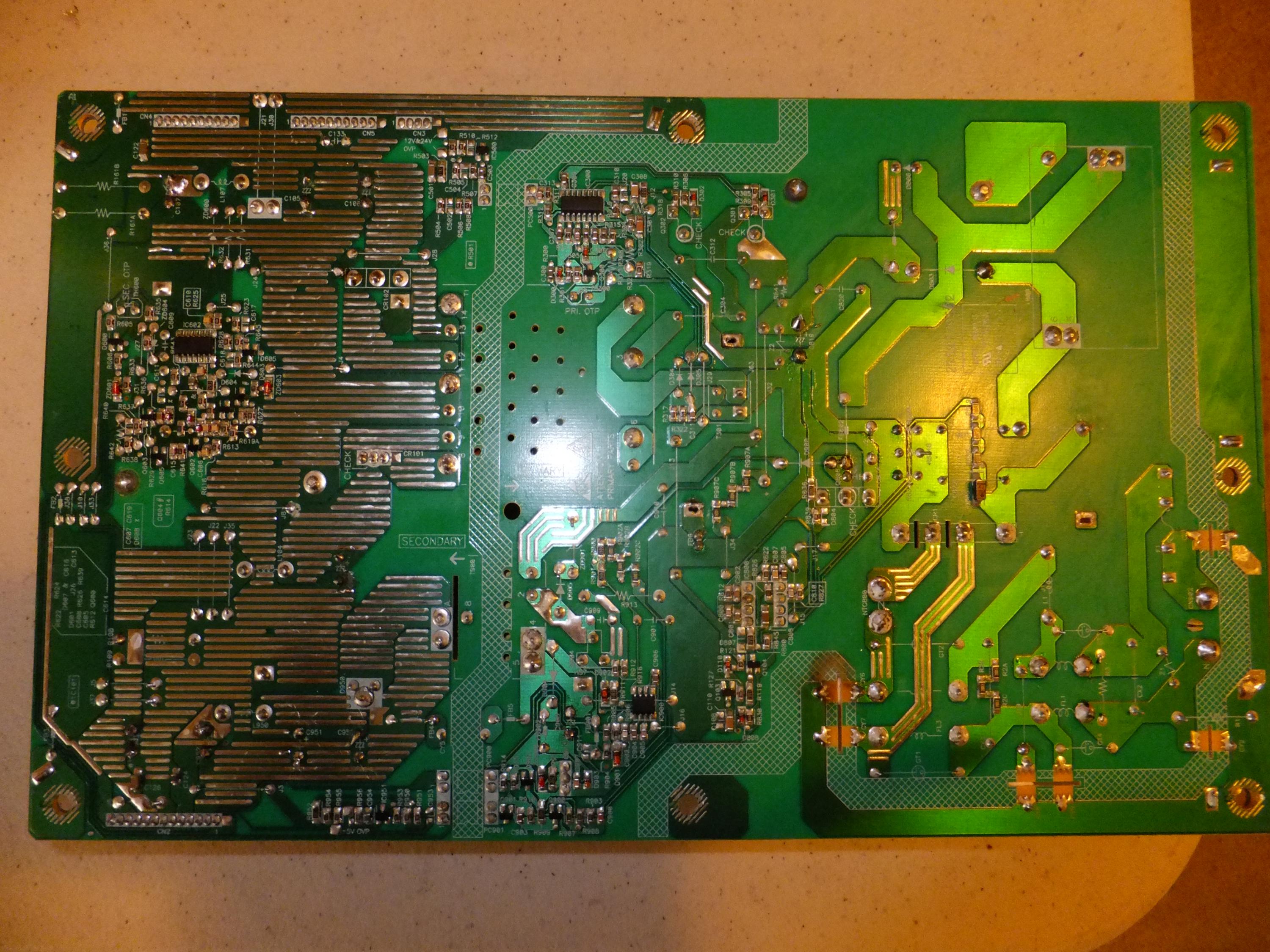

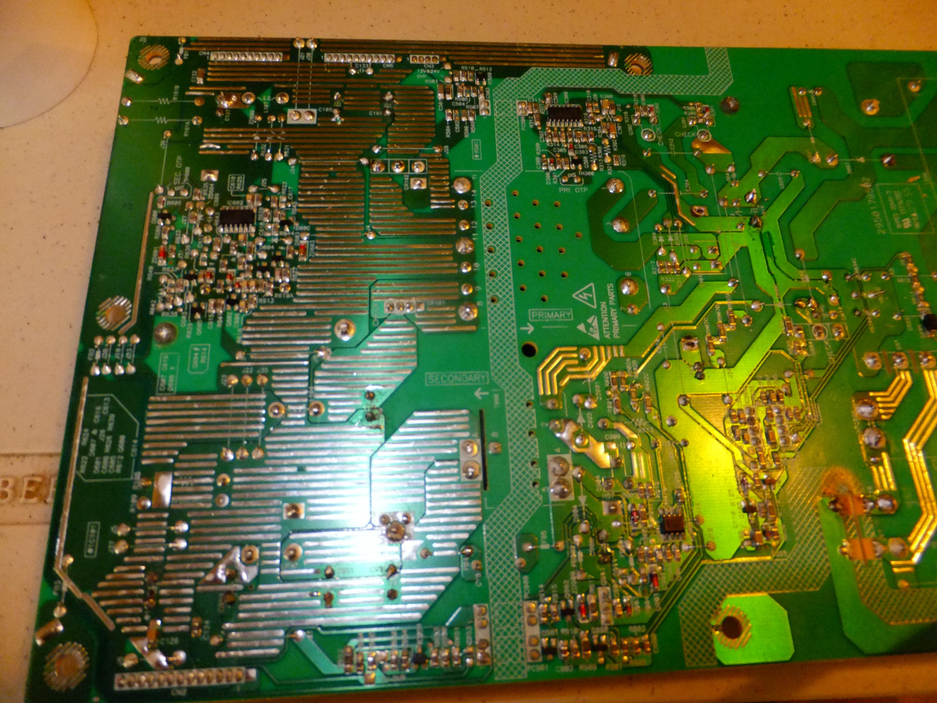

                                Need the pictures that show the whole bottom side of the power supply board so we can try to identify the PFC section.
                                  OK, there is a IC that I suspect, ICE 1PCS02. The weirdest thing is when I have it on and I am probing this IC it was cause the backlights to blink rapidly so it would seem this IC is at fault.
                                    ICE 1PCS02;' Are you talking IC800 DIP-8 through hole mounting IC?
                                    That is the PFC Controller IC. Are you getting steady DCV at the VCC pin and Gnd pin?
