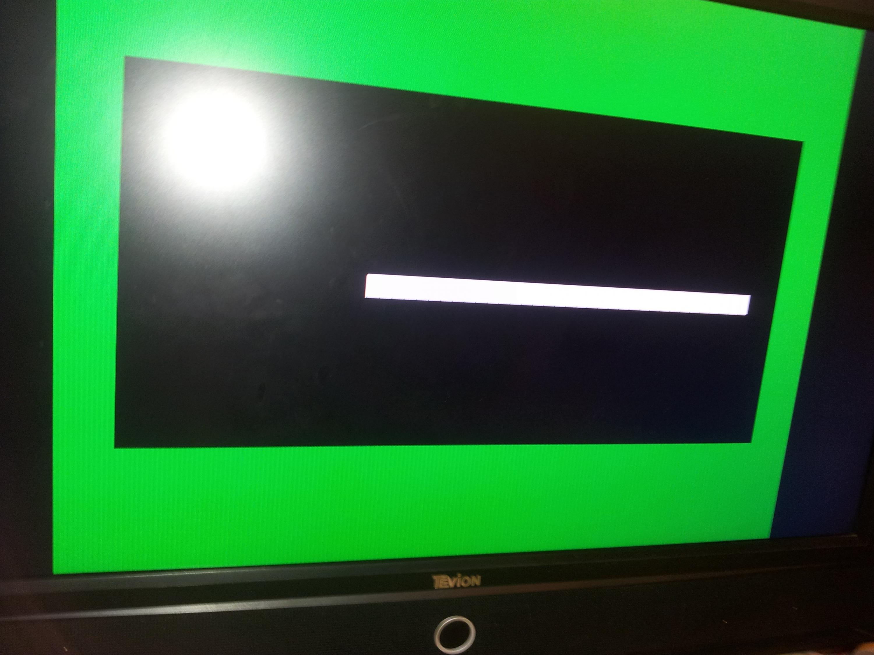

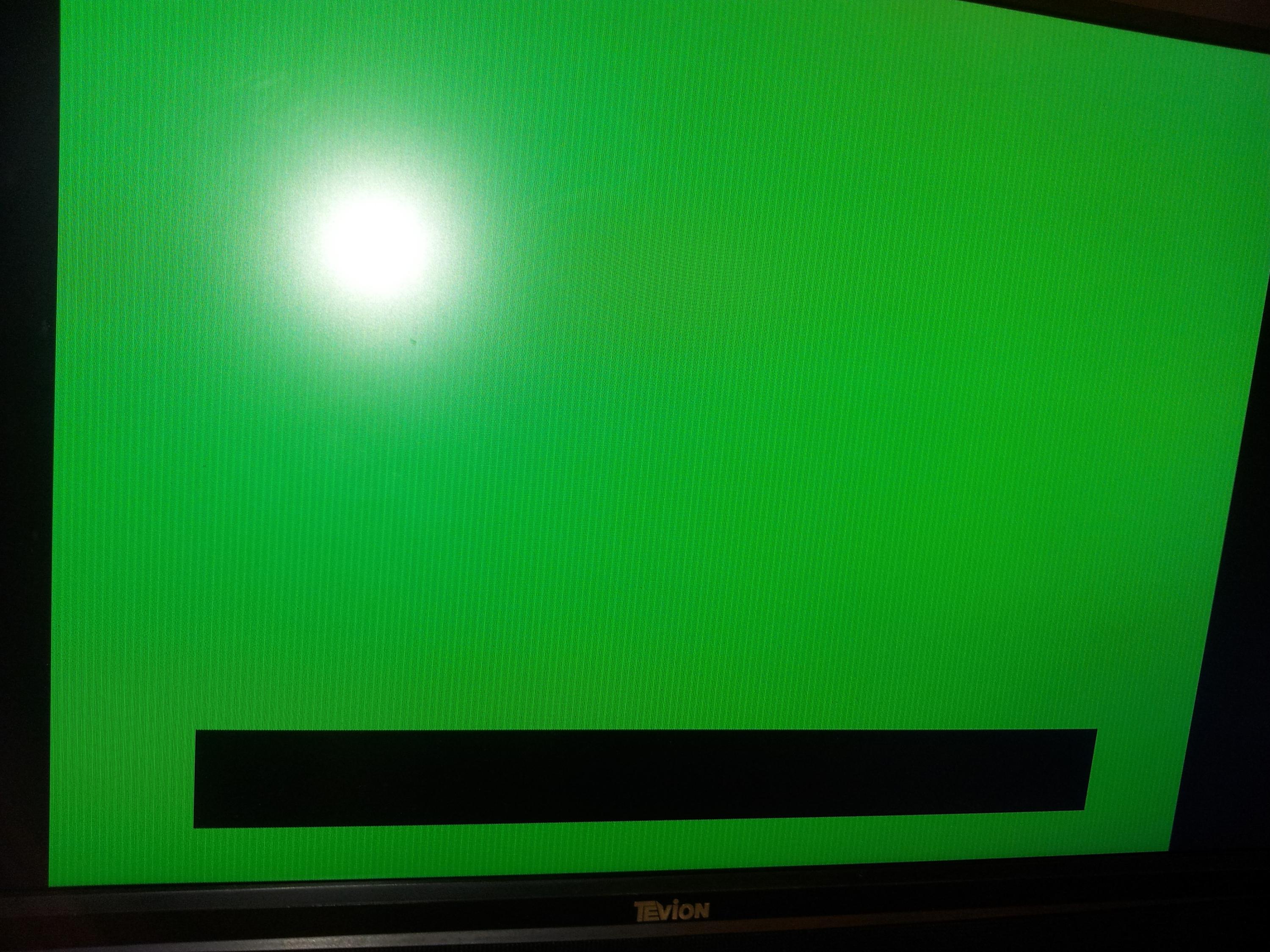

    Turn the Tv on and all functions appear to work, keyboard panel vol up and down, channel up and down, source, menu but the screen looks like its in test patterns, audio works when a source is connected.
    When Menu is selected a box appears without text but looks like it would be the Menu box.
    Select vol up and down and what appears to be the volume bar appears except theres no volume number just a blank oblong box.
    Select Source and a box in the top left corner appears except theres no text but a bar appears that scrolls up and down and source can be selected and changed.
    The screen looks like test patterns but I think the issue is either with the T-con or possibly SSB i.e Scaler

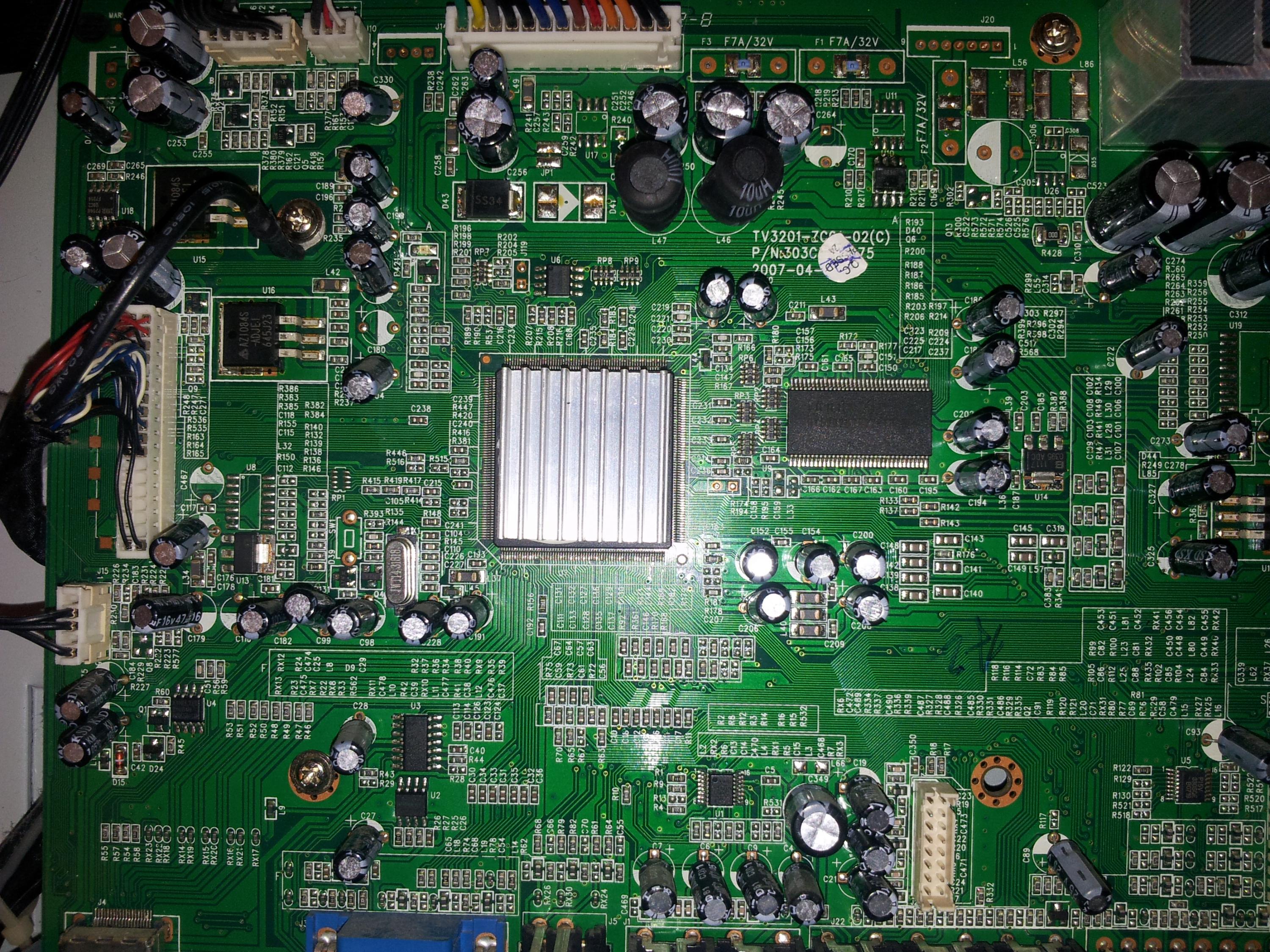

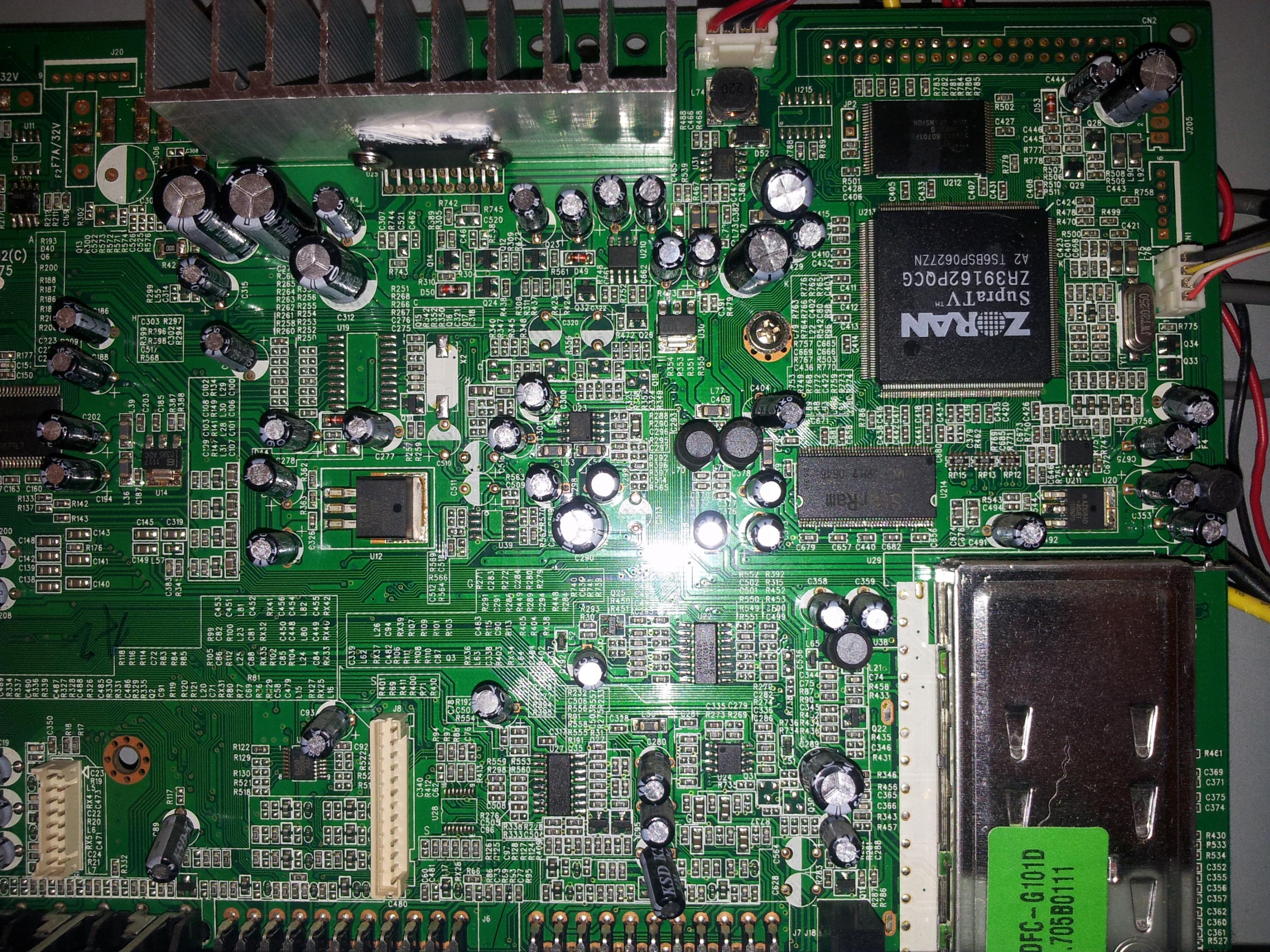

          Main A/V board
          U2 - 24C02
          U4 - 24C04
          U10 - 24C32
