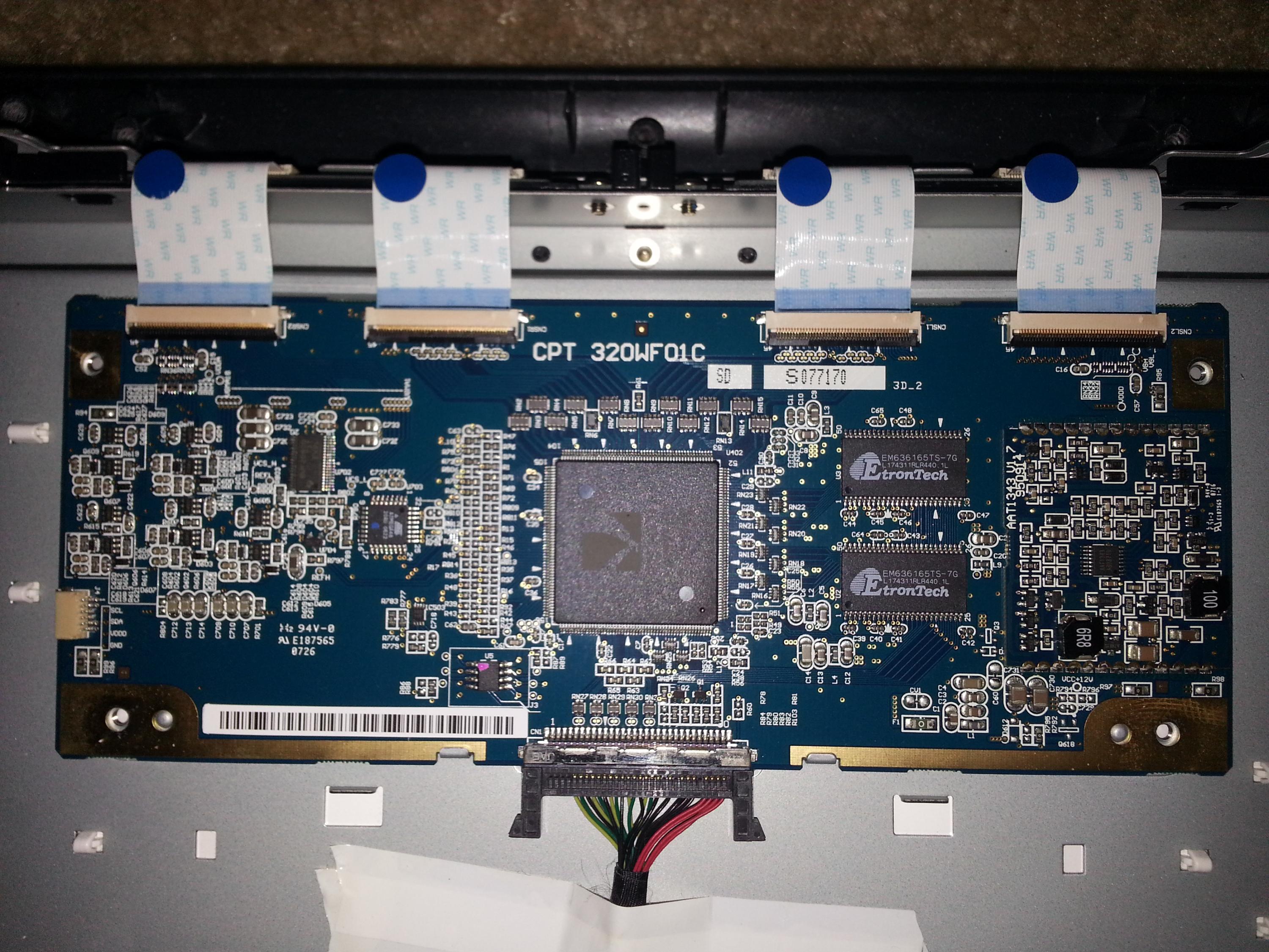

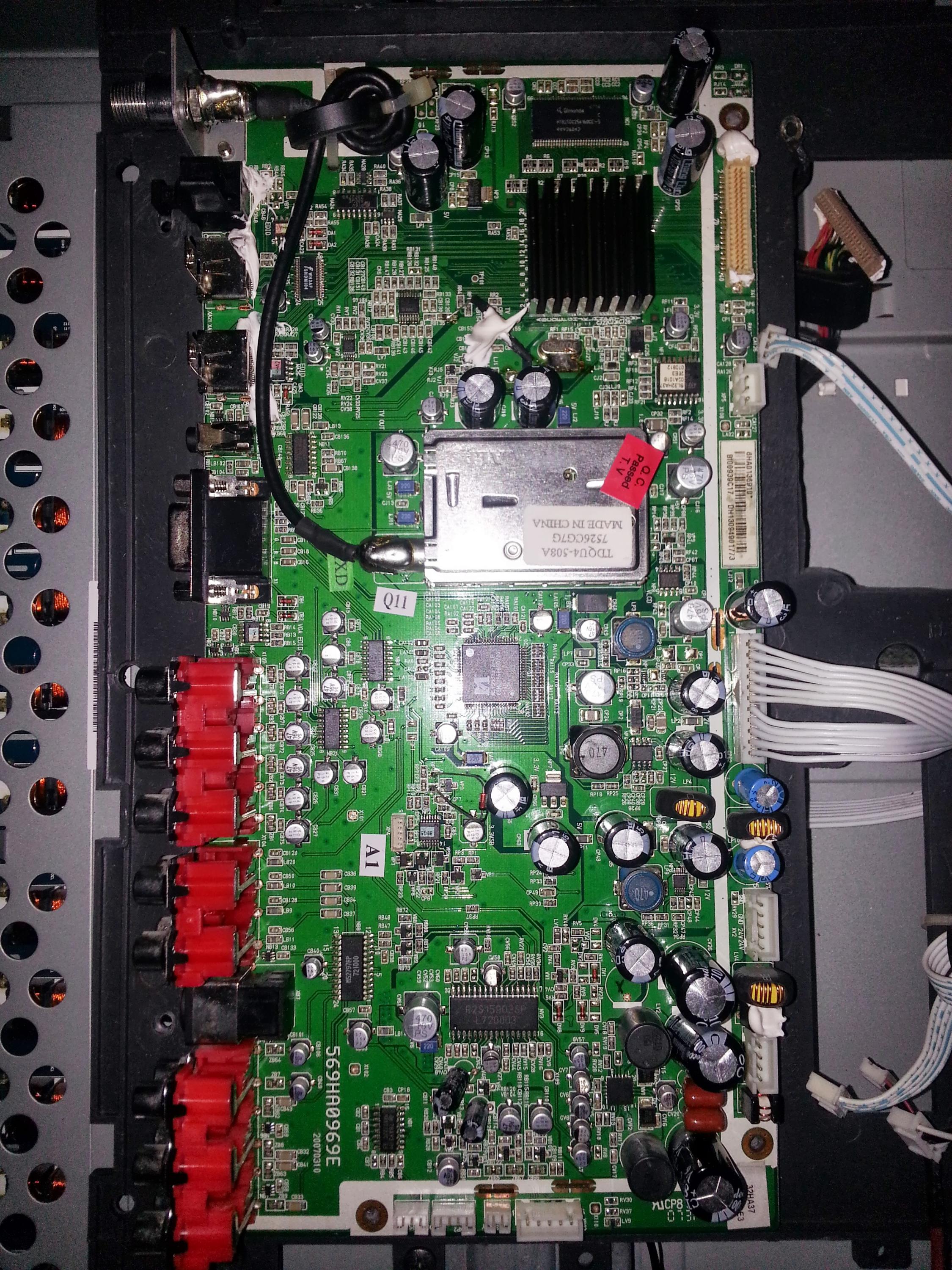

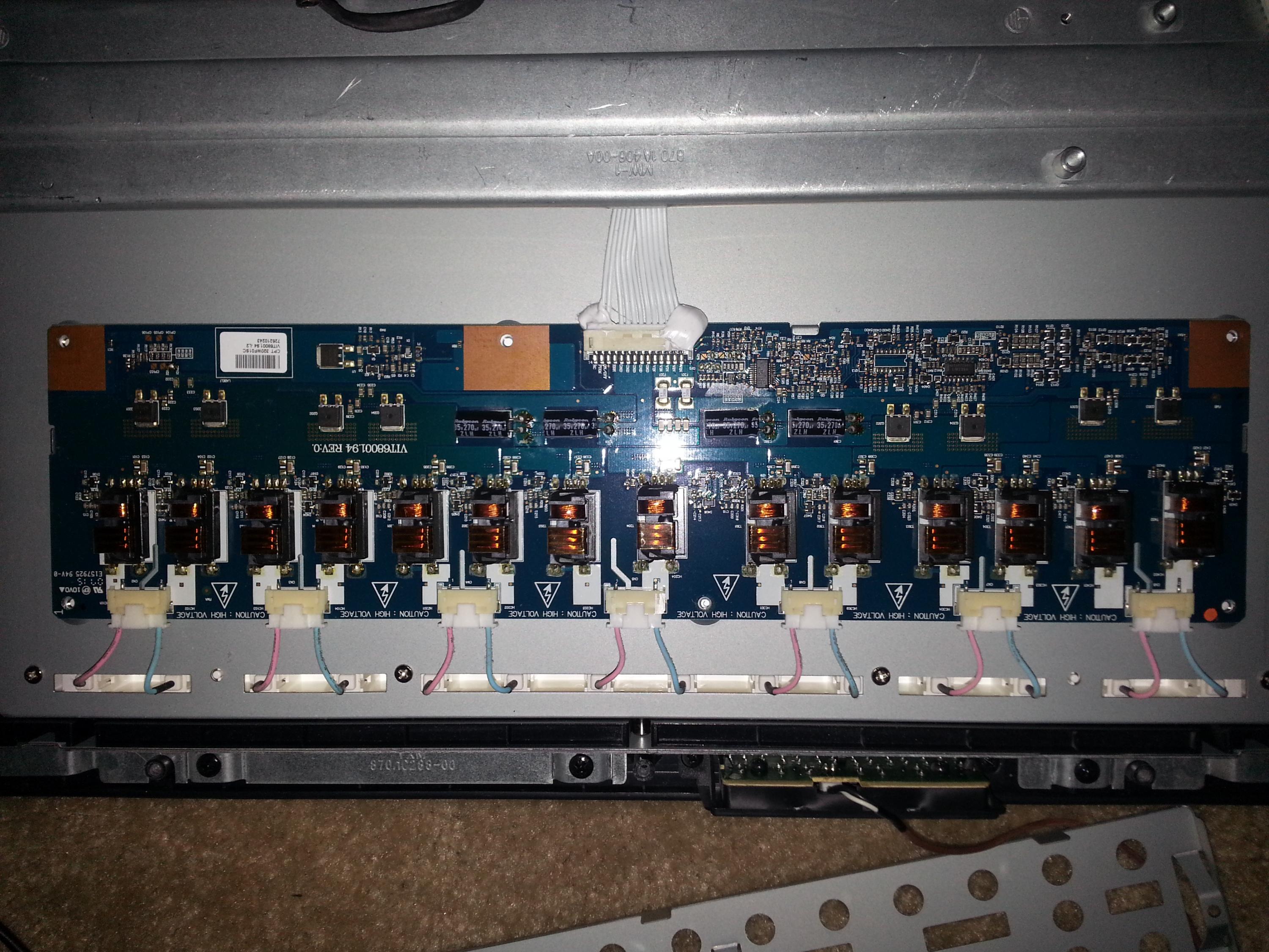

      Do you have the pictures of all the boards? at this point it seems that you may have the main board problem. You should also try disconnecting the backlights inverter board, but I cannot tell right now since I do not see the pictures of the power supply board to know if it uses power suppply/inverter combo board or not.

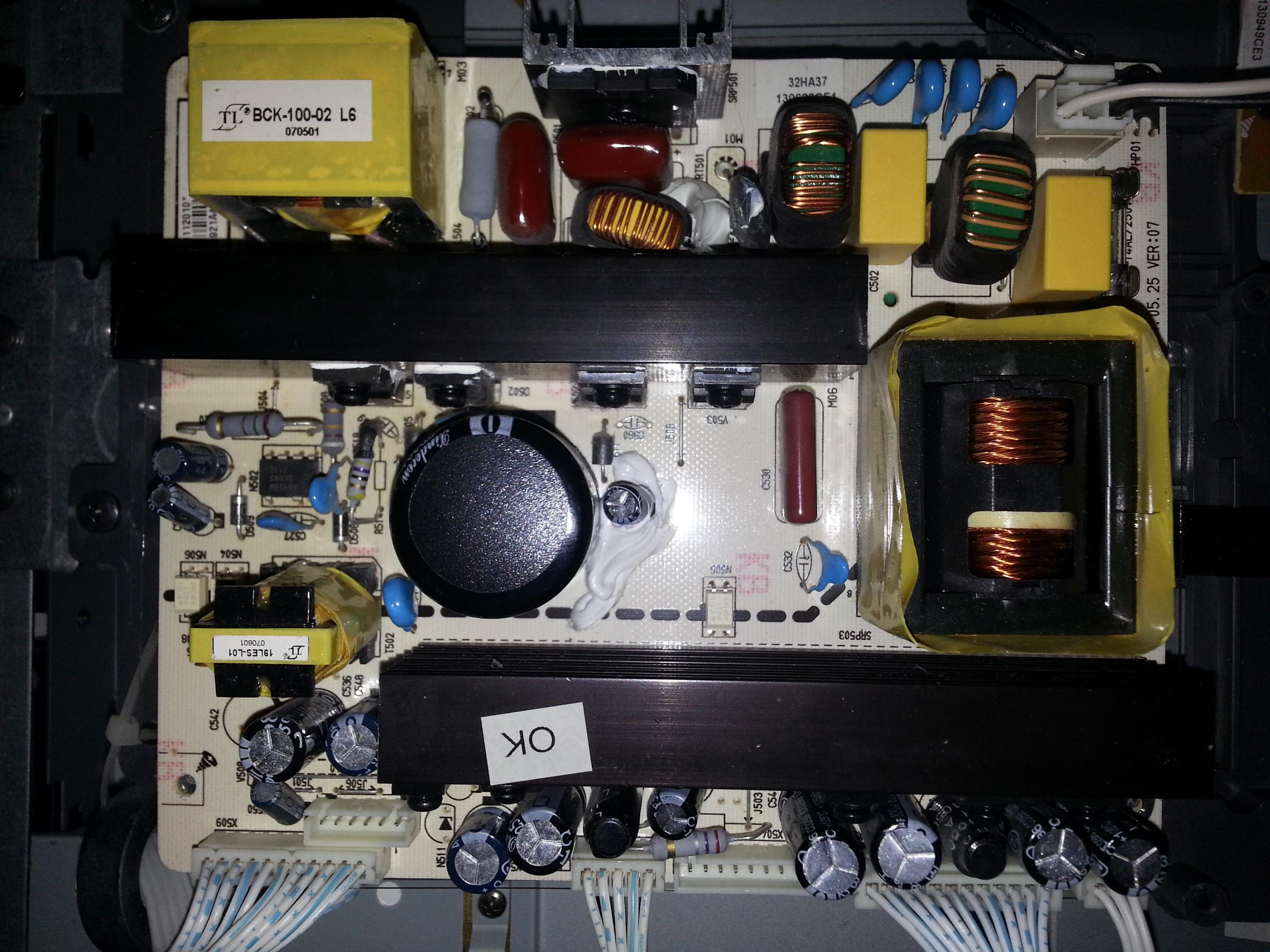

          Ok, I just measured the PS_ON pin and when the power LED is ON for its 5 seconds I get 3.267V stable, and when the power LED turns off for its 2-3 seconds it drops off quickly to 0V. Also, as you can see from the first picture of the mainboard I posted, it is connected ONLY to the power supply, and the power supply was also disconnected from the inverter board as well, so I'm 90% certain this is a mainboard issue.
          A second note, when the power LED is ON for its 5 seconds, you get a "buzz" from the power supply, whereas when the power LED turns off for its 2-3 seconds you get a squeal from the power supply (kind of a "charging the lasers" type sound). If a sound clip is needed I could try and capture one to upload.
          Here is a pic of the power supply, I'm glad you confirmed it has a 3.3v standby as every single service manual I have looked at for an NS-LCD32 have all been 5v standby. I guess I got the rare model of NS-LCD32.
          Thanks for the initial help guys as like I've said I've been tearing my hair out over this one. I don't know why I can never get the easy fixes like a lot of other people get :P

                Well I took a look at the original power supply and did find one of the output caps (47uf) to be at 16! Also, the main cap (150uf) was at 135 so I replaced both of those. Unfortunately I still can't get it to turn on as it still cycles when I plug it in. One thing that did change however is now the 3.3v standby is somewhat solid. When the power LED is on I get 3.304v and when it turns off I get 3.303v, which is a major improvement over what it was! The power supply also isn't making much of a buzzing noise anymore either.
                I'm starting to get more discouraged now as it seems as if the power supply is working correctly now, however it still isn't allowing to the TV to enter a normal standby mode. As for the one bulging cap on the logic board, that was my idiocy in putting the caps back on the board as I put that one on backwards in the picture (perfect example of why you should take breaks on working on stuff like this after so many hours). I have since replaced it, but it is only for the 24v supply which I have left disconnected this entire time.
                My next question is (budm maybe you can help me on this) will having ONLY the main power harness hooked up to the board allow it to enter standby? Or for it to enter standby do I need everything hooked up? I have been doing all my testing with only the one harness plugged in to isolate the problem, but didn't know if leaving everything else disconnected could be hurting me more than it is helping.
                Thanks again for the help, at least I got closer!

                  Ok, so I am starting to feel more like this might be a power supply issue. As it is I already found those 2 caps that were bad and replaced them and now it sounds cleaner when its on.
                  I tried jumpering the PS_ON pin to the 3.3v standby and the power supply starts ticking and the voltage for the 3.3v standby goes up and down from 0-2 volts roughly. With absolutely no load shouldn't the power supply start outputting the other 12, 9 and 5v rails when i send it the PS_ON pin? If so then this is definitely looking like a power supply issue.

                          Yep, I tried with a 1K resistor and nothing else connected and you can hear the power supply tick at about a 1 second interval with the voltage on both the 3.3v standby and PS_ON going between about 0-3v.
                          Also I measured earlier the voltage across the new main cap and now get about 350vdc with it dropping about 10vdc or so between cycles. Is 350 high enough? For some reason it doesn't sound like it.

                            A ticking suggests one of the following:
                            1) bad startup capacitor
                            2) bad SMPS IC
                            3) shorted component like a diode on the output side

                              It looks like A6159 is your SMPS IC
                              https://cdn.badcaps-static.com/pdfs/...af0bce6e6c.pdf
                              1) Measure the VCC (pin 2) and see if it is steady and stable (pin 3 = GND)? Report measurement.
                              VCC should be around 17.5V for "typical" operation.
                              2) Measure the DC voltage on the startup cap (that is tied to pin 2)?
                              3) See if VCC (pin 2) is shorted to pin 3 (GND)?

                                  So retiredcaps...I think you're on to something here. Pins 1-5 are all around 2.8VAC and pins 7 & 8 are ~8VAC. According to that datasheet that cannot be correct.
                                  Bud, nothing has changed from what I've said. You now see my confusion. When hooked up to the mainboard I get 3.304V with power LED off, and 3.302 with power LED on. Yet, for some reason with no load when I jumper the PS_ON pin to 3.3V the power supply cycles on and off every second.
                                  I feel like we are getting closer, something is obviously up with the SMPS. Note, all these readings were taken with the mainboard disconnected and the 3.3 standby stable and no power supply ticking.

                                        Wow I feel like an idiot now I just had it in my mind DC on one side of the dotted line AC on the other and didn't even take a second to completely comprehend the datasheet schematic.
                                        Pin
                                        1........... 0.00
                                        2.......... 17.78
                                        4.......... 0.482
                                        5.......... 177.5
                                        7.......... 171.0
                                        8.......... 171.0
                                        So now seeing these numbers it looks like the SMPS is in fact working. So does that mean we can somewhat eliminate the hot side for problems? And does anybody understand why the supply switches on and off every second when I pull PS_ON up?
