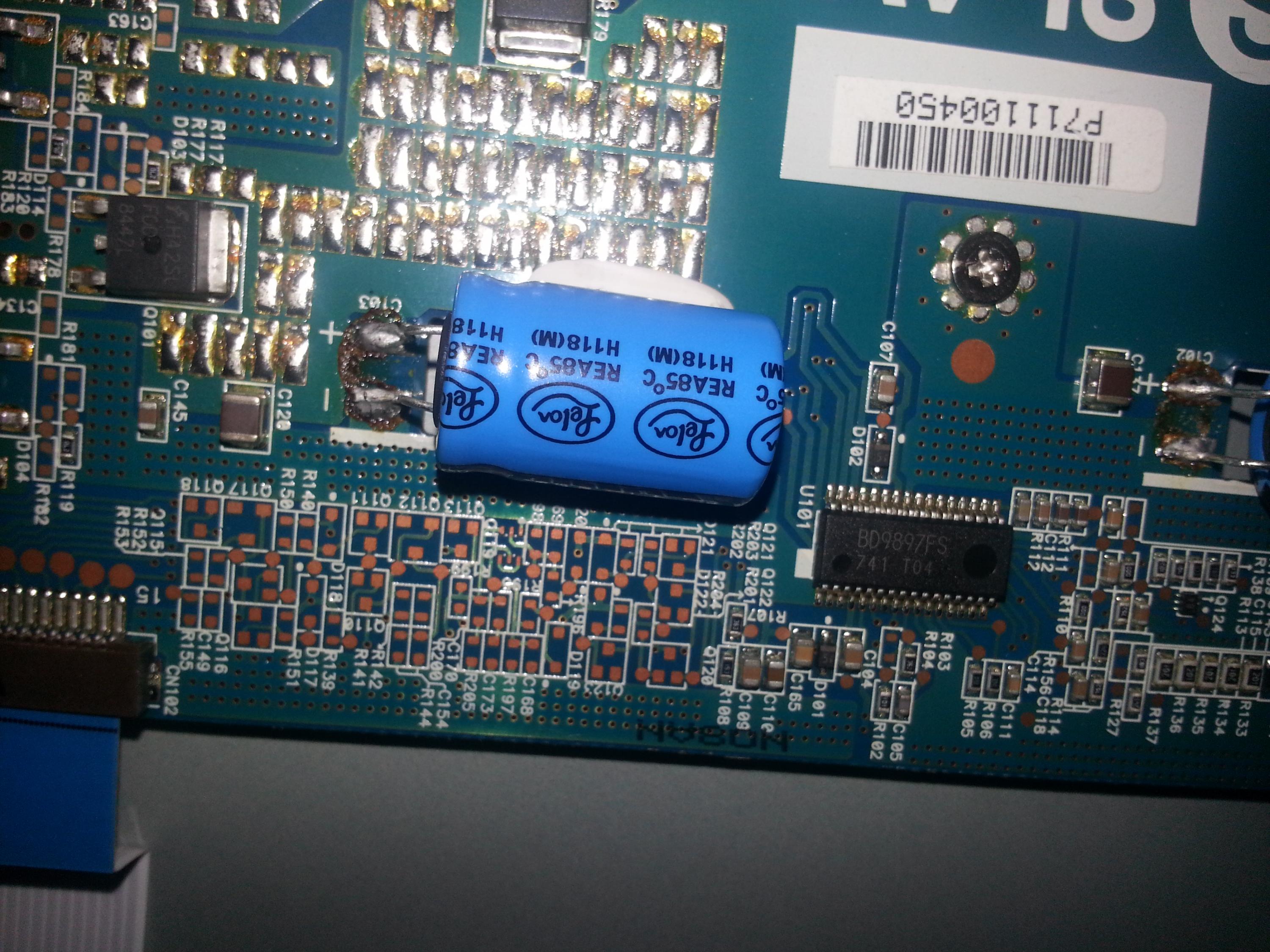

    I have a 47" Philips - 47PFL7422D. It would turn on and within a minute go extremely dim and flicker. Found both caps in both inverters (master and slave) were popped, so I replaced all four of them this morning. Powerd up and things are a bit strange:
    It was bright as it should be on the right side, still dim on the left. After a few minutes, the right side went dim but there was no flicker. I unplugged the left (from the front, slave) output to the CCFL and the right side went back to a normal brightness. It has enough light output to actually light the left quite well on its own. I've let it play off the DVR for many hours now, and it's been solid.
    I went back just recently, and plugged the left (slave) side back in (output to CCFL). Entire panel immediately went dim. Unplugged and it returned to how it was (right bright, left dim). Any ideas what would cause this behavior?

            Local electronics supply store is usually a big indicator of non-low-ESR capacitors which the inverters require to function correctly. The bulged ones may have actually briefly been better! Any chance you could take a picture of these capacitors so we can get an idea of the manufacturer and series?
            We highly suggest buying caps from digikey.com or from the Badcaps.net store, as both provide the right parts, whereas typical store bought caps are not up to the job. Even if the worked first time, they would fail in short order (a year at the longest in a high stress environment.)

              Is there any reasonable way to test that? I can place an order, but would have a better warm fuzzy feeling if I could somehow determine that it was the likely cause. Such as, could I determine that proper voltage is being output to the ccfl?
              Now that I snap a pic of the cap, I see immediately that it's an 85 degree part (the bin was labeled 105, my fault for not checking more closely). But I can't imagine that would play directly into it with the back off and immediately upon power up. Though it could lend itself to gauging the quality of the part.
                Re: Philips 47PFL7422D - Dim on left side (different than other thread)
                Those capacitors are certainly not suitable. Lelon capacitors are among the worst, cheapest crap you can buy. They are 85°C rated; originals would have been around 105~130°C. The temperature rating itself doesn't factor much into performance, only life. But, almost nobody, and certainly not Lelon makes low ESR capacitors in 85°C ratings.

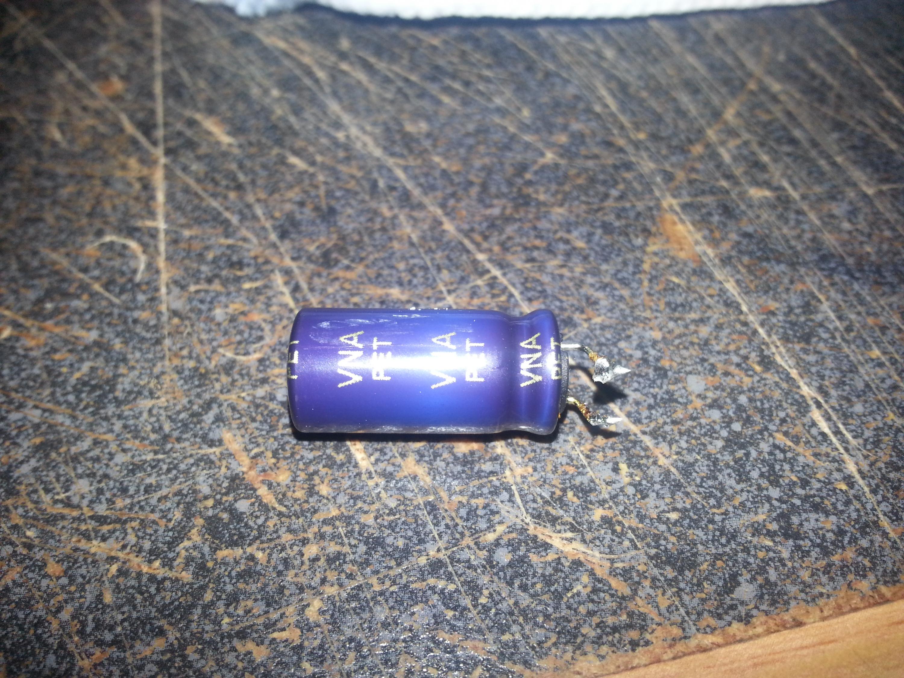

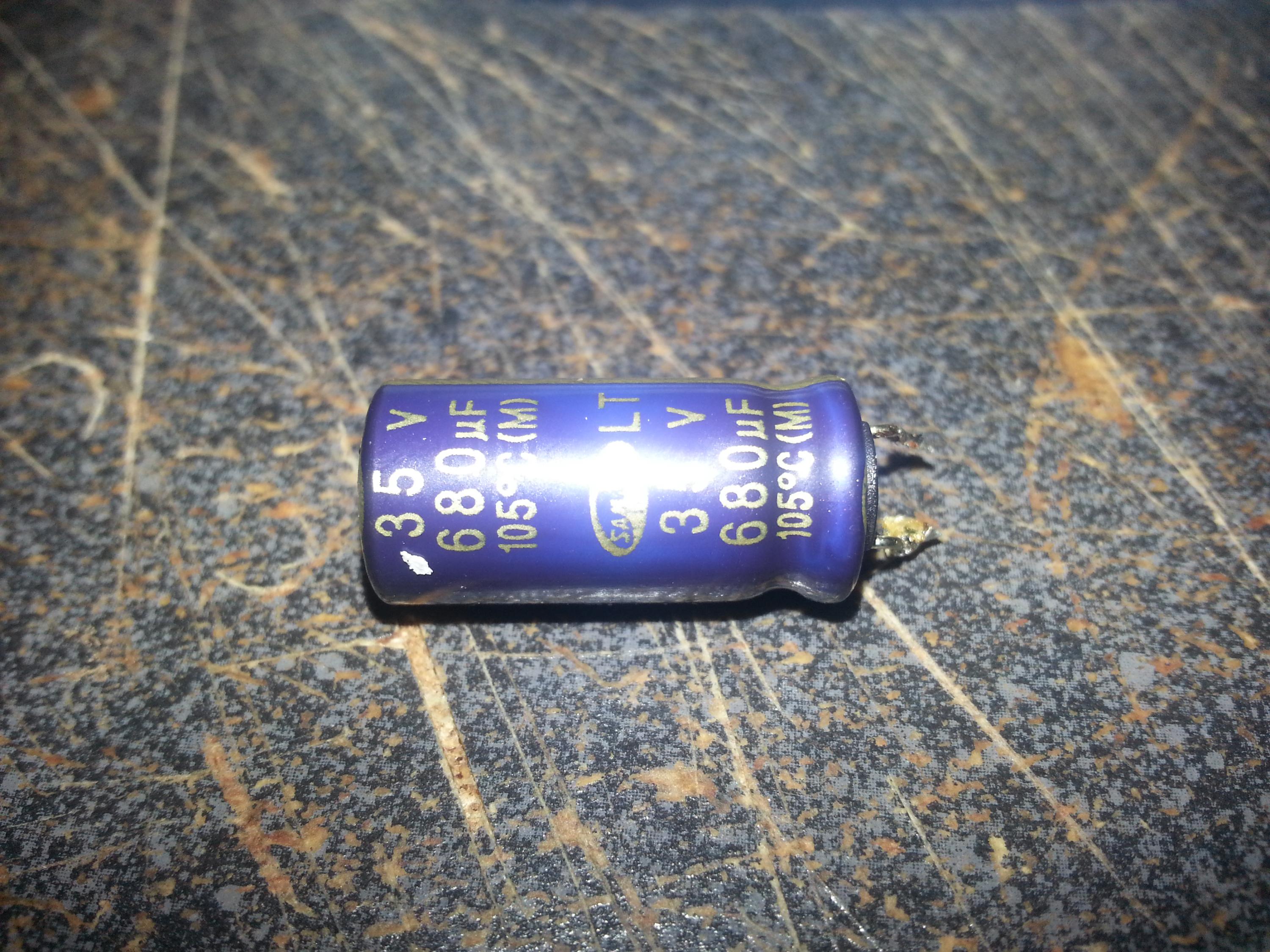

                  Here are the original caps
                    These:
                    http://www.digikey.com/product-detai...6CT-ND/3072276
                    will be fine. Add $2.50 postage.
                    Badcaps.net does not carry 680uF 35V unfortunately.

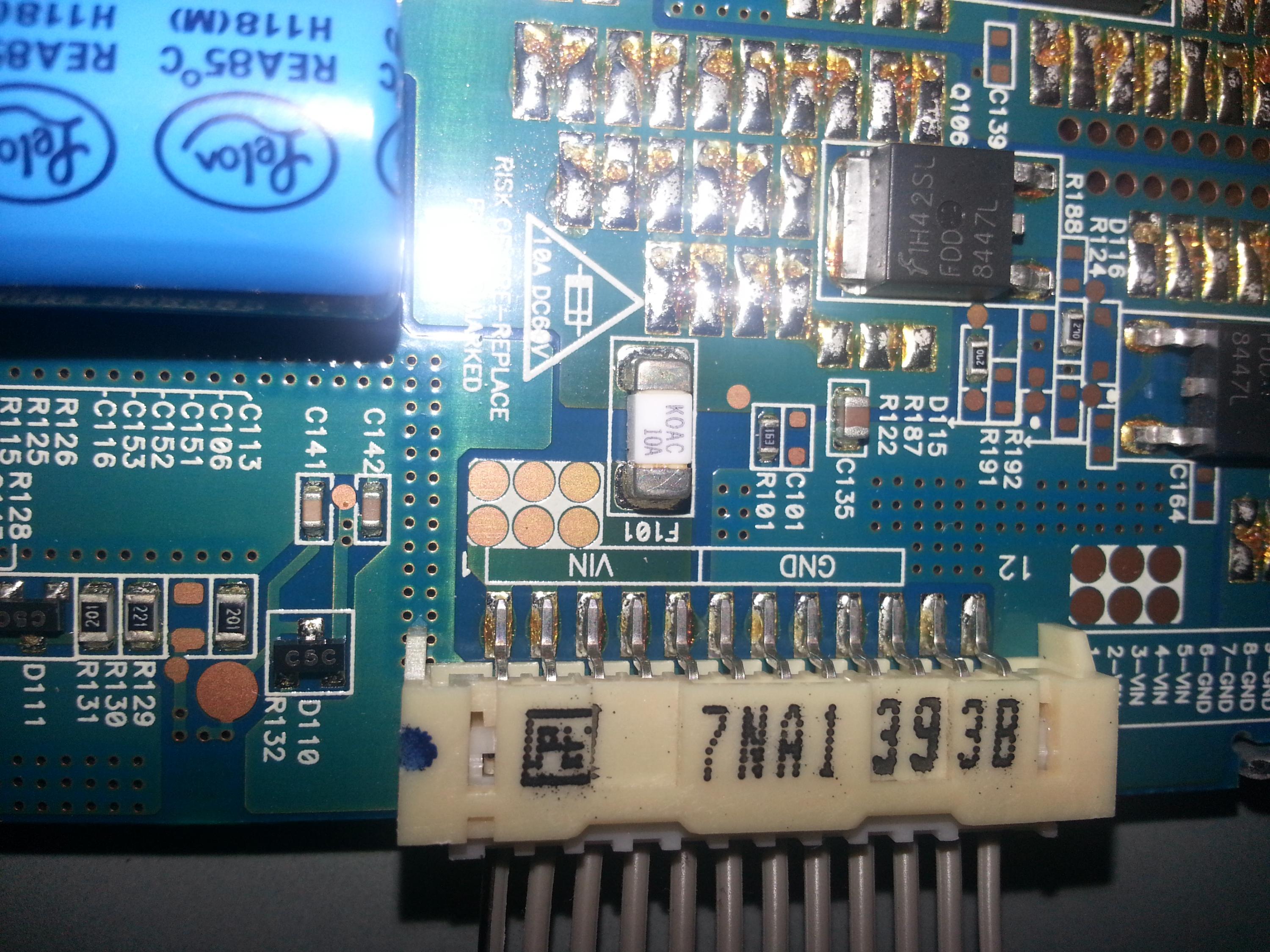

                            I'll be smurfed! The fuse is actually bad (no continuity). So the question is - does it make sense that with a blown fuse, plugging in the slave CCFL would bring down the master side? And the age-old question: is the fuse blown the problem, or a symptom (what caused the fuse to blow, same thing that caused the caps to pop or was it the caps popping)?

                              Success! I swapped out the fuse, so lucky and random that I had another 10a ceramic on-hand. The set is now 100% lit up. I'll still change the caps when they come in, they already shipped (digi-key doesn't mess around with shipping!).

                                New caps arrived. While installing them won't solve any immediate problems (since there aren't any at this point), they will provide longevity to the set. Again, thanks to both of you for the assistance!

                                  having similar problem, can you tell me where the 10a ceramic fuse is located, is it on the slave board or power or main, thanks.
                                  • DLinkOZ
                                    • May 2013
                                    • 238
                                    Sorry for getting back to this so late, but it was on the slave board.
