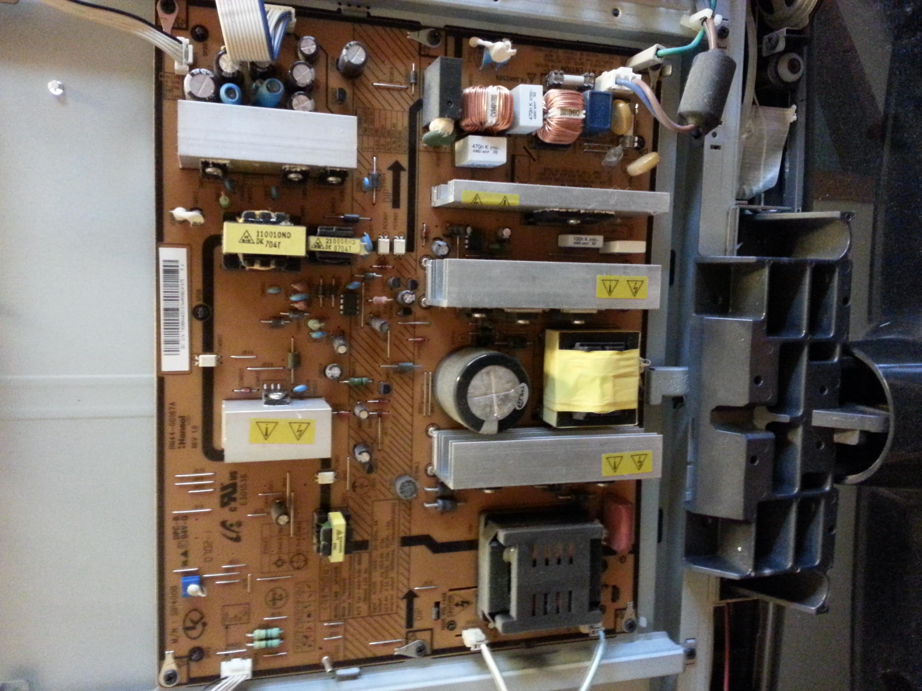

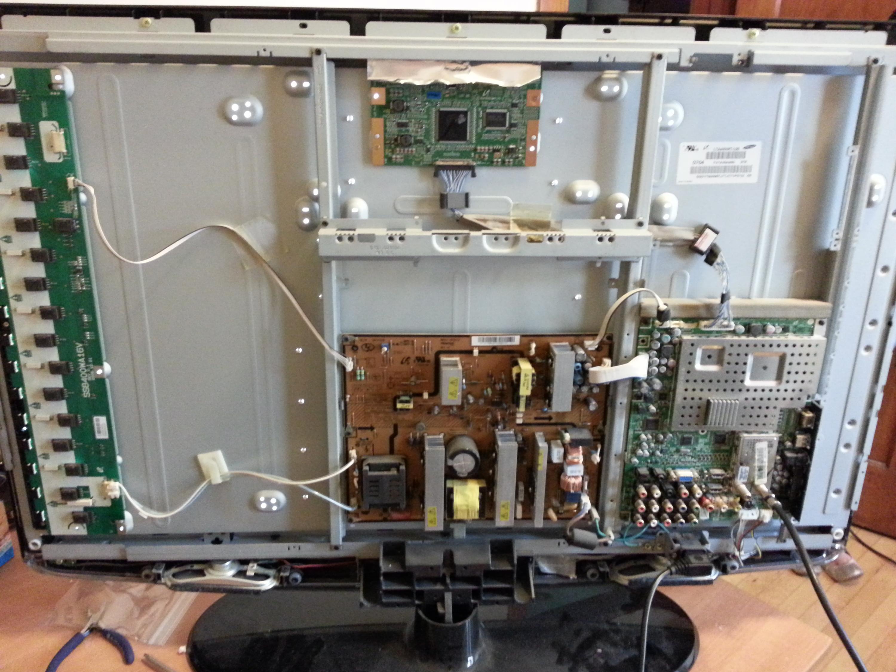

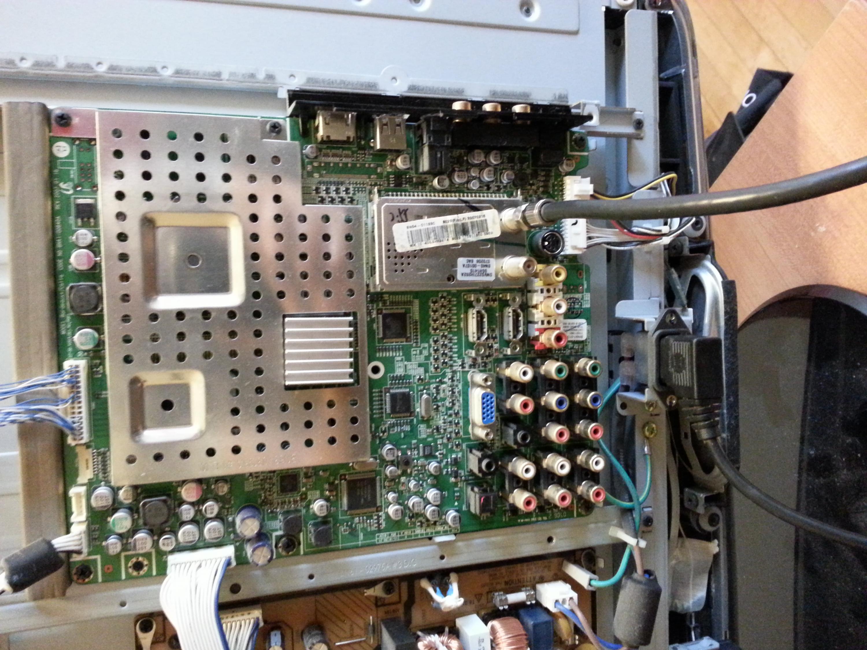

    I have a samsung
    Model LN-T4053H
    Model code LNT4053HX/XAA
    It has a blue vertical line on the right side of the screen

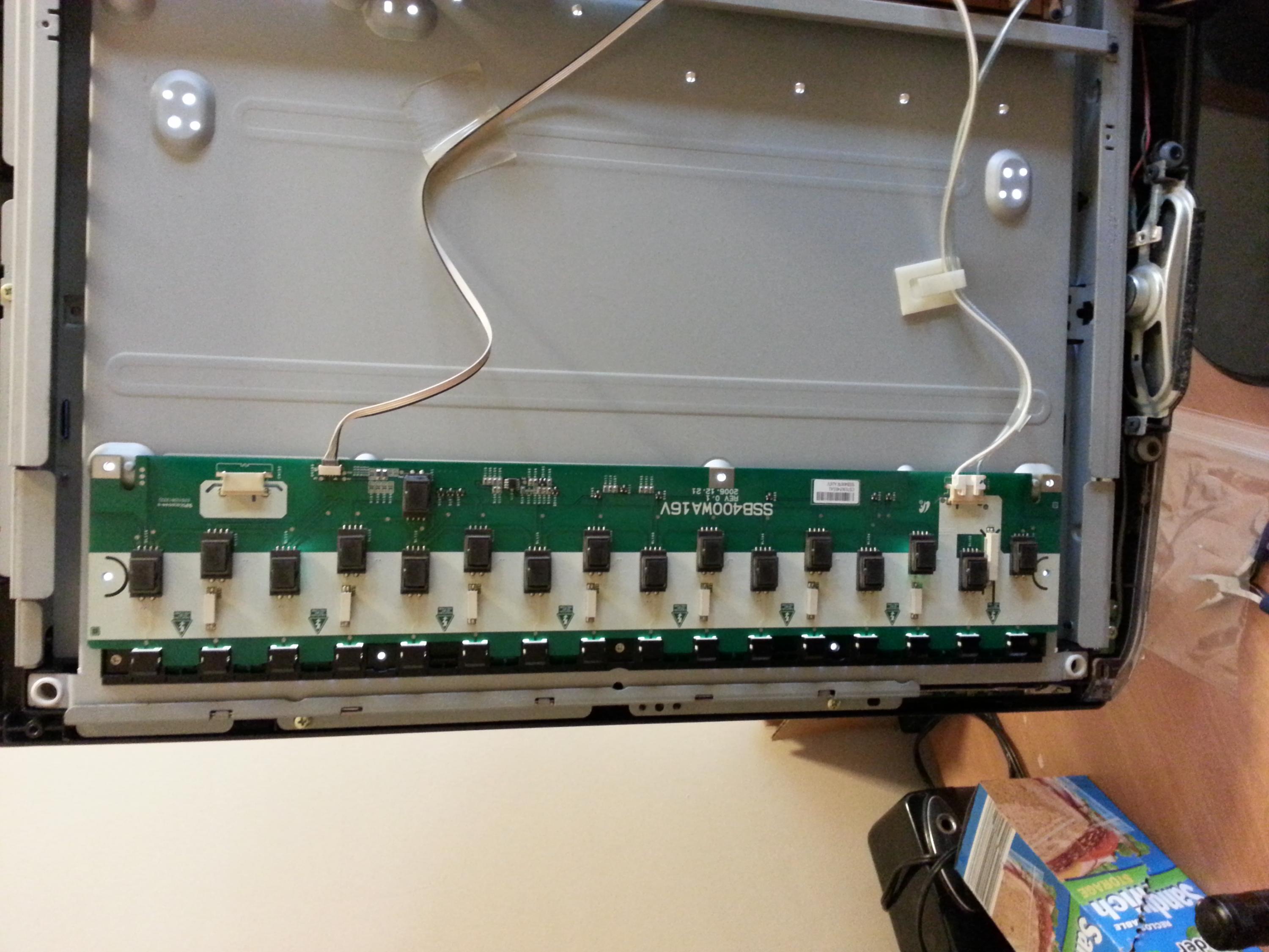

    Im guessing it has something to do with inverter board but not sure
    I also noticed 2 separate faint yellow vertical lines in the center of the screen
    Thanks for any help
    Re: samsung LN-T4053H blue vertical line
    It is more likely to be an LCD panel fault. Not repairable.
    Definitely not the inverter.
    Can we have a picture of the fault? Just to confirm if it is the panel or not.
    • jose6326
      • May 2013
      • 707
      The blue vertical line comes and goes
      I just turned on the tv and there were no faults
      When it happens again I will post a picture
      • jose6326
        • May 2013
        • 707

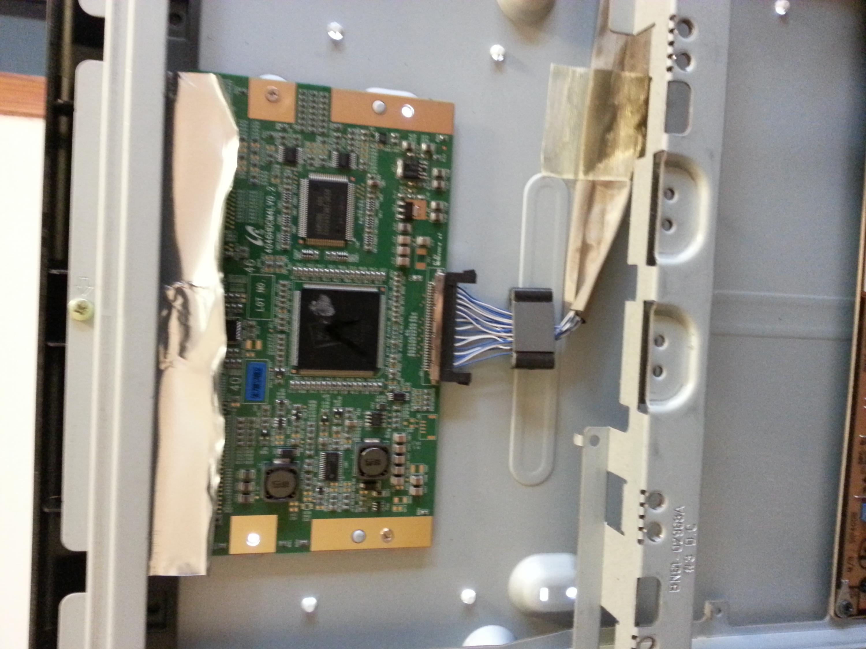

        I cant get the blue vertical line to come on anymore
        I leave the tv on for a while turn it off and on and nothing
        I did disconnect and reconnect the ribbon cable to the t-con board
        Maybe I got lucky and that was the problem?
        Thanks for the help
