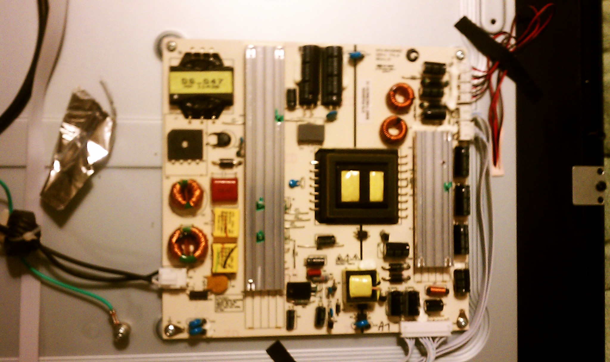

    I'm working on the Viore LED42VF80.
    I have searched the Control board, the Main Board and the Power Supply Board for blown Electrolytic Capacitors, to no avail .. by sight alone.
    I'm just an apprentice in this and learning, as I probably will always claim no matter how much more of this work I continue. Which I can only hope does.
    So.. let me tell you what I have done already and maybe you (someone) can coach me thru the routes I need to in order to press forward to the wanted end result; a working T.V.
    I have a digital multi meter (2) and even a new digital oscilloscope that I'm dieing to learn how to use!
    So.. let me show you the dilemma..
    LED came to me and would turn on for a little bit, a white Viore Logo Screen and then after a few seconds it would turn off.
    I have read this Thread: https://www.badcaps.net/forum/showthread.php?t=20369
    And followed it unto belief that it was the Video Mainboard, which I found was the house of the inverter, by calling and asking a tech at viore what the part number for the inverter was. He actually showed me how he looks up part numbers thru encompass parts.
    So.. anyways.. I ordered the part, I put it in and the T.V. came right up. The Viore Logo Screen came and went a Very Blue Screen came up and a floating menu appeared. Well, I had another call to go out on so I left it on my bed turned on, knowing I'd be back within an hour. I came back and the T.V. Was off and now when I turn it on, the viore logo screen and back light don't even kick on.
    Now.. if you look at my pics.. you see I have the equipment to figure this out.. I'd like the consistent know how to do this so if anyone has the patience to help me thru the first one.. (Or two .. lol) I'd be Really appreciative and over joyed!

    Have you tried using circuit cooler when it goes bad? Sounds like a thermal problem.
    Buy a can of it and spray the suspected area - If it kicks on then tighten the spray area to less and less components. You should be able to get your problem down to 2 or 3 parts.

      So Anyways.. after that I got this beast out of the corner.. the LED42VF81
      A thermal issue.. what's strange is .. I replaced the Video board, it did the same thing. Then I bought and replaced the power board.. It does the same thing.
      Both boards bought off Ebay, and it does the same thing.. So, then I took the new video board off, put my old one back on; it still is doing the same thing.. only it takes a little longer before it goes off the first time, but though I can turn it right back on, it turns off sooner.. So, obviously making it appear to be a thermal issue.. (Overheating Issue) but what..? LOL

          Dead unit even with a new power supply, We have found that the problem is inside the LED panel, To be more specific the red B+ wire on the led strips is touching the aluminum ground plane on one or more LED strips, To verify without taking the panel apart just disconnect the 4 sockets and measure for a short across the pins, If shorted then the problem is inside the panel.
          Reason of failure is the close manufacturing tolerances, The Plexiglas reflector is to big and the corners right on the top of the solder connections are pushing against the red B+ wire on the left and right strips thus creating a short.

              Just switch the multimeter into continuity mode and put the leads across the pins/leads in question.

                OK, when you remove the female connector (the one with red/black wires) from the circuit board, those wires on the connector go into the LCD panel assembly which contains the LED string assembly, those wires may get nicked by the sharp edges of the panel so it make contact with LCD panel metal chassis. So for you to find out if that is happening with your LCD panel or not, you need to check the resistance between the metal chassis against each pin of that female connector to see if any one of them show resistance readings.
