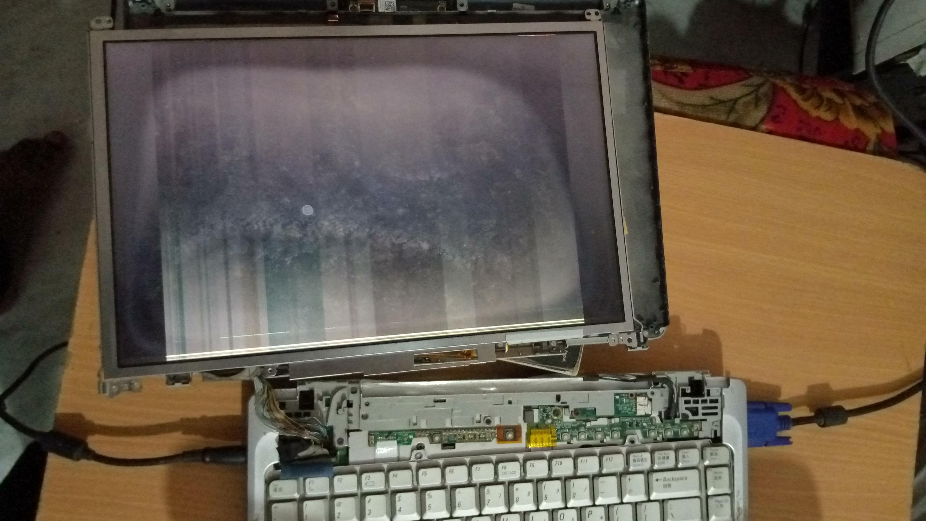

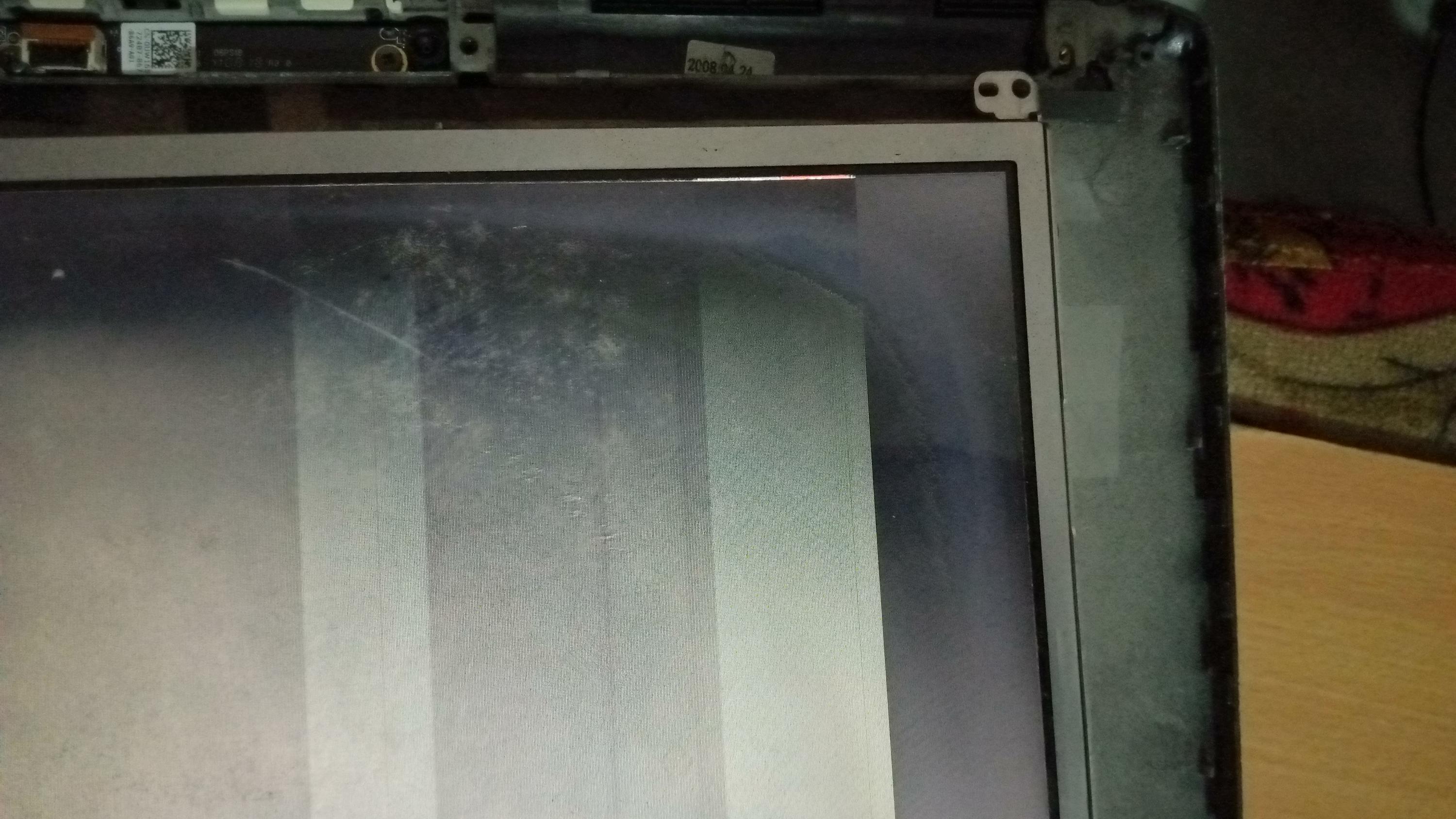

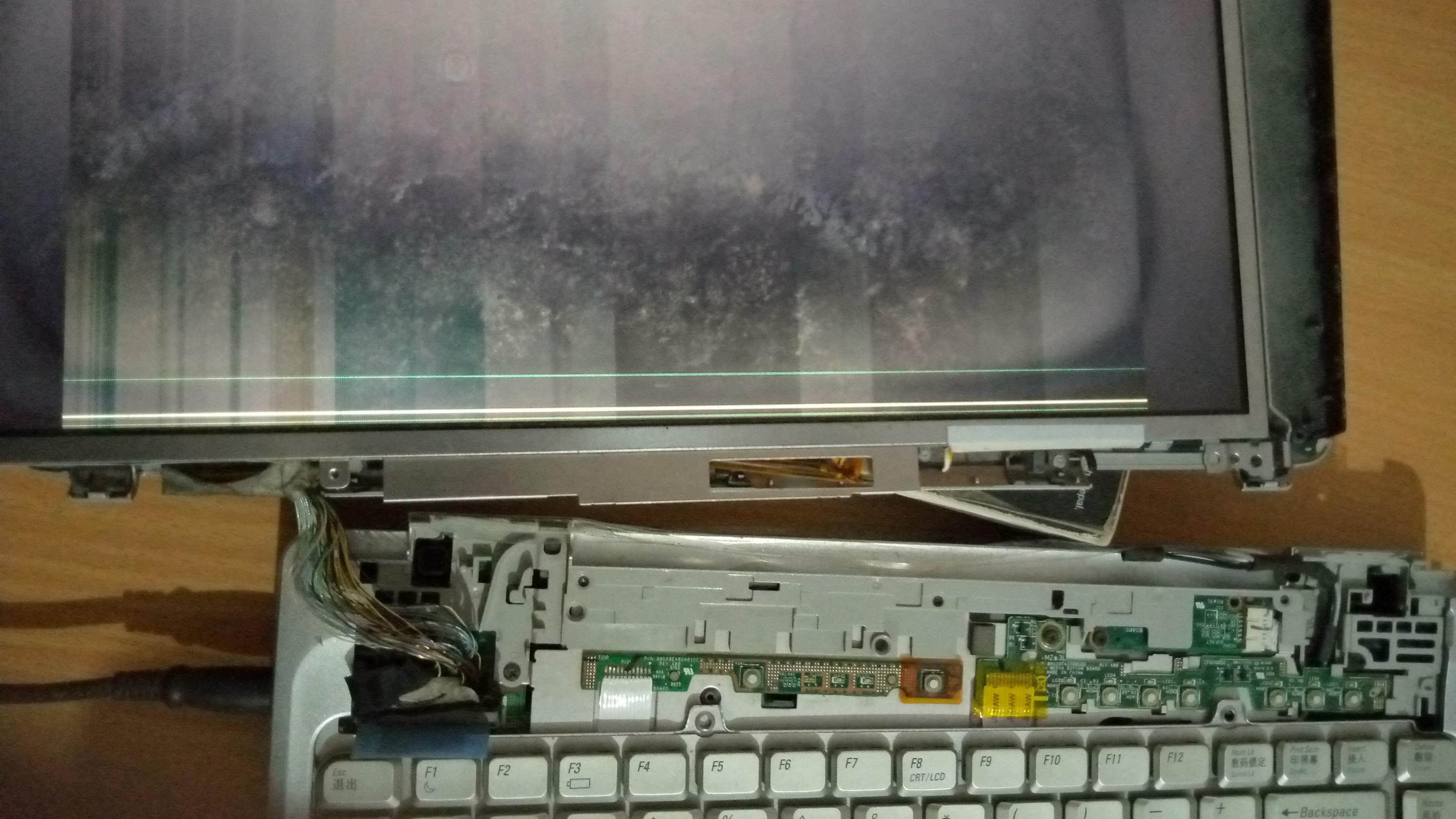

    this lcd first started showing green lines horizontal ,with flickrs then one day stopped showing rest of the screen , now it just like in the pic , i can see mouse at top,also the icons at right end of screen , i also tried to look around the cable wires ,adn loosened it ,but its the same result . i tried the flex test , the monitor changes to white ,and different colours, but dint show the actual picture , external monitor vga connection is good, so please guide me what next to do . please verify the pics, thank you .

      it looks like LCD is dead

          Its the COFF bonding brooken between screen and logic board of lcd. You need to remove all the COFF, rebuild the traces, put new COFF. This process requires COFF binding machine. So simply replace the whole screen.

            thank you @mcplslg123 ,i was thinking the same thing, is it possible ,it was due to inverter heat damaged this ?,because it was pretty hot to touch those days ,i thought its pretty normal or such ..
