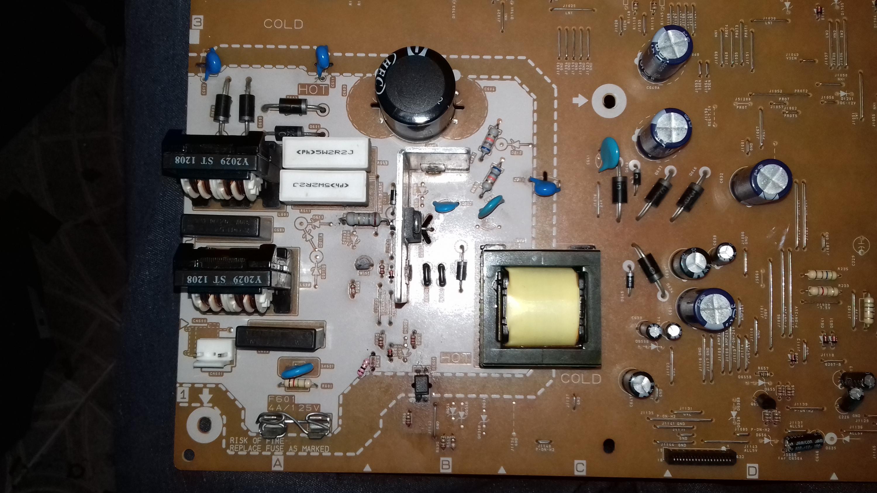

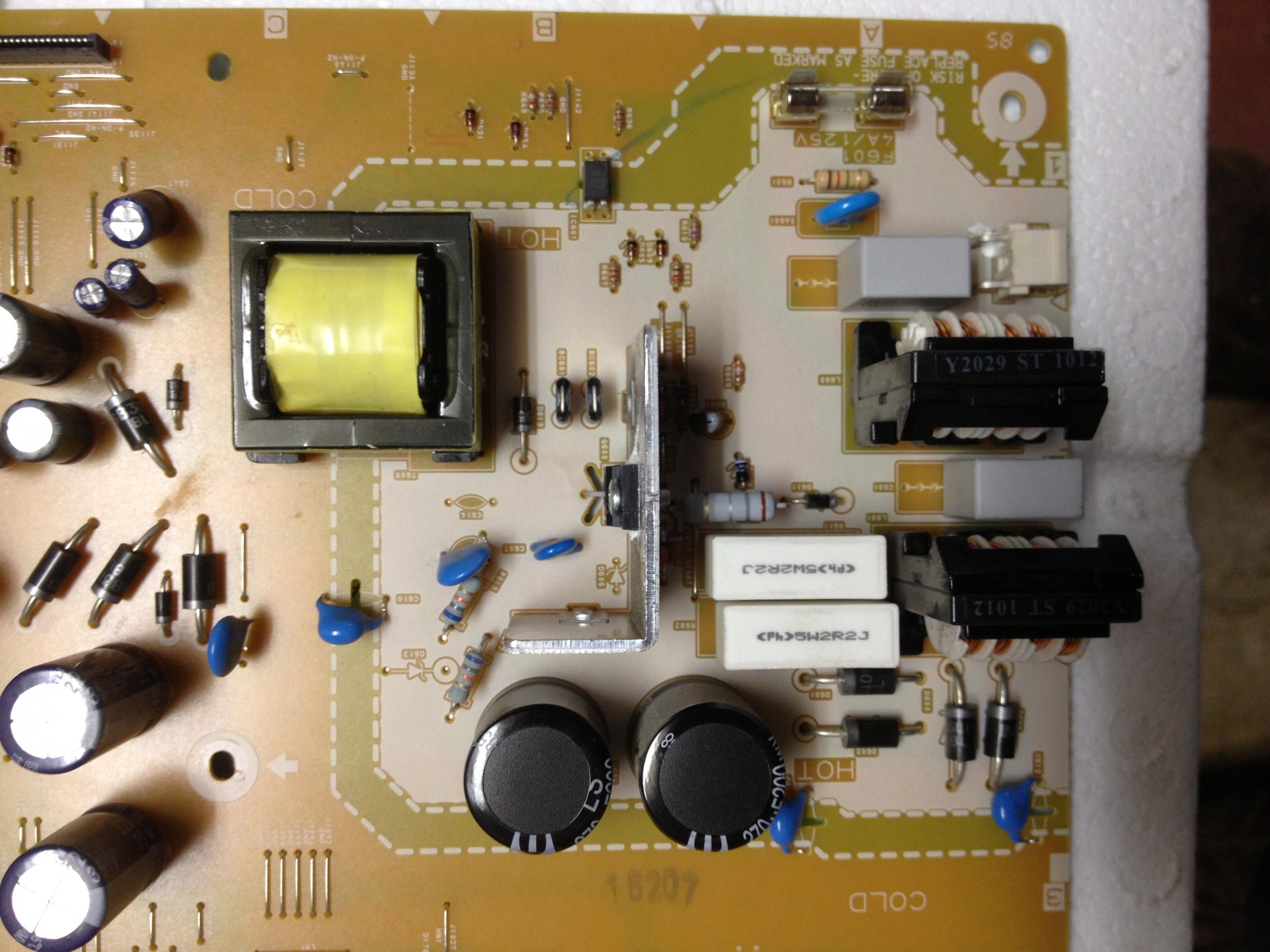

    I have an Emerson LC320EM2 that will not power up. No LED or anything.
    I purchased a power supply replacement kit that had a resistor, 2 diodes, a mosfet and a transistor.
    The problem I found was that Diode D607 was shorted and when I would replace it, it would keep shorting.
    the kit I used included:
    D607, D610, D604, D640, Q601, Q600, and R608.
    After replacing all these parts, I am still having no power, no LED.
    Also D607 and D610 are shorted again.
    Has anyone seen this before or have any suggestions?
    Thanks in advance for any help.

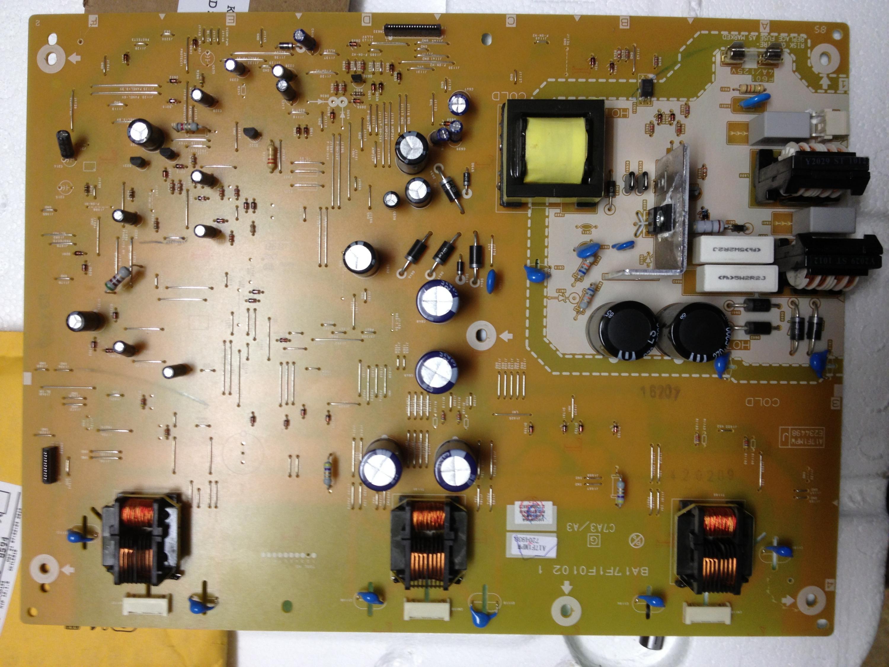

    Re: Emerson LC320EM2 not powering up
    here is a pic of the board and a close up of the power supply part of the board.
      I ran into this train wreck last month. and the only conclusion I made is not the one your looking for, I never found the true problem, so I tossed it. Got to be to much time invested for such a small set. I replaced everything that I could find defective and still no power, same as yours it kept blowing the zeners. Sorry I couldn't be of any help.

          I successfully did one of these very similar models, it was a Sylvania and the parts I replaced were very close to yours but some more. Check to see if you have a D640 on the bottom of the board, it's an SMD diode and was bad on mine, I beleive causing same issue.

              Heres a list of what I replaced
              Q600 - FET MOS TK10A50D - Mouser
              Q601 - TRANSISTOR 2SC2120-Y(TE2 F T) - Ebay
              D604 - DIODE ZENER 27BSB-T26 - Part # 568-5893-1-ND
              D607 - SWITCHING DIODE 1SS133(T-77) - Part # 1SS133T-77CT-ND
              D640 - DIODE SCHOTTKY SMD SK2B-TR - Part # SS210-TP
              R602 - CEMENT RESISTOR 5W J 2.2 OHM H 10MM - Part # 280-CR5-2.2-RC
              R605 - RES CARBON FILM T 1/4W J 220 OHM - Part # 291-220-RC
              R606 - RES CARBON FILM T 1/4W J 180 OHM - Part # 291-180-RC
              R608 - METAL OXIDE FILM RES. 2W J 0.18 OHM - Part # PNP300JR-73-0R18
              R611 - CEMENT RESISTOR 5W J 2.2 OHM H 10MM - Part # 280-CR5-2.2-RC
              F601 - 4A /125V SLO Glass 5x20MM Fuse - Part # F3594-ND

                  Repaired one of these Emerson TV's today, so saved another one from the junk pile: I used parts I already had on hand and had to cheat a little.
                  Q600 TK10A50D shorted, replaced with K2698 (had to bend the legs and drill new hole through the heat sink and added isolation mat)
                  Q601 2SC2120 open, replaced with 2sc5344
                  D604 27BSB shorted, replaced with 1N4749 1W 24V
                  D610 1ZB36 shorted, replaced with 1ZB43 43V
                  D640 SK2B shorted, replaced with FR207
                  R608 2W 0.18 OHM open, replaced with a 0.18Ohm 5W cement resistor
                  F601 4A /125V SLO open, replaced with same
                  Got another working TV!

                    On my model R605 & R606 were both 120 ohms.
                    Since D640 appears to be the cause of all the other components going bad I decided to use a schottky diode with greater current capacity to avoid another failure. Digikey had one that handles 5 amps rather than 2. Their part number is SB5100DICT-ND.
                    This is a through hole diode so I carefully drilled a couple holes through the circuit board and installed it from the top. So far so good.

                      I just repaired one of these as well. What a bloody nightmare!
                      Initially purchased the typical repair kit, replaced 12 components, promptly re-blew Q600, Q601, D604 & D610. Problem child turned out to be D640. (It wasn't initially obvious because everything else was on the cold side.) I finally ended up pulling T600 from the board just to circuit-trace and tracked down a shorted D640. Re-replaced blown stuff, *poof*, I was finally able to call my customer for pickup of a working TV.
                      A little trick when trouble-shooting this board - I lifted a leg on R605 to isolate and traced with voltage measurements. Surprisingly, the schematic for this set is quite good, with reference voltages, etc.

                        On these TV sets, D640 is what causes the problem. So I hope you did upgrade D640 with something beefier. I had the FR207 originally in there, but I did take it out again and used a 4A 200V diode instead. This TV that I repaired is still running to date.

                          Got another one of these this week. Ordered the shopjimmy kit. D640 is the culprit. Both sets. Easy fix.
