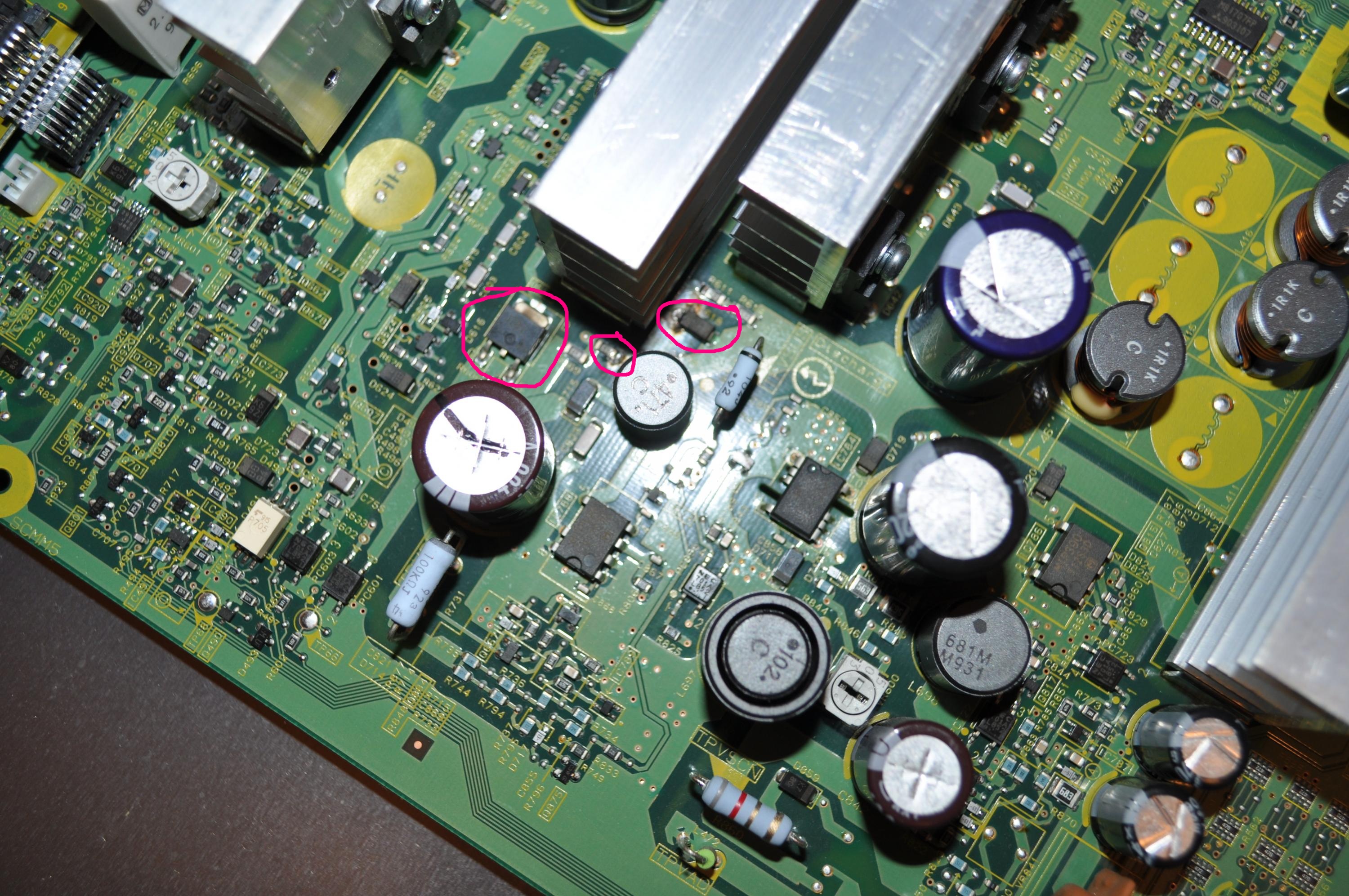

Panasonic Viera TC-P50G10 7 Blinking Red

      I want to order the FET as well but I am having a hard time cross referencing the code J281 8H

        Ok I found the service manual and found the fet I need
        Q16604 B1CHPM000001 FET 1
        Now how do I find that at Digi-Key The Part number does not come up.

            Re: Panasonic Viera TC-P50G10 7 Blinking Red
            Most of the numbers are going to be a Panasonic assigned number, some are real but all those "B" numbers are only useful if ordering direct from Panasonic.
            So have a look at the device and the markings you can usually work it out, google etc
            J281 will be 2SJ281(Sanyo)
                      this is your pic i circled the problems i think as far as i can tell on my board these are my bad componts cant you tell any others are bad on yours or are these the ones you are going to replace.
                      again thanks for all the info

                        #31
                        Resistor 683 P68KGCT-ND
                        Resistor 473 P47KECT-ND
                        Diode RF101L4STE25CT-ND
                        Still looking for 2SL281
                        Ordered all from Digikey

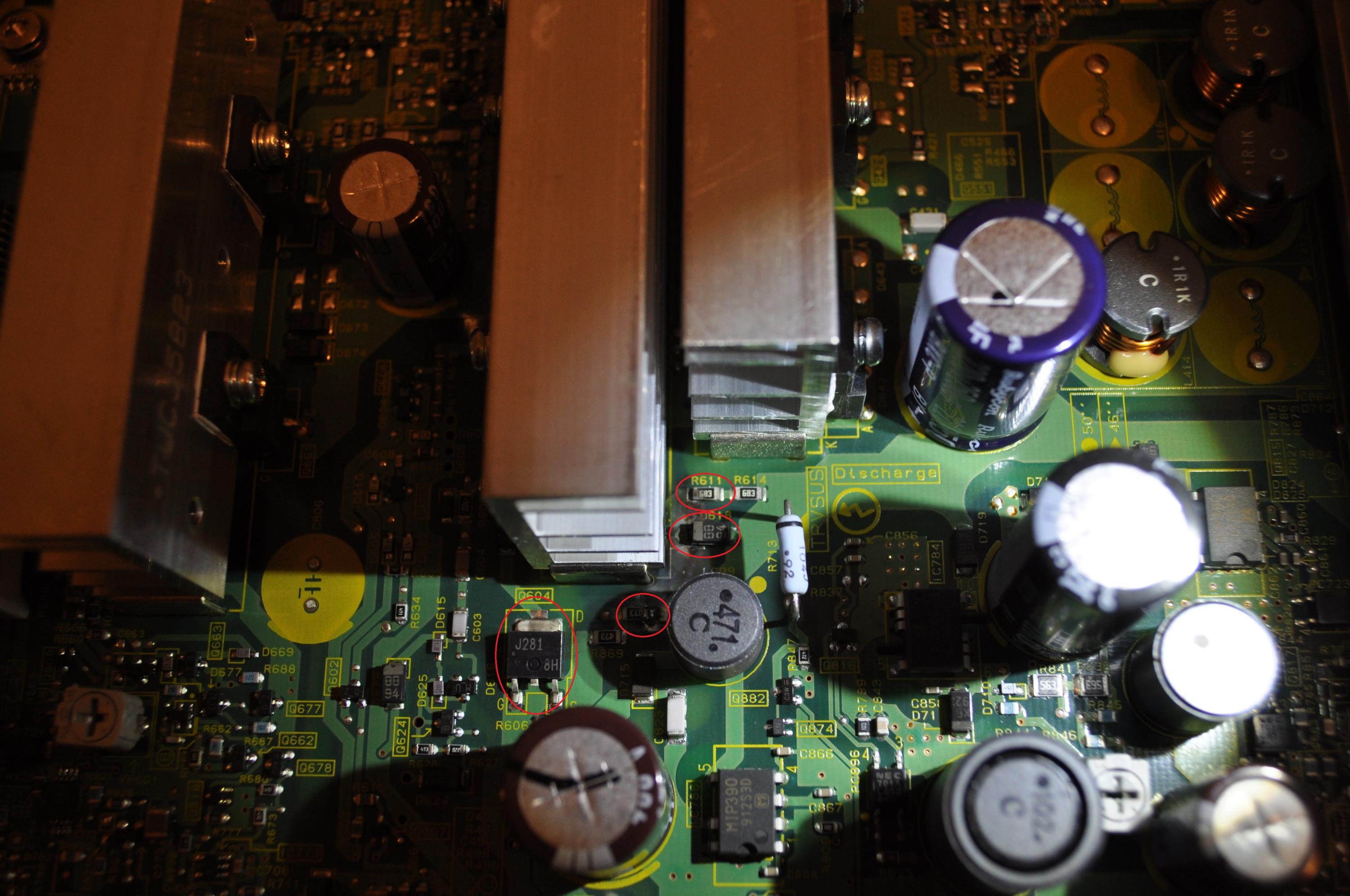

                          could you circle on the picture where the other resistor you are replasing is on the board so i can test if i need it as well

                            #33
                            Sure Here you go

                              #34
                              Ok changed the diode and resistors now we are down to a 5 blink code which is the 5V SOS. I have been unable to find the Mosfet 2SJ281 I have checked the datasheet but am unable to find ant suitable replacements.
                                Unplug SC see if it goes back to 6/7/8.
                                5 blinks can be PDP fault.

                                      #38
                                      It goes back to a 6 blink code with Connector and ribbon disconnected from SC board

                                        #39
                                        Update received the Mosfet and replaced it still no change. 5 Blinks. When I plug it in I hear a few clicks as it is attempting to power up. When I hit the power button it buzzed/hummed (not very loud) for 3 seconds or so then clicks again and goes into shutdown mode.

                                          #40
                                          I feel that it is something around the burnt spot in the board because before I started replacing components on the SC board it had 7 blinks. I wish I could find a SC board for this but it appears to be a popular item and not available anywhere.
