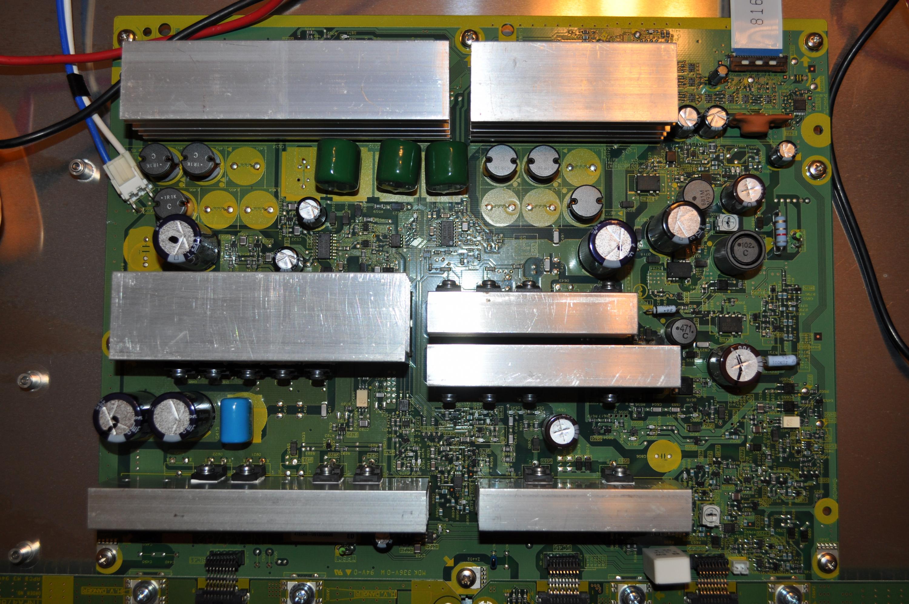

    Panasonic Viera TC-P50G10 7 Blinking Red
    Picked up another freebie, (it amazing what people throw away). I know this is a common problem and will do some thread searching. I haven't worked on a Plasma yet but I couldn't pass this one up. Upon my initial inspection I definitely found a problem as you can see in the close up picture there is an area of arc'ing maybe lightning damage on one of the boards.

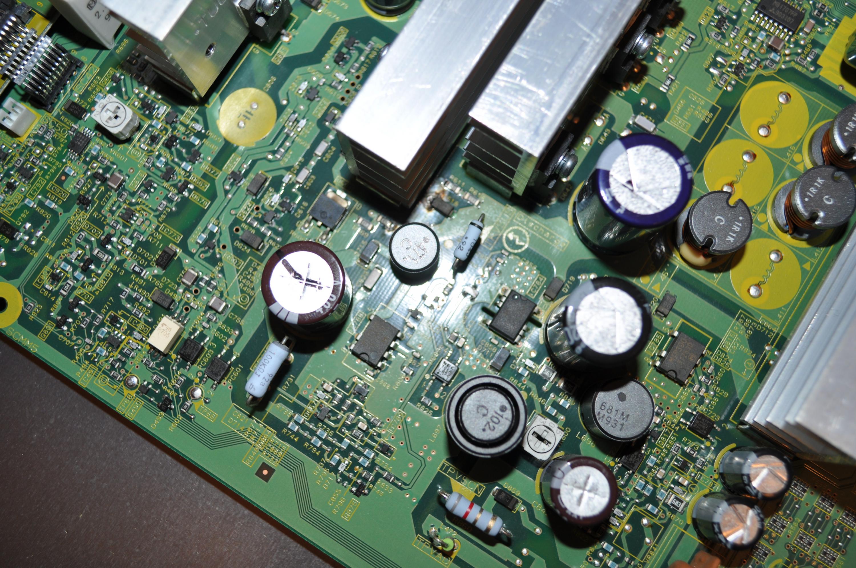

    Re: Panasonic Viera TC-P50G10 7 Blinking Red
    Here's a closer picture of the burnt area, pretty much thinking I need a SC board.
      Do you think changing the 2 resistors and the diode that are fried would be worth a try or do you think the board is beyond repair?
        Actually looks like something may have been spilled in there that caused that, from the photo's. Up to you how you tackle this, I have the full circuit diagrams, you can try to repair the SC board, and there is also a way to run the set with the buffers disconnected to prevent any damage to them by jumpering a connection. So assuming the buffers have survived I would suggest you start taking some readings around that dodgy looking area.
        Also test the connector that carries the VS and 15v supplies to the SC board, see that it's not shorted to ground on one of those rails.
            Thanks for the help. I am new to this (plasmas especially) can you point me in the direction of the VS and 15v supply.
              Well actually there only appears to be a VS supply on the SC board there, I think the 15v comes via a different path. Anyway on your first picture at the top left is a large connector with a blue and white wire. Check resistance on the SC board from the white connection to a ground point (or between the two points on the connector). Short there means more investigation and there's likely FET damage along with the problem you have observed. Panasonic call it VSUS rather than VS.

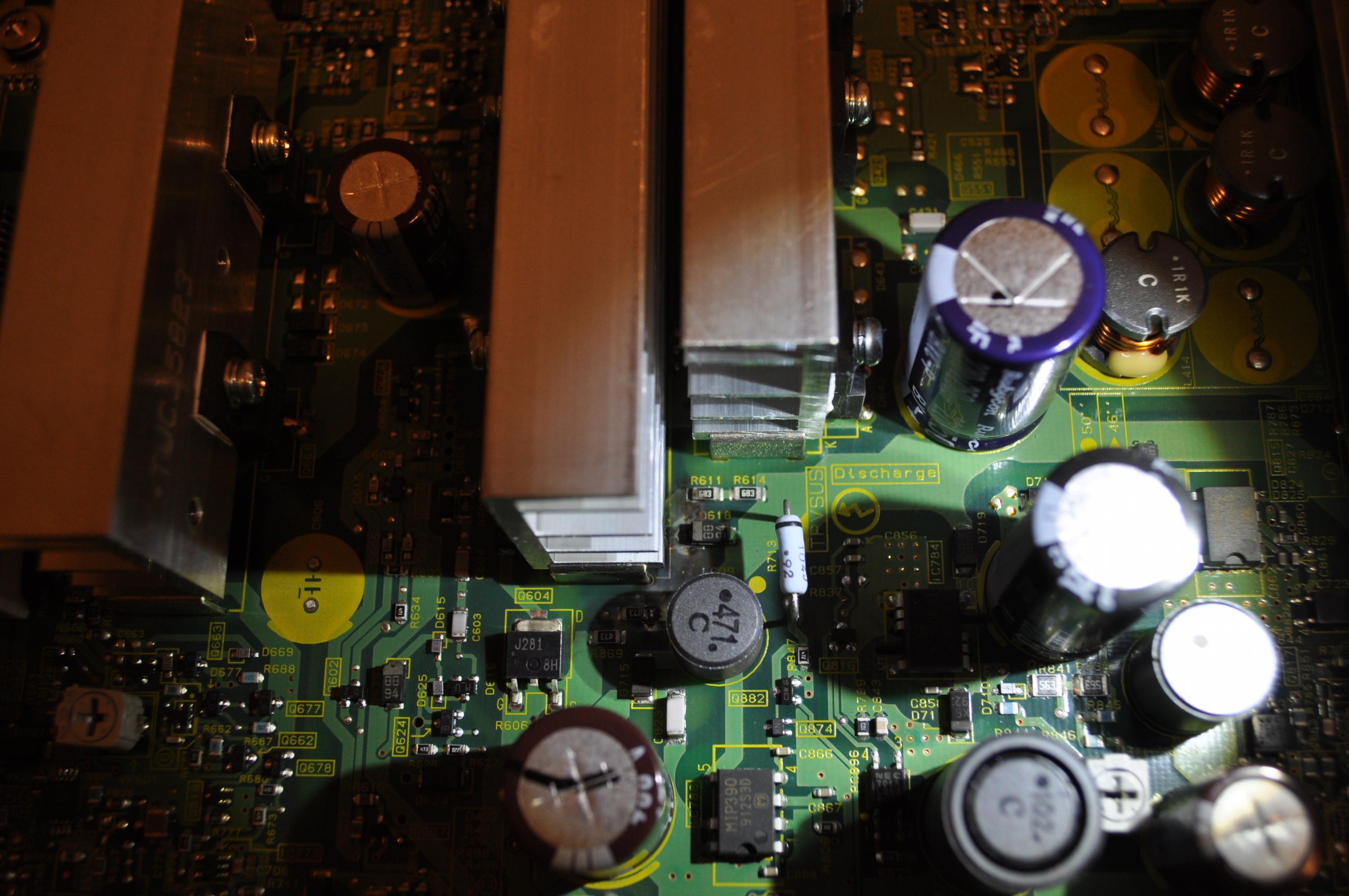

                Ok from the white connection to ground is greater than 1 meg ohm. Resistance varies across the connector but is not short.
                  I do have a short from the white side to one side of the burnt diode.

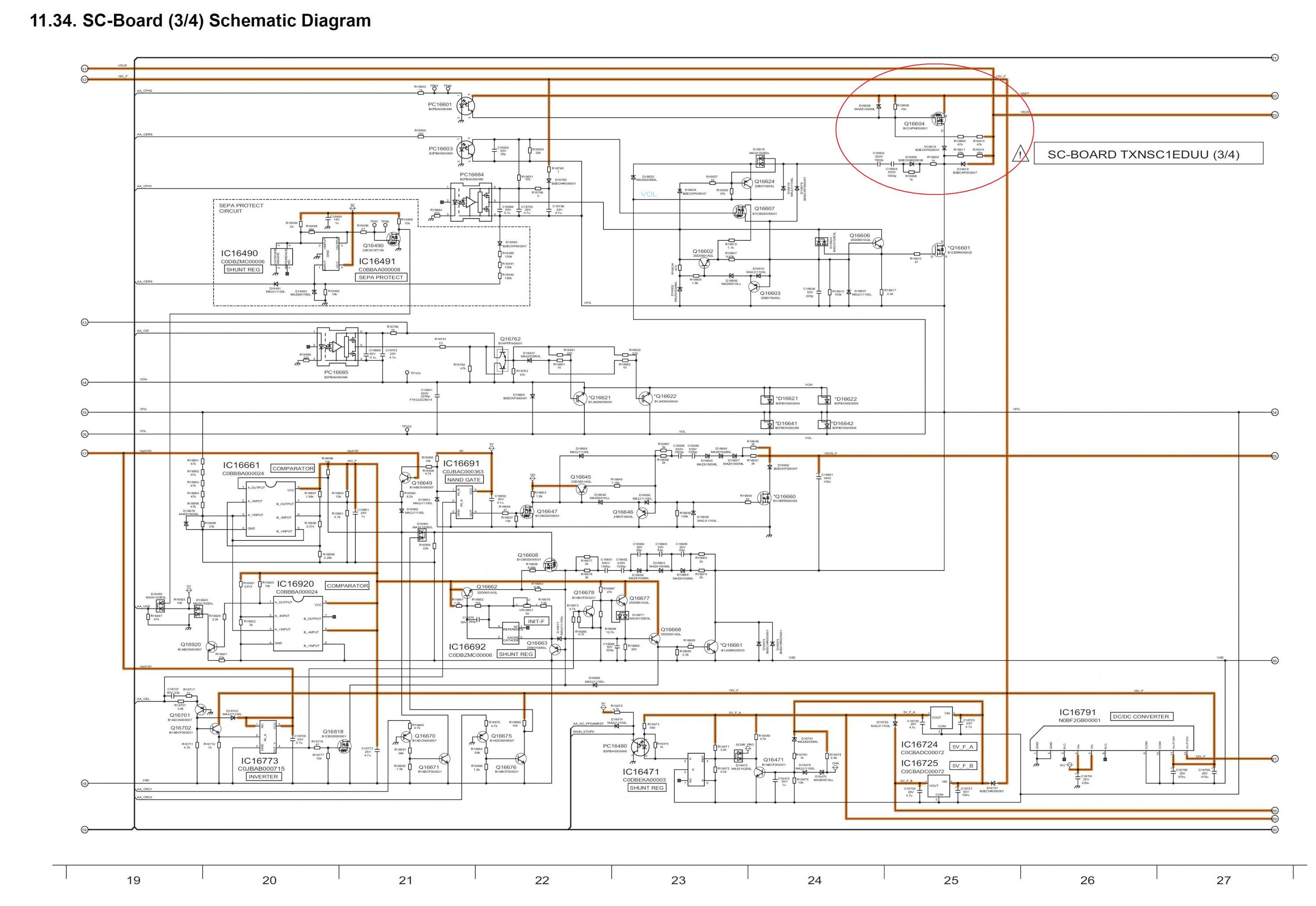

                      The white wire carries the VSUS voltage, can you tell me the location of the diode?
                      • landyboy
                        • Apr 2013
                        • 443
                        D618

                          Ok I am having problems finding the 5v and 15v.
                          When I power the tv on with everything connected it give me an initial voltage of around 190 volts feeding each board SC... but after a few seconds the voltage drops...
                          • tw2005
                            • Oct 2011
                            • 6458

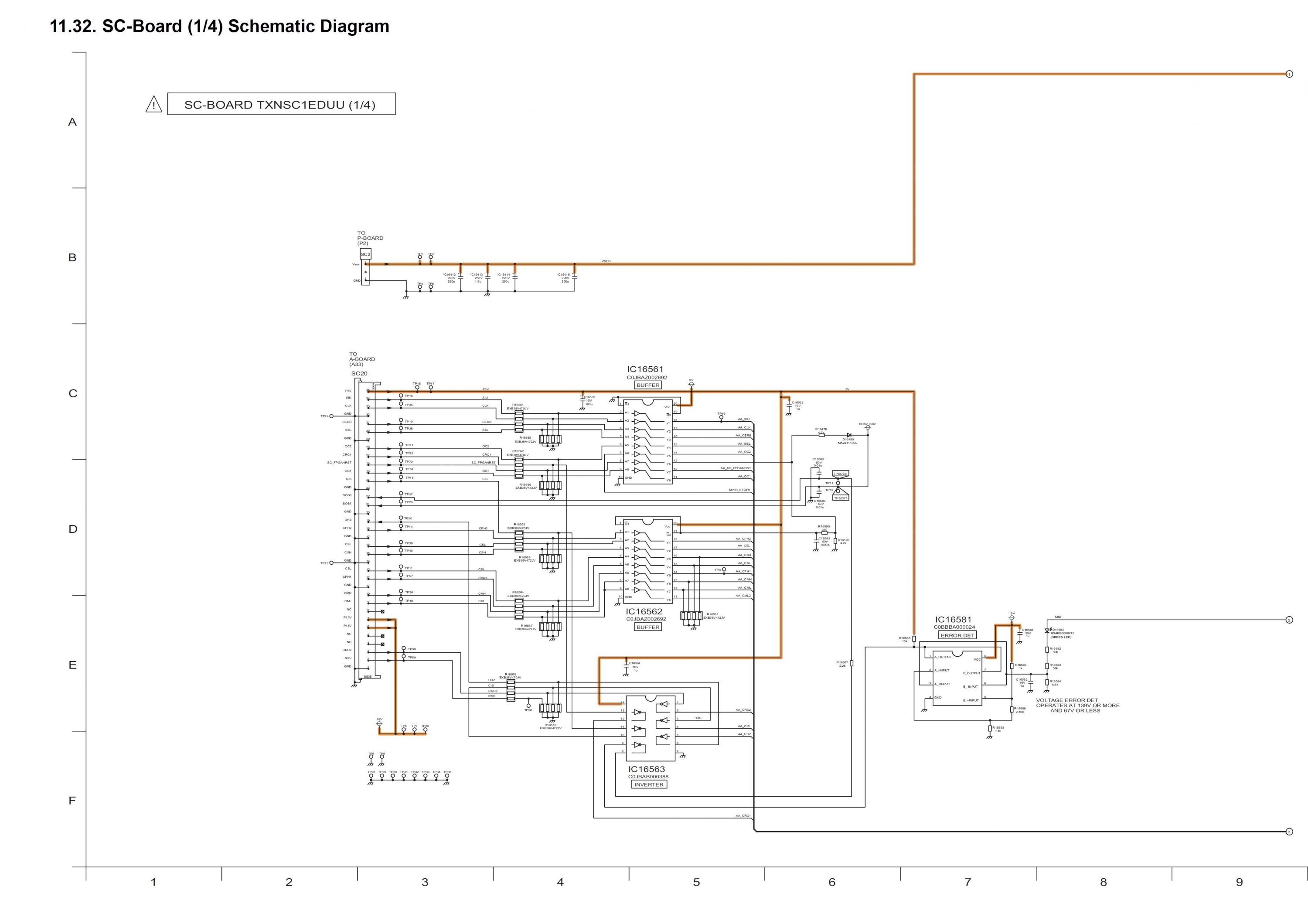

                            It drops beacause of the SOS shutdown, TP16,17 - gnd or across c563(c16563) 100uf 10v cap is the 5V in,TP6,7,82 - gnd 15V in, also on Pin 8 IC581, pin 11 IC521, pin4,5 IC791,
                            you could measure the resistance there to ground in case something has shorted on the 5V & 15V

                              no 5v or 15v present. 500ohm short between IC581 pin 8 and ground. Also D618 has solid short across it.
