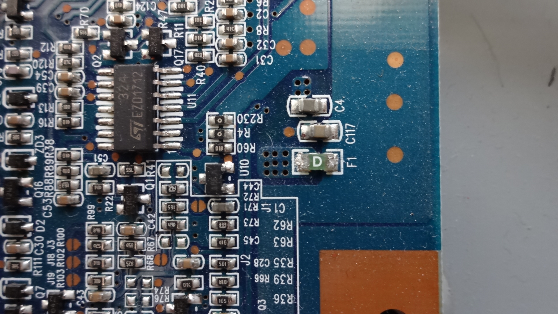

    When the power button is pushed, the TV status light will come on as normal but there is no other sign of life from the TV. It will also turn off if you push the power again. I have tried hooking something up to it and switching through the inputs but I have not been able to get any sound or video at all (no backlight either).

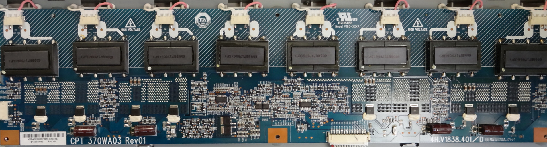

    After some testing I have found that the F1 fuse on the inverter board reads at somewhere between 3 and 20MΩ. I was hoping someone could help me find a replacement part or at least point me in the right direction. I took a closeup picture of the fuse, it is the fourth picture attached to this post. Should I try bypassing the fuse?

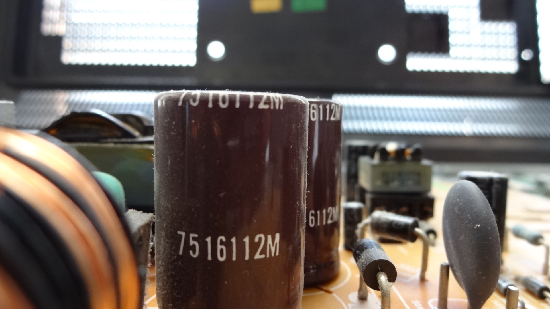

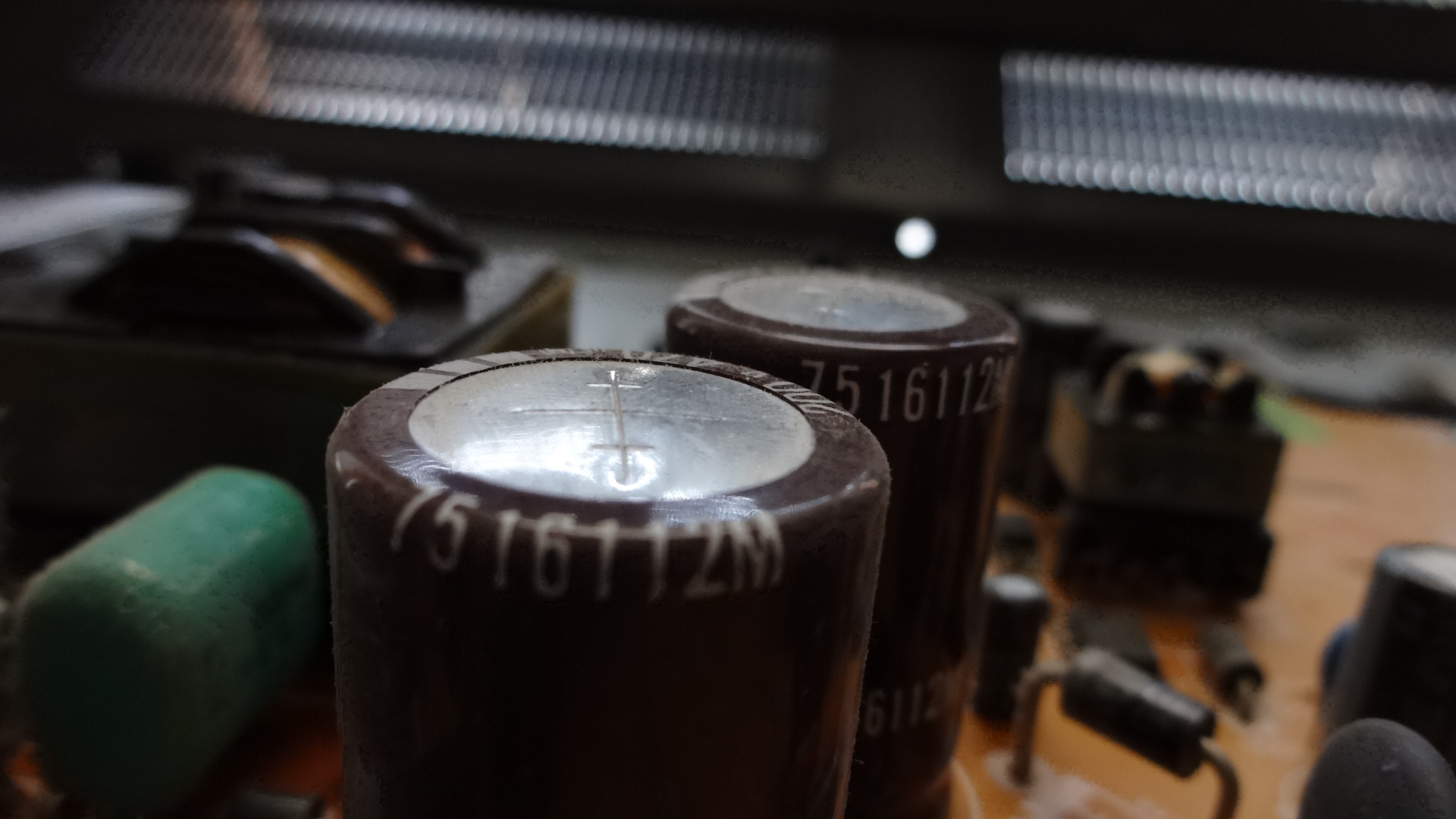

    Also, the two largest capacitors on the power board are ever so slightly convex on the top. I think it is how they are designed and that they are not bloated but I would like a second opinion (also pictured).

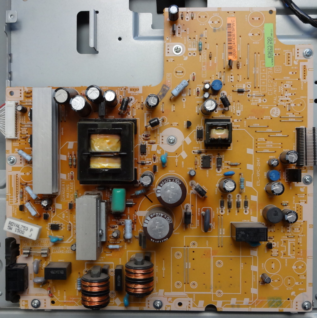

    Power Board

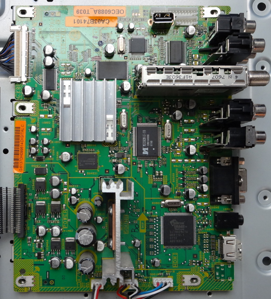

    Input Board
    Inverter Board
    Inverter Board Close Up 1
    Inverter Board Close Up 2

    Those capacitors are OK.
    Fuse ratings in this datasheet:
    "D" = 0.25A

      Re: Sansui HDLCD3700 -- Turns On, No Picture/Sound
      Thank you. Would it be a bad idea to bypass this fuse or should I wait until I get a replacement?
        Wait for a replacement.
          Welp, replacing the fuse did the trick. Thanks again!
