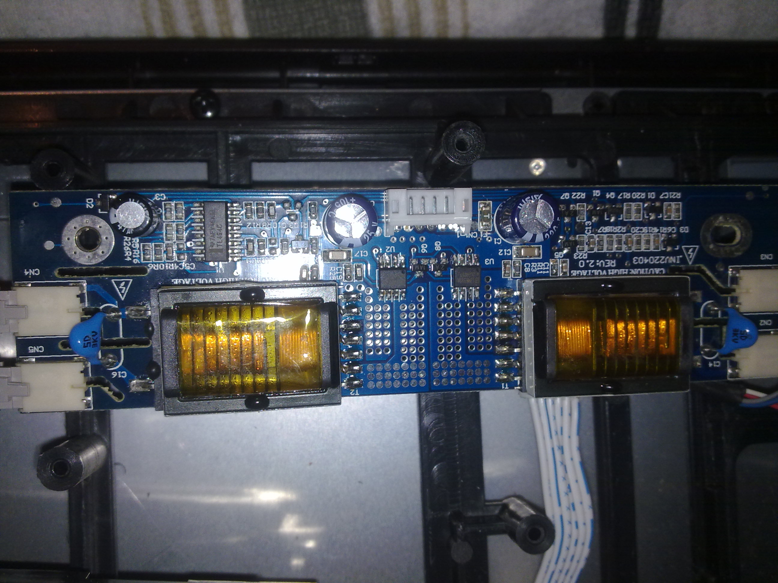

    Got this UMC and the backlights are not starting, all voltages seem correct apart from BL ON
    These are the voltages on the inverter board
    Standby:-
    Vcc=12.20v
    Vcc=12.20v
    ON/OFF=0.08v
    ADJ=0.00v
    Powering Up:-
    Vcc=12.03v
    Vcc=12.03v
    ON/OFF=0.08v
    ADJ=0.00v
    On:-
    Vcc=11.91v
    Vcc=11.91v
    ON/OFF=0.08v
    ADJ=0.00v

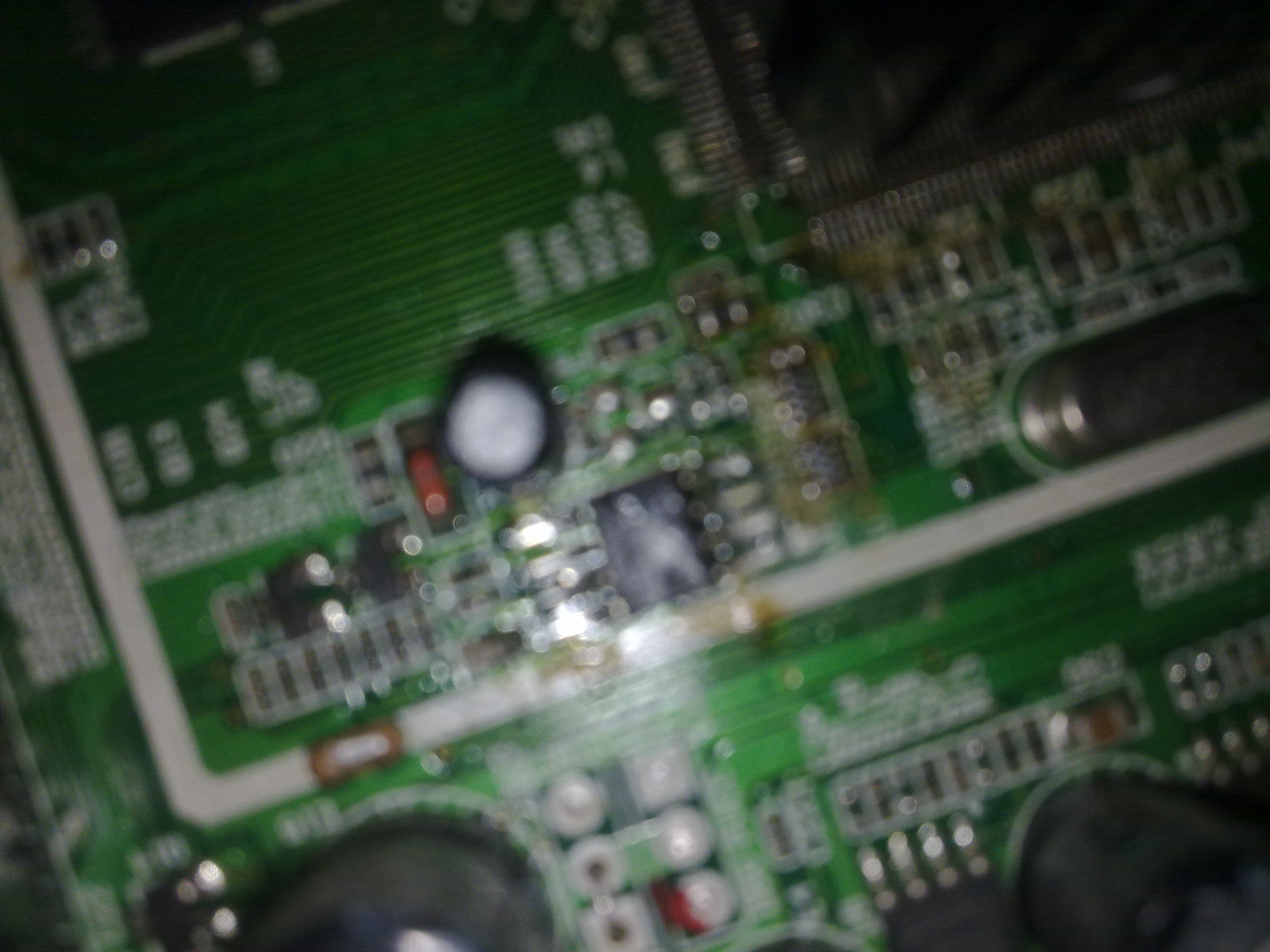

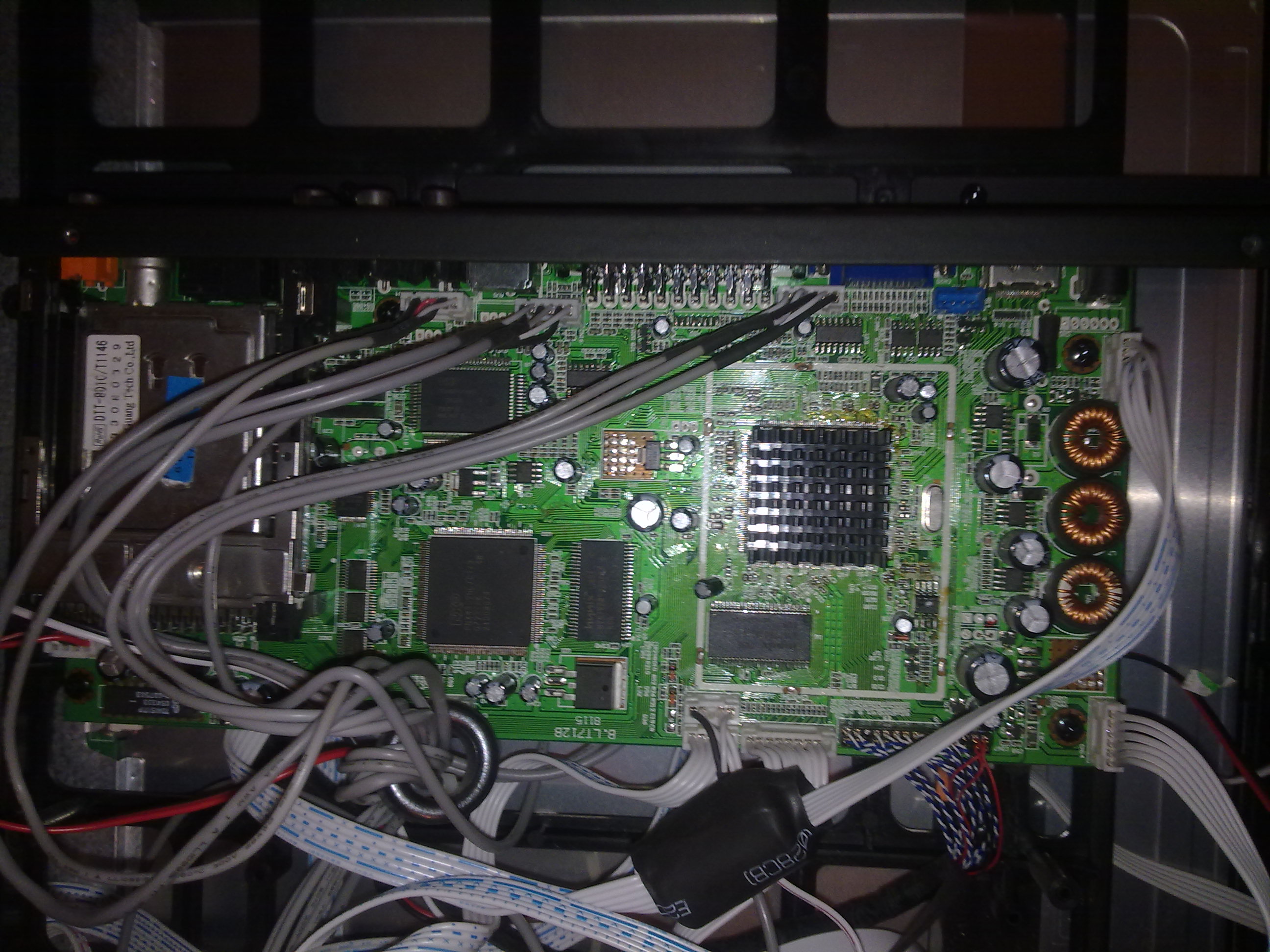

    I have attached pictures of the main and the inverter, I have not attached PSU as its an external jobby
    Could I add that apparantly if you sit there for 10minutes and keep disconnecting and powering up the tv it will work..I am guessing that it finally throws something down B/L ON for the odd start up
    On the main my only concerns is the 8 legged ic to the lower right of the largest IC,with the black heat sink on top...but I cannot read the back of the thing at all, and no schema's found to cross reference
    Any help would be appreciated
    Sorry about the chip pic's I keep getting flash glare will post more in the morning under natural light

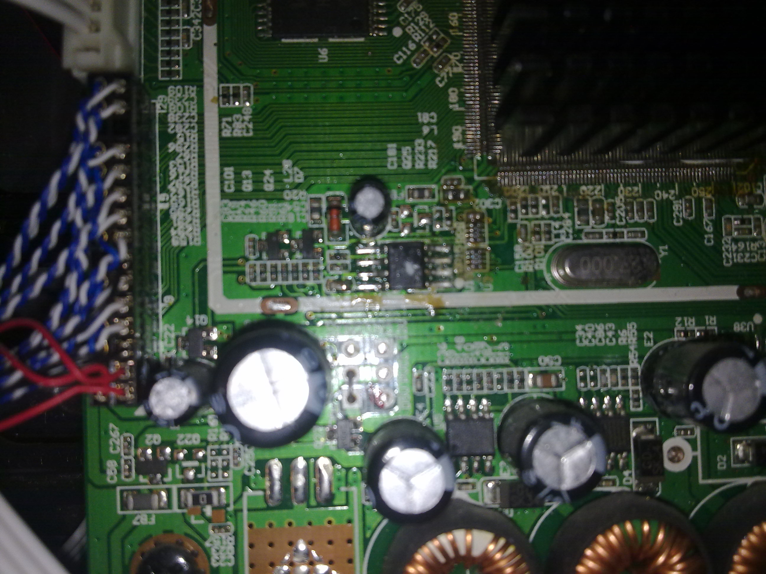

    Re: UMC L22/01C No backlights (B/L ON voltage)
    This is a bit better pic of the ic in question

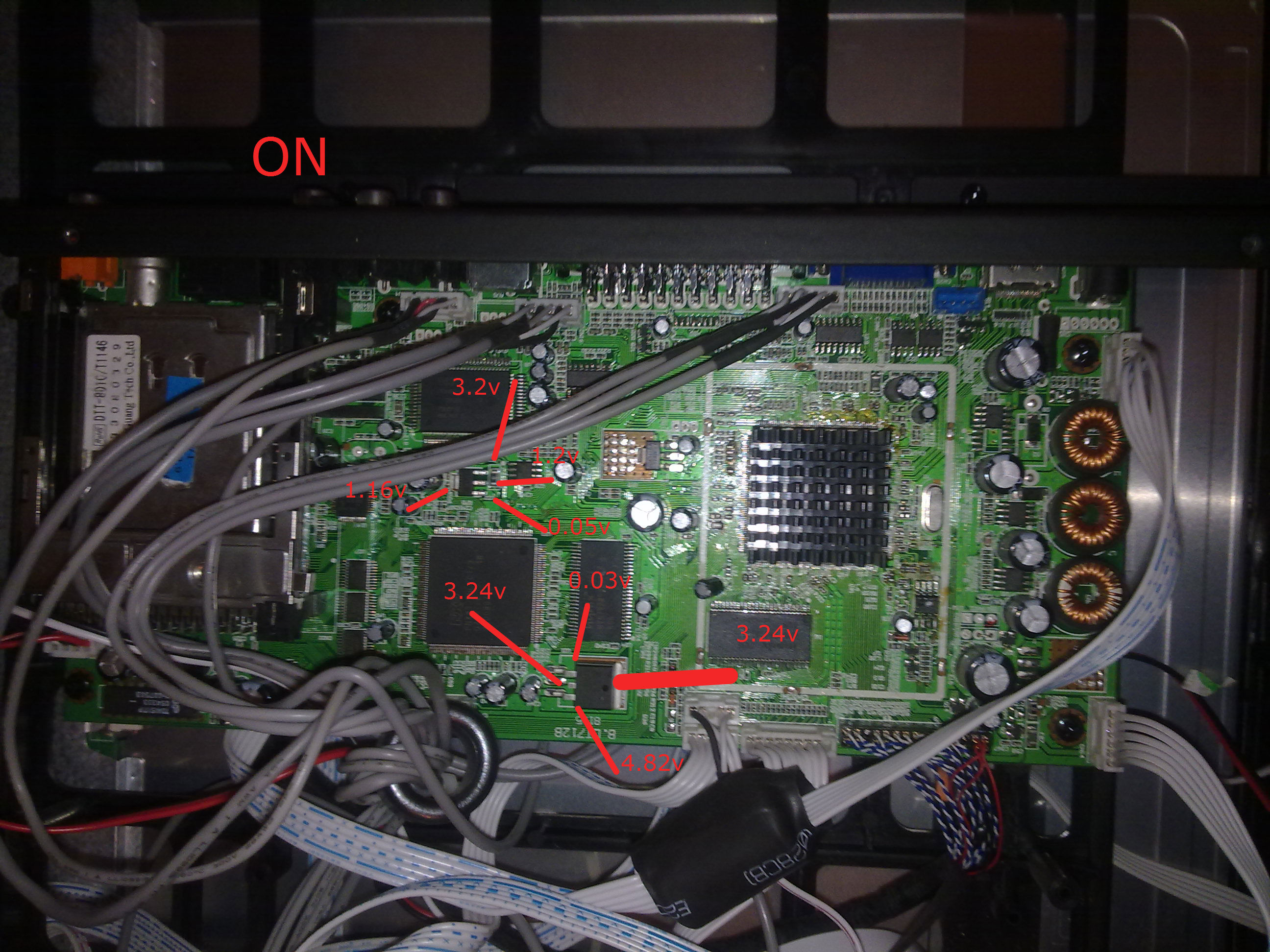

      I see some 3-leg LDO regulators on that main board. How are the voltages on those regulators?
      • signup
        • May 2013
        • 189

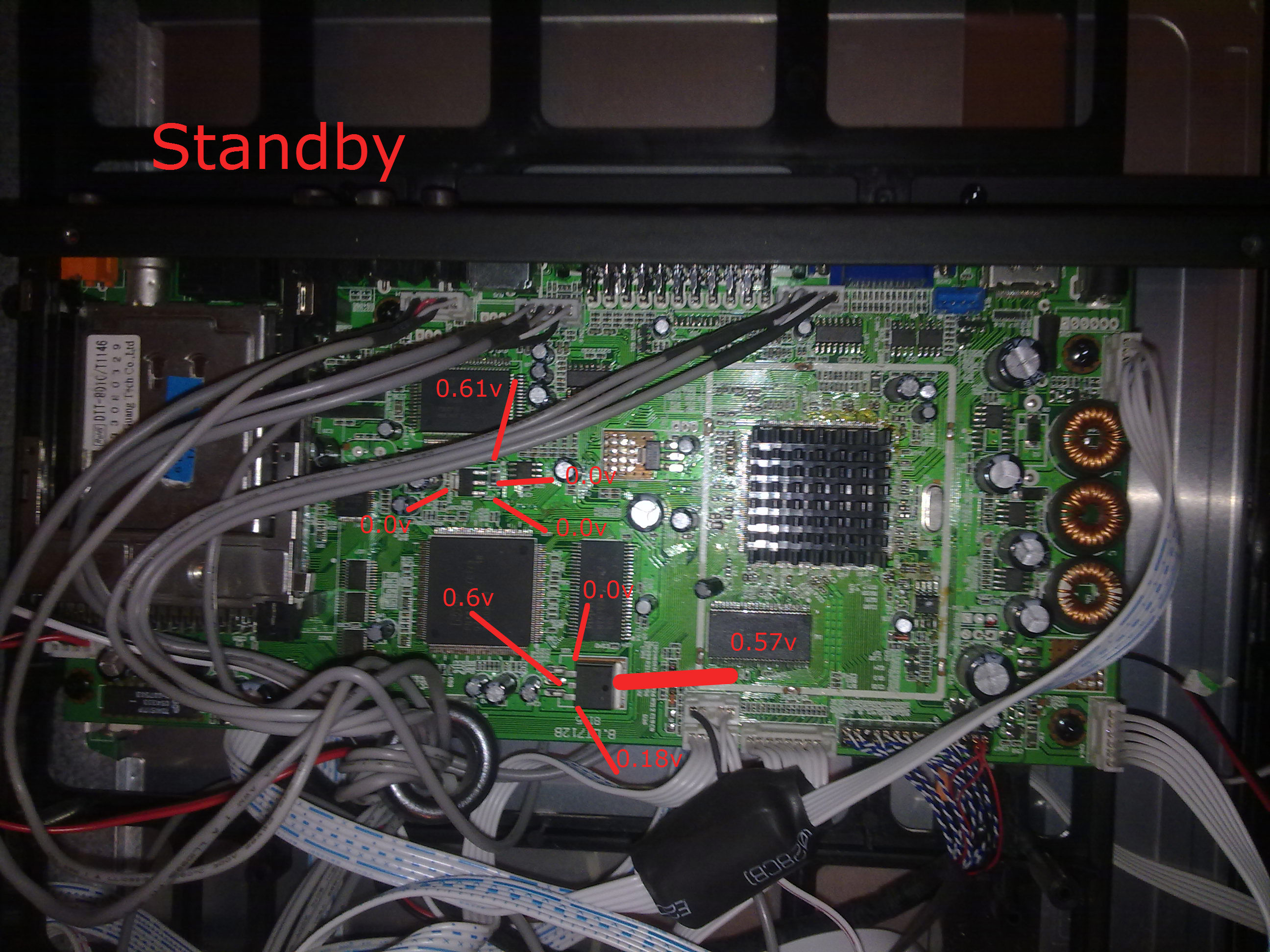

        Here you go
          In standby?
          Now try with TV not working, then after 10 mins fiddling, TV working. We need both states.
          • signup
            • May 2013
            • 189
            I will try but have spent sometime getting the dam thing to start with no success
            The picture on the right is with the tv on but not working
