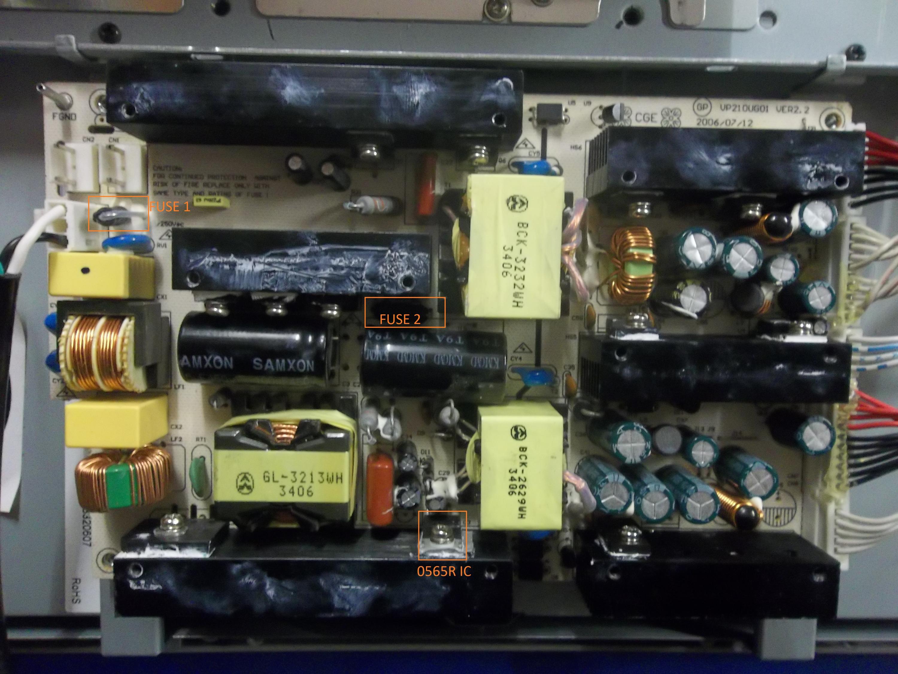

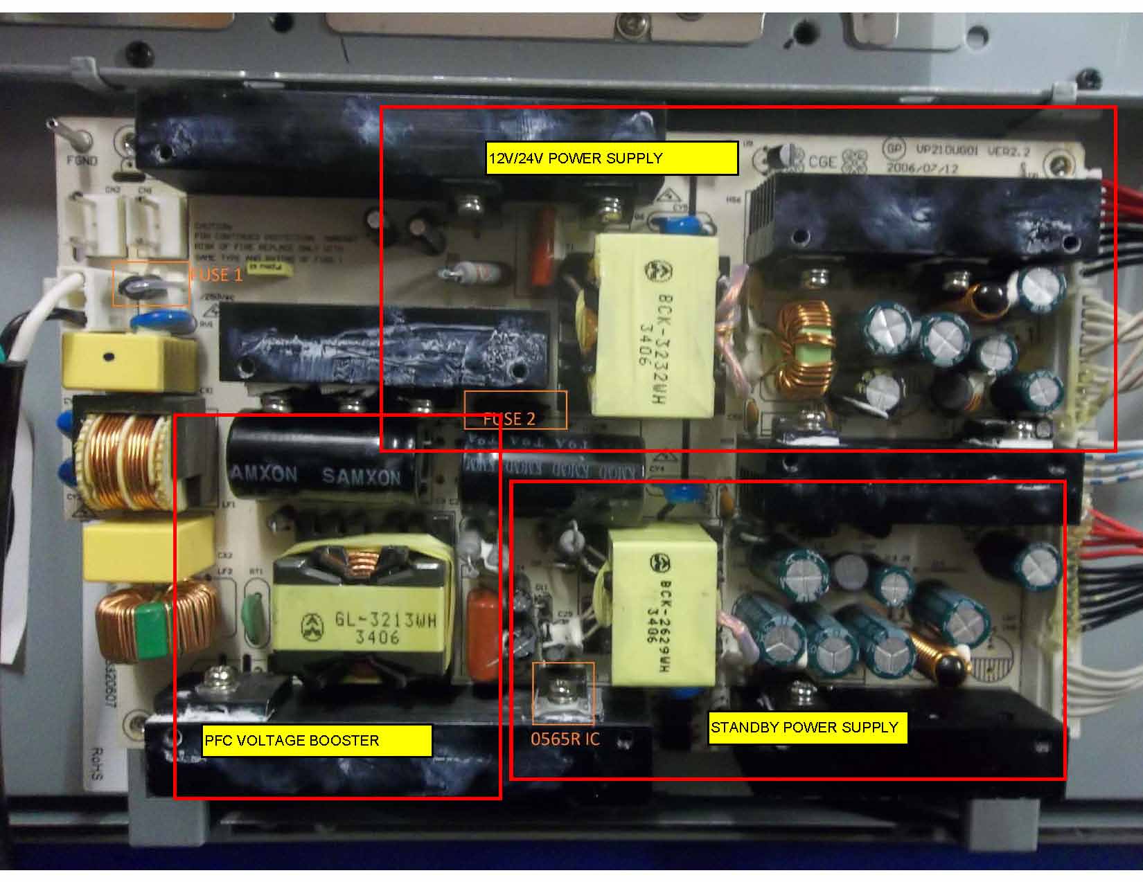

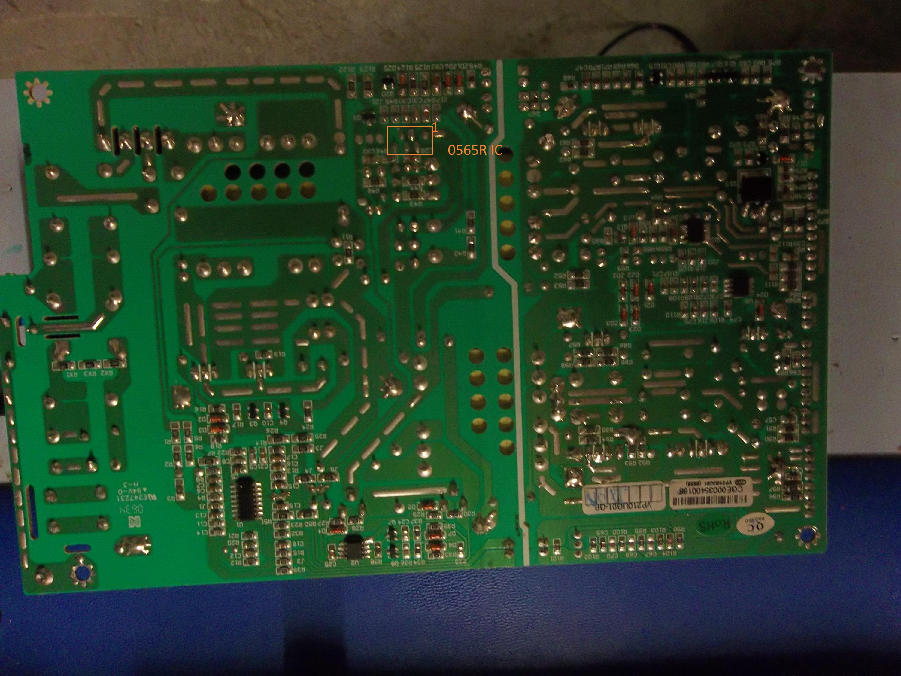

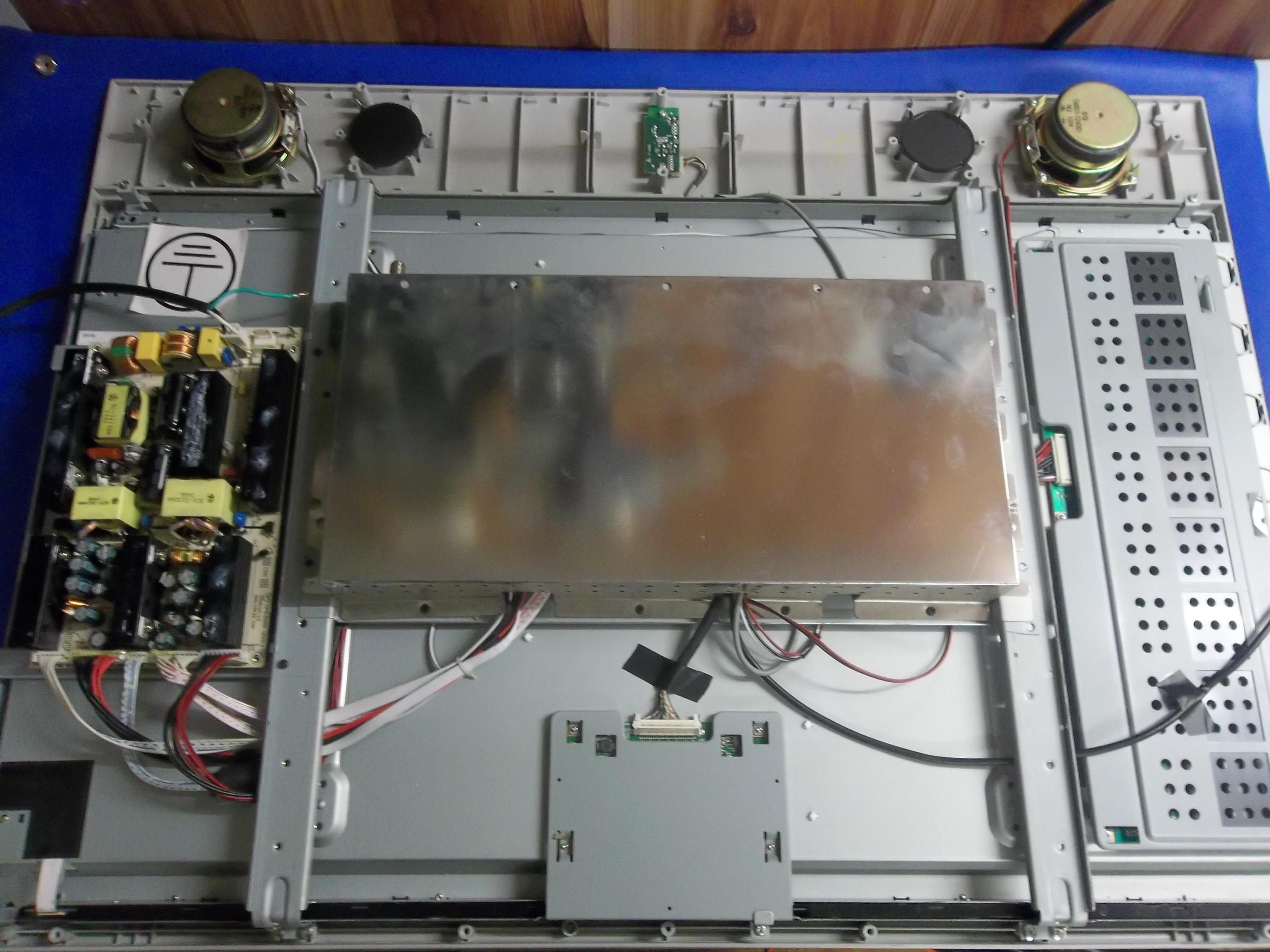

    This tv looks dead, meaning there's no LED on.
    Looking inside none of the output voltages are present.
    Both fuses are OK on the PSU.
    I get 179v on both filter caps.
    On 0565r IC this is what I get:
    Pin
    1-179V
    2-GND
    3-VARIES CONTINUOUSLY FROM 9 TO 14V
    4-VARIES CONTINUOUSLY FROM 0 TO 3V
    5-NC
    6-VARIES CONTINUOUSLY FROM 0 TO 1.7V
    Attached is the datasheet for the 0565r IC.
    I'd appreciate any pointer on what to check next.

      I assume from your original post that you have used a resistor to start the power supply / and checked the voltages at the connectors on the edge of the PSU?
      If that's correct then your on the right track checking the power supply as the power supply should be able to start on its own if you force it to regardless of the main board.

        It sounds like that standby power supply is trying to start, try heating up those small caps by the IC with hair dryer for 2-3 minutes to see if you can get out put voltage at the filter caps on the secondary side of the transformer.

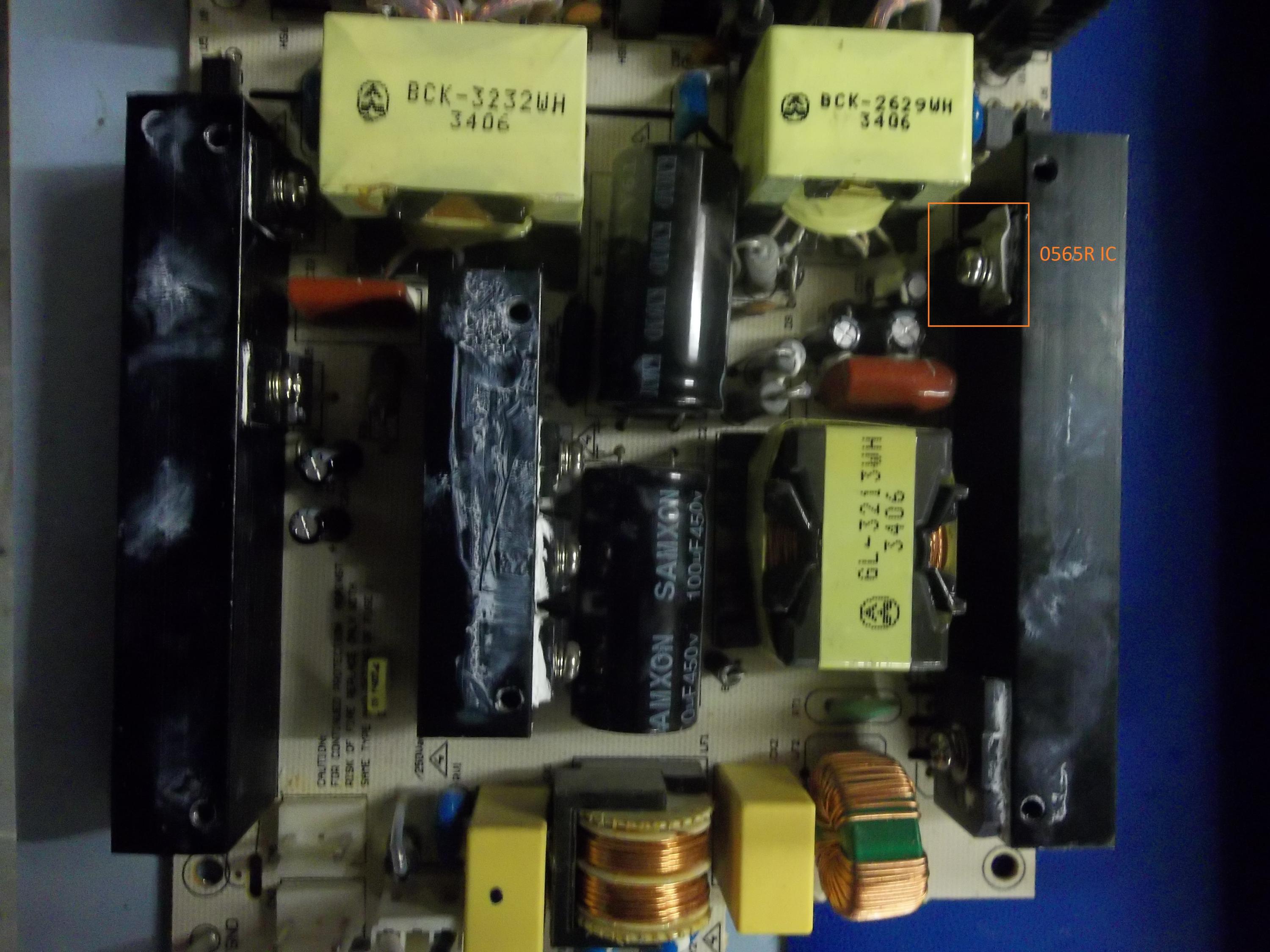

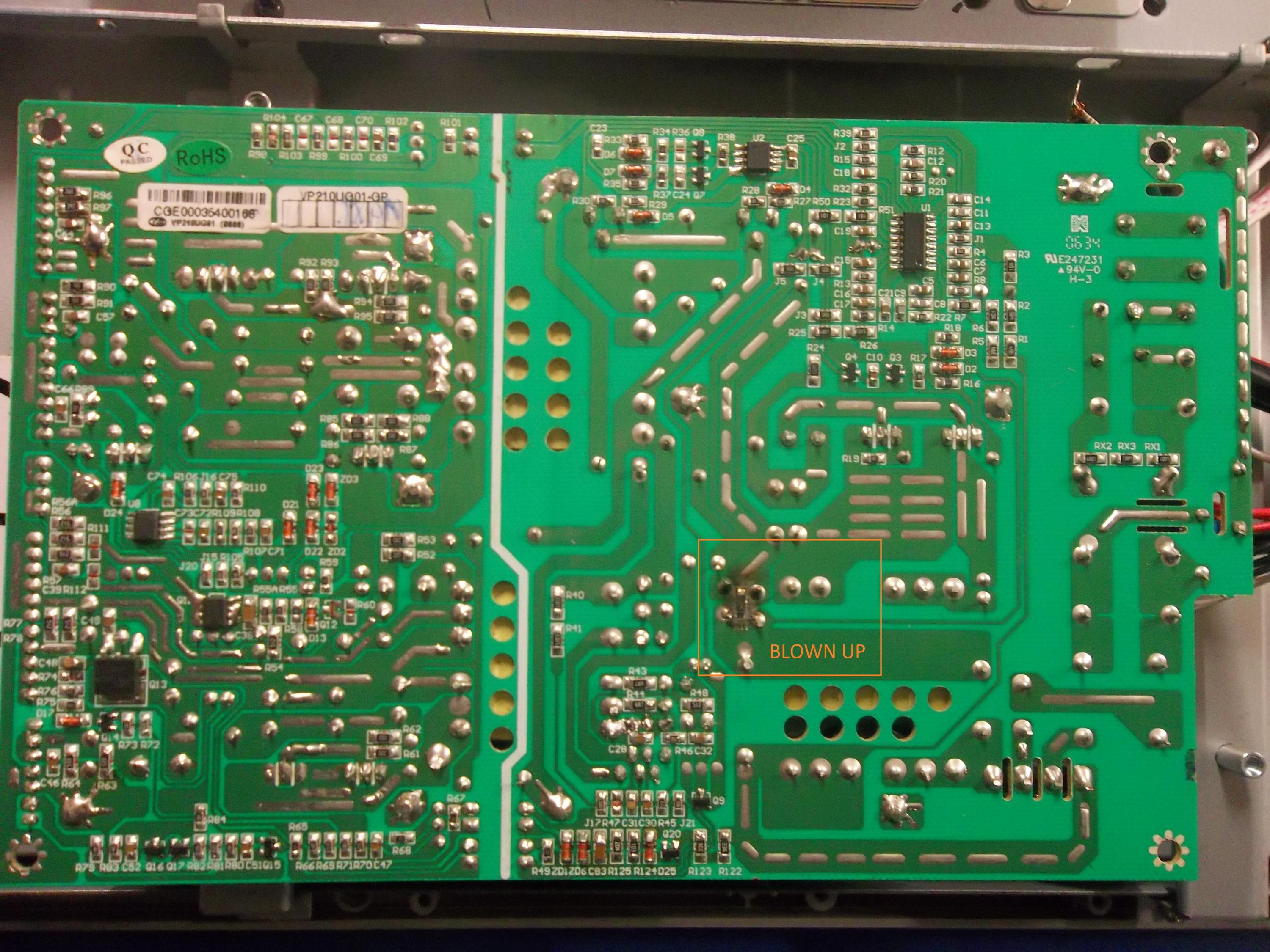

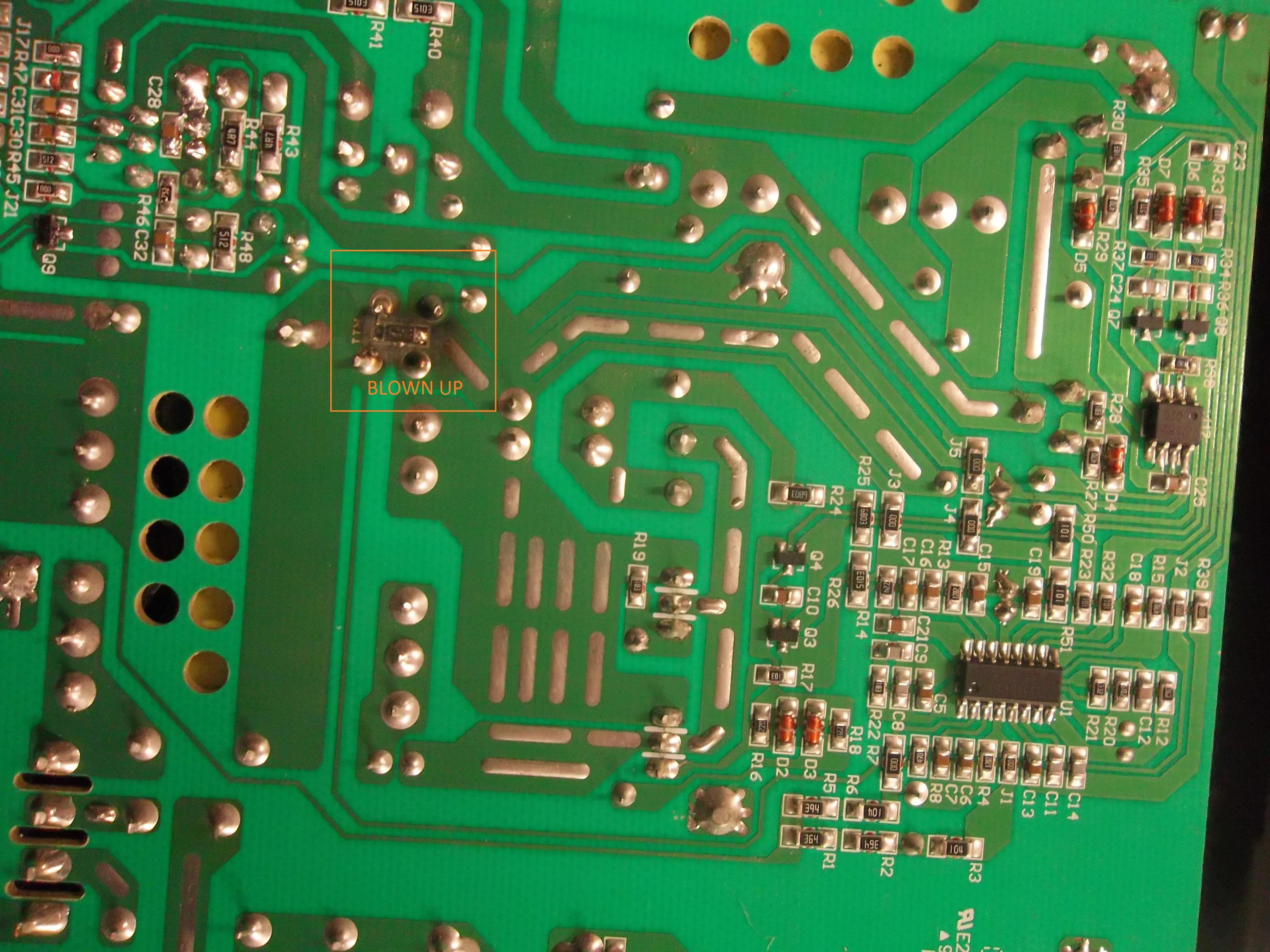

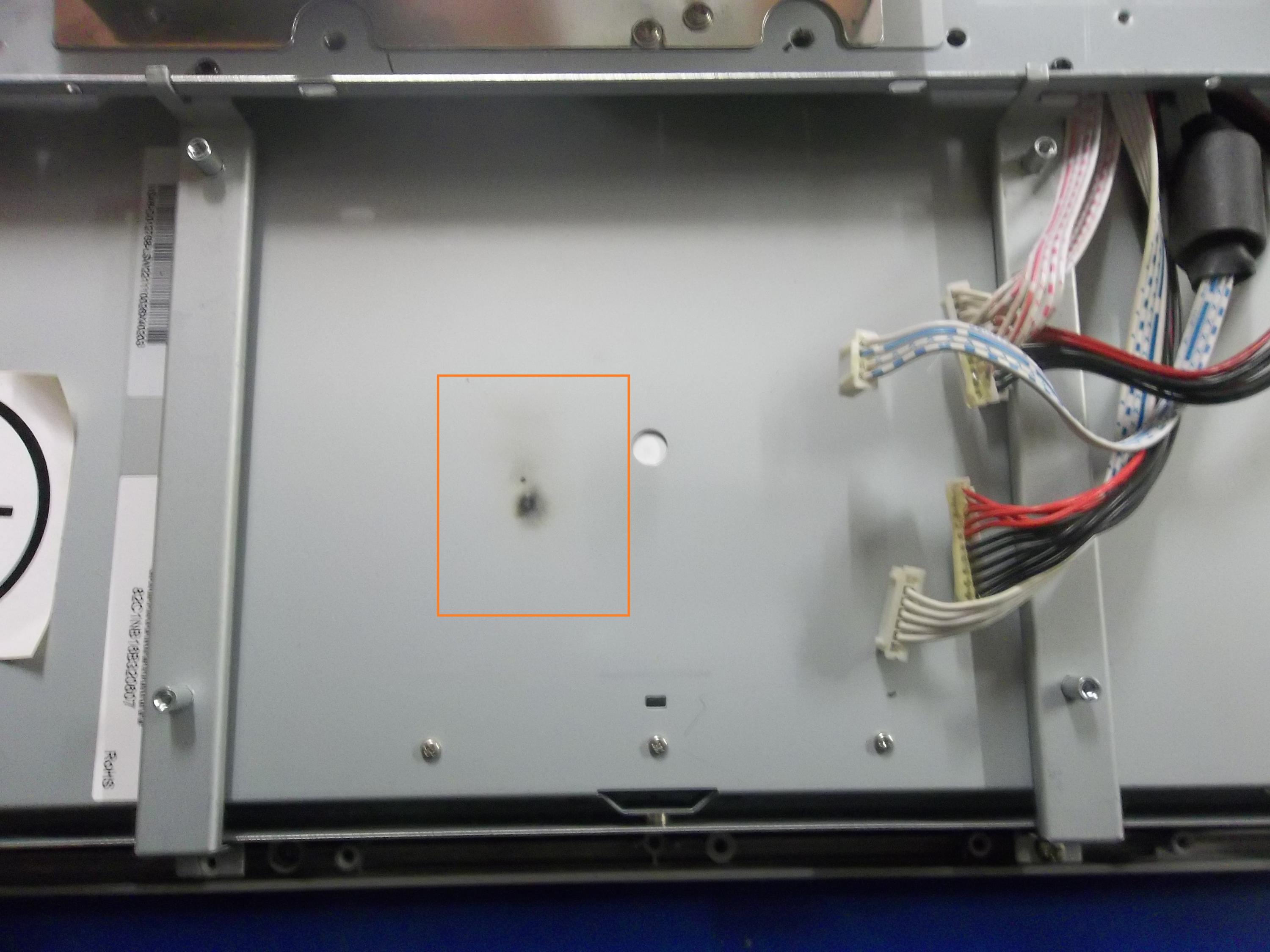

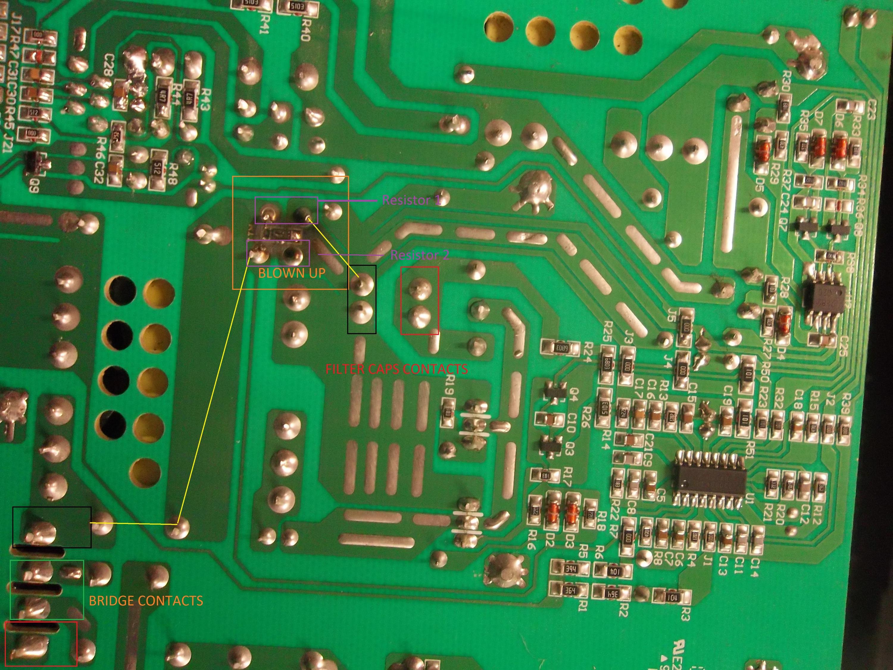

          Alright I put some little heat on those caps and something weird happened, one smd resistor on the bottom side of the board blew up big time And no, none of the fuses got blown.
          Hell I bought a board for $54 from shop jimmy. I'm not giving up on the repair though. I'll use the good board to help me fix this one and have two. Use one and post the other one for sell on ebay. Give me a few days to get back with an update.

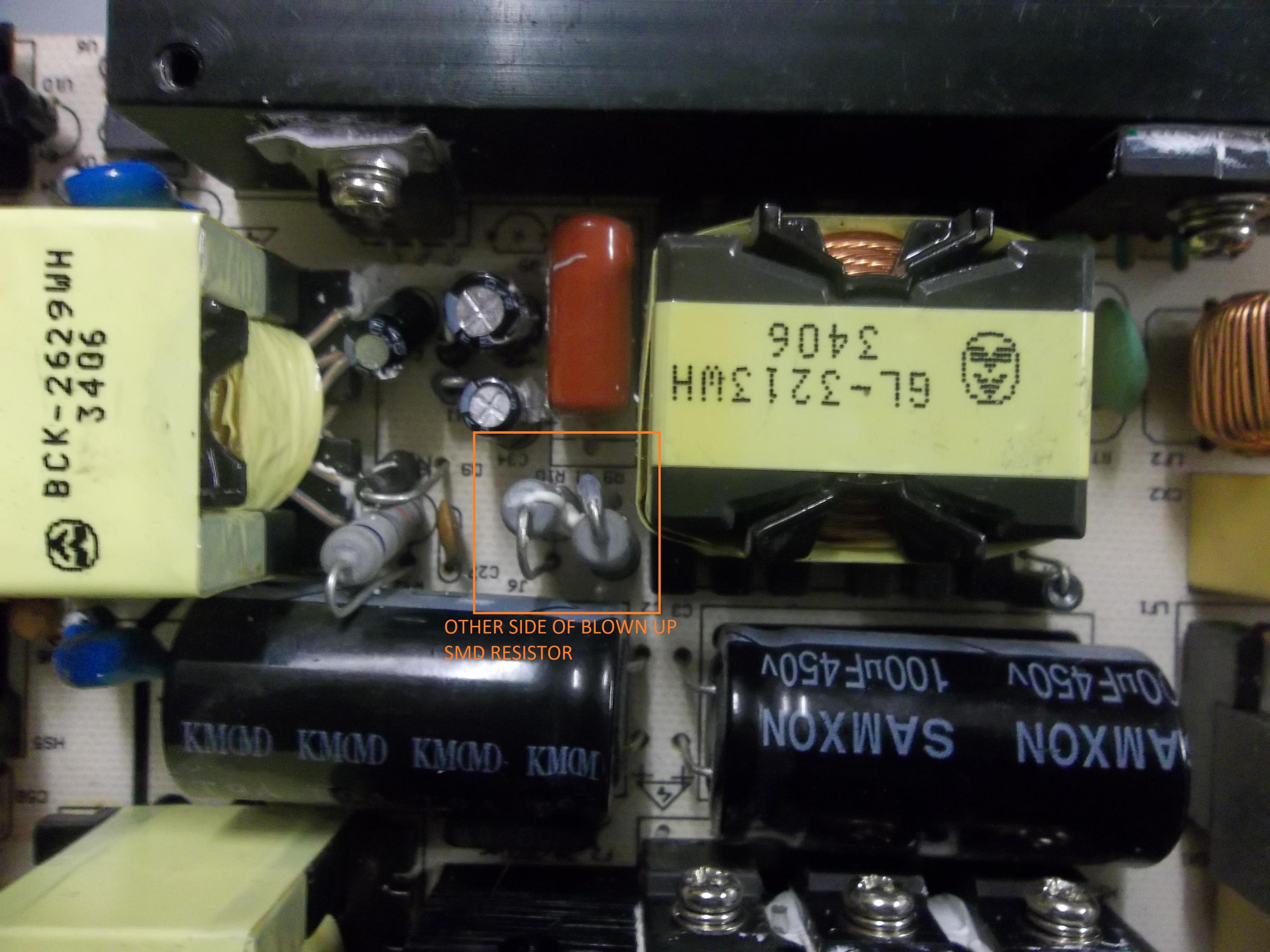

            Hmm, that SMD resistor that blew up seems to be connected in parallel with the other 2 large grey through hole resistors. Those resistors seems to be connected in parallel with the two large filter caps (450Vdc caps). Can you verify that?
              The three resistors are in parallel among them yeah. One side of the resistors connect to the negative of the filter caps and the other goes to a pin of the bridge rectifier labeled as (-) negative.
                Re: Ilo lct32ha36 dead
                That does not make sense at all since the negative of the bridge should be directly connected to the negative legs of those two filter caps. I am trying to trace out the connections but having hard time doing it.
                  Call me crazy but I've checked it like ten times visually and using continuity with the meter. I also found it rather strange. It wouldn't be the first time I get a tv with manufacturing defects. I'm anxious to see how the one I ordered is wired up.
                  Attached is a picture explaining it more.
                    How low is the resistance of those resistors, less than 1 Ohm? It may be using that as fusible resistors.
                      They're 0.39 Ohms. And they're cracked, probably from that little incident earlier lol.
                        For now, it is OK to leave it as is, I do not really know why it has small 1/8W resistor in parallel with the other two large Wattage resistors, since the circuit is not open, the two caps will be charged up OK. I would like to find out if heating those small caps in the standby power supply make it start running again.

                              From PlainBill, I learned there are 3 likely suspects.
                              1) the startup cap is bad - easy and cheap to replace with a Panasonic FC. I like to keep a stash of 47uF 50V and/or 22uF 50V caps just for these occasions.
                              2) the SMPS IC is bad
                              3) something shorted on the output side dragging down the power supply. something like a shorted diode. It would probably only take you 5 minutes to test all the diodes in circuit. If one reads shorted in circuit, desolder to verify readings.
