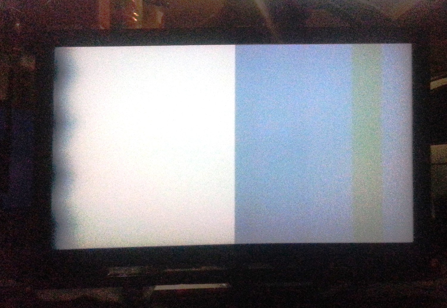

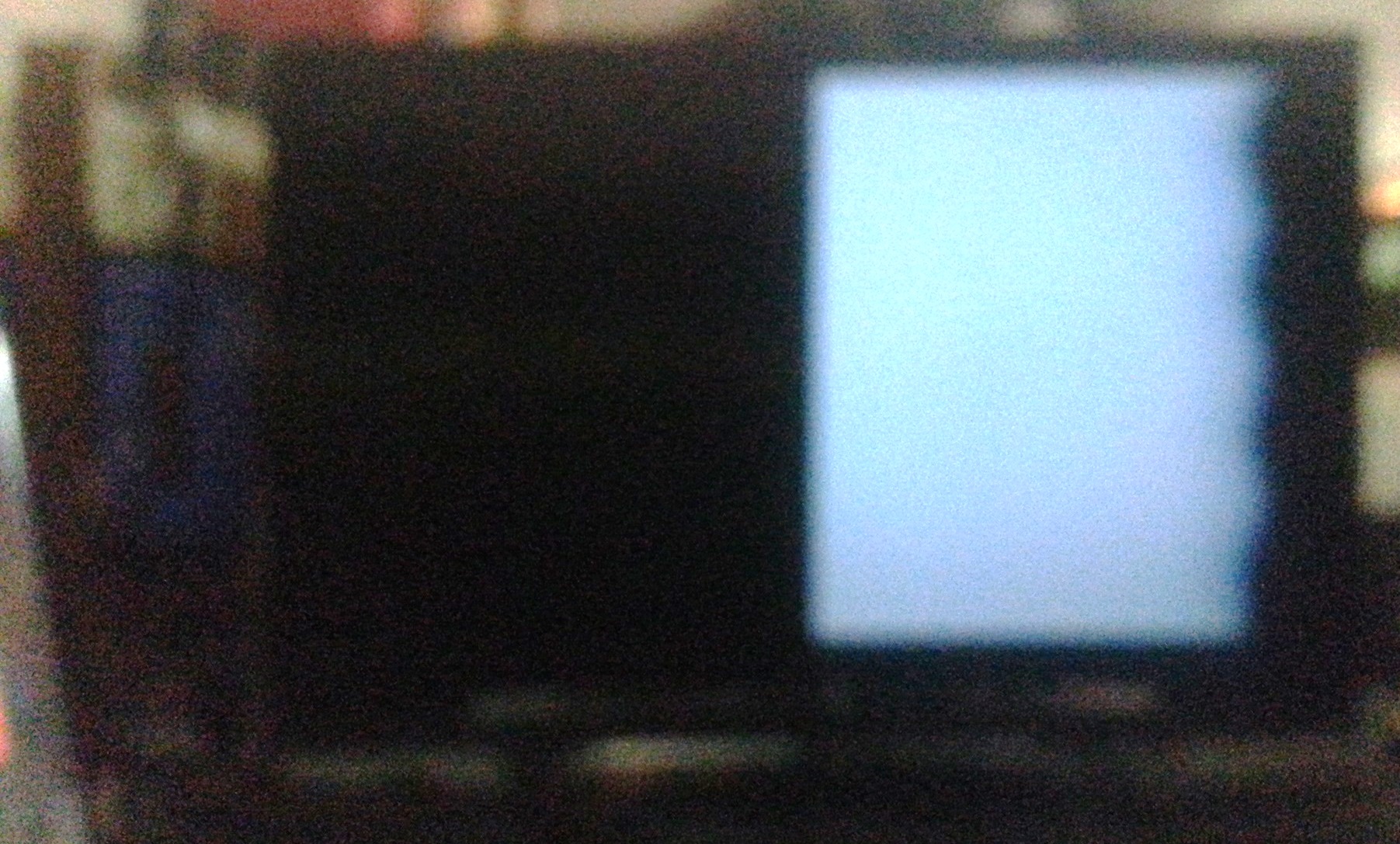

                      • tibimakai
                        • Jan 2012
                        • 3680
                        #51
                        Re: Sony KDL-40V4100 inverted picture
                        Here are the (bad) pictures. Sorry about the quality, but you get the picture.
                          #52
                          What happened? Now it looks like tab bond defect?! I thought it looked like original image?
                            When I unplug one ribbon at a time from the T-con output and turn it on, those black "spots" retract to the sides. Same thing happens at both sides.
                              #54
                              That is completely expected. Your fault is on the main board in my honest opinion.
