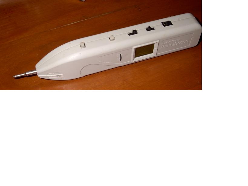

    It would be better if his screw driver looked like this.
    It's a screwdriver sized scope, I've had it for 15 years.
    He may be looking for a very small shorted coupling cap or an open bypass cap.
    Possably a bad signal proccess chip, any of these may be encased in metal shielding.
    Jim
